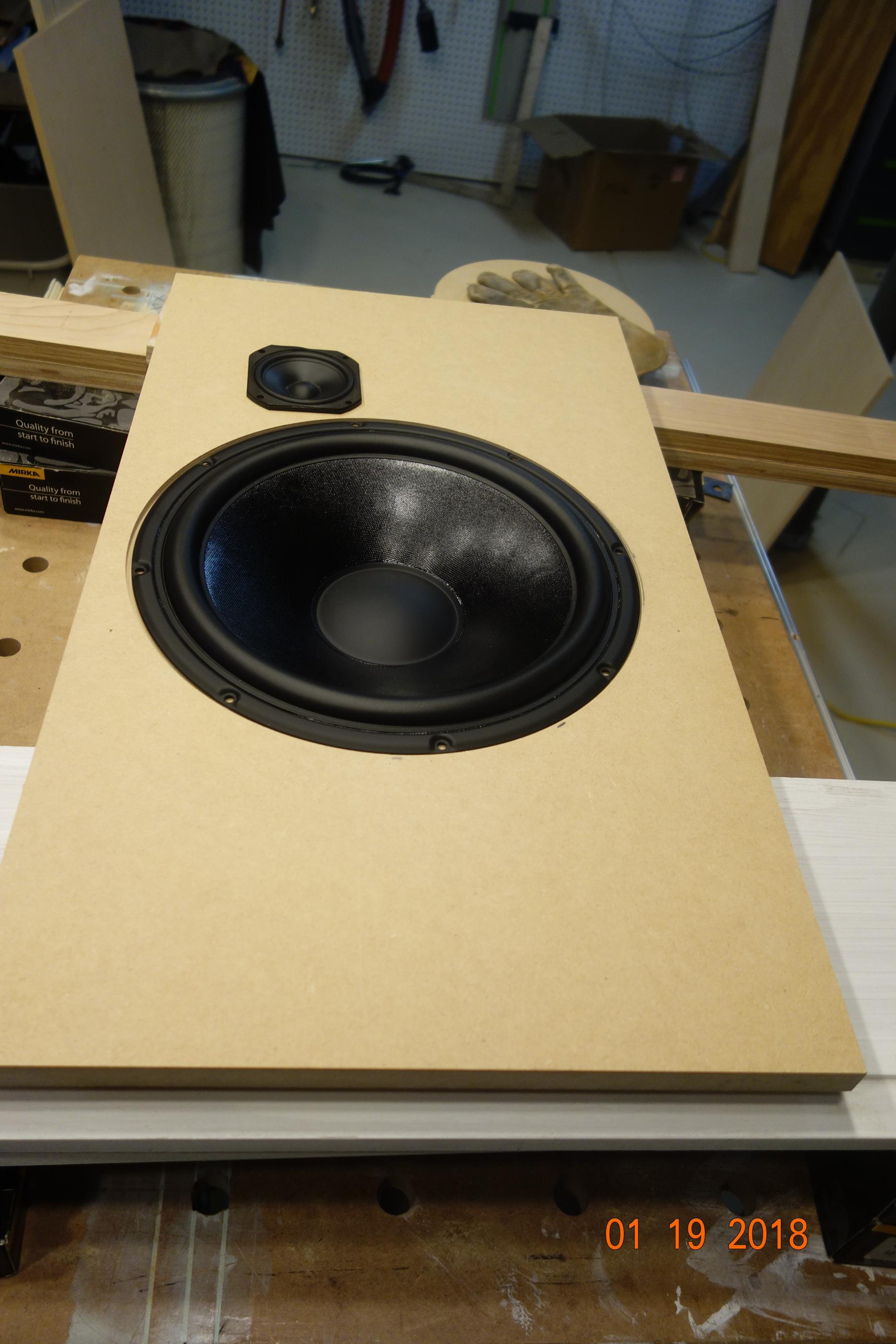

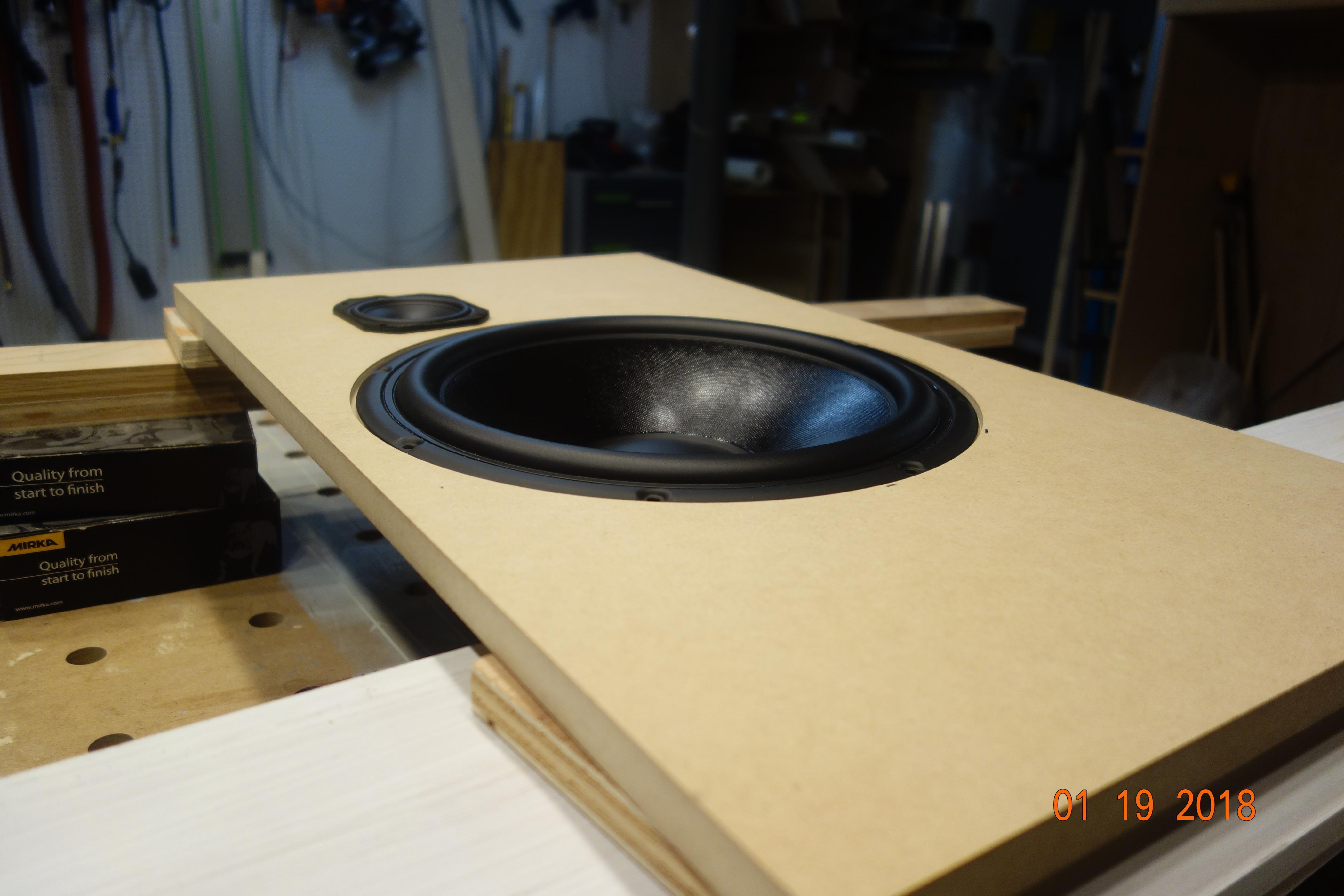

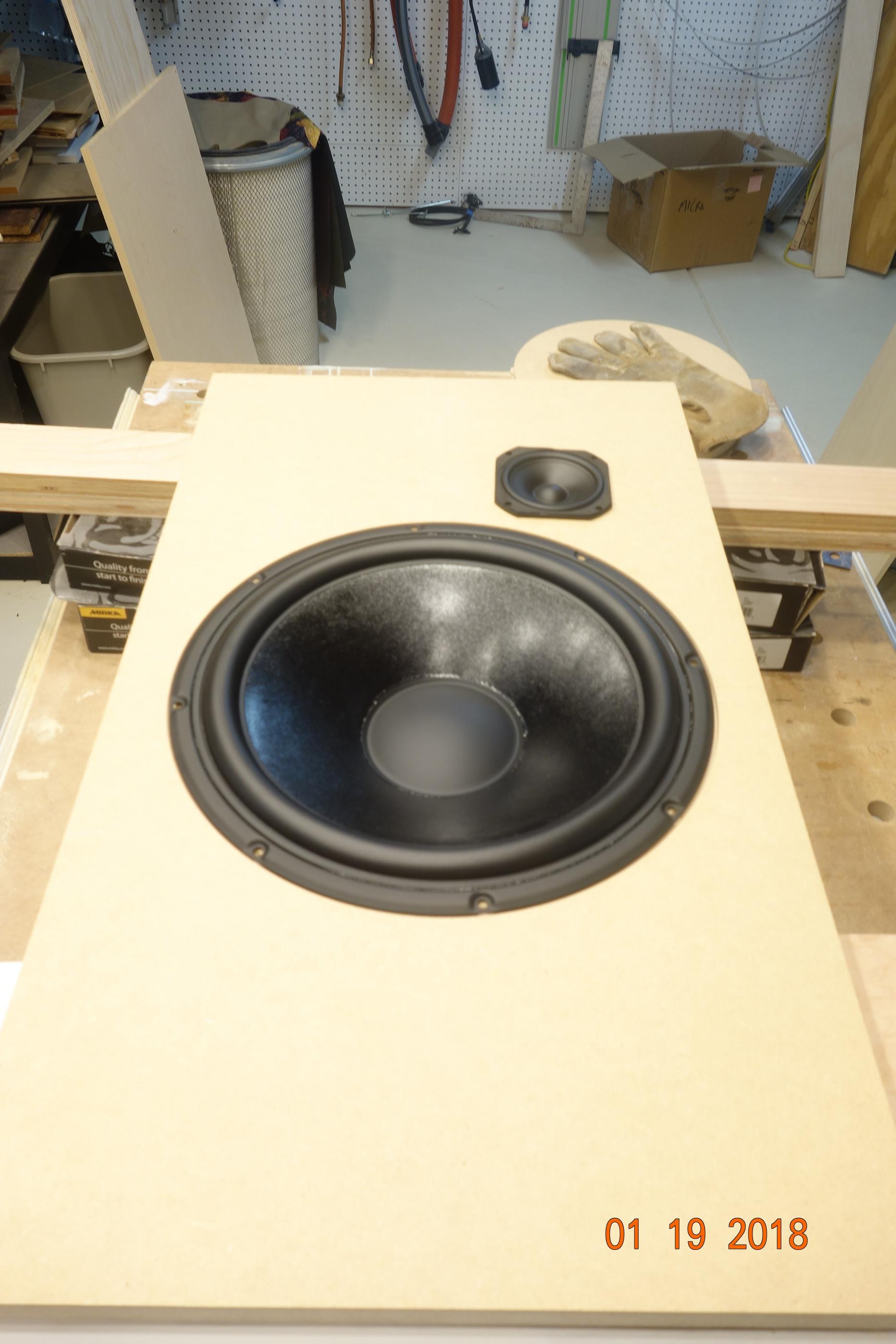

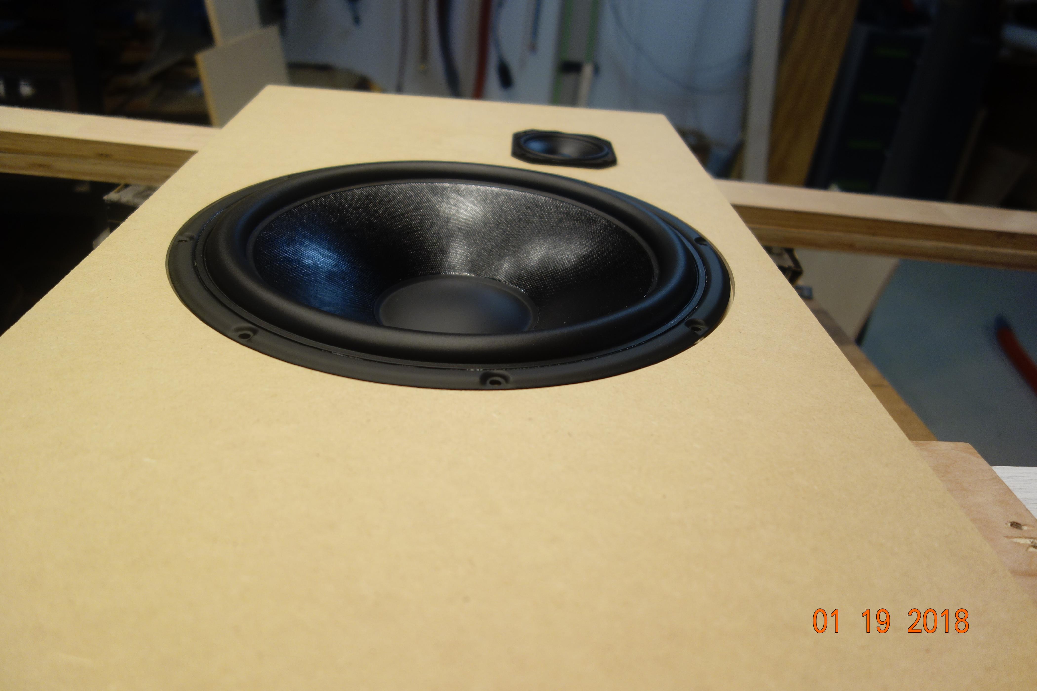

I will just deal with the 12" 830669 for now.
I cut the relief rings to a diameter of 12-9/16". This requires a little guessing due to the speaker shape. I ended up with about 1/8" extra (1/16" on each side) as you might be able to see in the pics. So, a tight fit would be 12-7/16".
I cut the relief rings to two different depths - deep at .238" and shallow at .176" Pics below show these.
Deep:
Shallow:

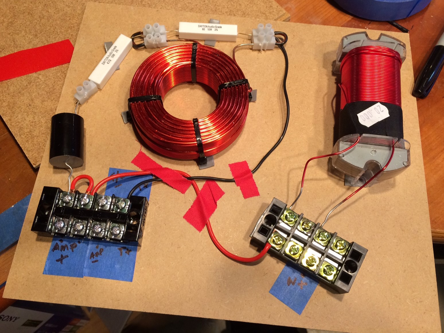

Ok, I have the prototypes all assembled, but I am getting no sound! I know that the amp and source are working as I tested on some other speakers.
Here is one of my crossovers. The tweeter + pretty much is in a circle pattern.
Tweeter wiring:
The positive from the amp goes to the far left where is it bridged to all 4 of the far left terminals on the left block.
The 6.2uF capacitor is attached directly to the terminal and then on to the 4.7 ohm resistor and on to the parallel of the 8 ohm resistor and 2mh inductor and to the terminal to be connected to the tweeter + speaker terminal.
The negative, together with the woofer negative comes off the third terminal on the left block which is connected to the amp negative.
Woofer wiring:
Positive from amp comes off the second terminal from the left on the rleft block which is bridged to the first. Then to the right block and on to the 20 mh inductor and back to the right block to be attached to the woofer + terminal.
Help!

Jerry: Looks OK at first glance. I don't see the negative lines, but you say they come back to position 3, right?
That's taken care of in the crossover. Works well.Driver qts is low for OB.
Hi pano,
Yes, both negatives to the drivers are connected on the top of 3 on the left block and the amp negative is connected on the bottom of 3.
I thought that maybe the barrier strips were not what it thought, but upon inspection of extras, they are regular barrier strips.
I guess I'll go back to "go" and test each piece separately. Not easy to do as I am hopping around on one foot after foot surgery.
Ouch, hop carefully!
Yes, I'd say make up some jumper wires and test point by point. I thought looking at the photo that the problem would be obvious - but it's not to me.
Probably someone will see the missing piece of the puzzle.
Ok, I am officially an idiot - as if it ever were in doubt. In my haste to final test, I hooked up the amp wrong. Getting good sound on the little test 15 watt Lepai. I'll move them over to an old Arcam AVR 100 (90 x2) next and then on to what should be their final home - an Audio Refinement (designed by YBA) 5 x 125.
Plenty of bass - even on the crappy little amp.

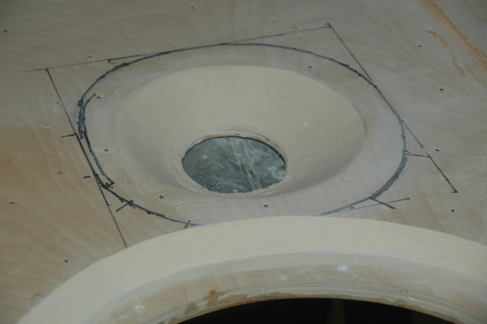

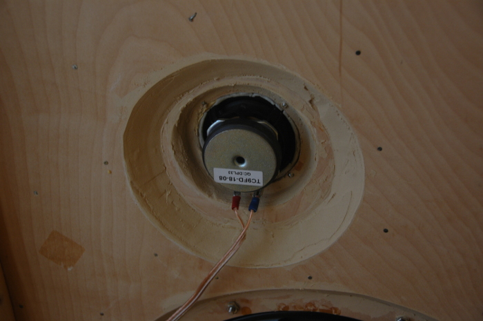

This is an example of clearing out the midrange - literally.
TLDR: Cleared out the space behind the Vifa tweeter and greatly improved the imaging and clarity of the Ultras. Changing the feet helped, too.
John mentioned he's working on some new updates to the Manzi design and it got me thinking about taking on a new project. Yet I'd never quite finished the Ultras properly so it was time to get to work on getting them done.
The front baffles of the Ultra's are made up of two boards and my clunky woodworking had left a couple of 90 degree ridges behind the tweeter and another behind the woofer. Years back I put some duct tape over the ridges near the rear of the tweeters and it helped.
This time I filled in the 90 degree angles with plastic wood. This improved the soundstage and texture in the midrange and removed a slight bass distortion that I'd not really noticed until it wasn't there anymore. Really nice improvements that pushed me to do more.
There was still a 90 degree ridge near the rear of the tweeter. It was close enough to the tweeter to act like a small chamber and it was causing unwanted reflections and likely some congestion. So the ridge was chiseled out and the remaining surface was smoothed with more plastic wood. The small chamber behind the tweeter is completely gone now and there's nothing impeding the back flow of air from the tweeter.
The results are similar to the earlier changes only more so. More spaciousness. Bigger soundstage. Much clearer midrange presentation overall. It literally opened up the mids.
The Ultras now sound good with some laid back tube gear that had always sounded too mellow with them. It's a nice change.
The house has suspended wood floors so the Ultras were never spiked but they did have felt feet. Changed that to some rubber caster cups and was rewarded with even more open sound. It eliminated a bit of bass bloat and that's helped clean up the midrange even more. Will continue to play with other footers as this is all for the better.
The combo of opening up the rear of the Vifa and changing the footers has really done nice job on the sound. John said the Ultras really let you hear the type and quality of the amp in the system yet my Ultras used to sound decent with a cold, sterile sounding amp. After these changes you can clearly hear the poor amp in the chain.
Will likely put off taking on another project for a bit and enjoy the improvements for a while. 😀
