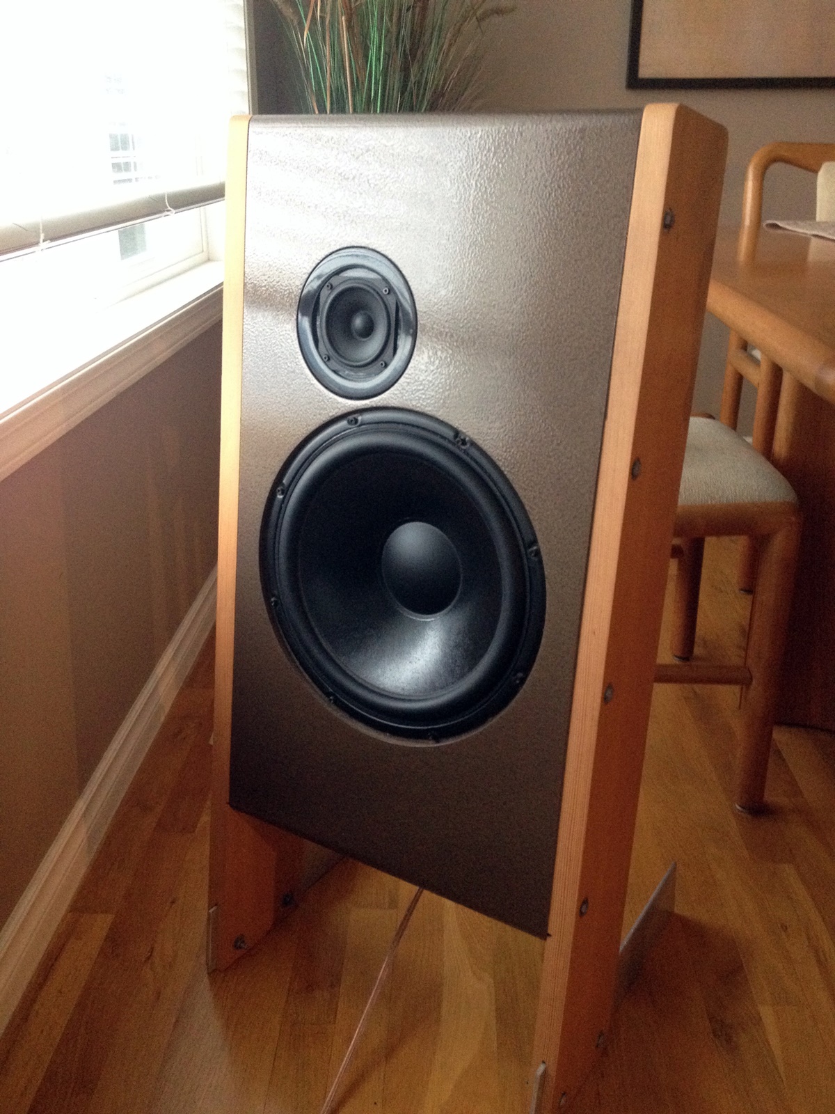

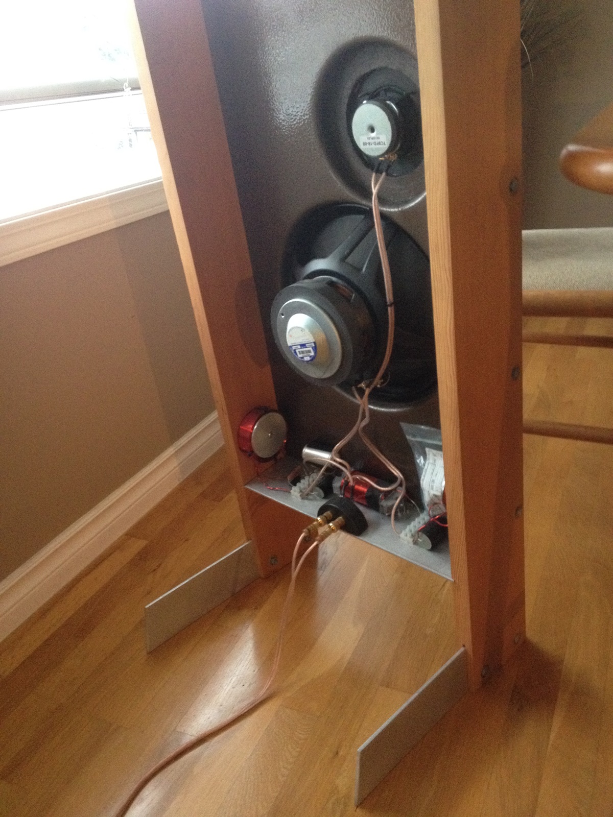

Nice to see the thread is still alive. The pics show (I hope) baffles made from 2' x4' 2" MDF, which I stumbled into at the local building supply store. They required some router work to open the backside, but am happy with the result.
It took about six months for the big drivers to loosen up and methinks its time to tweak the crossover a bit. Wonderful design John.
Thanks for sharing your build experience. And it is good to know you are happy with the speaker. The Manzanita design is a bit of a low cost, simple sleeper that can be quite surprising. Happy New Year! John
