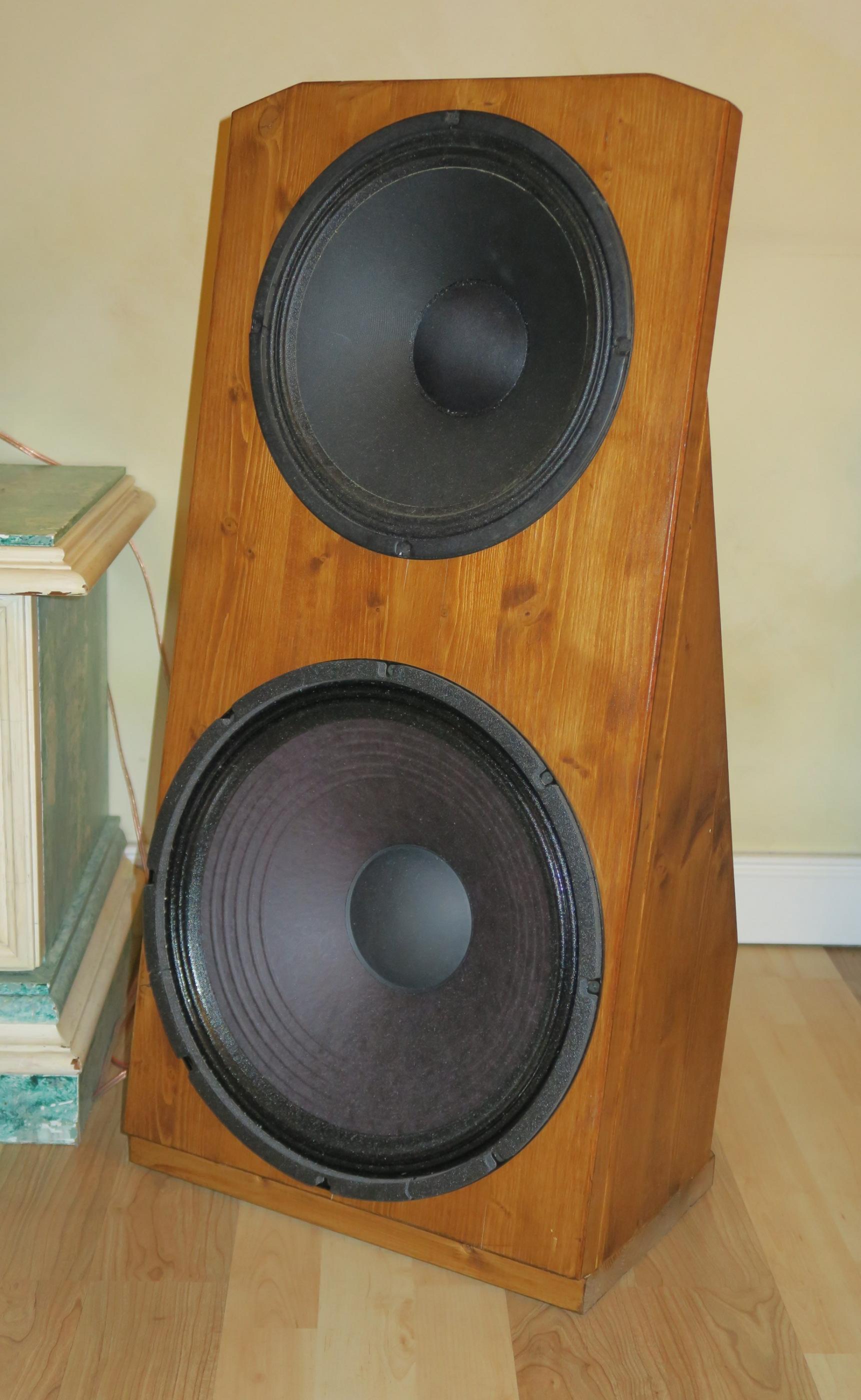

A bit different OB, inspired by Manzanita
Well, inexpensive this is not, but construction is easy.

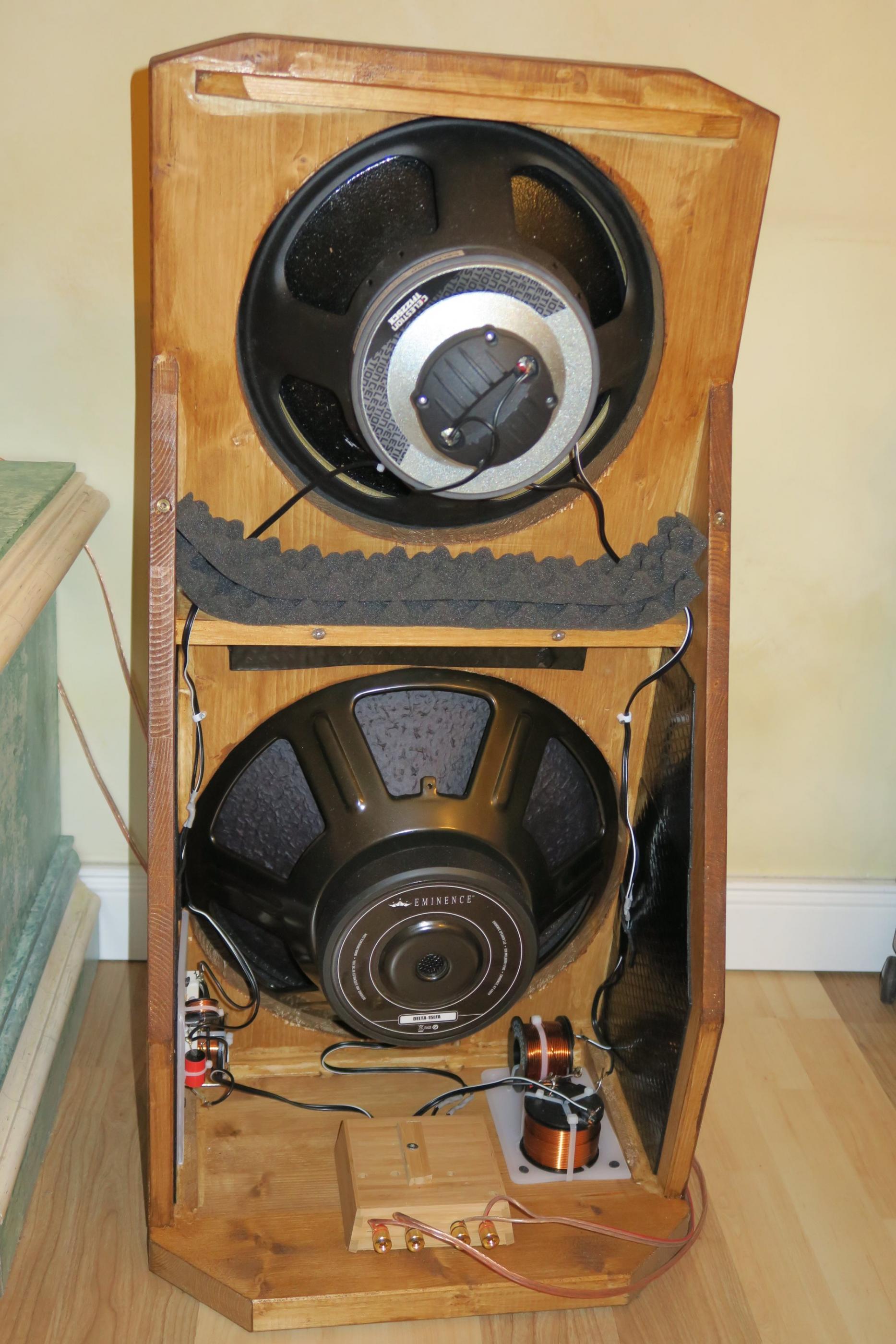

First, I got hands on pair of Celestion TF1225CX coaxials, and was planning to build normal reflex box with them. But, living in small apartment with no woodworking tools available, had to change the design.
So, OB shall it be. Go to Bauhaus and buy 80x40cm (31" x 16") wood panels and a cheap jigsaw. Woofers, Eminence Delta 15LFA.
Xo is a hybrid: between woofer and coaxial done with minidsp 2x4HD, coaxial crossed to CD passively. The passive xo is a design by German magazine Klang&Ton, K+T Celeste was the speaker they designed.
Xo frequencies, woofer to coax: 250Hz, coax CD: 1900Hz.
Then the usual woodworking part... and after several multi-hour measurement & EQ adjustment sessions they start to play really well.
Frequency response is just flat, even within +/- 2.5dB 30Hz-18kHz. But that result is more depended of the placement of microphone and loudspeaker in the room, and how much you filter the FR. With the DSP it is very easy to correct the dipole response, and also room response to some extent.
