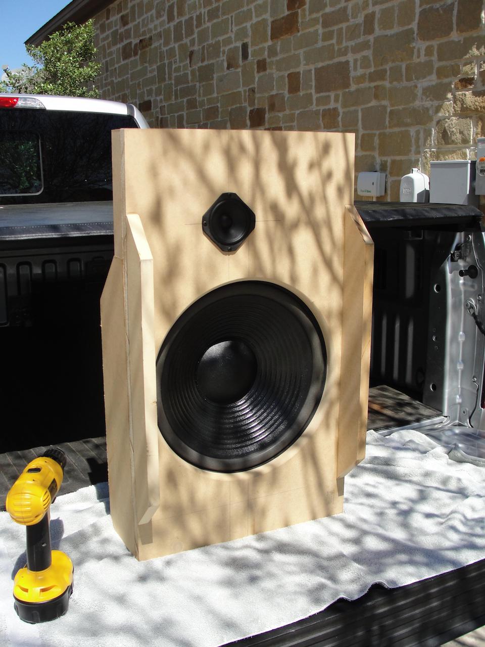

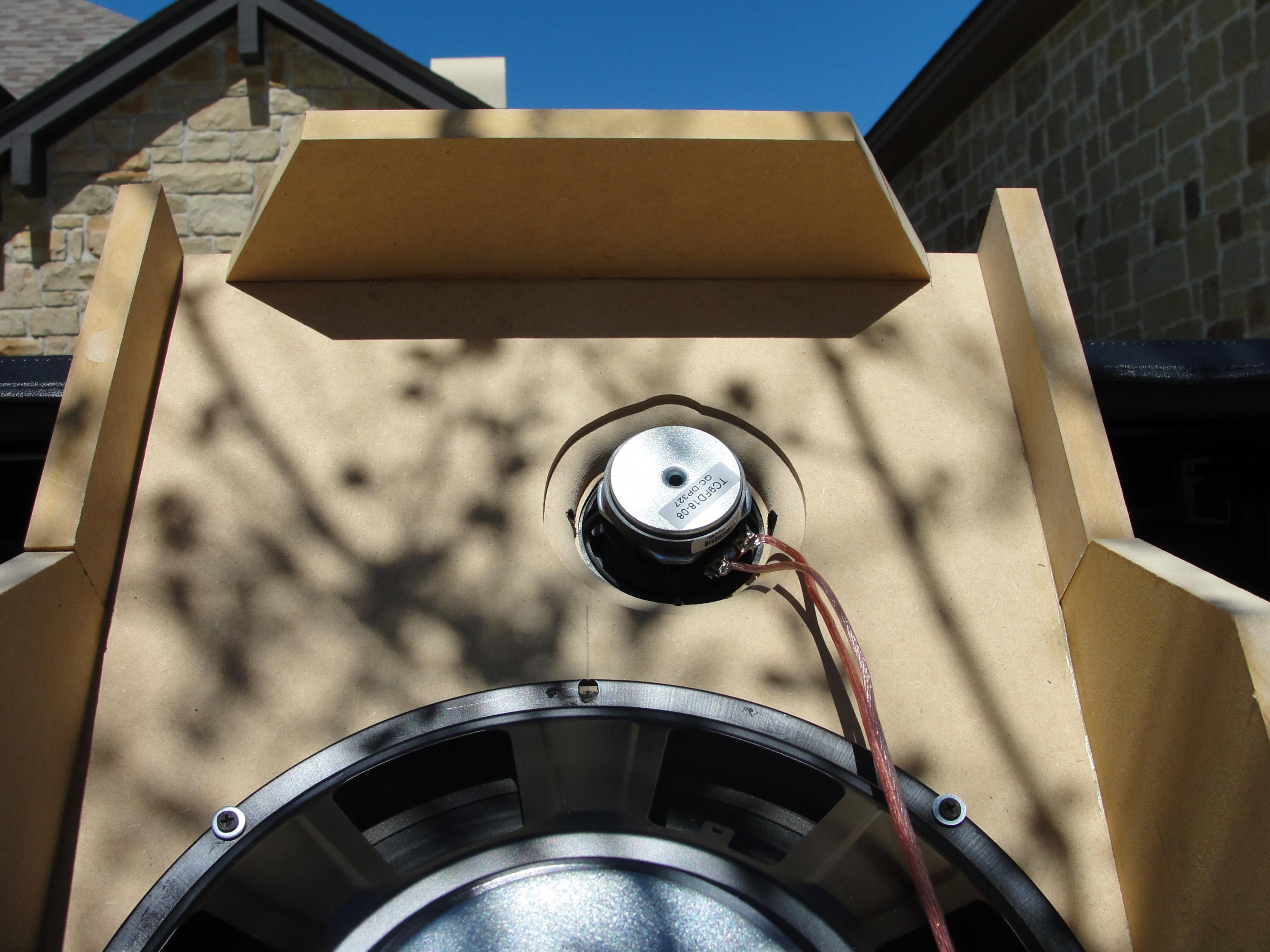

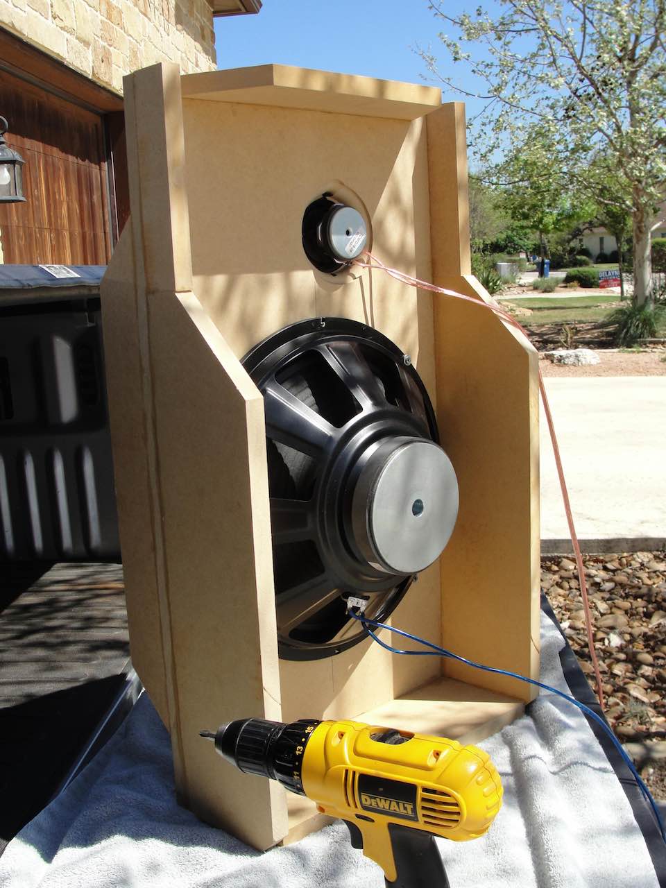

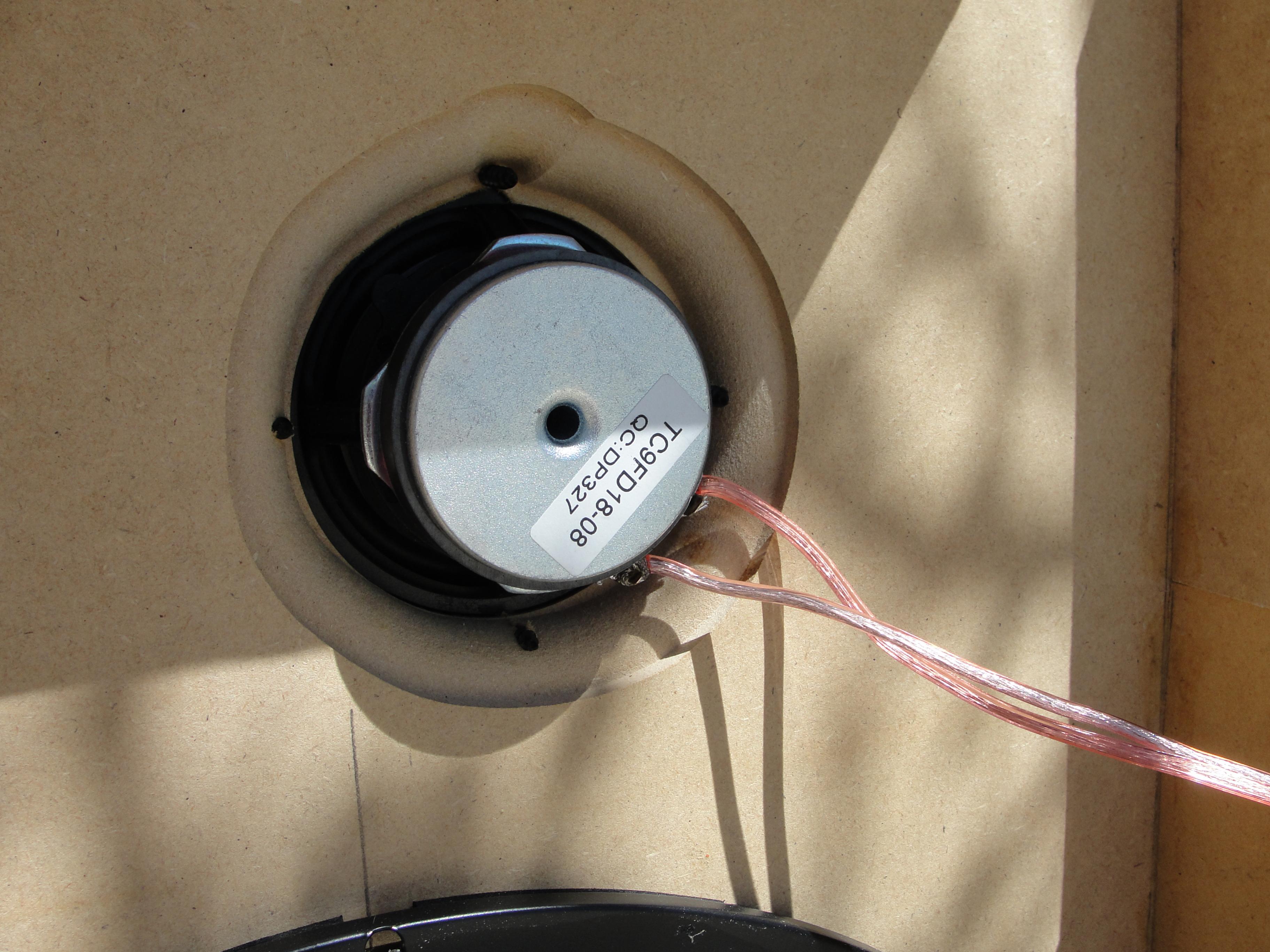

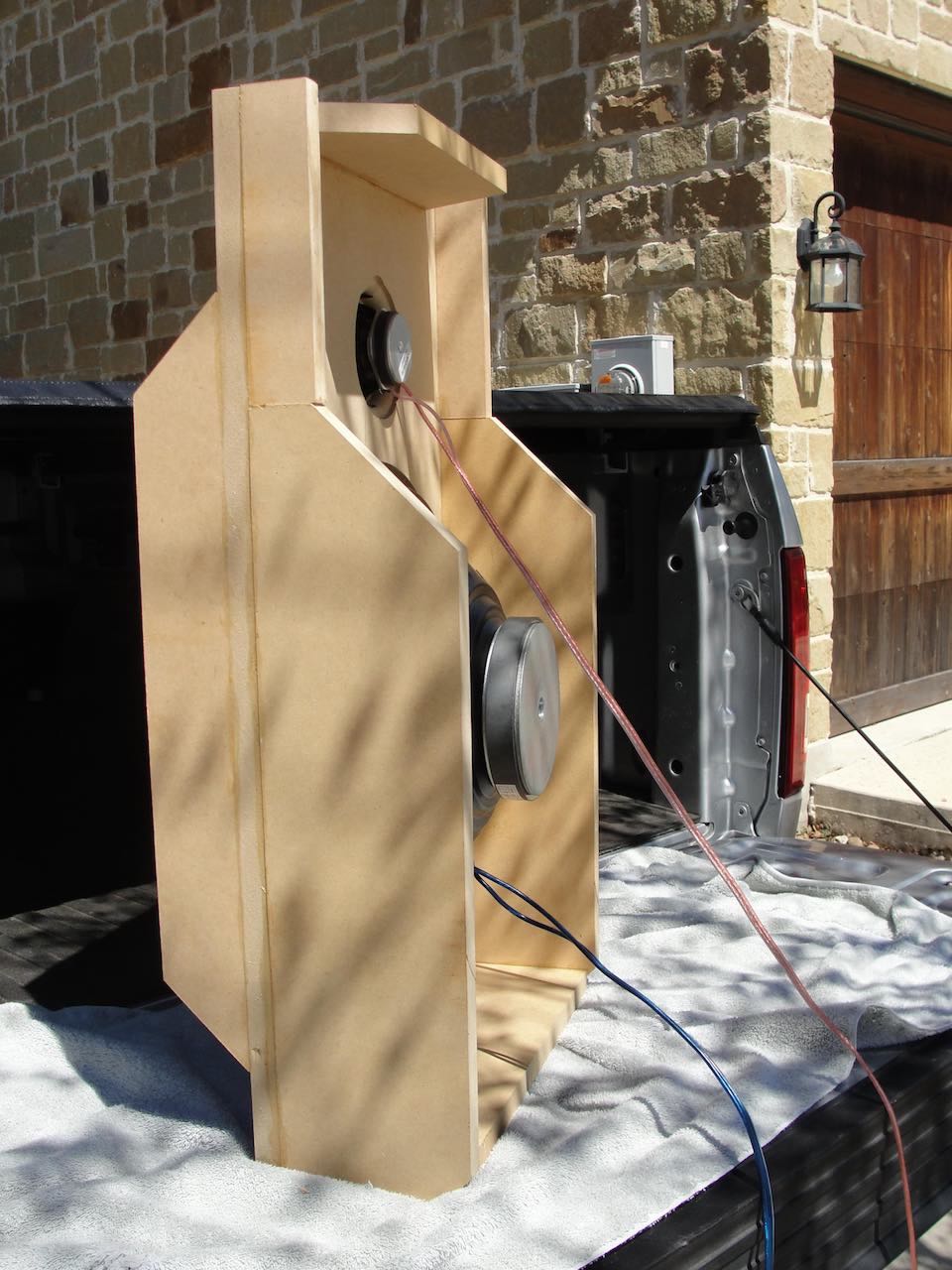

Finally posting some updated Manzanita info
As I indicated in a couple of recent posts, I have been working on some performance enhancements for the Manzanita. Most of the work concerns getting the most out of simple to fabricate wings. And I am still refining them.
After the usual playing around with heavy card board, I built a MDF prototype out of used, oh, I'm sorry, repurposed materials, including the drivers. OK, I'm cheap!
Anyway, here is what it looks like:
OK... Just kidding!
OK... Just kidding!
Ok... back to reality, 2nd attempt
Not so good at posting pictures... thought I had it. Must have pushed the wrong key.
Here goes again. BTW, for some reason the pics are not in proper rotation, as some are on their side. Told you I'm not any good at this. May have to get Pano to fix this for me.
Will comment on each in a separate post.

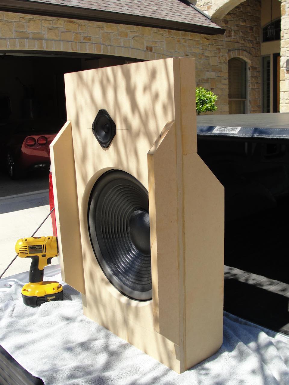

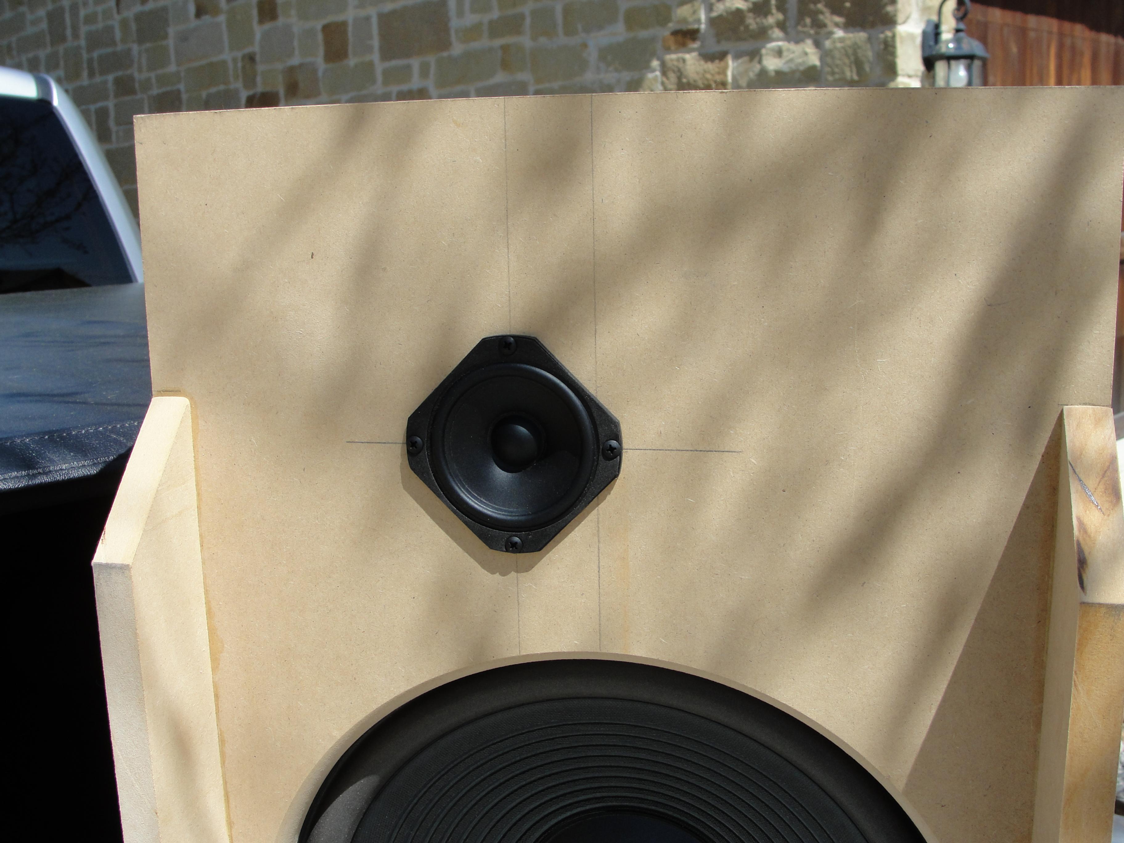

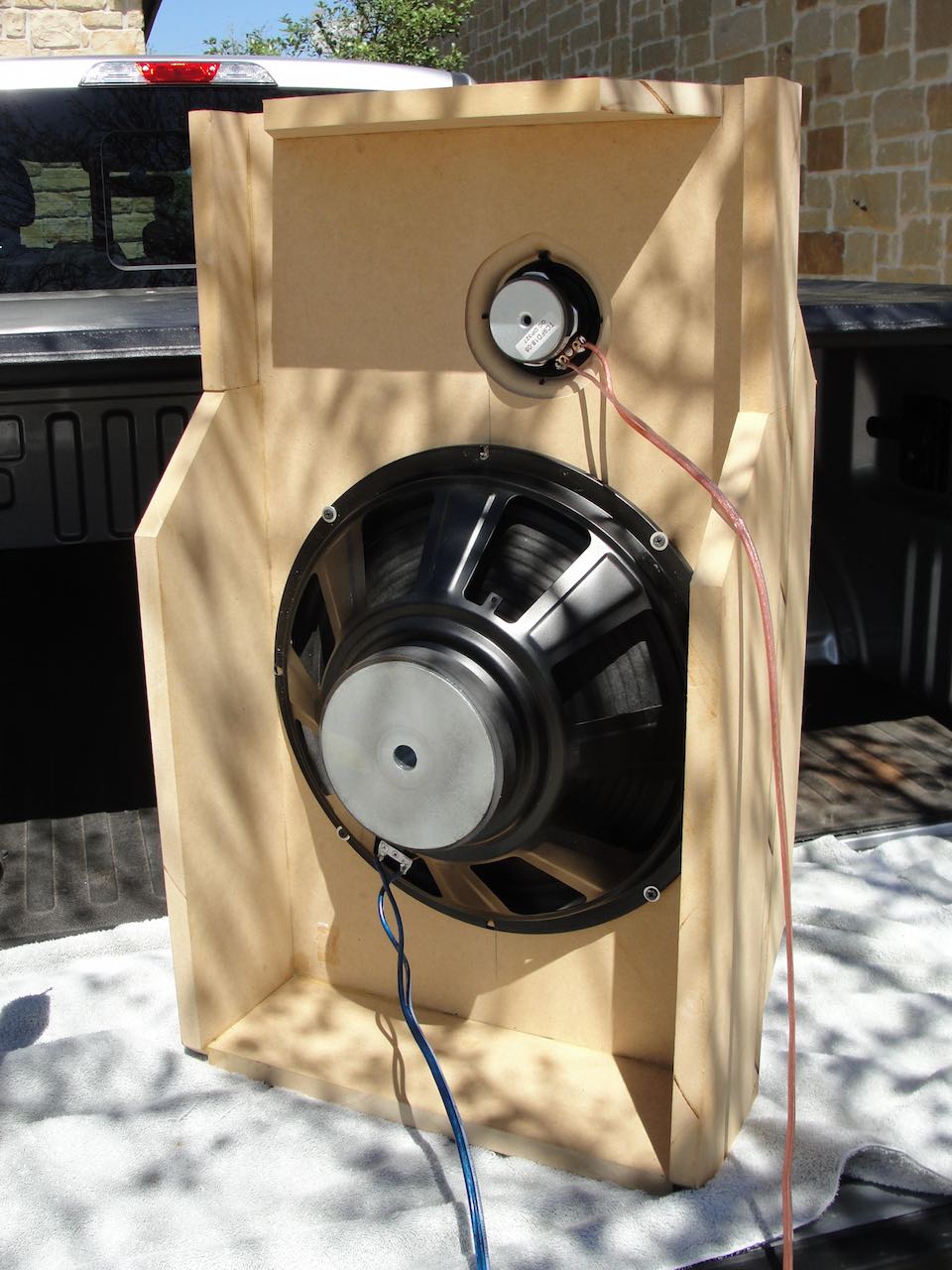

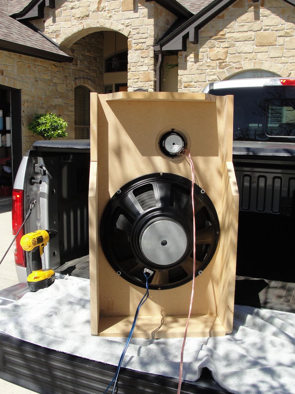

Why more complicated wings?
With the switch to the GRS 15, getting the more out of the wings was of interest to me. The GRS has a much higher QTS' than the Peerless and it's on baffle FS tends to be about 4-5 Hz lower. Both have similar Volume of Displacement (VD) with the Peerless having a slight edge. Free air efficiency of the GFS is about 3 db lower, but the much higher Q requires less equalization below about 60 Hz.
Mounting the GRS on the back side of the baffle adds a bit to the front to rear path length. Adding a 2.5" front wing depth adds a bit more and finally the revised system now has 5" of wing depth behind the baffle plate. All together the path distance has increased from around 12" or so to over 20".
This moves the effective F = from around 180 Hz to around 110 Hz.
The result is a lowering of system low end cut off from 45 - 48 Hz to 37 - 39Hz. And operating efficiency is up about 3 db.
The added front wing and longer - taller rear wing are glued to the main baffle board. This allows them to be fabricated with a simple sabre saw if needed. There is little or no shear load, so glue and clamping is strong enough. This assumes smooth and parallel mount surfaces. A table or circular saw is always a better bet. Still want to keep the system simple enough you could build it on an apartment patio if you had to.
