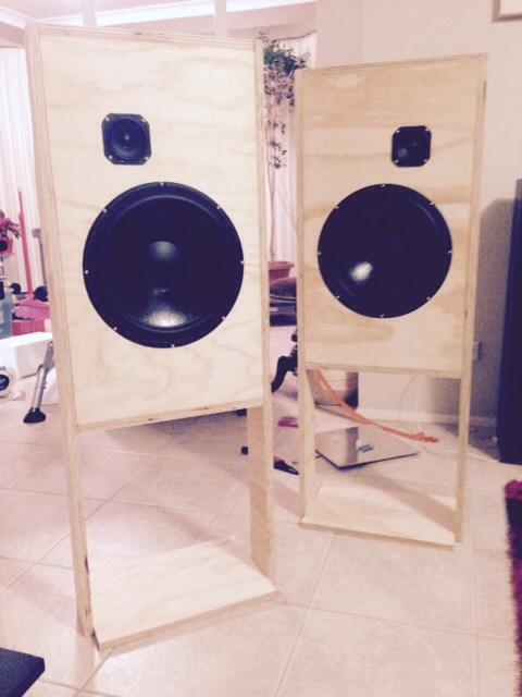

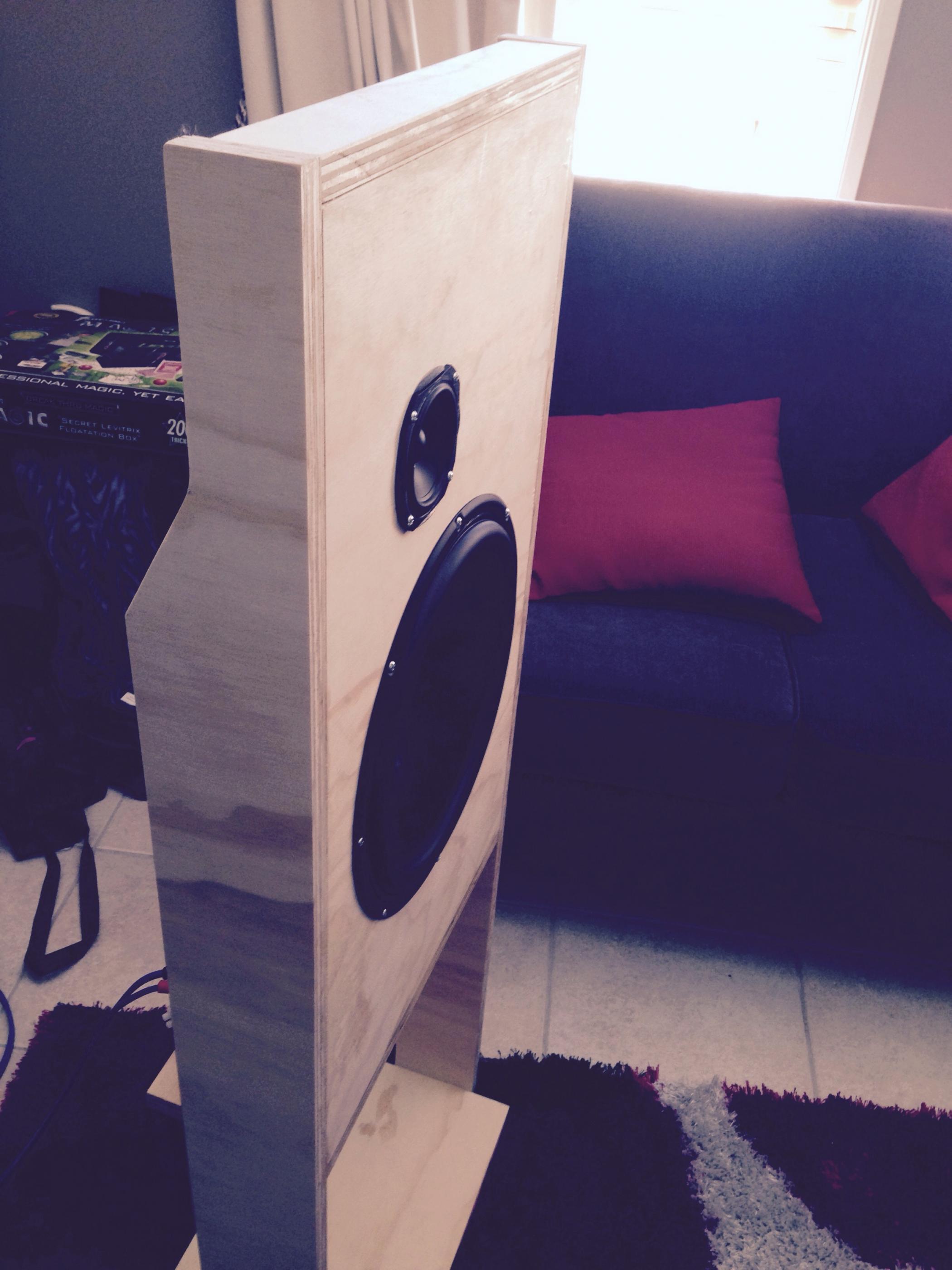

Ok, so I thought I would share my experience to help any other newbies to the diy speaker building caper so they don't repeat my mistake.
I knocked up a set of frames (see attached pics) as a "proof of concept" pair to listen to before going all out on fancy hardwood ply etc. Put them in the main room and hooked them up to my Naim amp and all sounded pretty good, promising. All I needed was a few crossover tweaks to fix the slightly forward mids and pad the vifa back a little to match the Peerless 12.
Shifted to another room to do the work -slightly smaller space (5x7m) and with a more reflective wall behind the speakers. Suddenly the slightly forward mid became much more pronounced with a distinct "cupped" sound around 500-600hz.
Hmm... More work than I thought. Hours later, I'm now at 12.5 ohms for the pad resistor, dialled back the cap to 4mfd to maintain the crossover point, and I'm still not hearing the seamless integration all the other posters were talking about! Time to go to bed.
Up the next day and I decided I've built something wrong. Maybe the narrow wings on the top? Weird phasing effects happening as well. So I started again. Checked all measurements, rewired the crossovers to pad at 7.5, cap at 5.6 listened and thought. Why was there so much energy coming from the vifa?
So I looked at the back. I don't own a router so I'd just filed out some lobes around the driver at around 45degrees or so to let out the rear radiation. Maybe I'd horn-loaded the back?
I carefully folded a couple of t-shirts and draped them down to damp the rear output.
Before I'd even sat down I could hear the difference. Everything now sounded right, really right! I spent around 5years working in the hifi game at the end of the 90's and heard thousands of amp/speaker combos, so I have a fair idea how things should sound, and I can tell you this design gives genuine high-end performance, as long as you build it right!

Thanks so much for telling us about your build! Glad you got the issues sorted out.
And thank you for the photos, they look very nice. John and I had talked about building the stand/legs in that way, but never did. Nice to see you did it.
If you have any photos of the back side of your mids, it might be interesting to see what went wrong there so that others don't make the same mistake.

Sorry Pano. Bought a router and now all evidence of my bodgy woodwork has gone up in a spray of sawdust.
Did do a 20-20khz sweep comparing before and after though, and all the lumpiness in response between 500-1200hz disappeared, as well as a couple of resonant peaks that nicely corresponded to the diameter of the little cup I'd managed to mount the driver in! ��

My driver mounting frame just happened to be the same thickness as the chipboard panels I was using to build my second speaker way back in 1976.
I wanted to make the front flush. So I cut out the hole to fit the driver frame OD and mounted the driver to the front of a second panel glued to the back of the main front panel.
Double thickness front panel and flush fit. No rebate required, which at that time I had no tools nor skills to achieve.

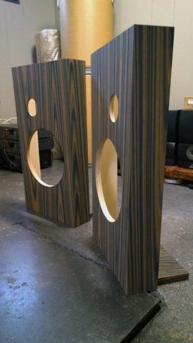

Here is picture about my almost ready baffles. I ordered veneer from Aliexpress (too small amount, not enough for backsides 😡 ) and local carpenter made veneering. Need to do finish for veneer, burn or paint backsides and make digital xo solution / or more familiar passive which i already tried with satisfaction with my test baffles.

Very nice looking baffles! Thanks for the photo.
