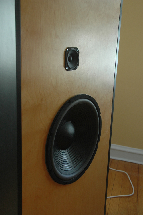

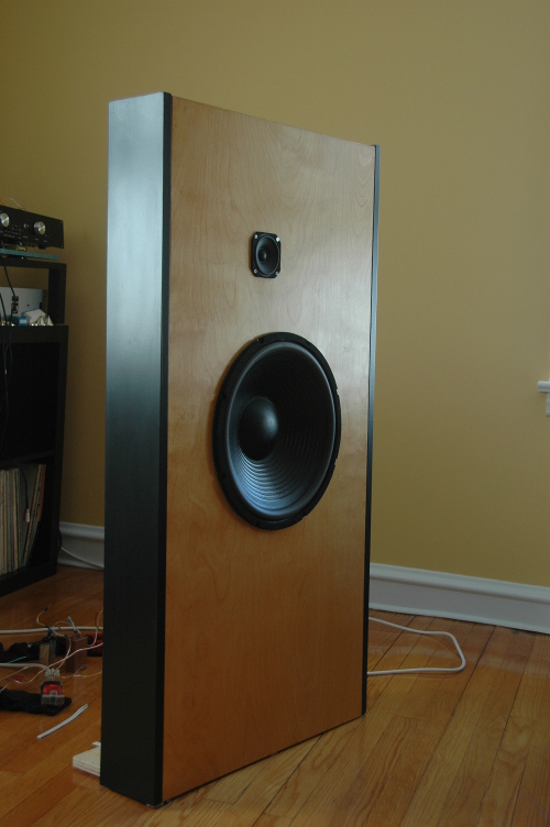

My Ultras look very good from about 5 or 10 feet but not from any closer. Such is the quality of my woodworking.
But a few weeks back the sun was hitting them just right and they looked *good*. So the camera came out and some photos were taken.
They don't really look this good in real life but the lighting really highlights their strong points and cleans them up.
No photos of the back of the baffles. They haven't been done yet.

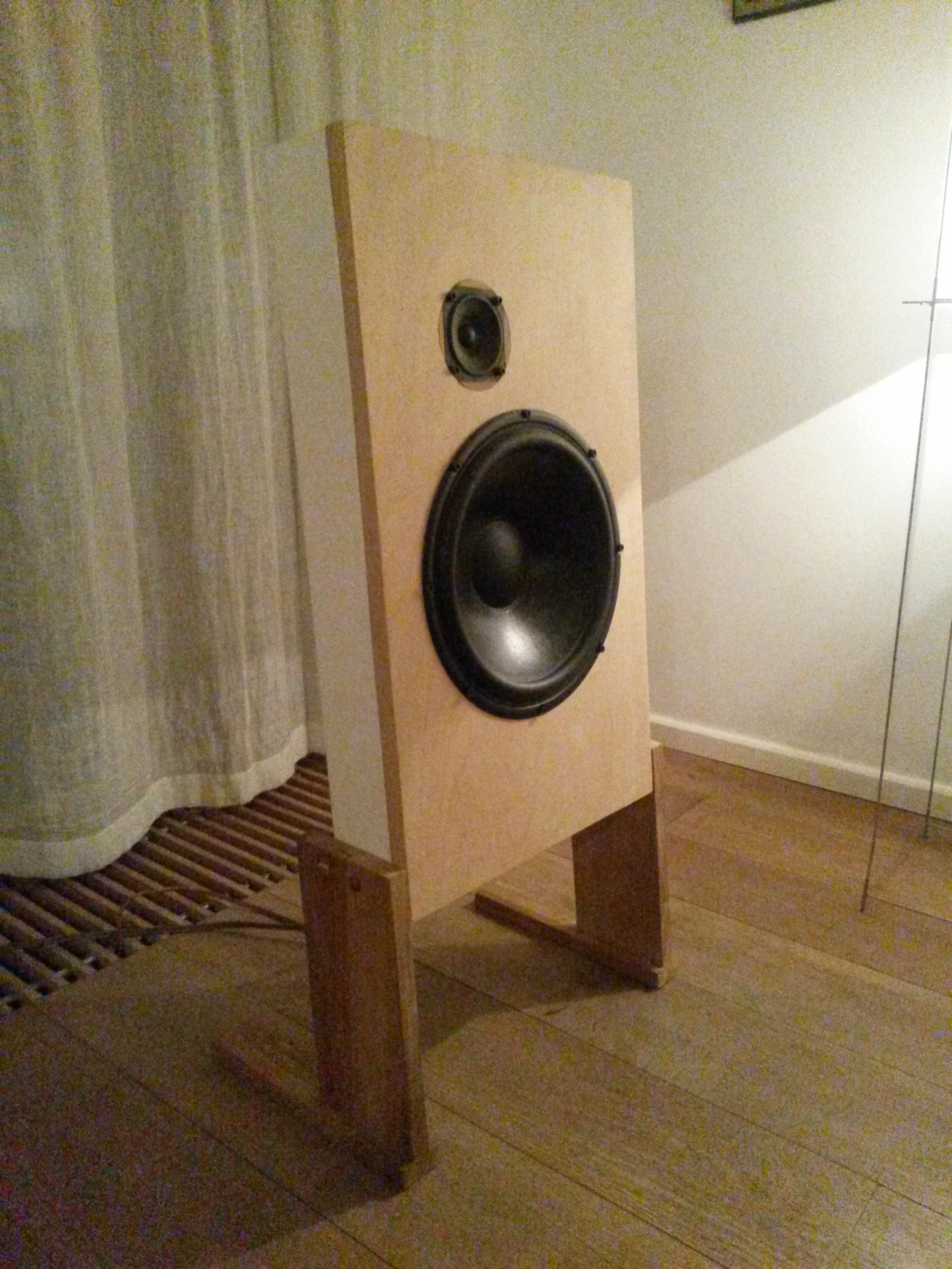

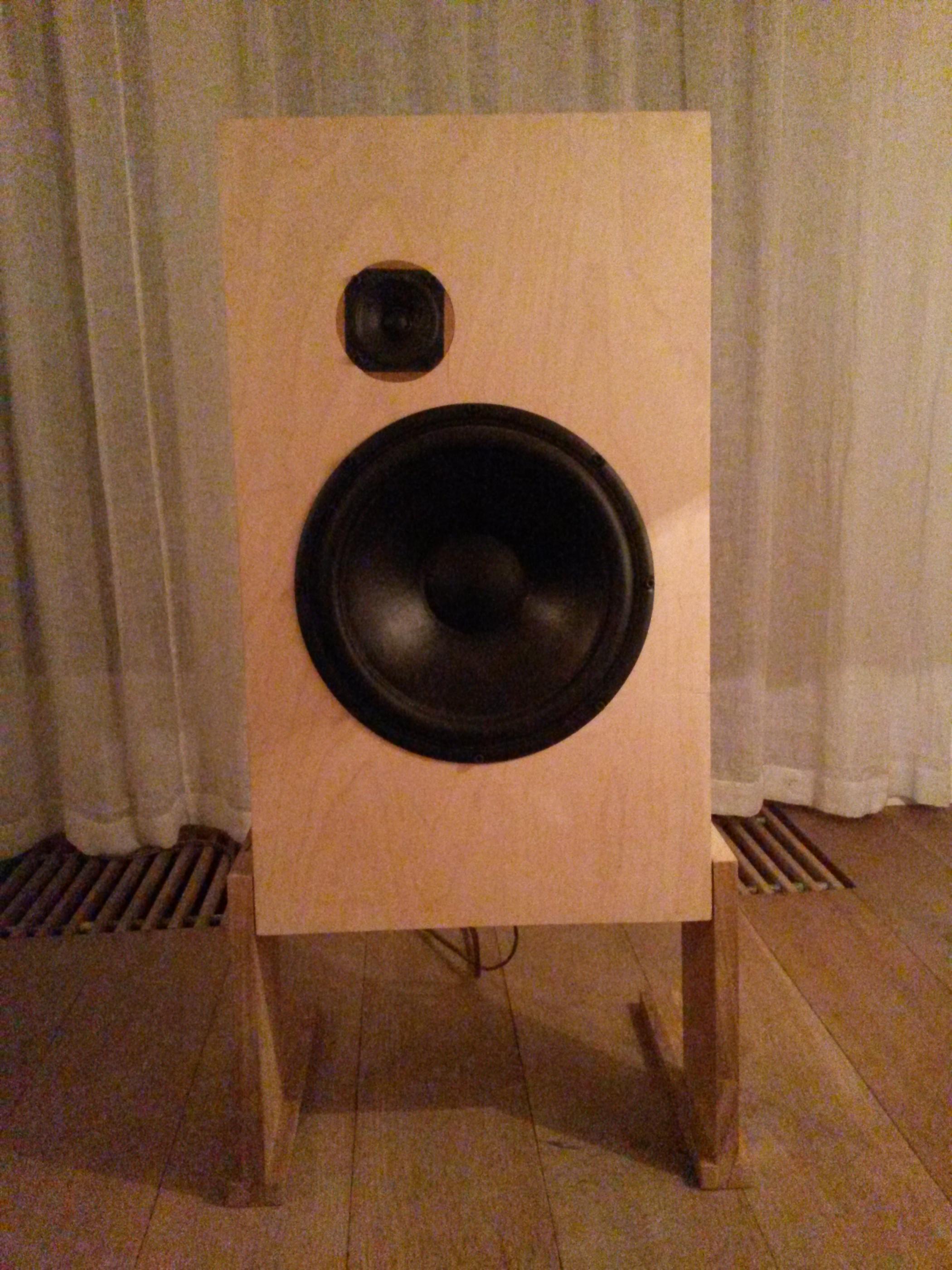

After asking some questions on this forum and thinking about it for a long log time of building a pair of Amzanita's, I've finally bit the bullet! A trip to Ikea provided me some nice kitchen cabinet doors in the correct size.
I know the Manzanita's were never intended as floorstanders, but I'm stubborn... The pieces of wood were higher than needed, so I figured it should compensate for some of the influence by the floor etc. Next to that, the Vifa's were a little too low for ear level, so I inclined the panels a bit.
I only just have the proto's finished, but already I'm so heavily impressed that I just wanted to share it with you all!
First some pictures (bit crappy, taken in the dark with my old Iphone):

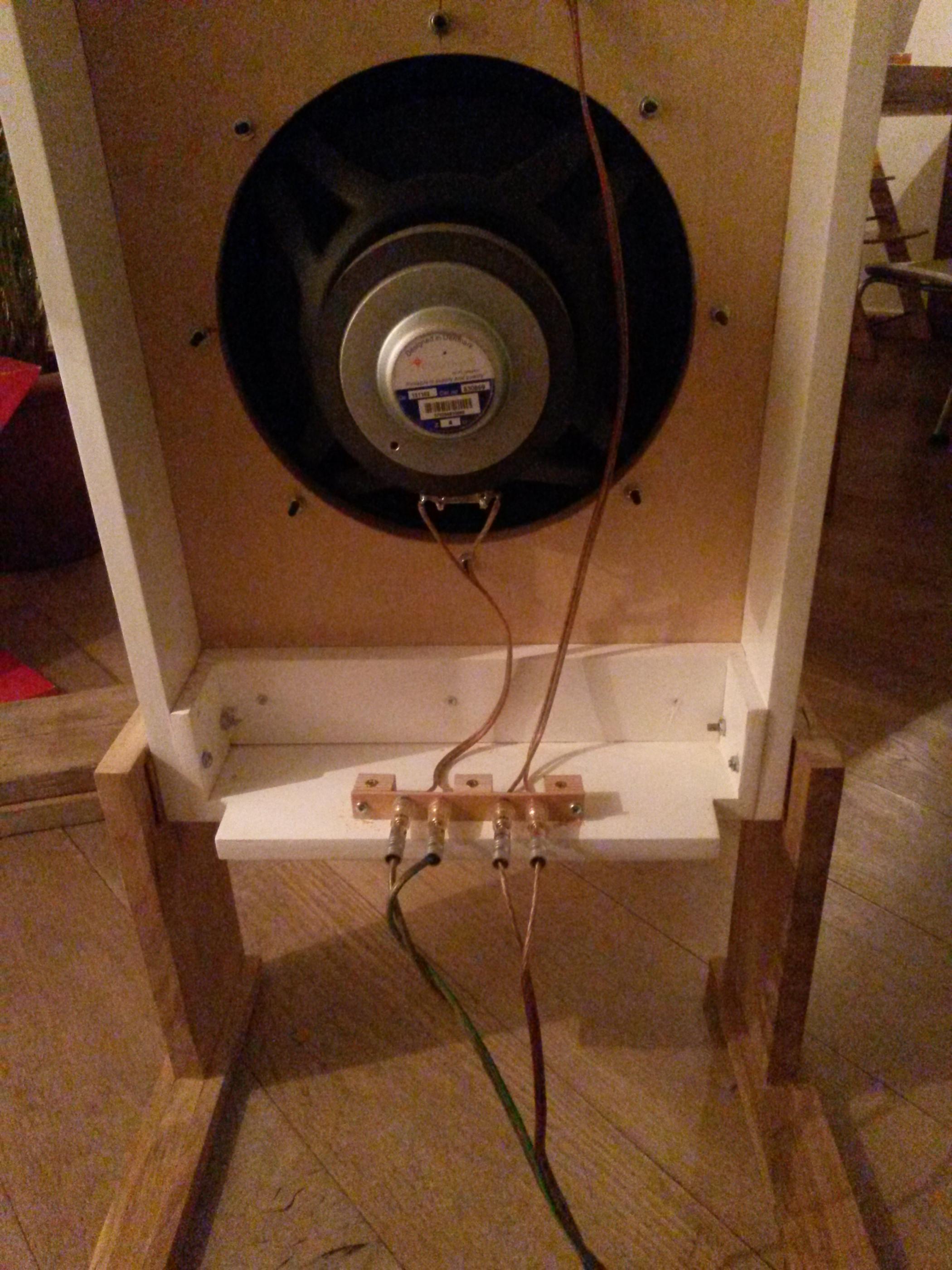

I thought the filters might need to be tweaked quite some bit, so made a very temporary one:
I know that I really should add the side panels, but just couldn't resist the temptation to hook them up...
AMAZING!!!! The sound is incredible! Despite being only hooked up to a 15 watts tube amp, they produce the sound with so much ease! Completely relaxed, me being able to listen to them for hours... Most interestingly, some songs I never really found interesting now sometimes bring something totally new and I can listen to them over and over again, without getting bored.
Even without the side plates, bass response already is quite amazing. Then again, in the first pictures, you might just see the Onken with MarkAudio Alpair 7 gen1, which is my reference.
There´s more to come regarding the design, once I´ve found the correct shapes for the side panels. Also, the one single alloy bar for the rear support will be changed in design on a lathe.
Bottom line, I think is: The Manzanitta is a great design and with Ikea offering cheap, good looking panels, it's quite easy to make great sounding speakers!

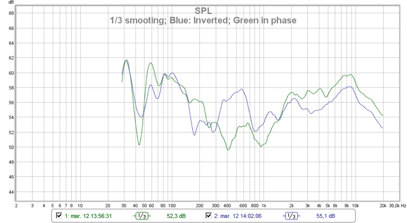

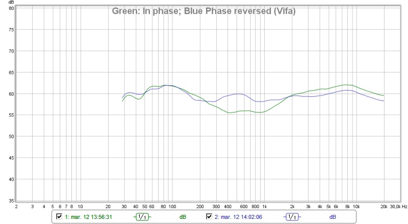

For a long time I was dissatisfied with what I felt was a huge “hammock” between 200 Hz and 2kHz . In actual fact I spent quite a lot of time trying to get rid of it to no avail – until I reread a large part of the thread and saw the two comments summarized above. I also did some measurements.
The first chart is smoothed 1/1 – and the “hammock” is quite visible – and so is the lack of it after the phase reversal. This does not point to “subtle” changes, though – rather the contrary. But the other chart showing the same measurements smoothed 1/3 octave could very well be interpreted as showing subtle changes. However, the sound of the phase reversed speaker is much more pleasing to my ears – in my room. And it seems that the cross over slopes are indeed 2nd order. And that usually calls for phase reversal of one of the units if the aim is flat summation.
A note on the measurements: They were taken in my room some 1.2 metres from one speaker placed in the centre of the room. The garbage at the frequency extremes is due to the measurement equipment. Also note that I was only interested in the cross over region – the differences in the high frequency response may be due to slight changes in the set up. (It was way too cold to do it outside!)
And now we are at it: During these test I have drives the speakers with an Almarro 318b - no problem! But the best combination seems to be the venerable old Quad 303!
