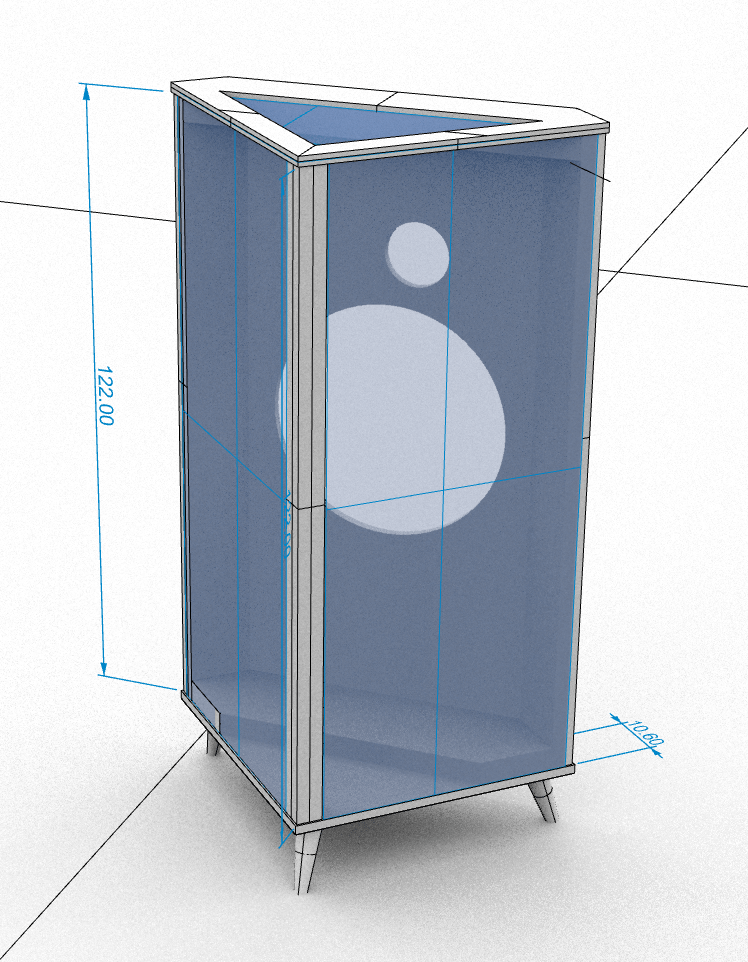

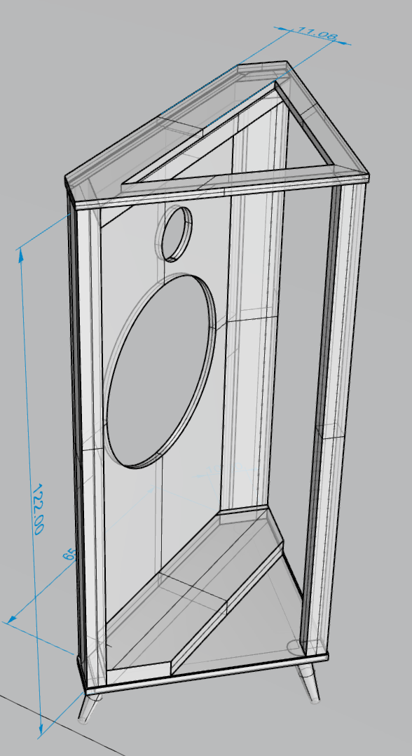

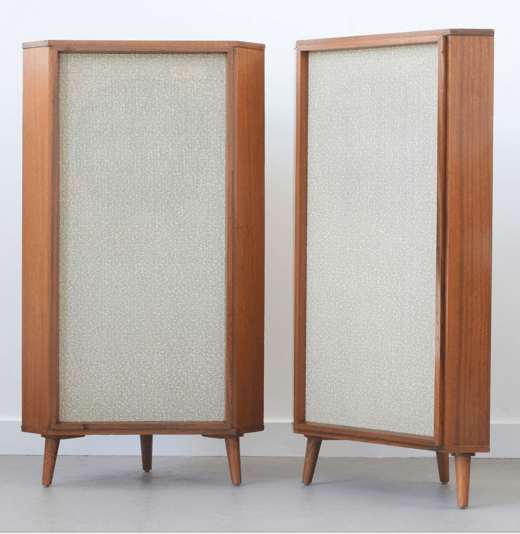

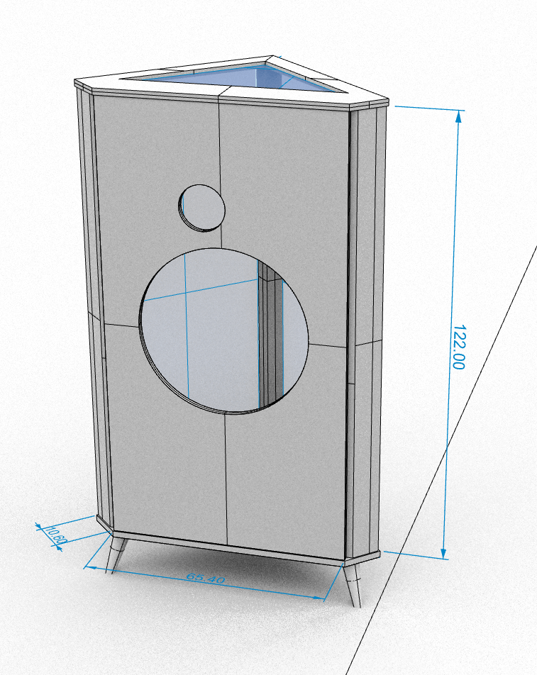

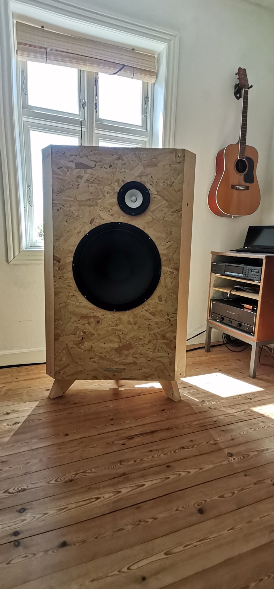

I've been toying with the idea of making a version of the ultras with the style of vintage loudspeakers like the Grundig or these Tannoy I have attached here as the last image. I'm of course not making a closed box, I'm instead covering the back in fabric. The blue is the fabric.
Is the 11 cm in the top of my proposed model going to be a problem?
And how about lifting it from the floor?
Those are very nice looking, I wish that I had done that. 👍
The top triangle will not be a problem. And it looks like you have some wings, right? You do want get it off the floor for proper low mid balance.
It’s good to experiment, but know that if you change the baffle shape or size, you’ll need to adjust the crossover. Usually that will be the resistors on the tweeter, but if you change a lot, other crossover parts will shift.
Thanks for posting that. You have taken the Manzanita concept and adapted it to other drivers. Nice to see. The basic Manzanita is a good platform and place to start if you want to explore and experiment with OB.Just for fun I did a mock up version of the Manzanita with a Kawai 30P09 ex-organ driver (Qts 1.4) and an unknown to me 3" full ranger
Thanks. You could still do it you know 😀
I was worried about the top actually being a horizontal wing.
The wings are just not in 90 degree angle, but 135, but they are the same length.
I did not know that lifting it would improve the middle.
The baffle size is the same. Is there some rules to how things will shift?

There are rules, and Martin King explains them well and has (or had) software for it. All of the baffle sim software I have is 2 dimensional making it hard to simulate wings.

The Manzanita should be approximately 24-40cm off the floor, about standard speaker stand height. Or get the tweeter near ear level when you are seated.

I can just say that not running the FR out of phase sounds horrible. I had forgotten that.
Also, having a structure blocking the top of the baffle is not a good thing.
What is it that happens when the wings are cut down around the FR driver?

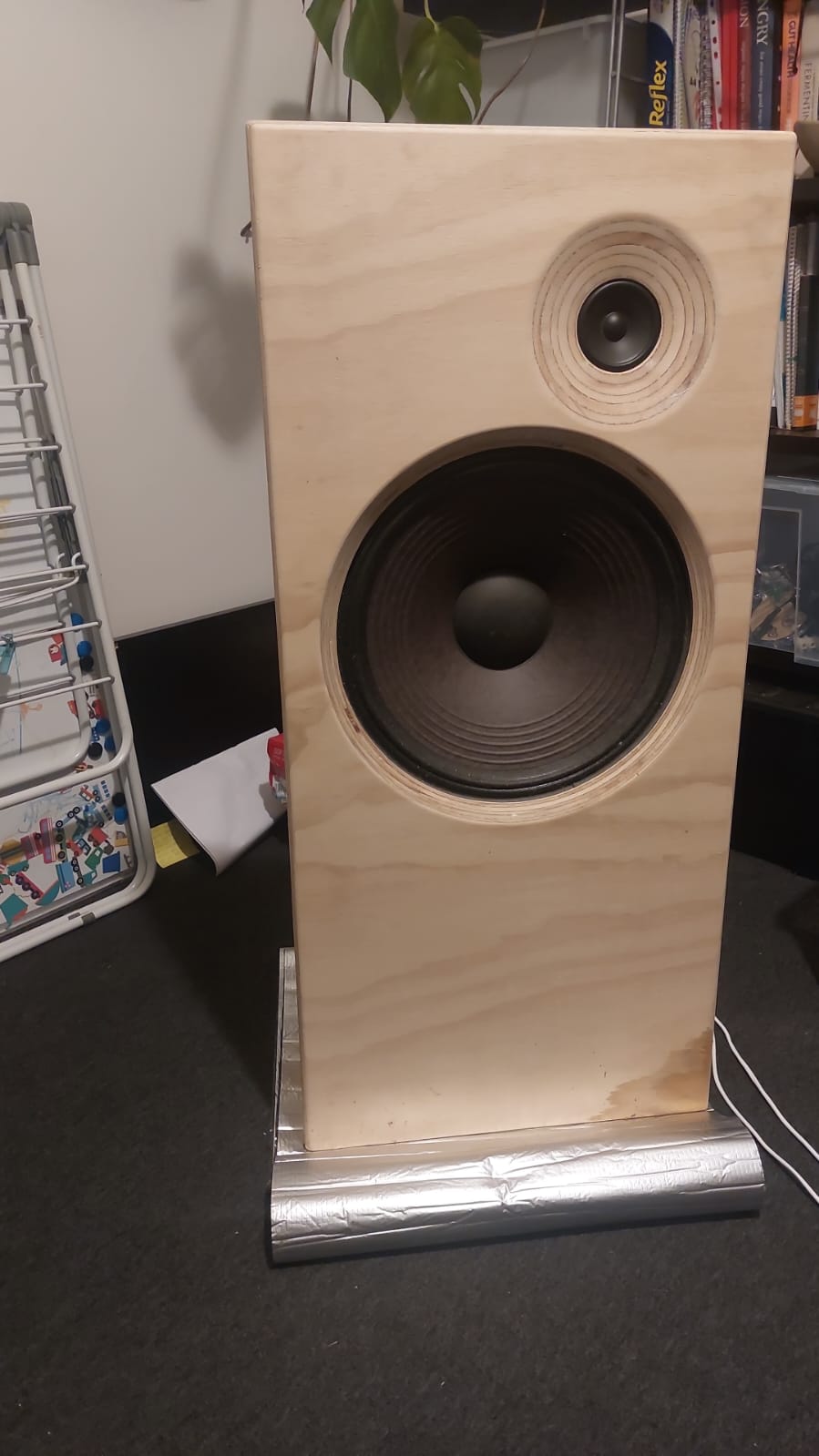

Just got my Frankenstein Manzi's up and running and all I can say is many thanks to John & Pano.
If you have some similar parts and might be hesitating, don't!
The design is extremely flexible as stated. Using Eminence Delta 15 LFA with the TC9f because I had them from other projects.

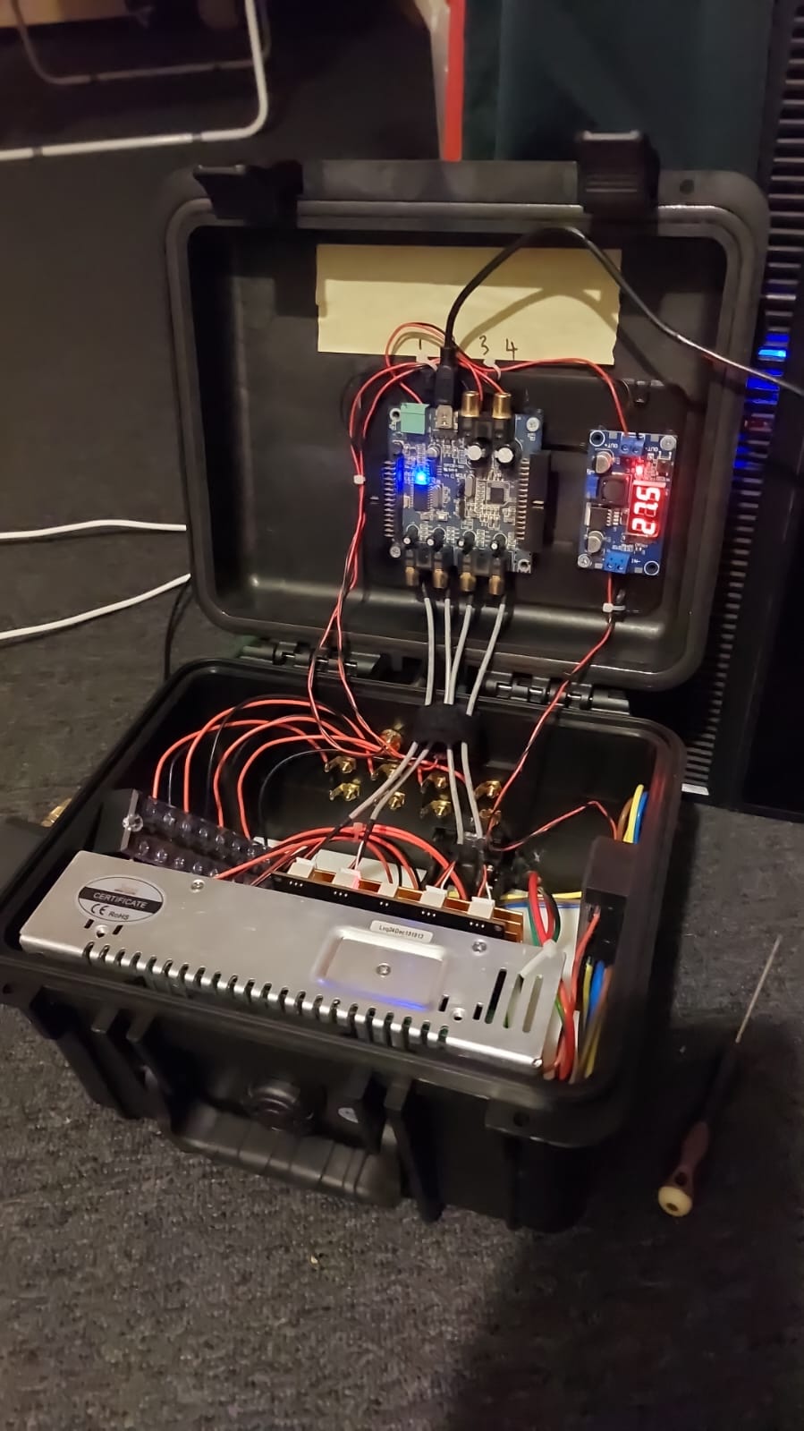

v2 of my Lunchbox Amp is MiniDSP 2x4 v1.5 (2010) with 4ch x TPA3255. Nothing between the amp and the drivers for now.
For the record, Pano's recommendation of DSP set at 70hz (70 to 110 works) 6dB LP & 750hz 6dB HP works a treat.
Don't forget to change the phase of the TC9f and add attenuation - 3dB & -3dB@1000hz (900 to 1200hz) High Shelf to suit.
Also added 0.28ms delay (0.096m) on the TC9f to align the approx voice coil offset, you will hear it.
Before I get roasted, I operate a CNC and I cut plain old circles all day long, I couldn't help but add a teeny weeny waveguide just for fun. Just remember this is v1... And yes, I extended the baffle all the way to the floor, it sounds amazing but I will try the proper short version... did I mention I have excessive amounts of plywood offcuts to play with?

Ha ha! When I read "Frankenstein" at the top and then scrolled down to the photo - well I was expecting something a little more monsterish. What you have is a sort of Utra-2 Manzi. Shows what you can do will skills, tools and experience.
Glad to hear that the DSP is working out for you as the values I gave are best estimates based on the passive. You might try a ~0.25 Ohm resistor in series with the woofer to imitate the Q change that comes from the big inductor's DCR. A 10 or 15 watt will do, as it will dissipate only about 3% of the total power.
John liked the Eminence Delta drivers and had done some projects with them, including a Manzanita version, IIRC. Don't hesitate to much around with the crossover, as you have a rather different woofer and the tweeter in a waveguide - along with the big baffle. That's going to changes efficiencies, as you have already seen.

Yah i wanted to be clear that i had knowingly defiled the Manzi but ment no disrespect so FrankenManzi seems appropriate.
The upper baffle and drivers offsets all measure as normal, just the lower baffle is extended and both drivers are rear mounted.
The waveguide is simply a constant path from the initial tc9f surround outer to 5mm away from where the woofer fillet starts, through the 18mm ply.
The next plan is to double the baffle thickness to 36mm (2x18), this will look essentially the same from the front, using hardwood ply and possibly experiment with wing depth.
Before that i will break out the mic and get some measurments to see what effect the waveguide has on the tc9f and experiment with the crossover once i know more.
I am ordering the 0.25Ohm resistors as we speak and will update.
