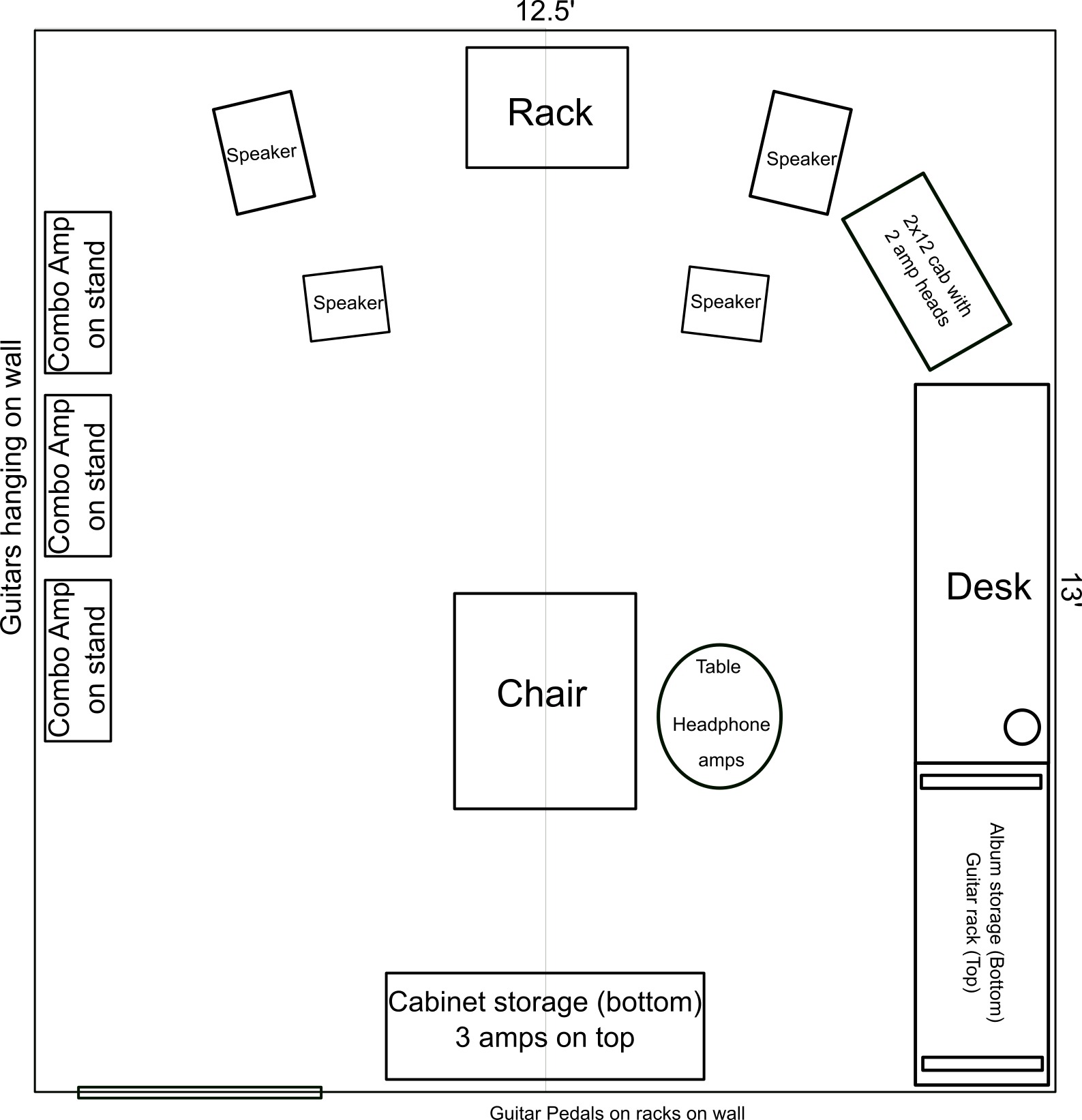

Small room at 12.5' wide and the max spacing I could possibly do with the Manzi's is 5.5'. 3 feet from the front wall leaves me with about a 6 foot listening distance to my ears. The 15" looks HUGE 6' from your head.
Here's a kind of perspective of what it'd look like. It actually looks bigger in the room.
Some would ask why the Manzi looking huge matters at all if it sounds great?

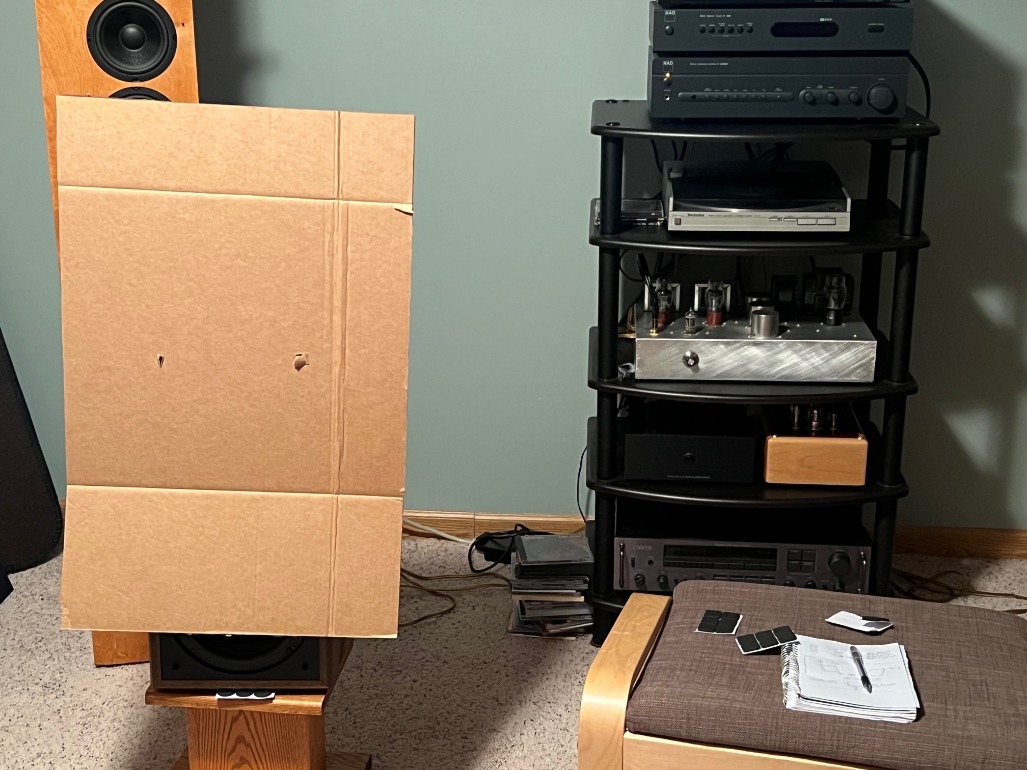

It's the baffles yes, but the driver itself is rather imposing at a close distance. Makes it uncomfortable to sit close to it visually. I'm not the only one on the forum and elsewhere that has made that comment. My wife listens as well and even she said it was going to be a bit much at such a close distance. The fact that I'm lazy I don't want to have to mark the floor and shuffle speakers around if I want to listen. By the time I do that I've lost interest.
I made some cardboard cutouts to see what might "feel" right in the room and about 15" x 48" or so would be a max good size assuming the speaker is sitting on the floor and I could get it withing 2' of the front wall. Part of the Manzi's feeling large is the fact that they are on stands and nearfield. I know they sound good as I've heard them many times over the years, but there is something to say about aesthetics in the room and right now I'm trying to get rid off all my old crappy audio gear to rework the system (which is why it's a mess in there). The guitar stuff stays though. I'd rather lose the hifi than the guitar rigs. I love the OB sound, but I may have to go with a smaller OB/hybrid to make this work. I'm quite torn as I'd like to have a pair of Manzi's.
