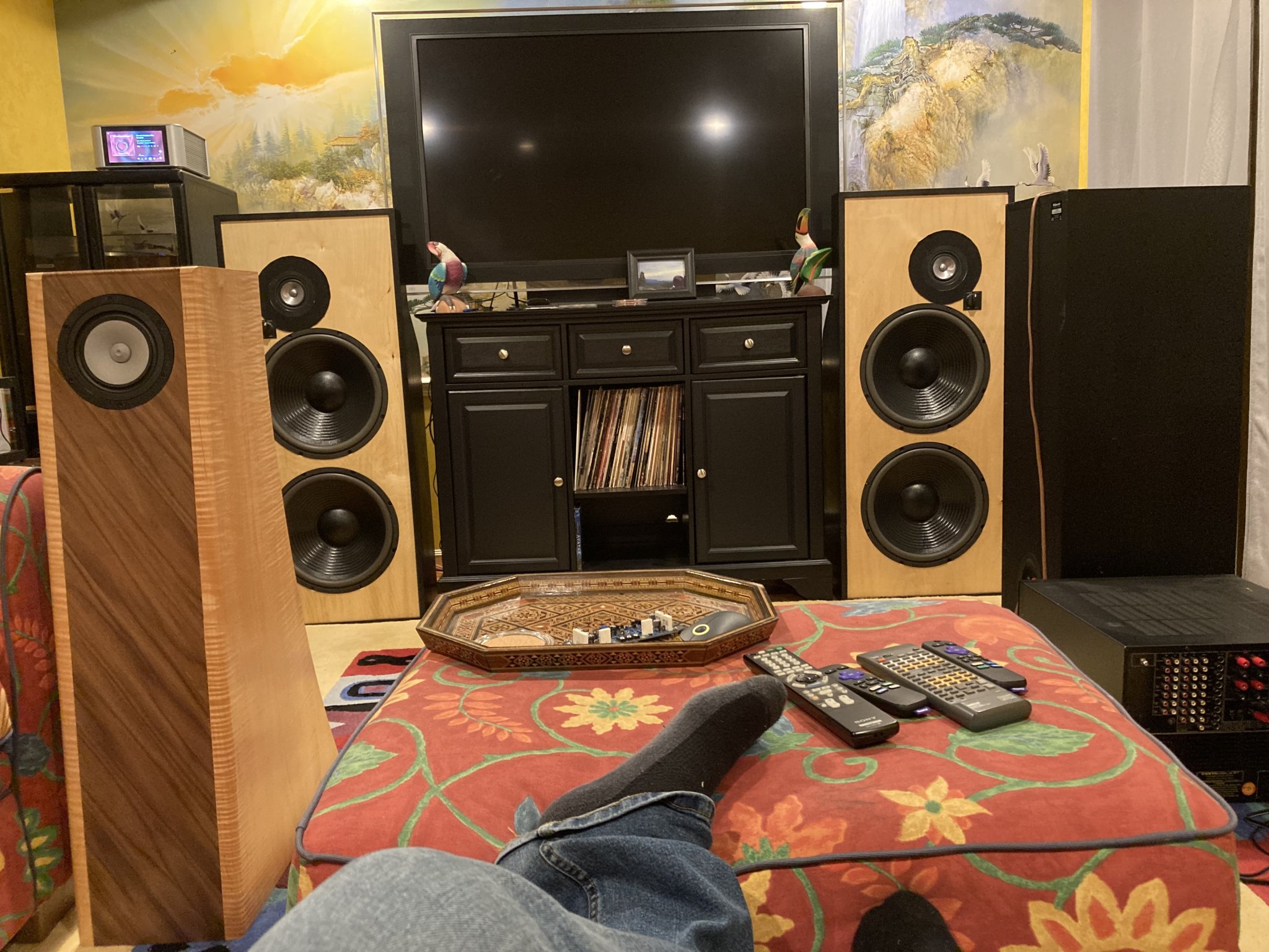

I’ve had a set of Pi speakers. First I ever built. Gave them to my brother as the ART arrays sounded better. Wayne and I have talked a lot over the years though. I even helped him do the LSAF when it first moved to Dallas.
I can pull speakers out a ways. I wonder if something like the little Nola’s and subs would work better? Or a smaller BR cabinet with OB up top?
Like I said, I still haven't made up my mind.

It's hard to decide. The 2 pi towers sound different than the 4 pi speakers which sound different from the original stand mounted Manzi which sounds different from the floor standing Ultra. All of which sound different than all of the other speakers that have gone through this place. Totally different presentations and I'm kinda fond of all of them.Like I said, I still haven't made up my mind.

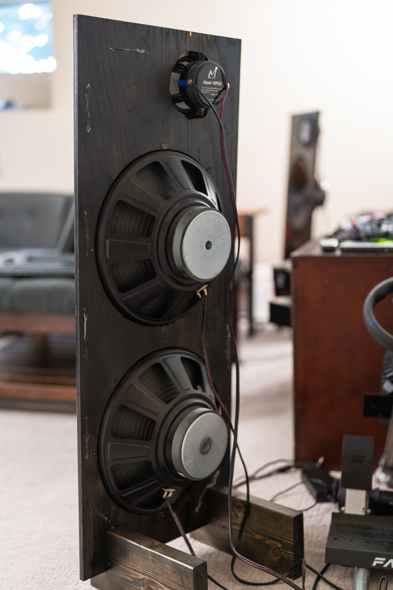

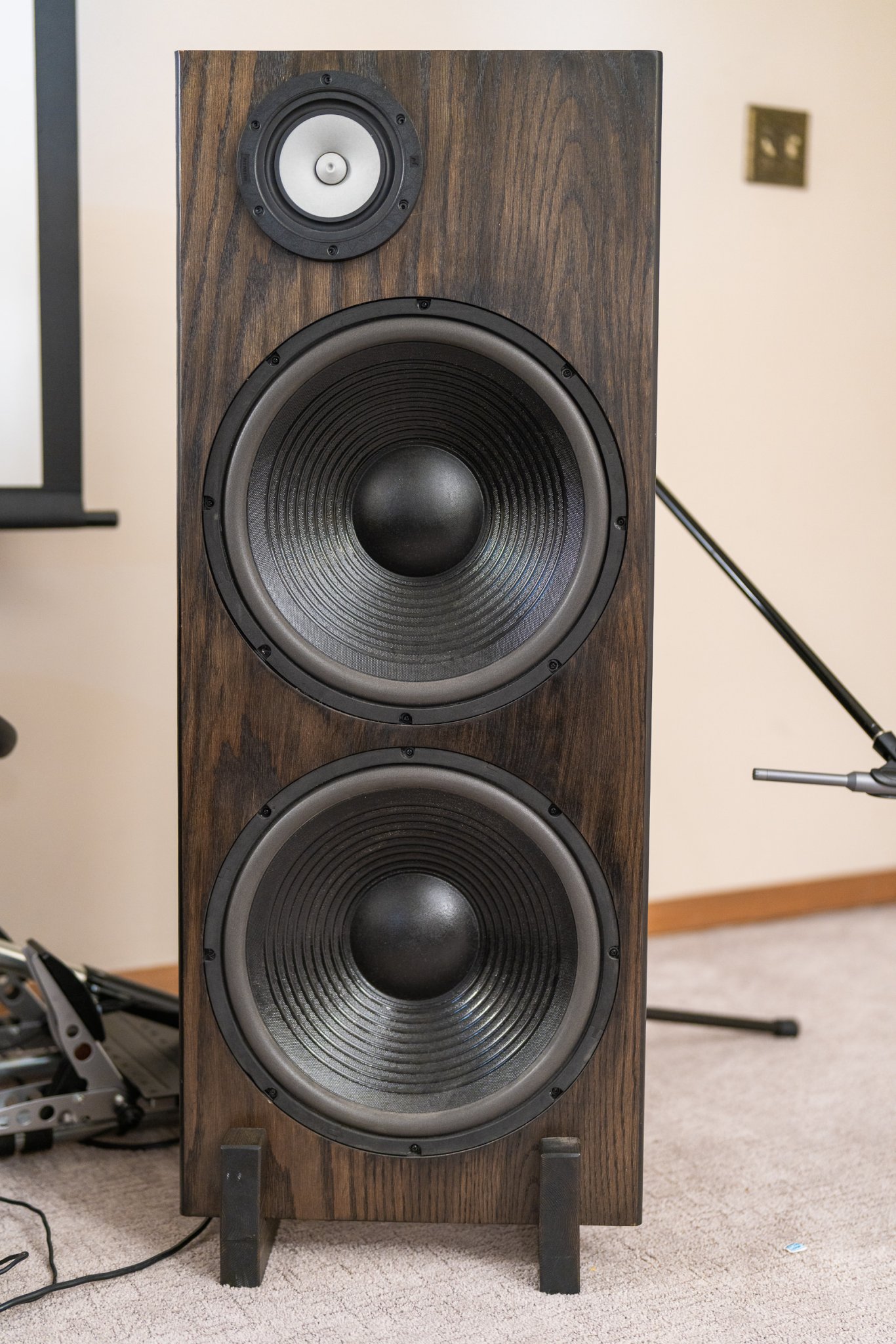

Hey folks! I've gone through a couple of iterations on this speaker starting with two GRS 15"s with Kef q100 coaxial driver and then to Alpair full range driver to do upper range duties.
It's always been partly active with a mini DSP crossing the woofers to the upper range but I had a passive XO when using the q100's to cross the midrange to the tweeter. I have the ability to try this again fully active if I want.
I felt I was missing some spaciousness with the q100 up top and attributed it to possibly not being fully open baffle (closed-back tweeter).
I moved to the Alpair full range 6" driver and feel as though I might be missing out still on spatial qualities.
Thoughts on trying the Vifa TC9FD tweeter in conjunction with the full range alpair? What would you try next?
I would also love the ability to change whatever I want to be on the top end more easily so that I could compare and contrast different setups but I have no platform to place the drivers on up top and don't know how that would/could work out.

We seem to be on the same page here. Done very similar, started with the Alpair 10p, tried several other speakers, now have Alpair 7.3 and couldn’t be happier. Soaring highs, authoritative lows and a drop dead simple crossover.
