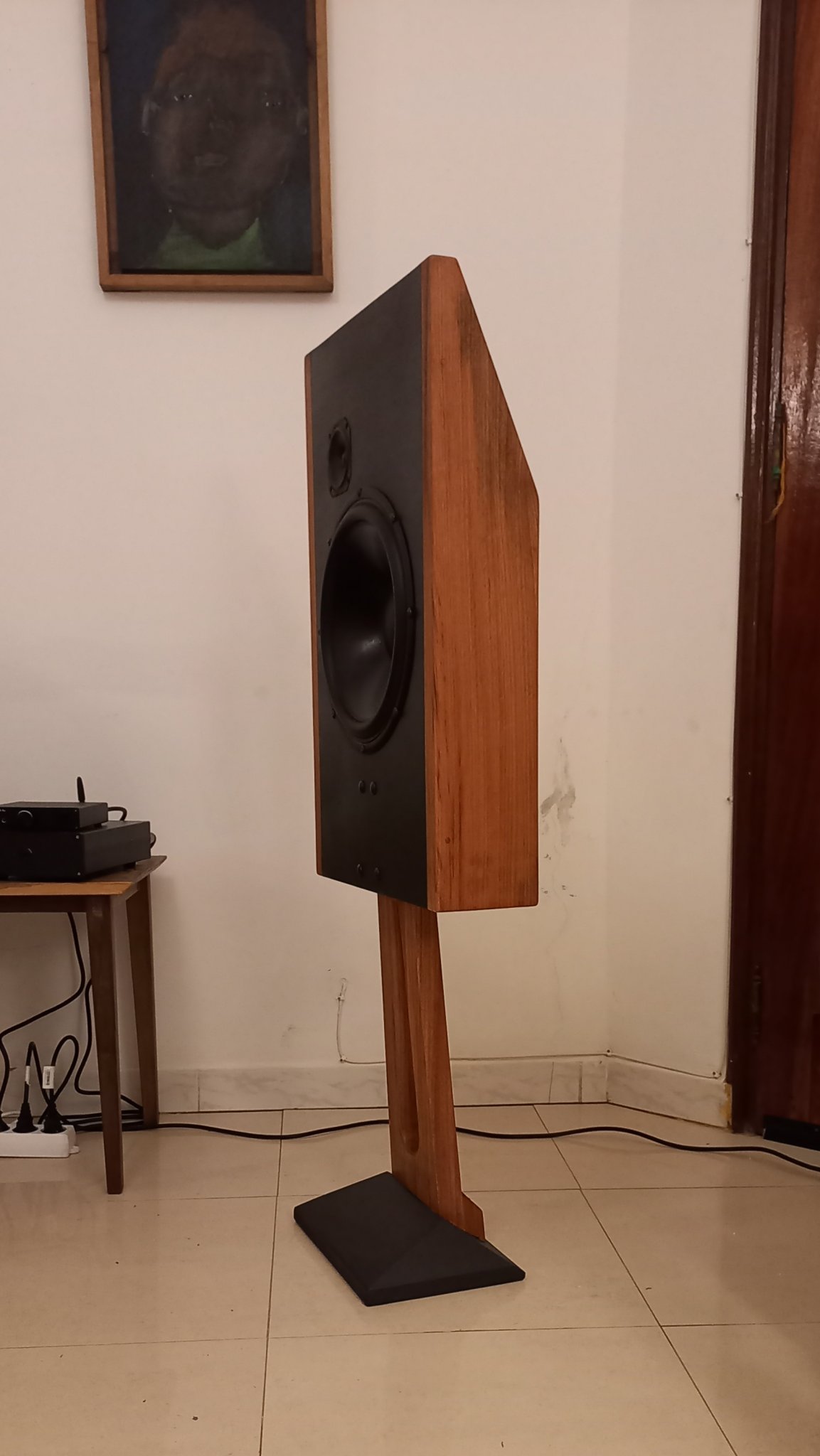

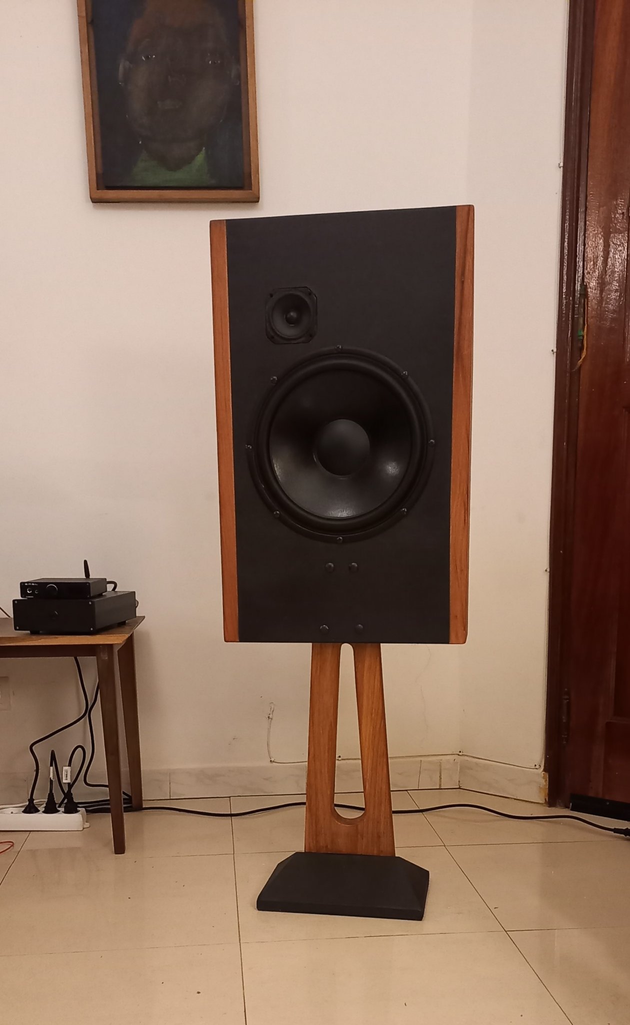

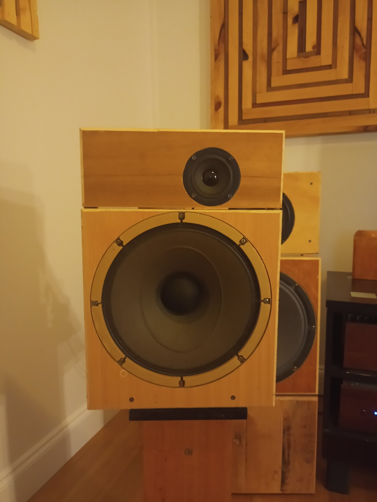

And finally, here you are with my interpretation of the Manzanita.
It's been a great journey, thanks to all for making this possible.

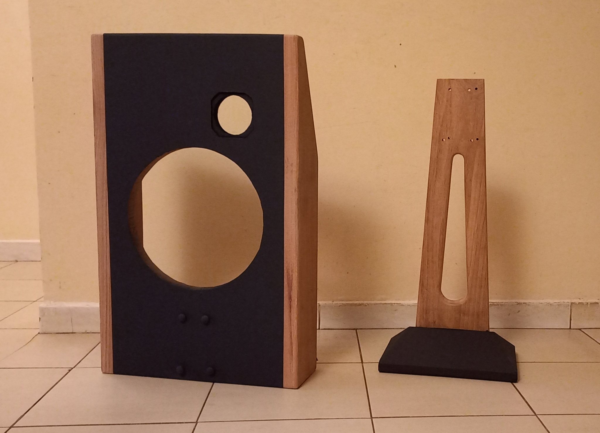

After a PM request I'm posting the sketchup file of the drawing which I used mostly to decide on the design, the first on the left is the winner. Please consider that dimensions and angles might not be exactly what I finally used nor what what recommended in the forum but they are very close, just double check them if you are building one of them.
WIth regard to the base, it's made out of scrap plywood and MDF, all glued toghether and then cut to an angle at the table saw. I've then glued and screwed the leg to the base so that the baffle would be perfectly vertical. Leg and baffle are not glued so that I can disassemble them if needed, 4 bolts and nuts are more than sufficient to hold them solid.
The baffle is made out of 3 cm MDF, while the wings, 3 cm thick, are made out of a local, tropical hardwood, same as the leg.
I cut the hole in the leg with the mortiser of my minimax cu300 plus some rasp and sandpaper work.
I don't have a router, and didn't want to buy one just to cut four holes, so I used a compass to draw the circles, then drilled hundreds of holes along it and then rasp, sandpaper...
Enjoy.

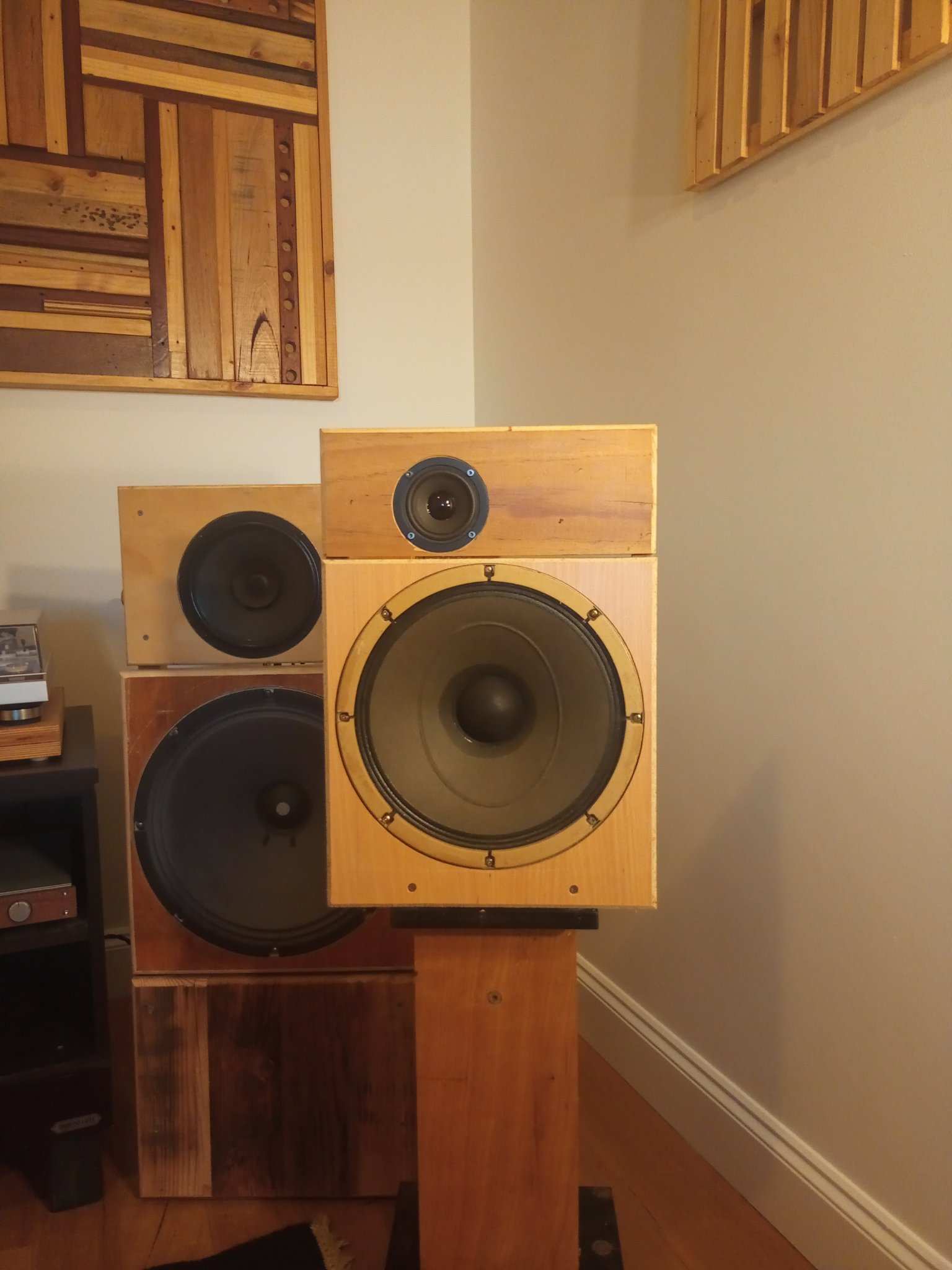

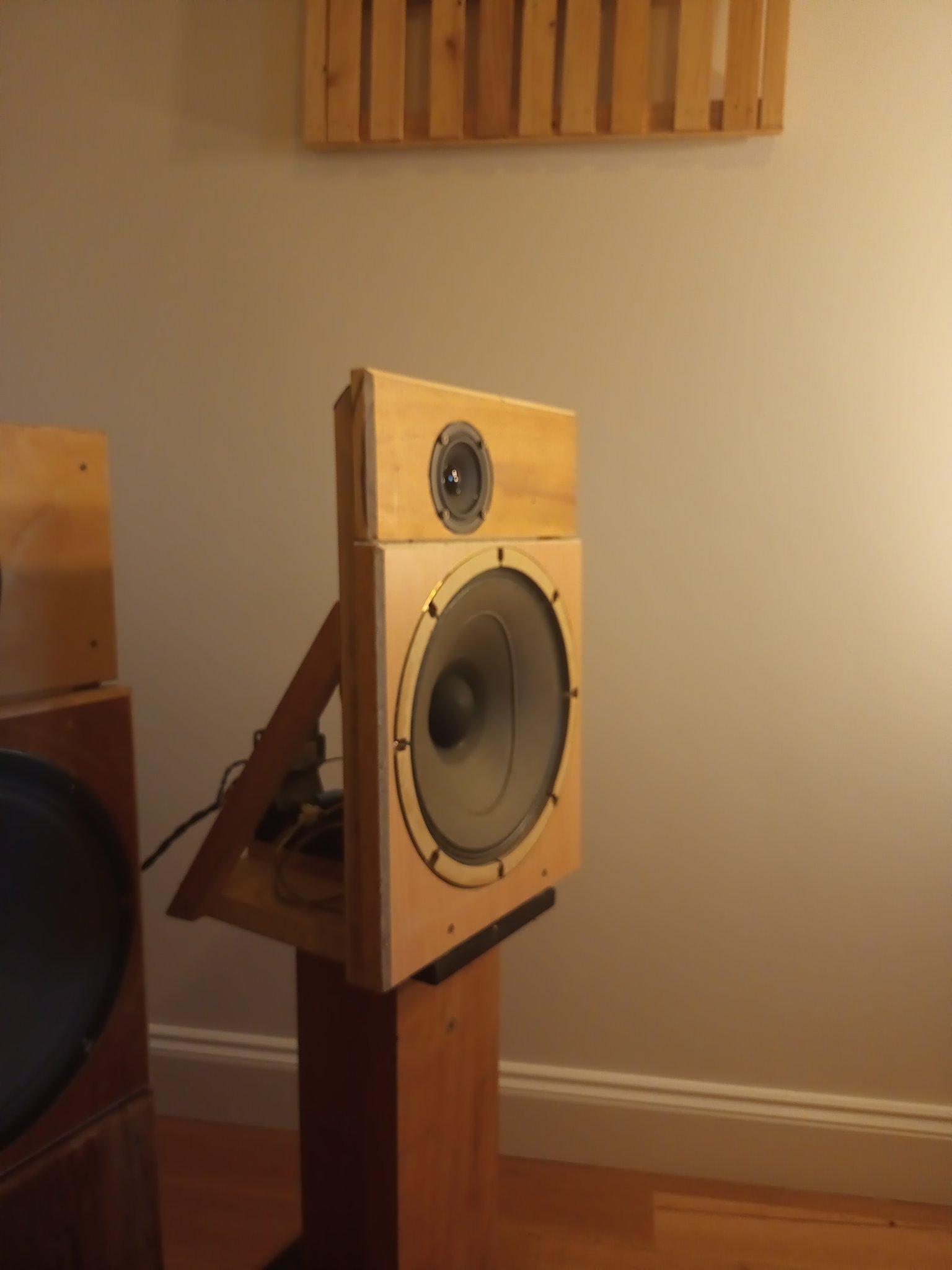

Just for fun I did a mock up version of the Manzanita with a Kawai 30P09 ex-organ driver (Qts 1.4) and an unknown to me 3" full ranger from some home theater speakers.
Series xover with additional 1000uF in front of the LF driver to extend and smooth out the LF response.
Xover needs a bit more work but the result is very promising, reaches down to around 42 Hz, the mids have great presence. Overall sensitivity is around 86dB so my ACA barely copes with the demand.
Also will be much better if I somehow manage to time align the drivers.
Here are some photos:

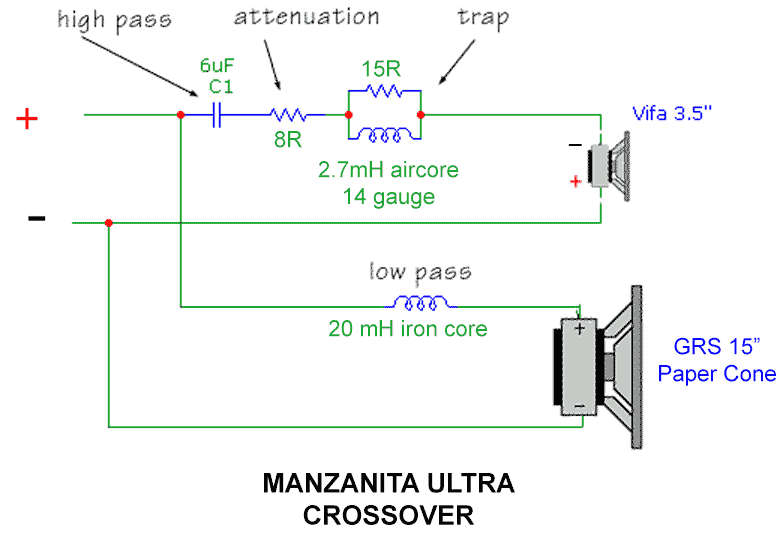

FWIW, here is a crossover.
The best I can find is what John said about this in an email:
What John usually did was start with the stock Manzanita crossover and work from there. The design is forgiving enough that the stock crossover sound good on most of John's designs. I built 2X15 ultra and still used the 20mH coil, despite the fact that it was 4 ohm. On top of that I swapped in and out several fullrange drivers in the 4-8" range both vintage and new. Mostly it was the tweeter (fullrange) resistor that needed adjusting to match levels. That is where I would start, the Ultra crossover with a low pass inductor of 18-20mH. You'll need to tweak the cap and resistor on your midrange, especially if you are using the NE123.

I asked about the crossover but can't find a reply. And there is nothing about the 18" version.The Ultra is just a wide baffle, floor standing Manzi. Reaches almost an octave lower and is about 2 db more efficient due to the larger baffle - path distance. So the Vifa pad is a couple of ohms less and the cap accordingly goes up a MFD "give or take" to put the acoustic crossover frequency back to where it should be. Does benefit from the woofer trap a bit more than the Manzi. That is about it. Killer "on the cheap" home theater speaker. Really reaches down. Even better with the Peerless NE123. But that is another story. This may sound (no pun intended) over the top, (who me?), reminds me a bit of a Klipsch Horn as long as you feed it class A tube and don't push it to hard. Again, with the NE123 up top. It has that much bass authority.
Wings are the same, but with the wider baffle you can add a couple more inches or so to the over all depth on the bottom two thirds of the baffle and get to a full 3 db more efficiency without getting into cavity troubles. Actually, the best Manzi format system I have designed. Especially with the Neo 4.5".
