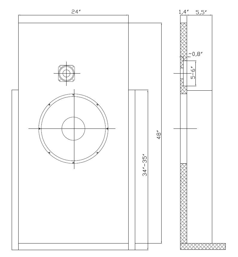

This is how I would like to build Ultra.
I thought (for better transparancy) that side panels goes in height only in woofer height
Further more, because of added thickness of baffle 1,4", hole on the rear side of Vifa driver would be open according to the picture.
All other dimensions and parametars of XO would be respected.
What do you thing?

Leooki.... Your proposed build - drawing look good. Yes, you can taper or truncate the rear wings above the GRS if you wish. The straight wings were a way to keep the original build as simple as possible. The Ultra baffle is wide enough to load the GRS down into the upper 30's and the Vifa down to its crossover based cut off. The wings on the wide baffle are shallow enough that cavity resonances are not a problem. Part of the wing requirement was structural. Again, keeping the build simple and sturdy. Look forward to hearing more about your build and results. Best J
