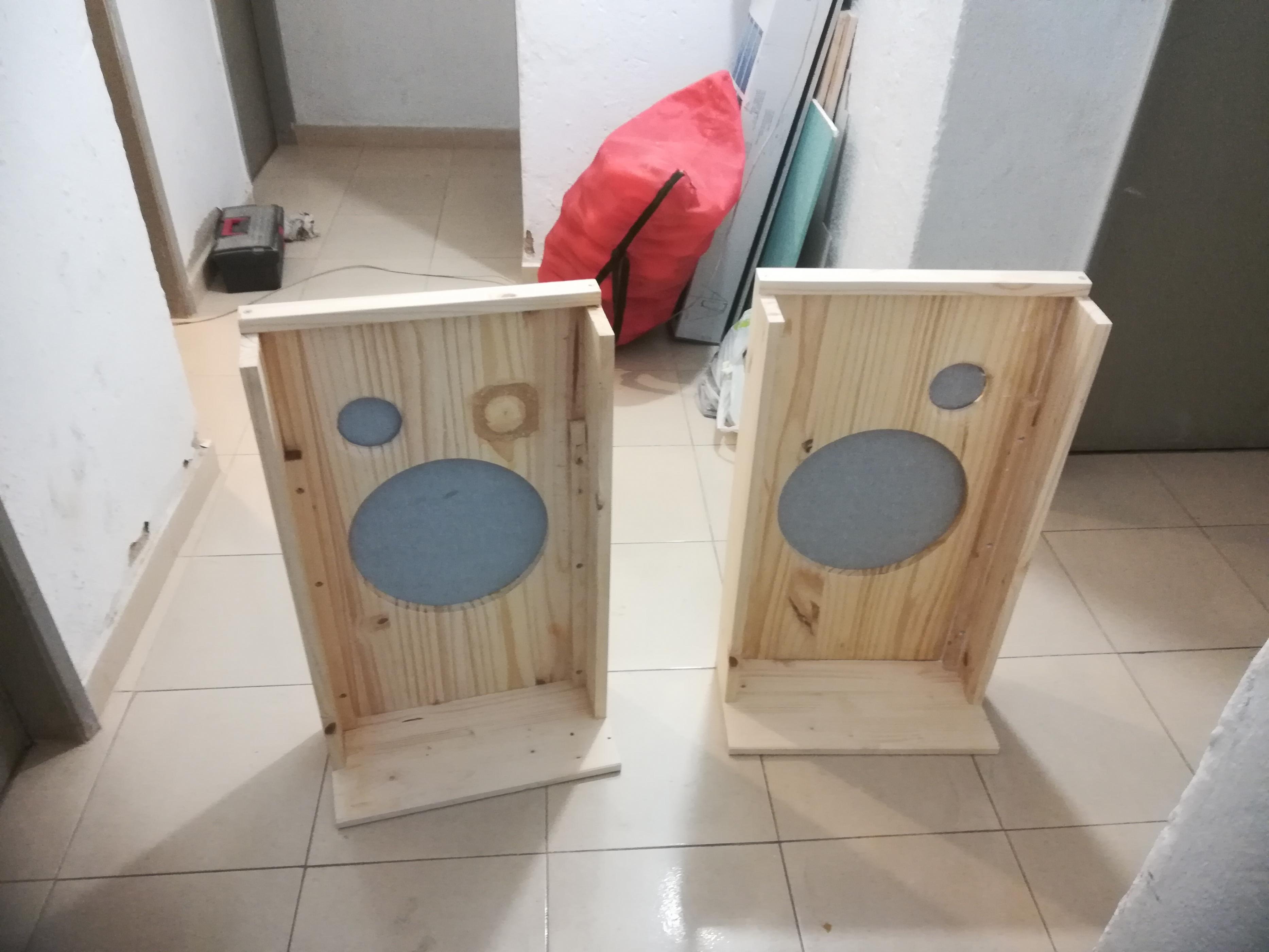

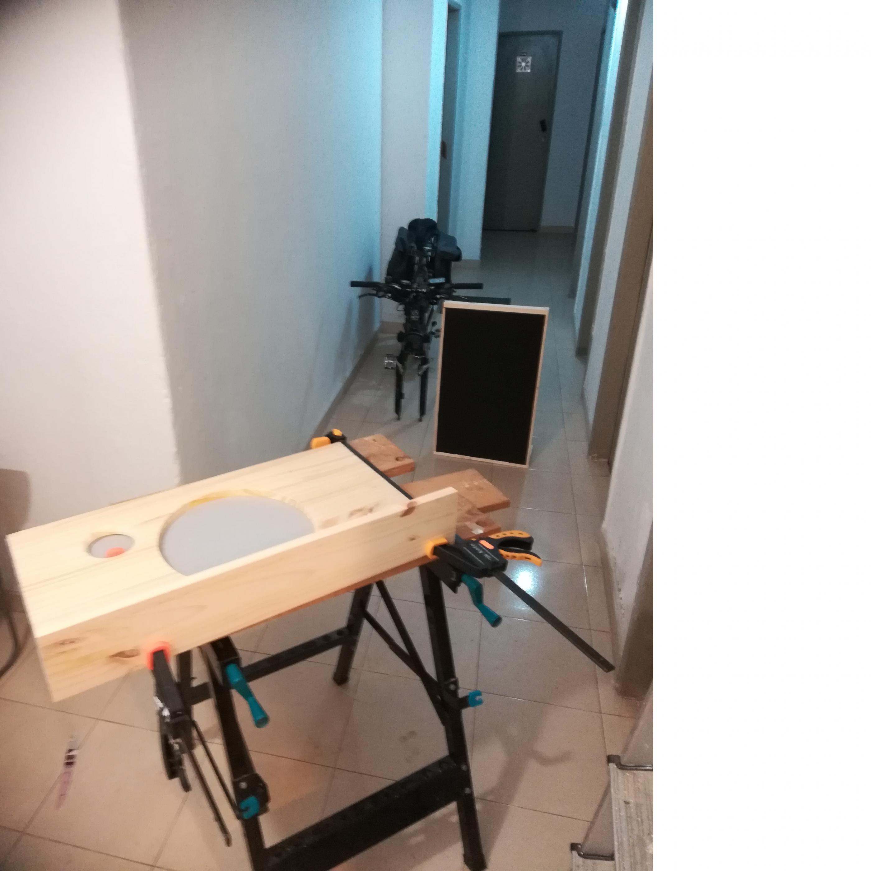

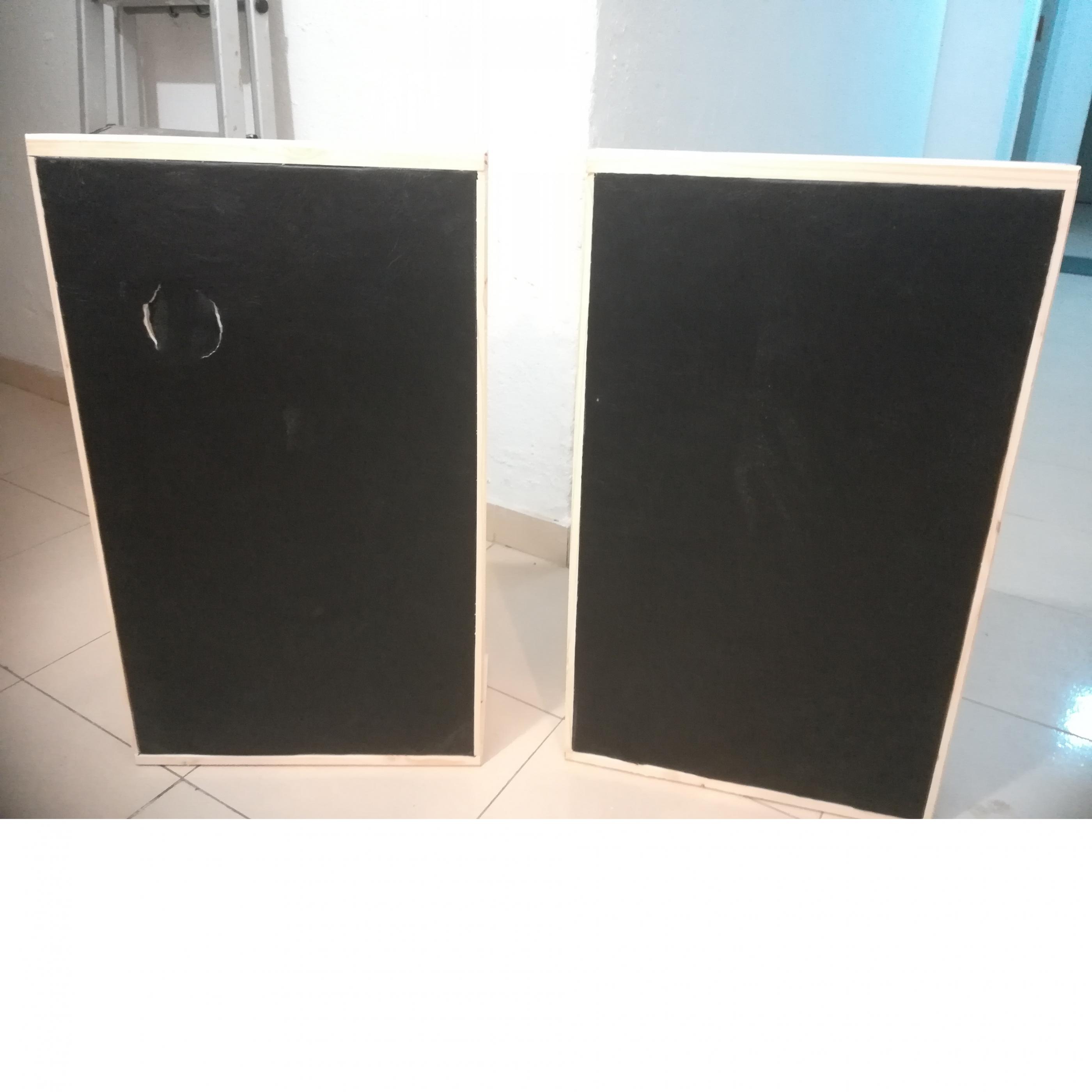

Thanks for the photos. If the mistake in behind the speaker, it never really happened - right? ;P
While we're on the topic of baffle construction, is there a preferred material? MDF? Birch plywood?
Hello Harrold.... ideally the baffle plate should be MDF, but plywood, or if all you have is solid wood, that will do. Being an open design it is quite forgiving of substrate resonances. MDF is the easiest to machine and is available most everywhere. The wings can be anything from cardboard to granite. Shape and structural integrity are the main things to consider. Best.
yes 🙄

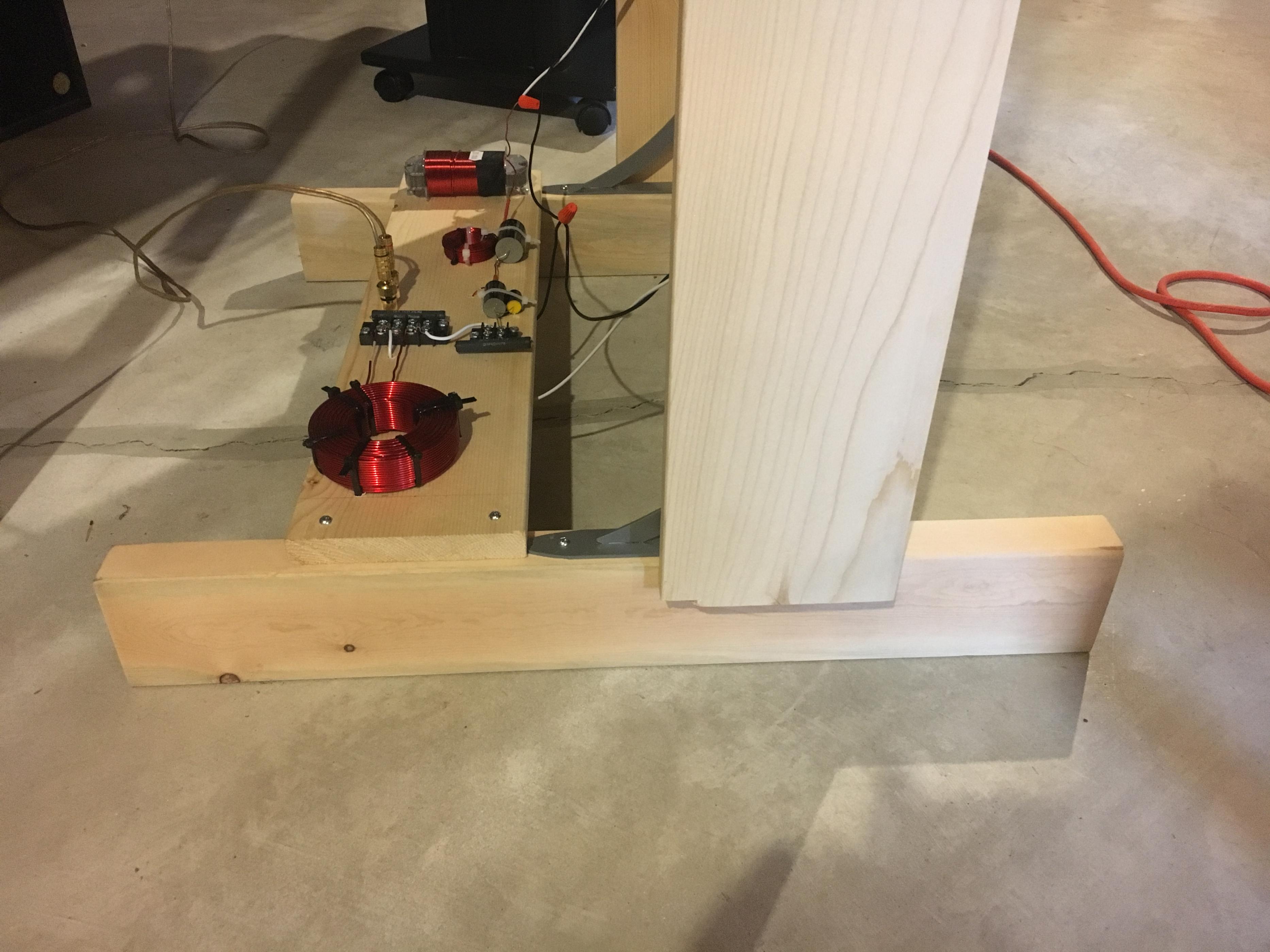

Just laying out my crossovers now. I'm concerned about interference or crosstalk between the relatively large inductors. Can anyone share their experiences or suggestions? If it matters, I expect that my crossovers will extend across the 24" width of the baffle.
Inductor cross talk
Just keep them a couple of inches apart, and if you are still not sure, stand one of the two inductors on edge.
I use the pic at the bottom of this link as a guide:

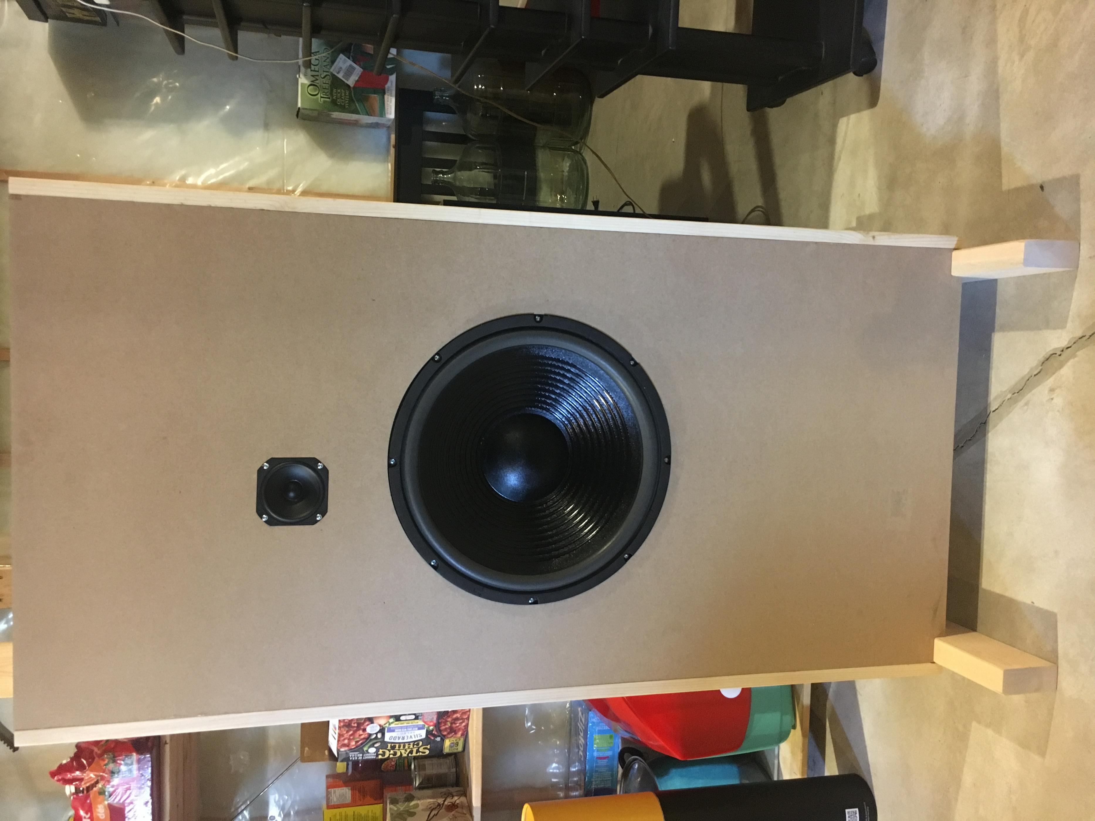

I finished my Manzanita Ultra build yesterday. Right out of the box, they were really enjoyable and have improved with a few hours of playing time. The bass has settled in and listening to a bowed double bass, you can hear that these speakers can produce both quantity and texture. It still may be a bit too much for my liking, but I'll give a few more hours. Relative to the woofers, the tweeters look tiny but they do a surprisingly good job with the mids. Nice integration across the audible spectrum with a lot of spatial cues. Overall, a very nice set of speakers!
Thanks to John and Pano for keeping this thread active and informed. Making these speakers was as much fun as listening to them.
