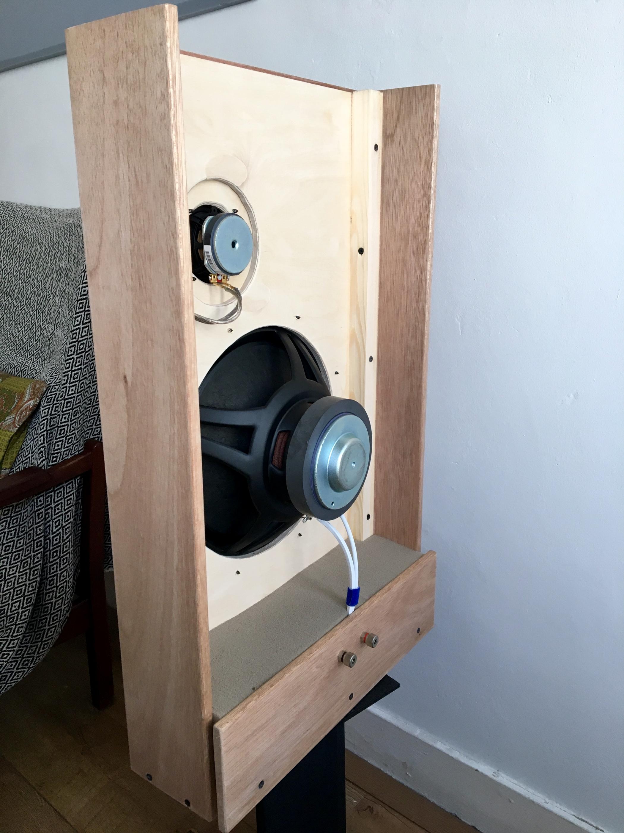

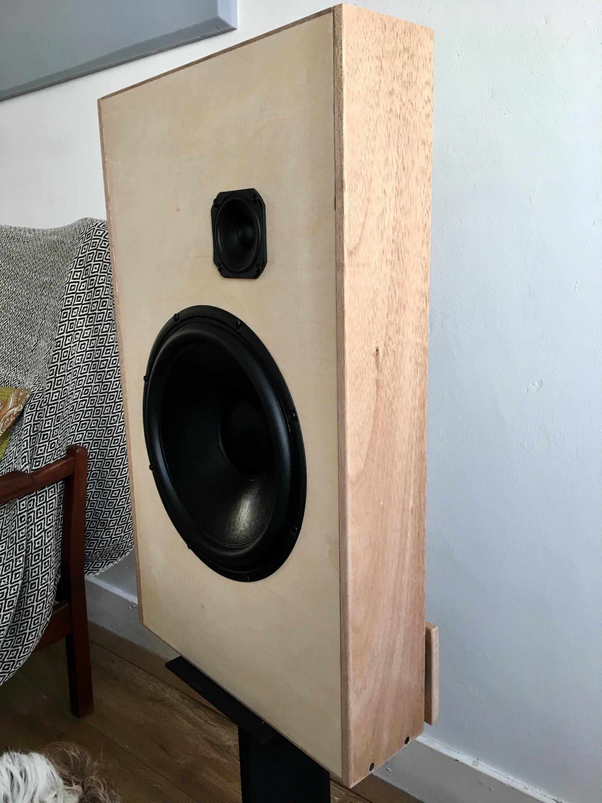

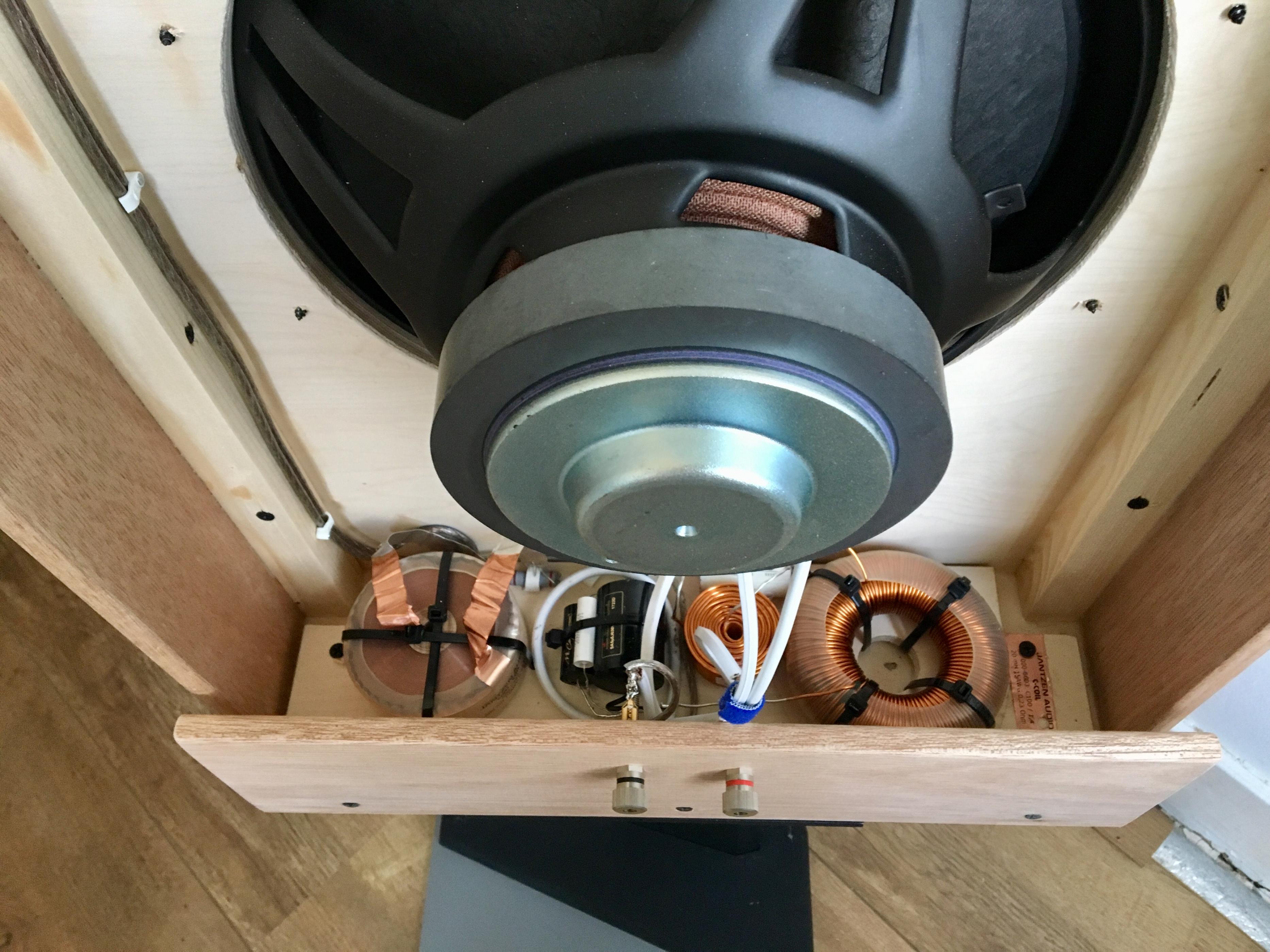

With the help of a friend (who showed me this thread and is the real diy audiophile) I'm building a pair of the "small" Manzanitas, using the 12'' peerless woofer and the Vifa (i.e. the slightly older part set). I've a few questions based on using newer developments discussed here while I still use the 12'':
1. is it still recommended to use the woofer trap posted for the 15'' version (previous responses in the thread indicate yes)?
2. would it be recommended to cut off the top of the wings as seen in the newest build?
3. would it be recommended to mount the peerless from behind the baffle as also seen in the newest build?
My baffle is 1'' rigid oak.
Thank you!

I have a couple of answers for you:
Mount the Peerless woofer on the front of the baffle, it's made to do that.
The Peerless doesn't need the trap, or at least not as much as the GRS.
John may have more suggestions.

Hi Pano, thanks a lot for the response, that's very useful. I'm also very keen to hear what John has to say on the wings.
Original Manzanita wings
MK.... the original wings were a simple as possible in keeping with the "Fast & Easy" build concept. Just enough to provide a bit of additional loading on the 12" and 3-1/2" Vifa at the lower end of the Vifa's spectrum, plus, a bit of added structural support for the baffle. Over the several years this DIY project has been up here, there have been several alternatives noted.
I feel the best compromise between effective and easy is a 5" total wing depth from the base up to the centerline of the Vifa mid-tweet, then taper the rest of the way up ending up with the wing having about one inch of thickness against the rear of the baffle. Trying to get loading without creating obvious cavity resonances. You can experiment with heavy card board and see what works for you then fabricate the permanent wing accordingly. Hope this helps!

Thanks a lot John Busch, will do! I think it will actually create a nicer design as well. I think I've compromised a bit on the "easy" thing, as we've ended up going quite deeply into working the wood nicely (seemless joins, no screws; and the woofer trap parts are already bought so we'll end up making that as well). Here's the current design, brixvold (another member) drew this in 3d:
(As you can see the design needs to be adjusted a bit, as this assumed mounting the woofer from behind, which Pano suggested not to do).
One last question - I made the front plate 16 inch, but then the two wings have a width of 1 inch each. Should I shave an inch of the width of the front plate to make the total 17''? Thanks again for these designs and all the good help on this thread!
MK.... looks great! The 16" baffle width is OK. Wider is better actually. Make sure you round the rear of the Vifa cut out. Don't want the Vifa loading into a deep tunnel! I would bring the 5" deep wing height up another inch or so. Hope to hear how it all works out. J
