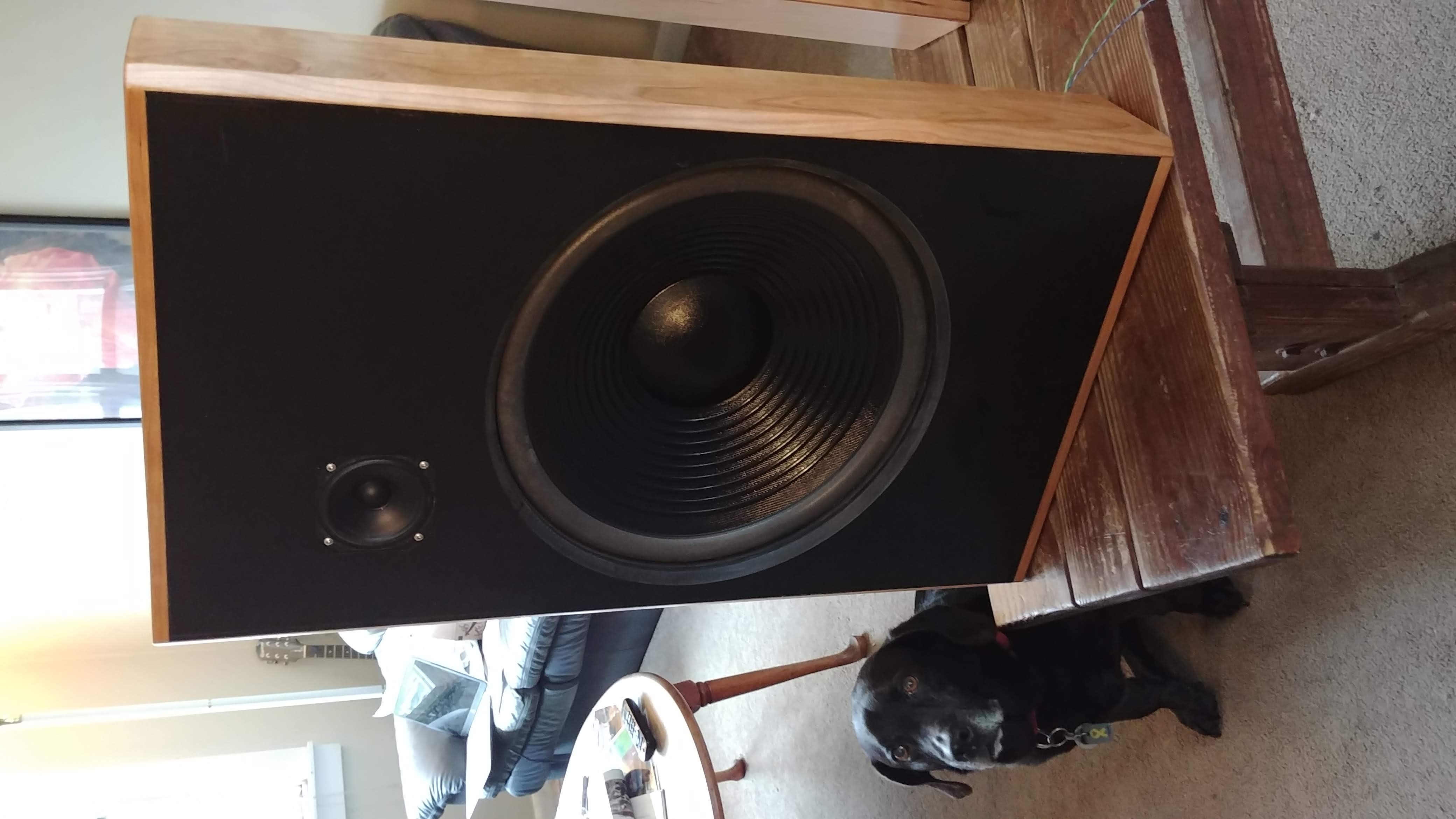

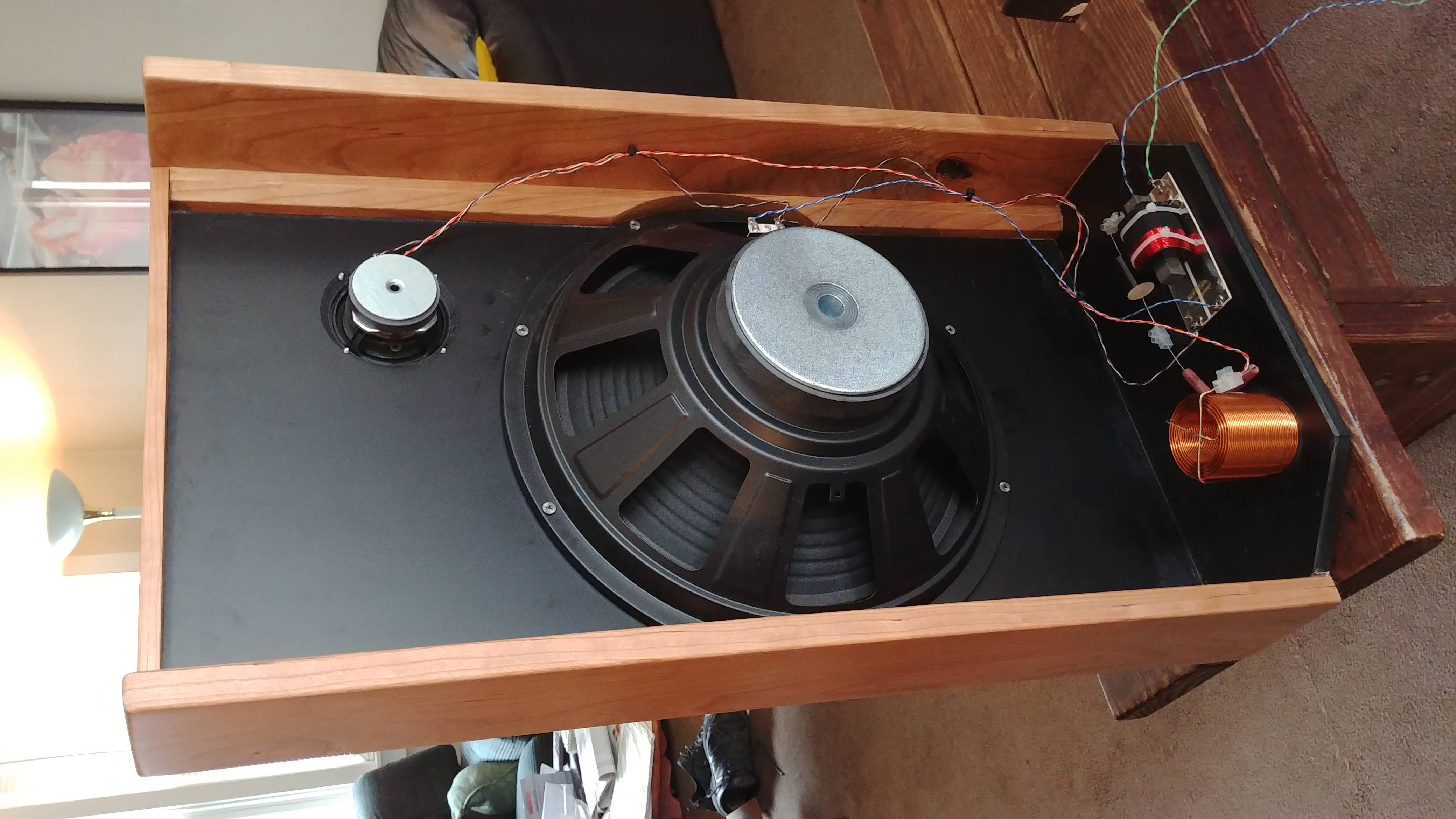

Finished these up over the weekend. Listened to some rock and roll before my little Lepai decided to give it up (don't think it liked 16v). Sound was great, loved the bass and the room filling sound. I thought the highs might have been a little "ringy"? Maybe just the amp or the room...

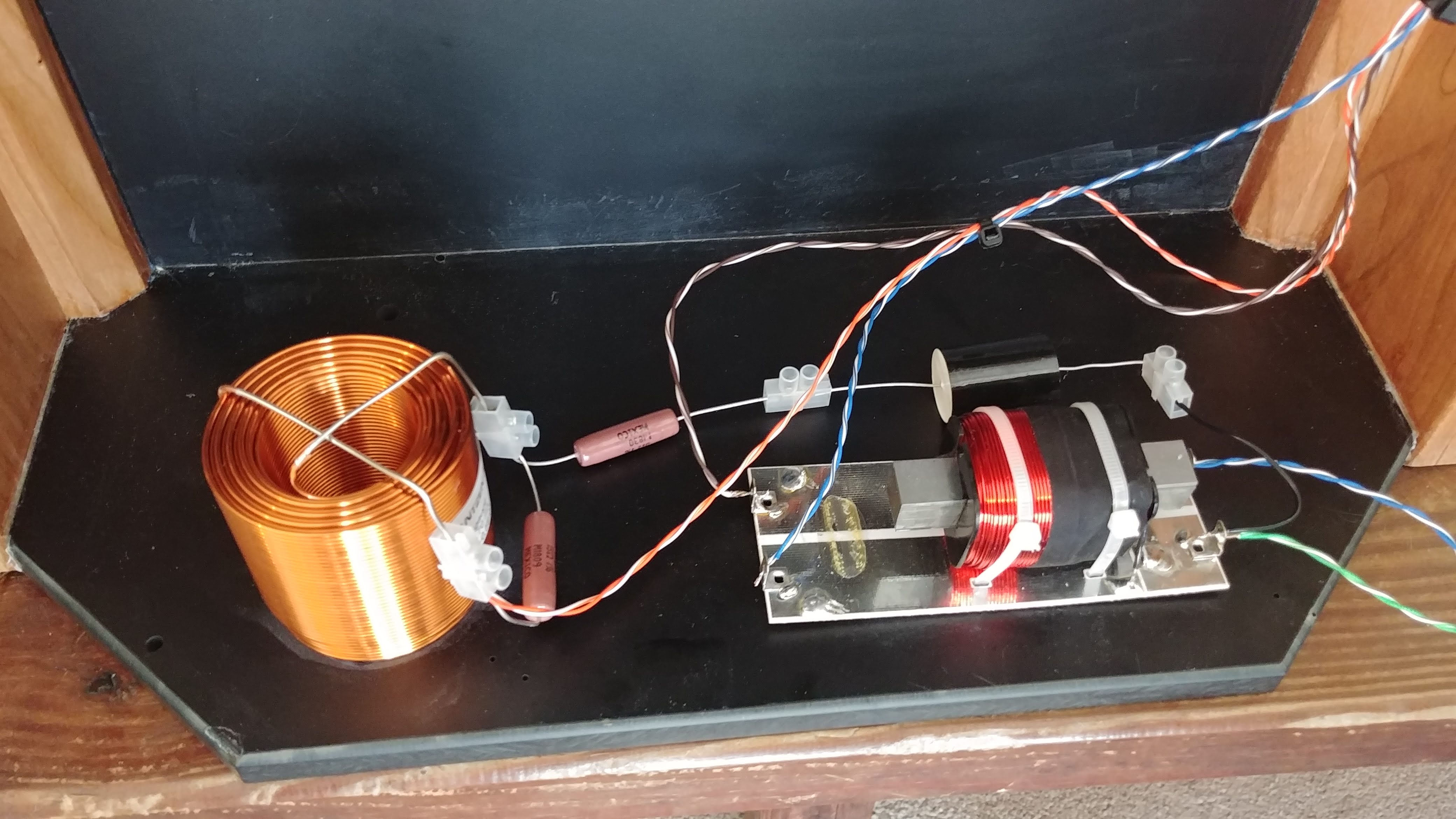

I mistakenly ordered the crossover parts for the Ultra, but found somewhere on the thread that this would work for the smaller model so I went ahead with it. I have all the components set up so I can switch stuff out and educate myself some on speaker sound. Any suggestions would be appreciated.
Tried to stick to specs but the baffle is just 1/2". I had a sheet of phenolic I wanted to use and since it is stiffer than 3/4" ply I thought it would work ok.
Many thanks to John and Pano and everybody else on the thread who made this design comprehensible to me!
