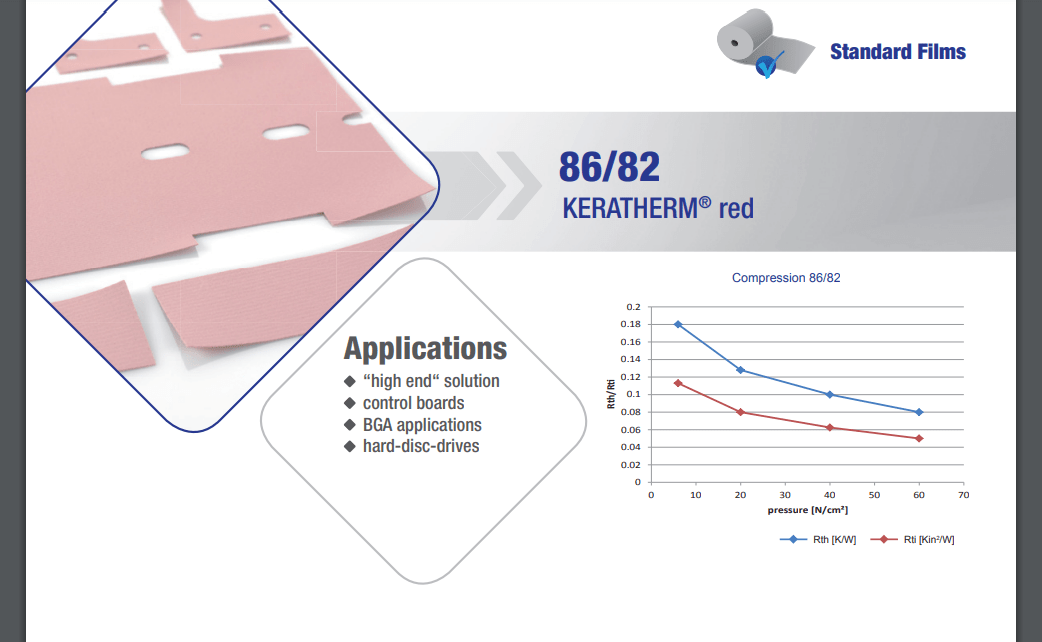

I was looking for specs on the thermal pads supplied, they are listed as BER1340-ND.All that comes up and close is BER134ND.It is black and proper dimensions.Its name is Bergquist Q3.The specs for it on Digikey say it is non insulating,which can't be a good thing I'm thinking.Reason I'm looking for specs is I have a bunch of mica pads and was trying to decide between the 2.
Check the data sheet link from the store.

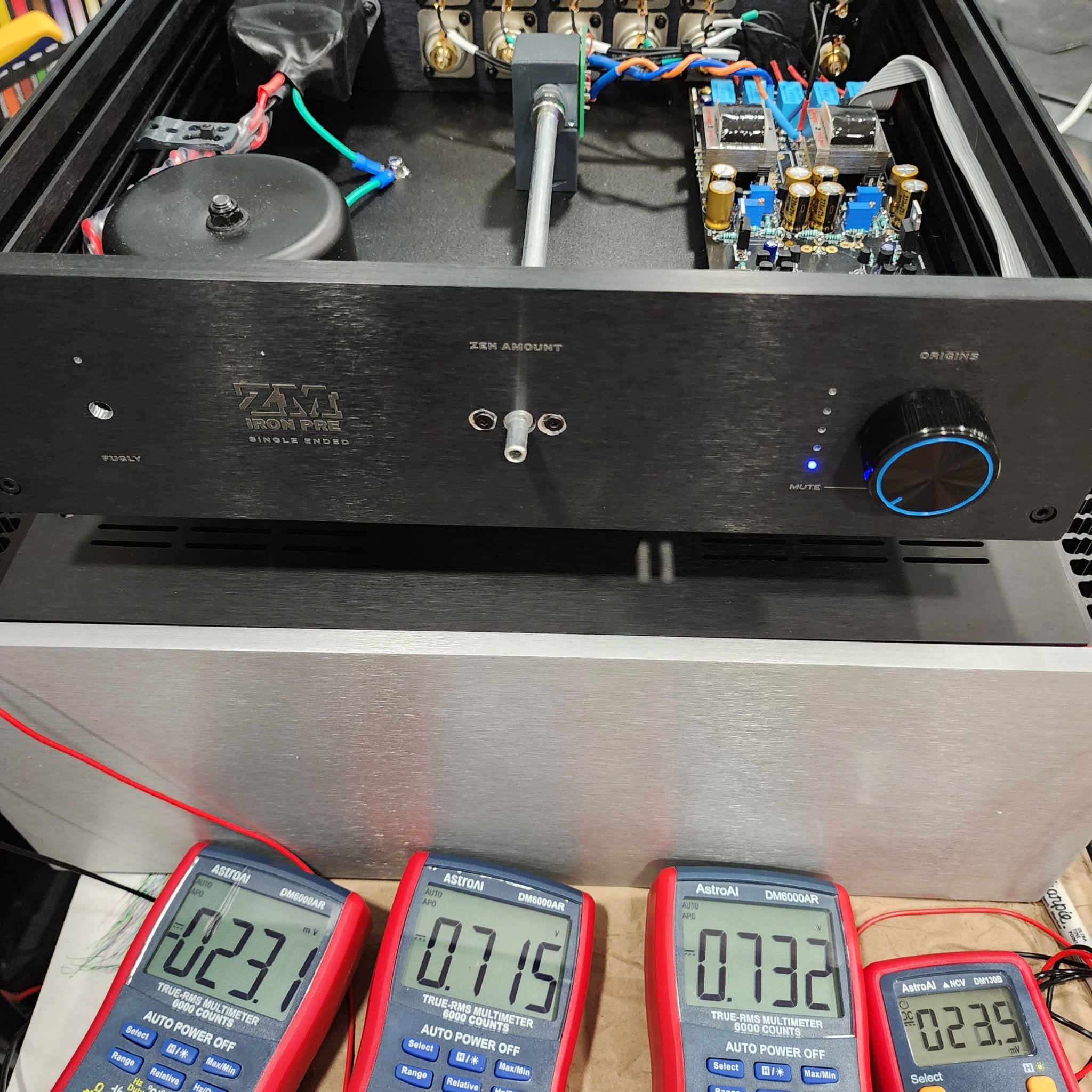

Well, my bias was too high at 1.7A, I have the 10ohm thermisters when I should have bought and installed 4.7ohm thermisters, and I used the thermal pads in the completion kit which appear to be non-electrically insulating....call me a "Foolish Amp Builder" because I turned it on, hooked up the Iron Pre SE SMD and played music....
🎶 !! Glorious Music !! 🎶
Amps sounds amazing!
I wish I didn't have to take it all apart now to make the fixes. It'll be good practice at least.
Thank you to everyone on this thread who has freely given their knowledge, pointed out my many errors, given me a little razzing from time to time, and shared their build experience! Very generous group of people here!
