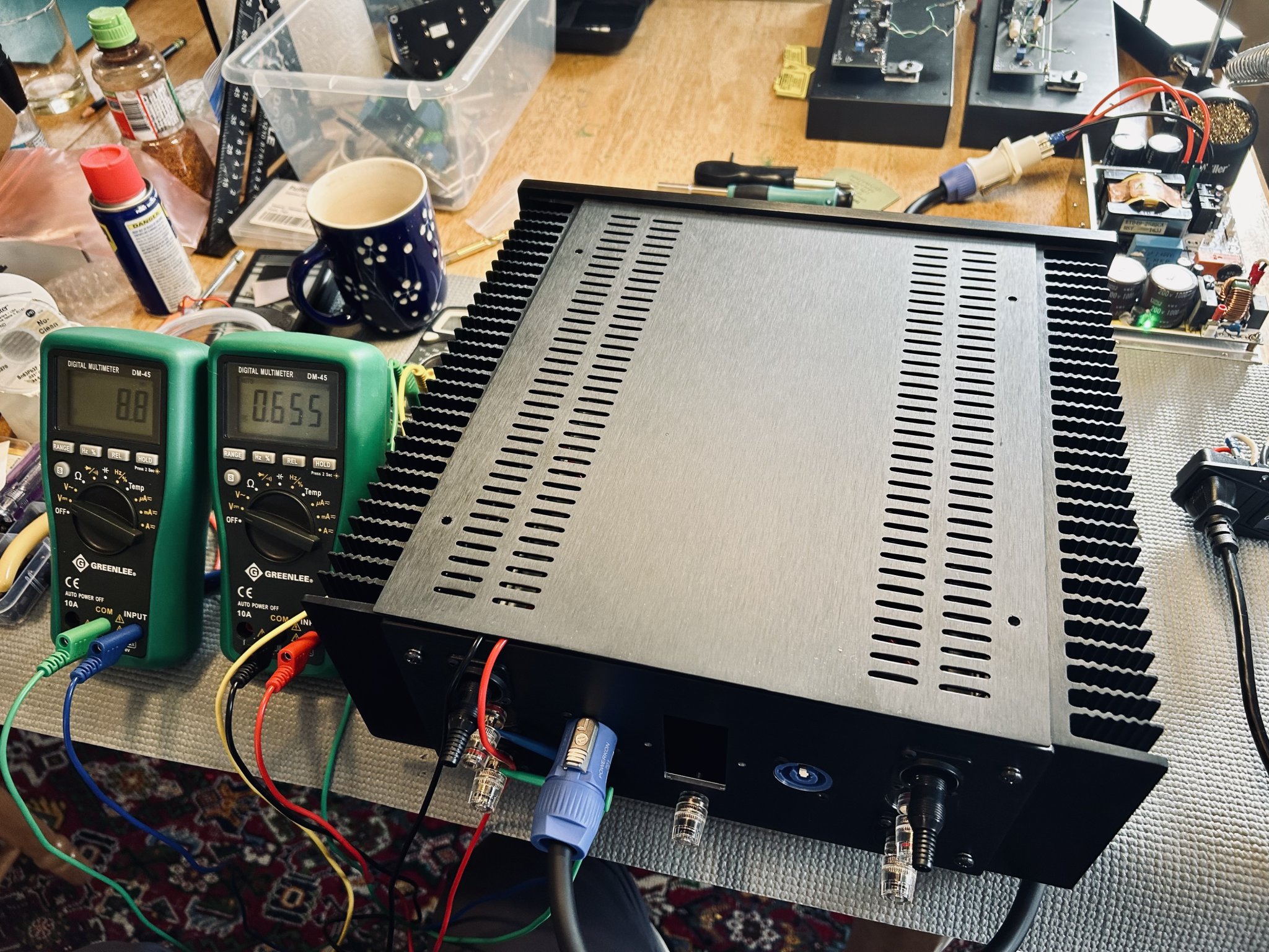

Haha. I’m awake now. Cooking one channel.On page 7 of the revised F5m build doc. Just one correction: With 0.47 ohm source resistors, I believe 1.4A bias would render a voltage of 0.66V.

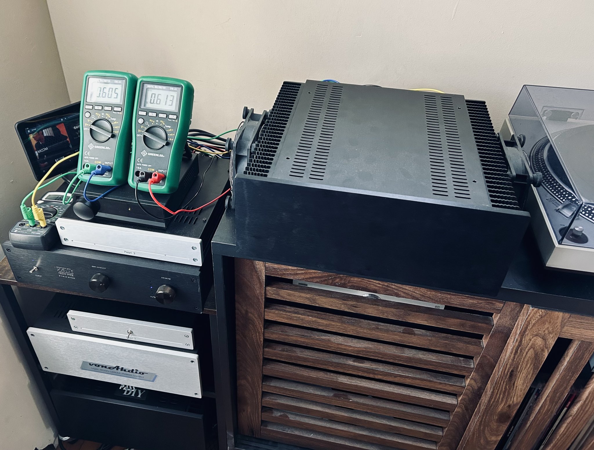

Initial setting of both channels went well. Now monitoring Iq and DC offset in the main rig with music playing. It sounds very good. Silent background.
During initial setting, 1.4A Iq resulted in 55C at the warmest part of my 3U300 sinks. I’ll get it settled in the main rig at stable Iq and offset, then see where I can get with a little fan action on the sinks.

How much DC offset do you measure and how long does it take to stabilize?
When adjusting, I left each channel at about 20mV DC offset because I was happy with the Iq measurement at about 660mV. One gets a feel and a rhythm to how each pot affects the values and how the circuit responds with the heatsink. Once warmed up to around 1A of Iq (470mV), my amp seemed to settle with 10 minutes between little increases of current. So once I was content, I left the pots alone. It took me about an hour to set one channel and be satisfied with the results.
Later when I fired up the amp from cold, the DC offset started at about 50mV and steadily went down to about 20mV as the amp warmed up. Everything settles within an hour. All benign values and behavior. I didn’t experience turn on or off thumps.
Like Nelson advises in his articles, take your time and make small, incremental adjustments. Patience rewards the builder here.

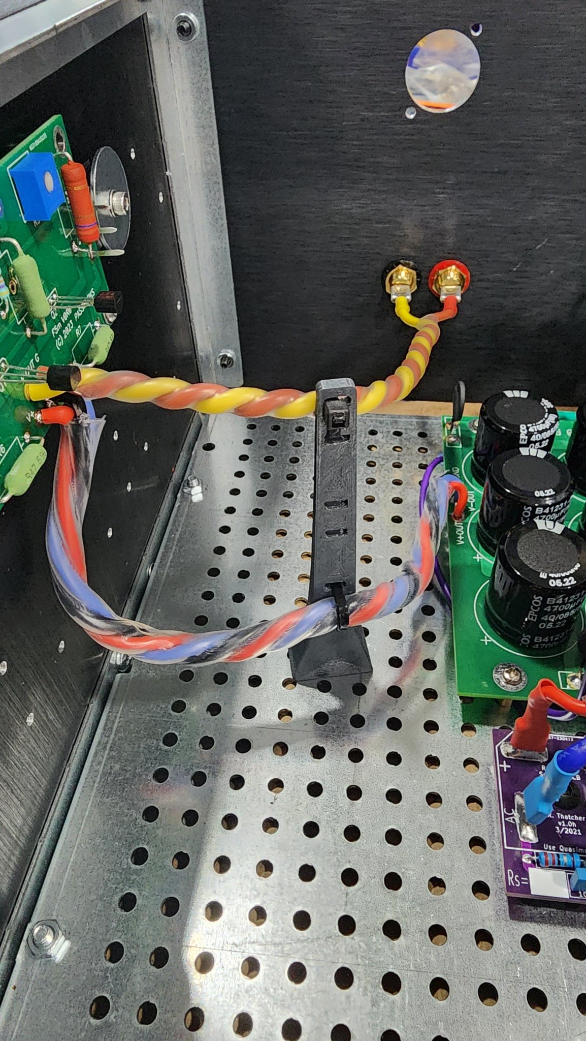

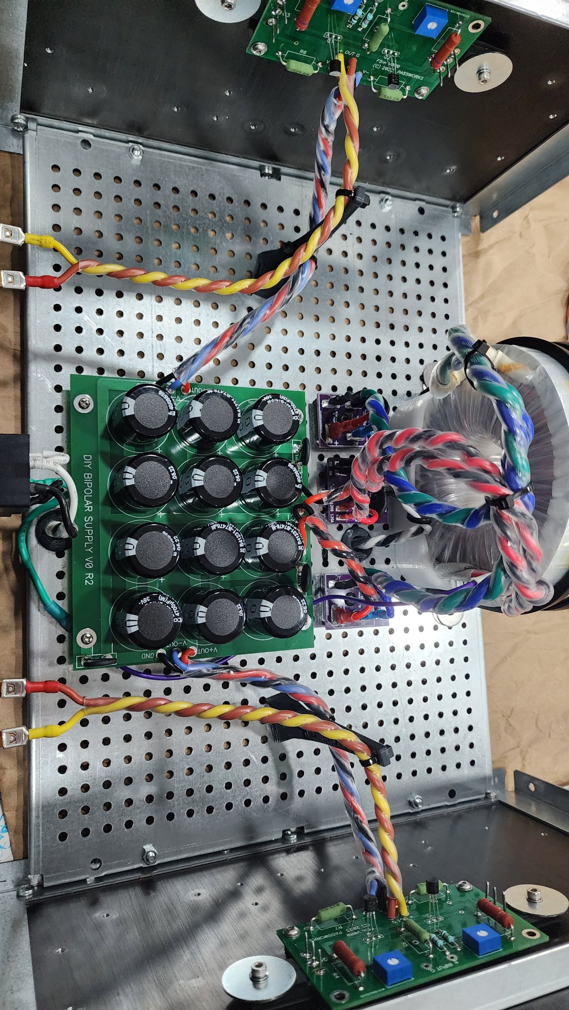

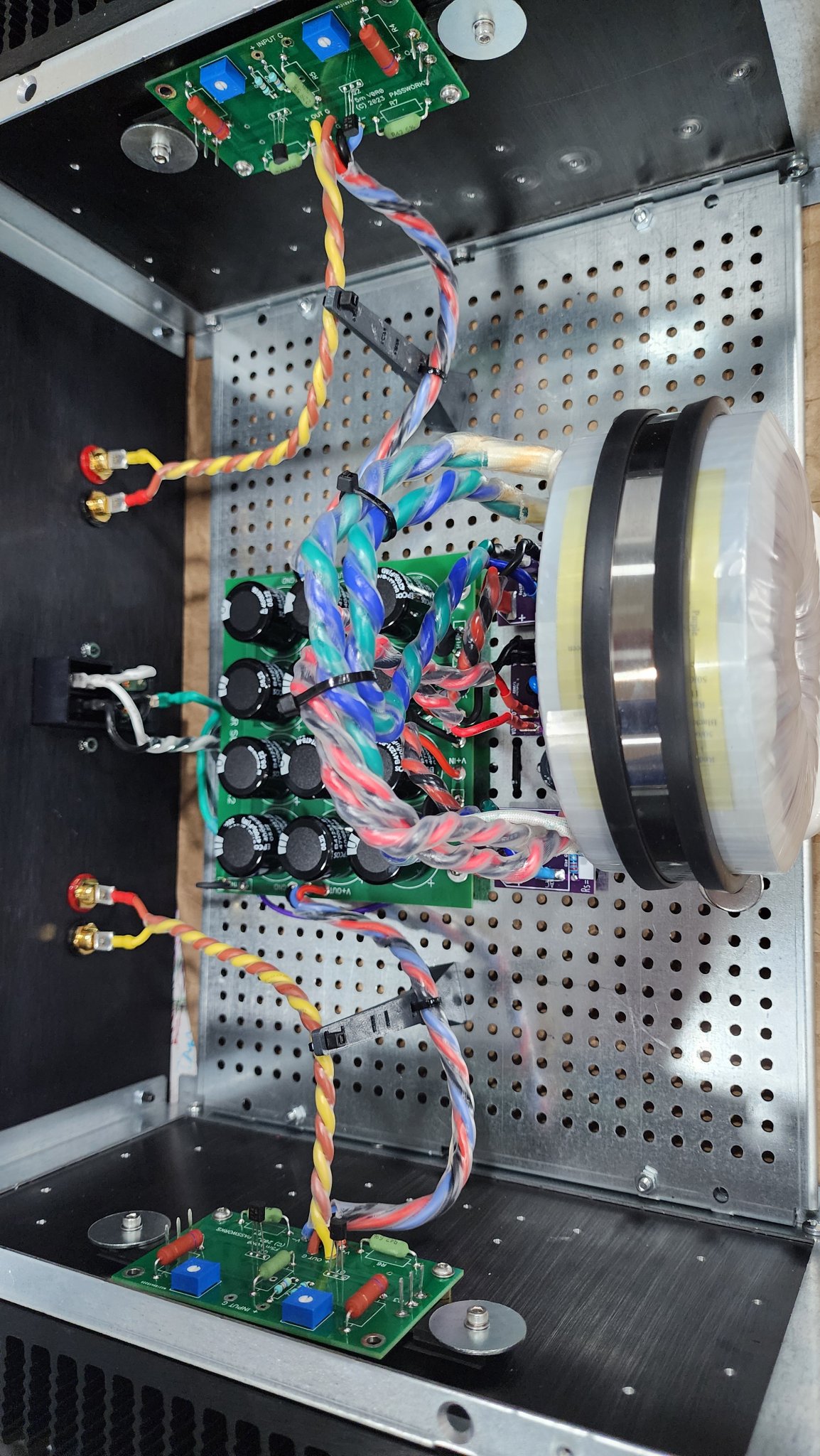

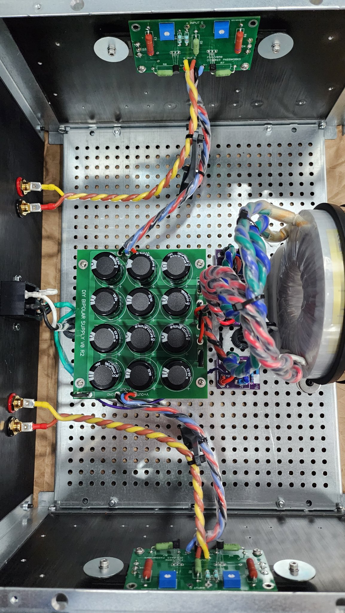

Power Supply rails checked out at ~+/-25VDC unloaded using DBT (dim bulb tester) with 150W incandescent followed by autoformer to ramp up. After verification of good DC rail voltage I let the capacitors drain (or attempted to), but then realized a 3W 10ohm resistor would help speed things along when used appropriately (and carefully).

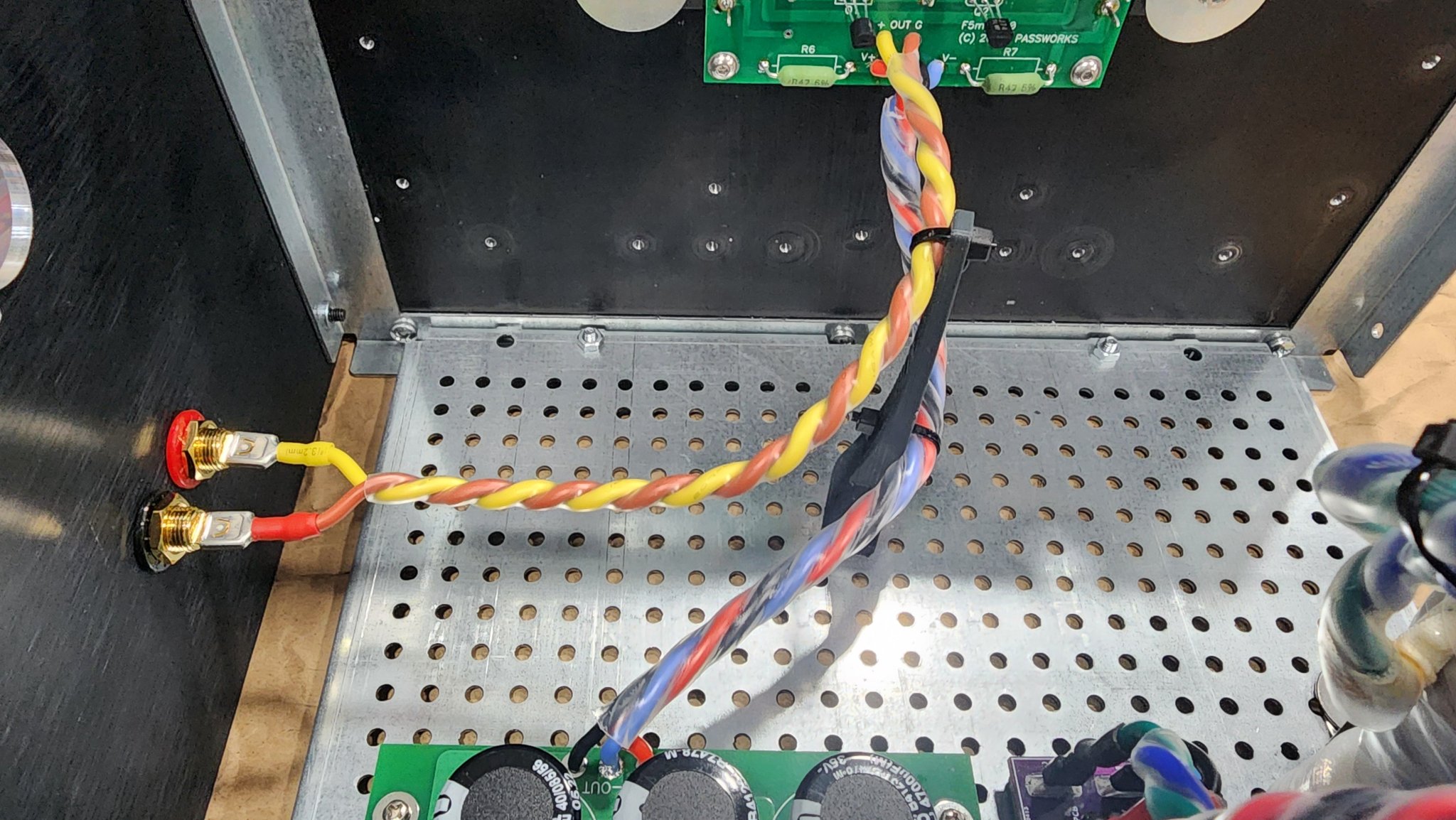

Got the wiring from PSU to amp boards done. Transformer primary/secondaries probably need to be shortened, but I had already crimped on the spade connectors, so left them as big loops to be fixed later. Still need to connect signal input wires.

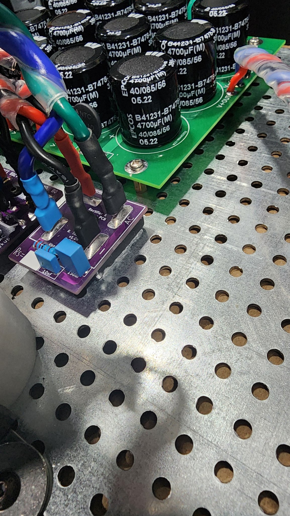

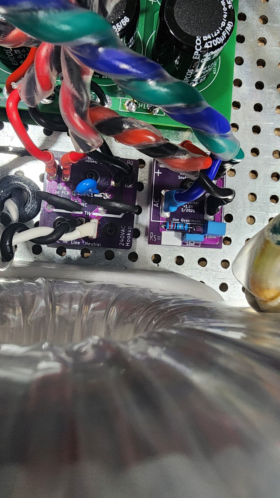

Im using @rhthatcher boards for mains inrush with CL60 thermisters and rectifiers with snubber resistors and capacitors for AS-3218 per Quasimodo posts from other users.
I'm going to carefully read power up instructions tomorrow and hopefully get bias and offset dialed in.....then.....glorius music.
