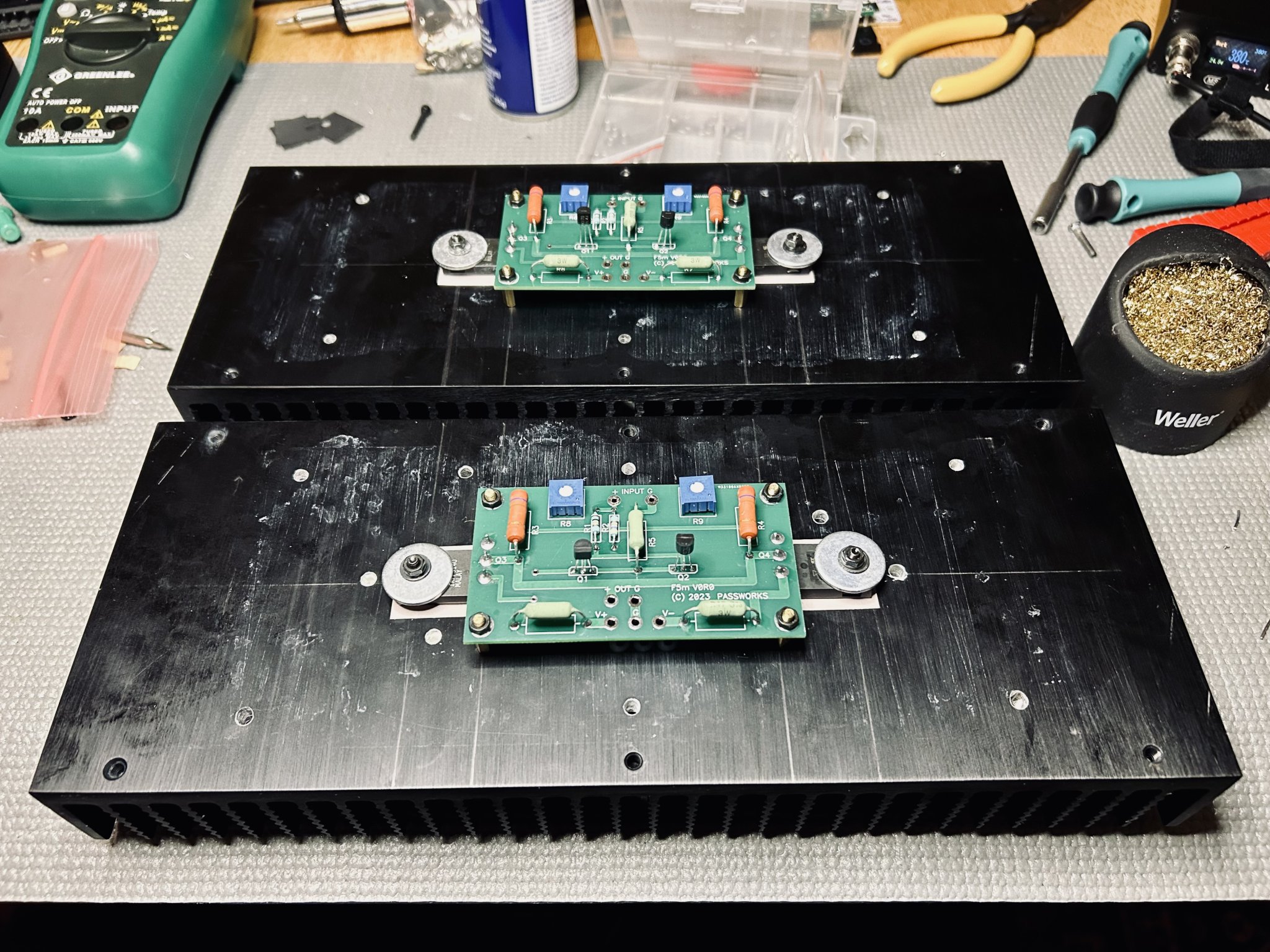

Could somebody please let me have the between centers measurement for the output device holes as I'll be drilling and tapping my own heatsinks? Thanks.
The UMS pdf on this page https://diyaudiostore.com/pages/universal-mounting-specification will serve you well if you are drilling and tapping yourself. As said the mosfets will fit across 120mm and the board mounting holes are 80mm x 40mm. All multiples of 20mm, very neat and clever.

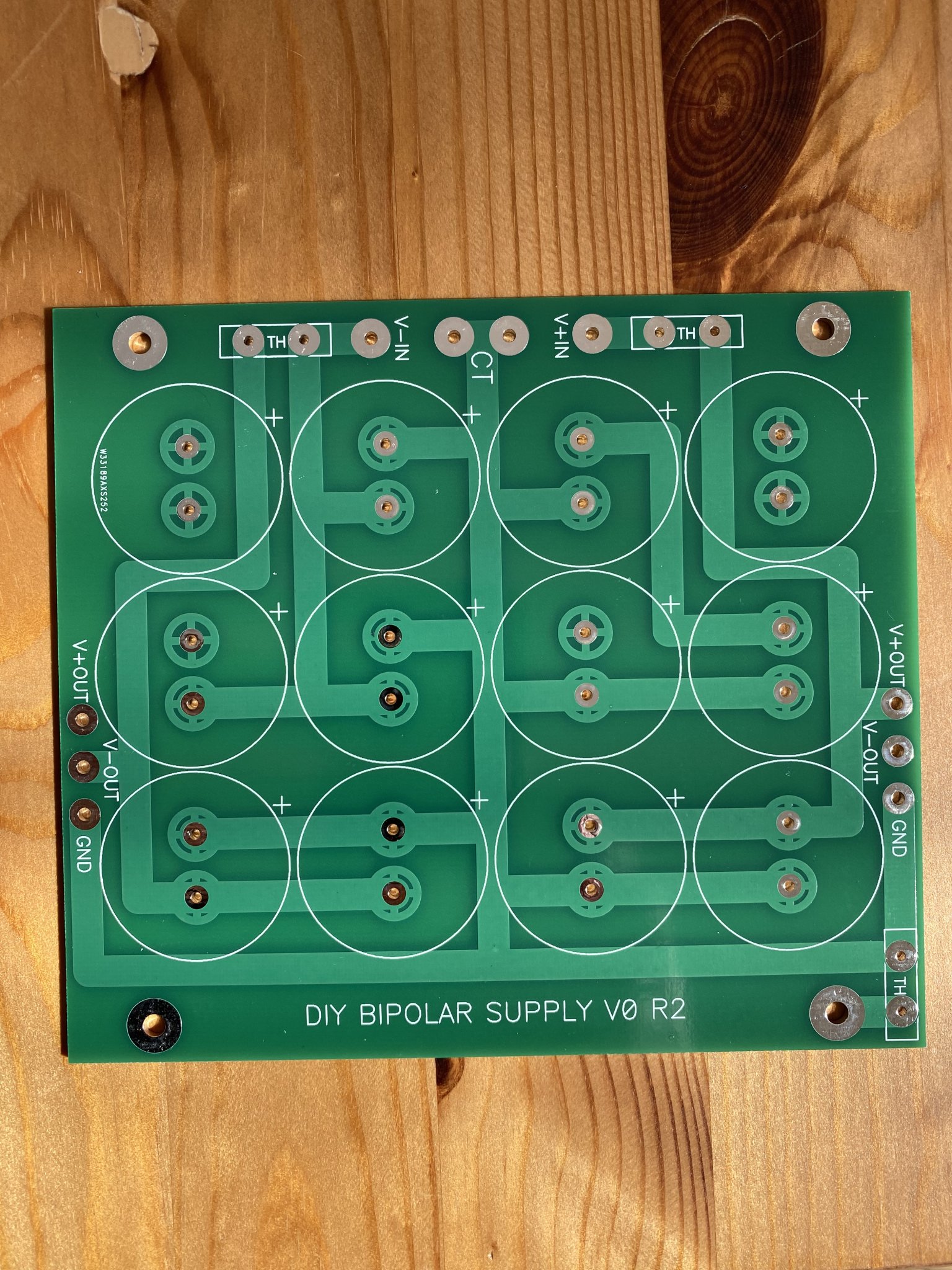

very interested.If someone need a second psu board to build dual mono I don’t need mine. Pm me if interested. You pay the shipping and it’s yours
FWIW, I had to drill my heatsink holes too.Could somebody please let me have the between centers measurement for the output device holes as I'll be drilling and tapping my own heatsinks? Thanks.
I laid the PWB down on the heatsink, and used it as a template for the 4 mounting holes. Its easy if nothing is installed in the PWB.
After drilling and tapping those holes, I loosely mounted PWB with the 2 FETs (without soldering), and located their mounting holes.
Used a punch to locate the holes in the middle of the circle made for each hole.
I have one done so far, and it fits fine, 2nd one will be made over the weekend.

I have one as well that I don't need,however I don't need the caps and thermistors as well I would throw in the board if you pay for the caps,thermistors(4), and shipping Cost would be as per digikey and no profit.Hi Ylab, I will take it.
Vinay
Hi @oreo382 , I could use an F5m PS board if it is avaiable. Please PM me with the details. Thanks!I have one as well that I don't need,however I don't need the caps and thermistors as well I would throw in the board if you pay for the caps,thermistors(4), and shipping Cost would be as per digikey and no profit.
