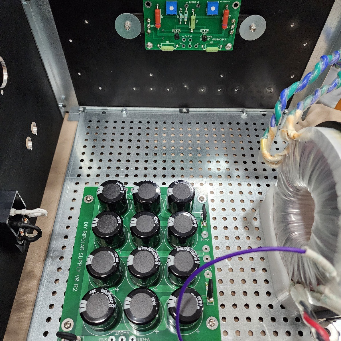

A little more progress on chassis population tonight. Still a ways to go though. Thanks to 6L6 for posting the pics of your build. Your inspiration helps my motivation. Also, thanks to Zen Mod for his poignant comments about chassis size. The 4U deluxe on the left leaves plenty of space to work, while the 3U Mini on the right looks like it would be a real challenge to fit everything in without a lot of cuts, scrapes, and cursing 🤬. A wise choice for a nooby like myself.
Coming along nicely!A little more progress on chassis population tonight. Still a ways to go though.

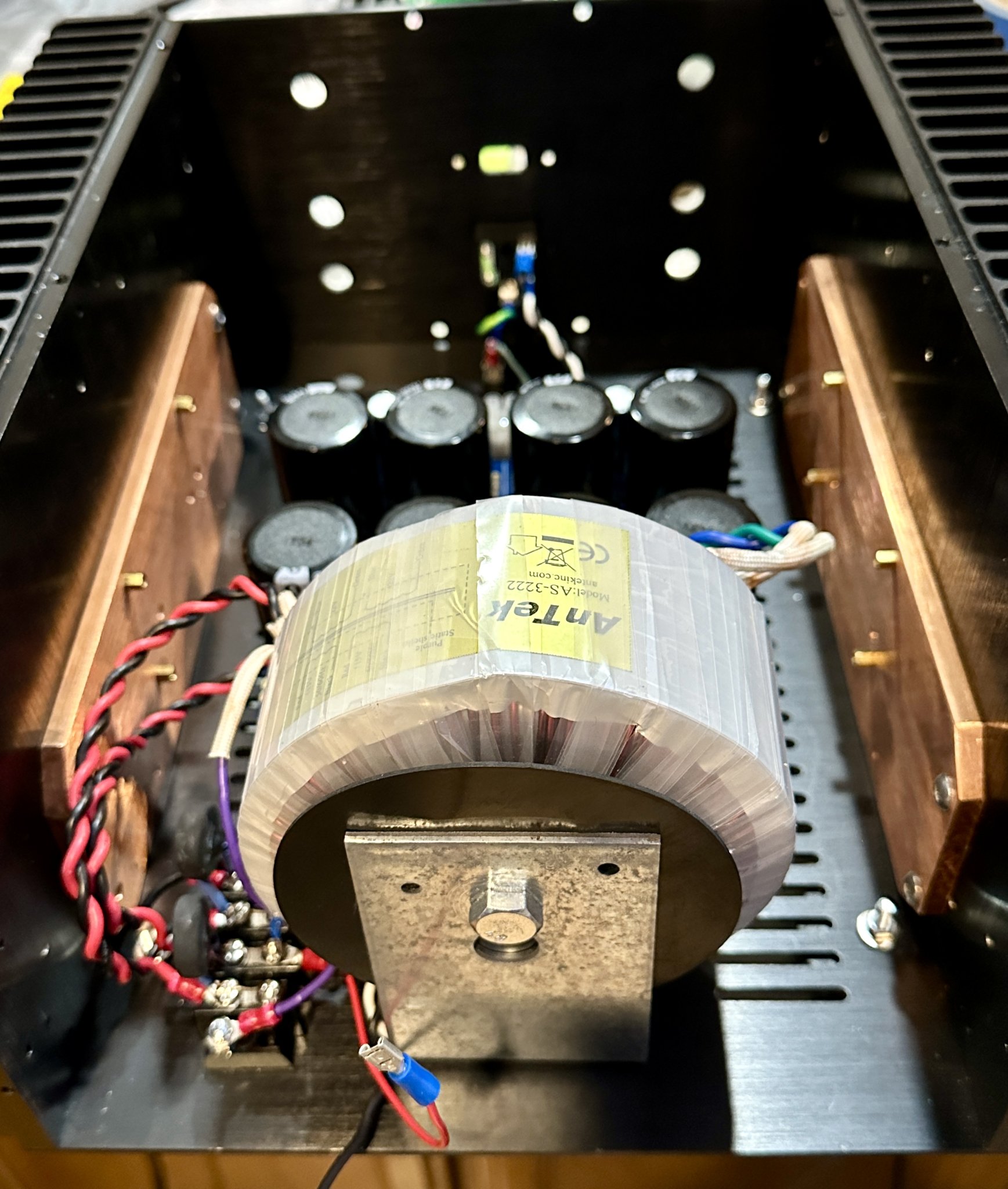

The general rule of thumb is if you place two loops of wire next to each other they can/will inductively couple through their mutual inductance and the amount of inductive coupling scales with the loop area. So if you're looking to minimize 60Hz induced hum issues, one needs to look at both the generator/"offender" end and in the receiver part of the system. The vertical mounting helps in that regard since you can move it AWAY from the input area of the main amp board.

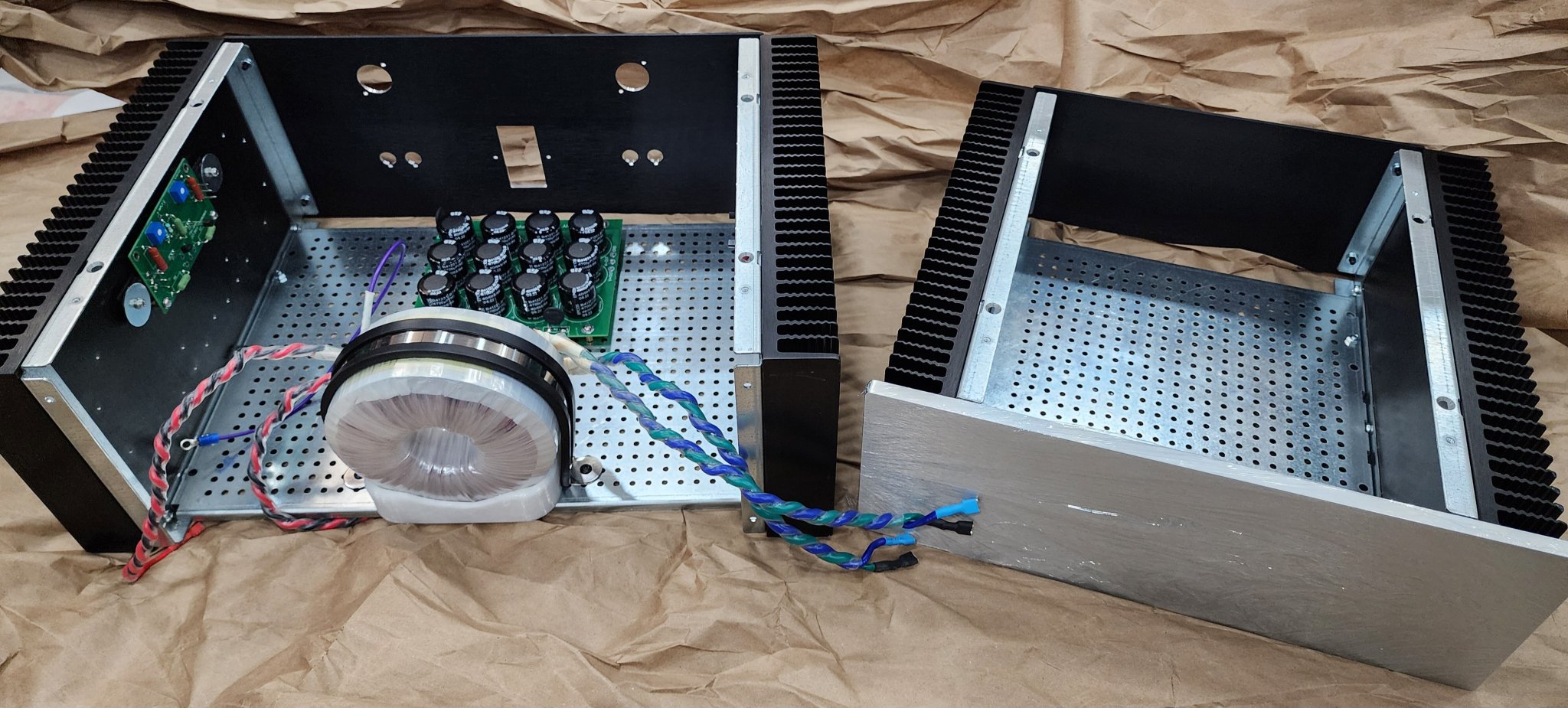

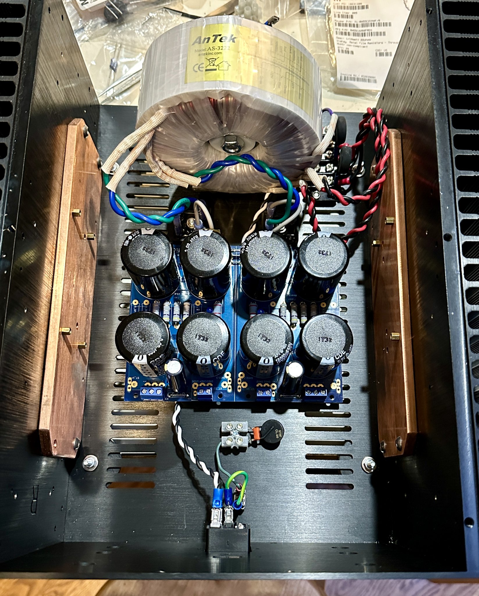

An example of vertical mounting with an Antek 300VA transformer.
This chassis is nearly identical internally to the DIY Sony VFET (lottery) chassis. A 400VA transformer would just squeak inside, but this one is easier to work with.

All this talk about interference from your toroid. I have never had an issue with hum in any of my amp builds (same chassis ,different boards). 500va Antek transformer mounted laying flat approx. the middle of the amp with the ps board in front of it. Chassis size close to a 4u. Amp board inputs to the rear of the amp. I dont know,lucky or is there something to my layout.
