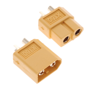

In all seriousness the anodize layer is a pretty good insulator. Problem is it's very thin and a sliver of metal could pierce through. I'm guilty of using some crimps here and there on non mission critical or low current supply rails and such. High level audio output leads, important grounds, and main amp rails I almost always solder. I've been using these XT60's any place I just really need a reliable connector without loss or problems down the road..

I have used XT60 and Deans plugs for power and speaker connections within amplifier chassis and have complete confidence in them. They have large contact areas and are designed for many Amperes of current. They are also very secure as it takes some force to disconnect them.
They are typically used in radio controlled model vehicles and aircraft to connect lithium polymer batteries that provide many Amperes of current to electric motors under demanding conditions.
Reactions: 5 users

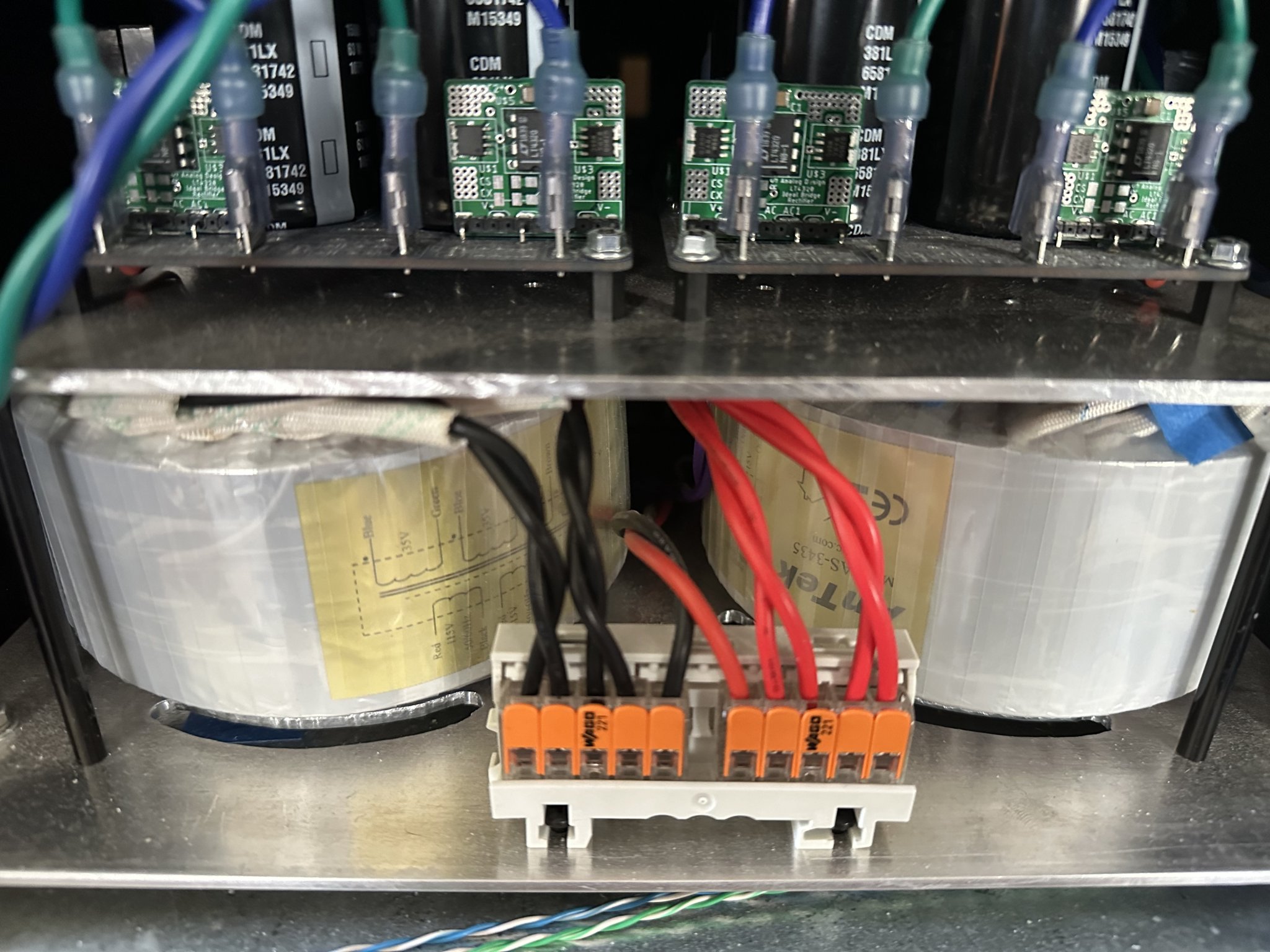

I've been thinking about using connectors for easy swaps and modularity. In shopping board mount terminal options, I found that Wago makes pcb connectors. I love their 221 lever locks for line and low voltage field work so might try using them with the snap in bases for flying leads and the pcb mount version looks interesting too. I've recently started coming to grips with Kicad so a trial might happen eventually.
The 211-4 series are IEC approved up to 32A, UL to 20A and the 221-6 are rated to 40A IEC and 30A UL. I'm sure the idea is questionable for some but they also rate Lloydes Register and the American Bureau of Shipping approval, and apparently also meet ABYC standards.
Reactions: 1 user
Vunce, I should have been more specific 221-4xx and 221-6xx are the standard lever nuts with -4xx accepting 12-24ga wire and -6xx accepts 10-20ga.
I'd have to suggest going directly to the Wago site for the pcb mount info. I haven't dug through the options just yet.
You can't beat these things for general use. Strand, fine strand and solid conductors in a wide range of guages using a single listed unit sure simplifies things.
Reactions: 4 users
