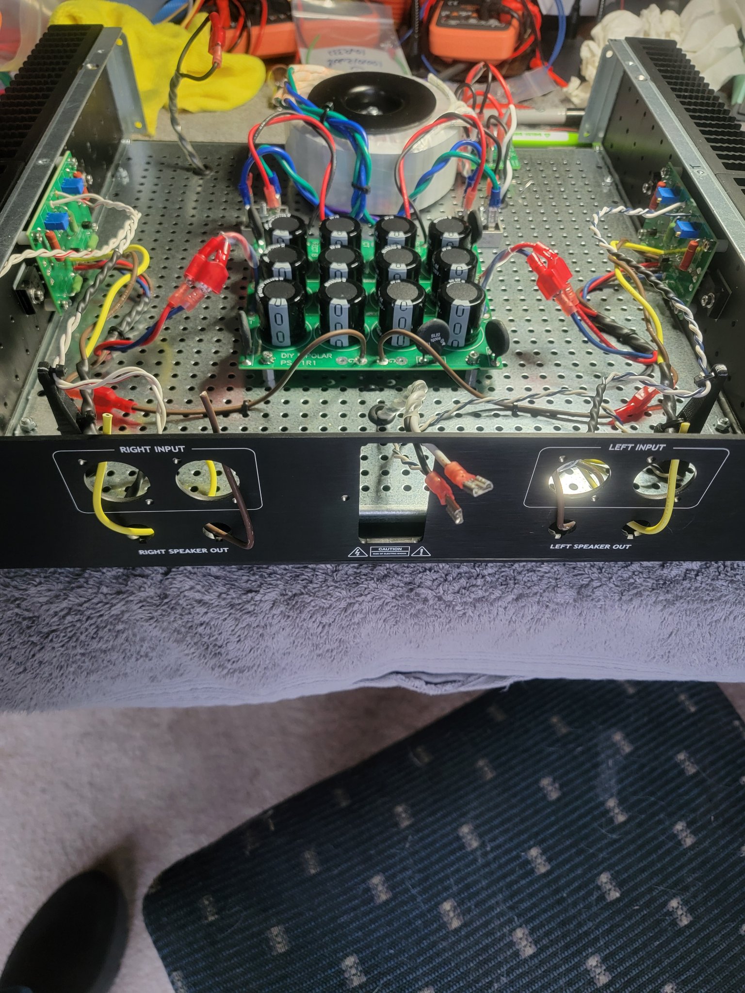

Not to answer your questions, but just to share my experience with my year old 2U build, which I'm currently listening through. It gets very hot with the lowest level of bias (1 amp), and needs to be raised to aid with cooling. If you can go with 3U then do it.
Thanks for the reply and insight...I was going by the 'lower bias' build guide and of course just got notice from UPS that all is on the way...I will say my Mini seems to be pretty warm to the touch especially after it's been on for quite awhile...and i did use a dab of paste under the outputs....but she shows a steady bias of .300mV and a IR temp gun shows a pretty consistent 52 to 54 C on the sinks..upper 30s to mid 40s on the mosfet cases...still odd to someone not used to class A....'warmth'

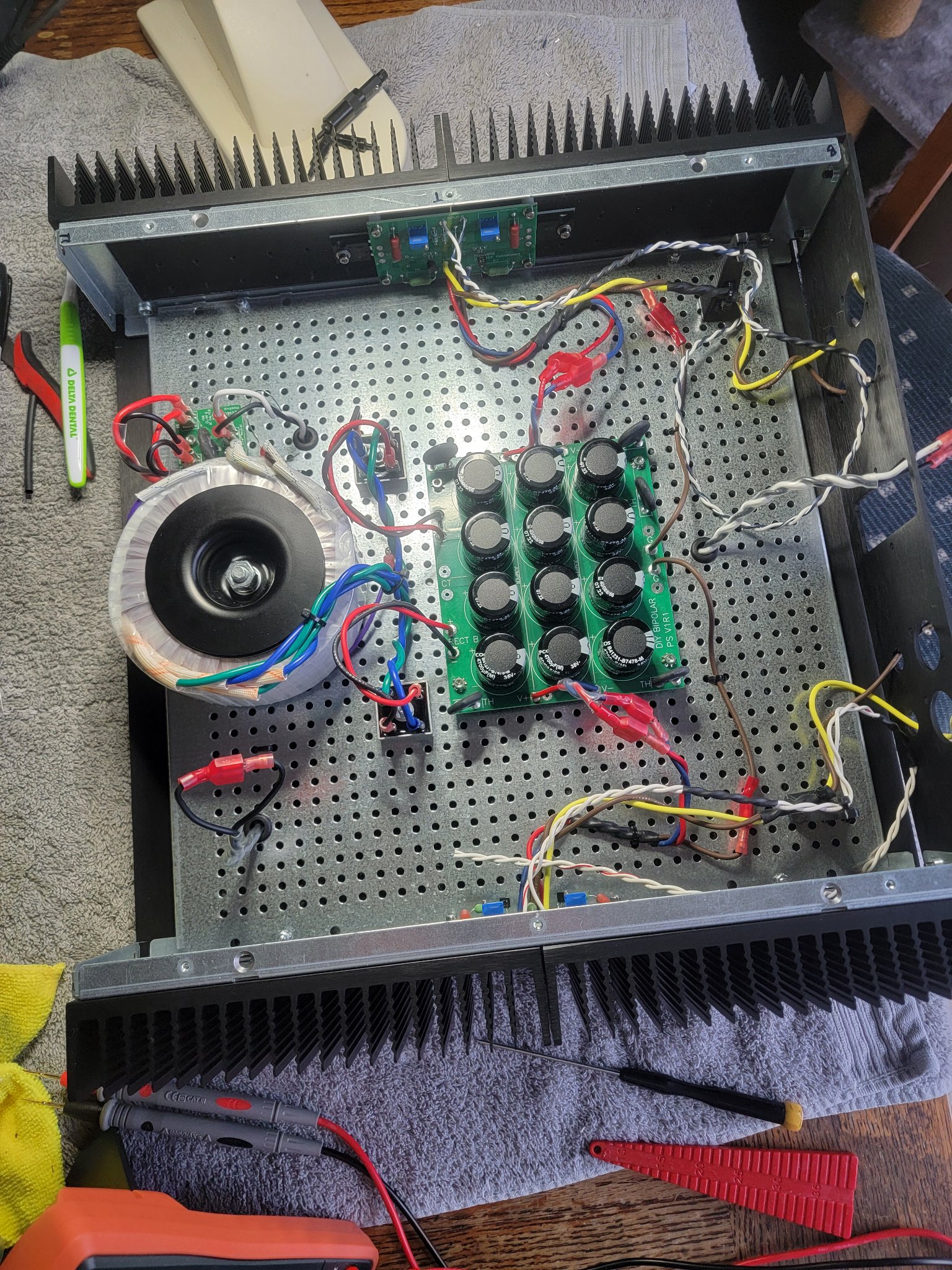

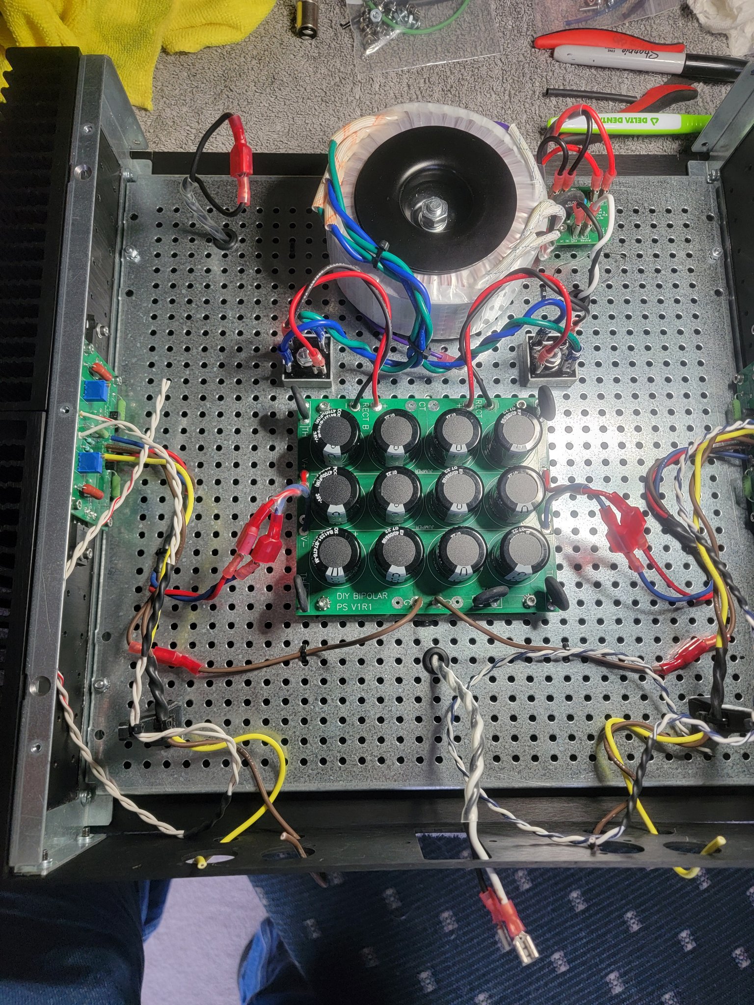

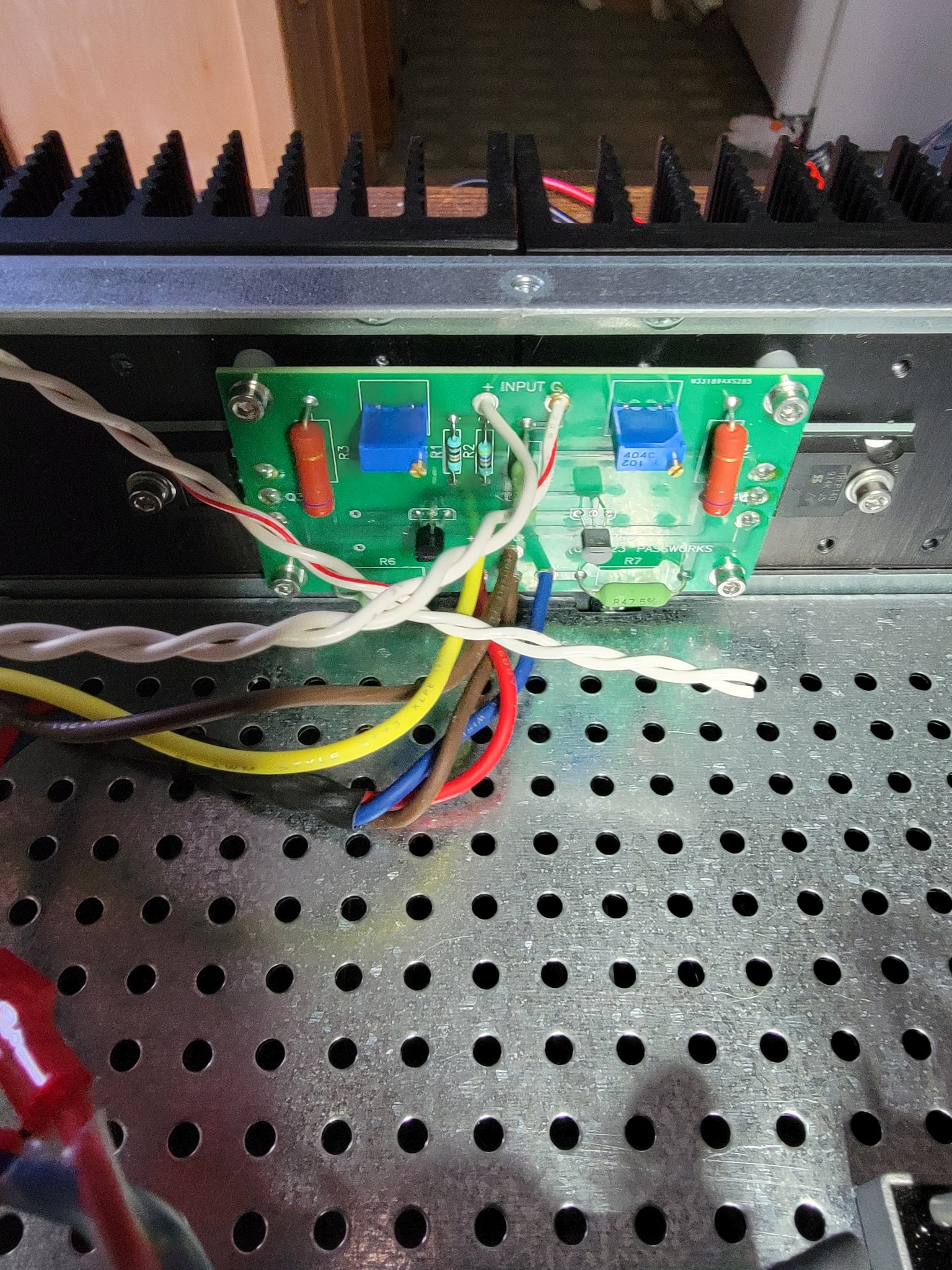

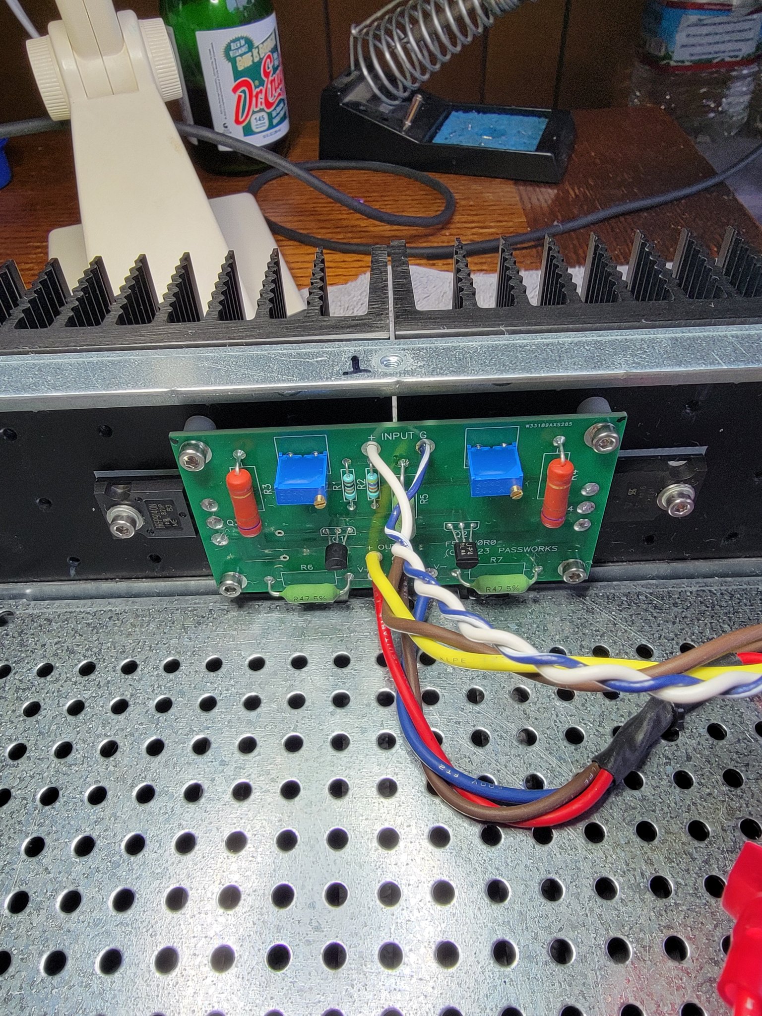

Here are some pics of where I am now, if anyone's interested.
Still waiting on the PEM, Jack's and posts.
I have done some quick and dirty PSU checks....24v both rails. Still needs final checks and what not, but I will wait on PEM before I make any attempt to see if she wakes up happy...or angry...

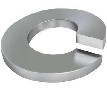

Yes..the...fender.. .washers...my understanding is it promotes better contact with the sink...spreads the load over a larger area...I did use some flat #4 stainless washers and the kit spring washers...what I had...but I don't plan on much over 1 to 1.2 on bias...depending on temps,ect I might add some ...maybe some different insulators..

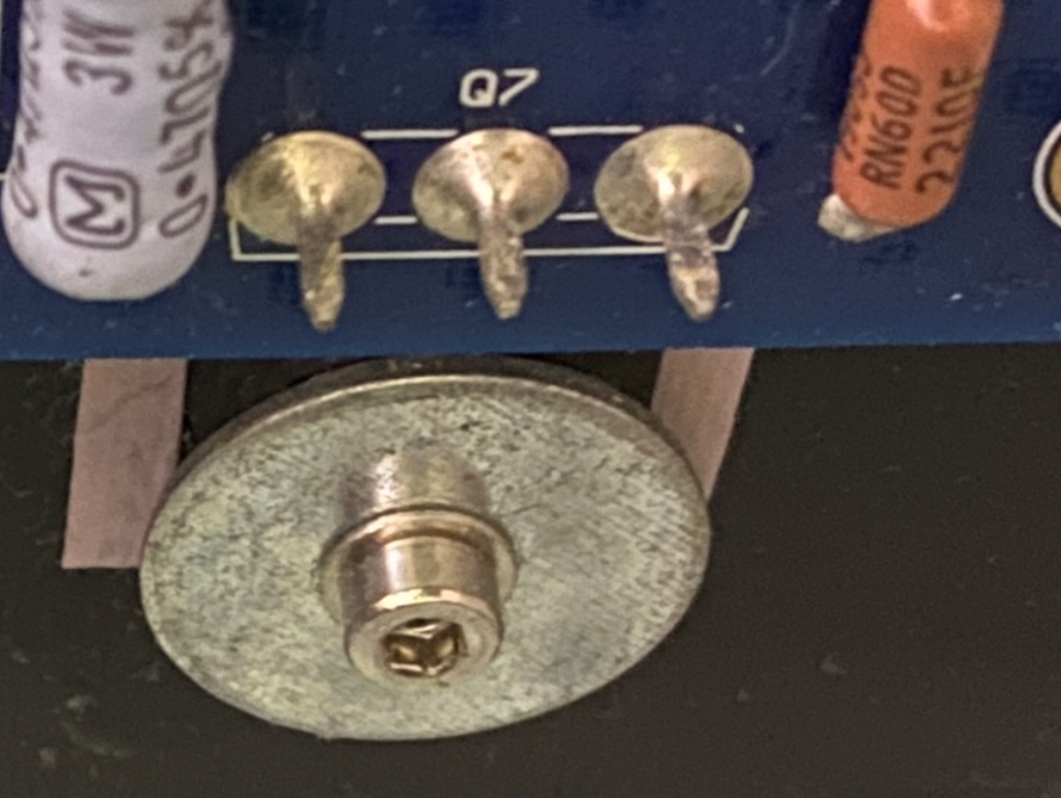

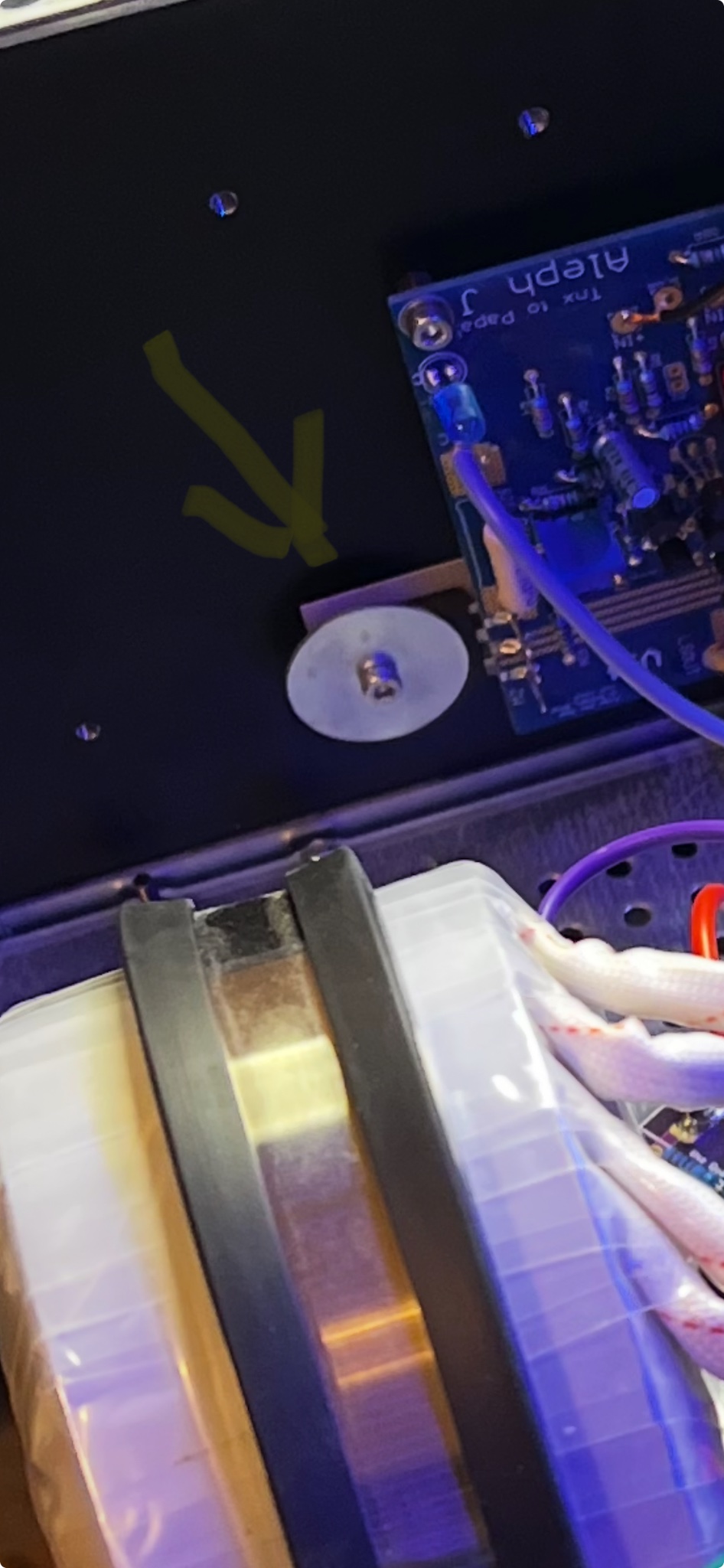

I think it won't hurt to use a larger diameter washer with solid thickness if you want to crank the bias higher than 1.2A, which is quite easy to do/be tempted to do. Once you start, it is hard to stop...
This is a slightly different FW clone, but they (all FW amps) sound better with high bias settings. I started with smaller and thinner washers and arrived at these - see below. The spring-loading little washer also helps, as JayDee mentioned above. I dissipate 200W at all times... so better to be safe than sorry in the long run.

I guess the primary reasons were that the zinc plated carbon steel is much thicker fender washer, therefore stiffer, and also 1/4 of the price of stainless. Also those ship free from Bezos Bookstore and show up the next day. All my amps operate indoors and the washers do a great job. Is there some reason I'm not aware of that makes the thinner stainless steel option a better choice?
