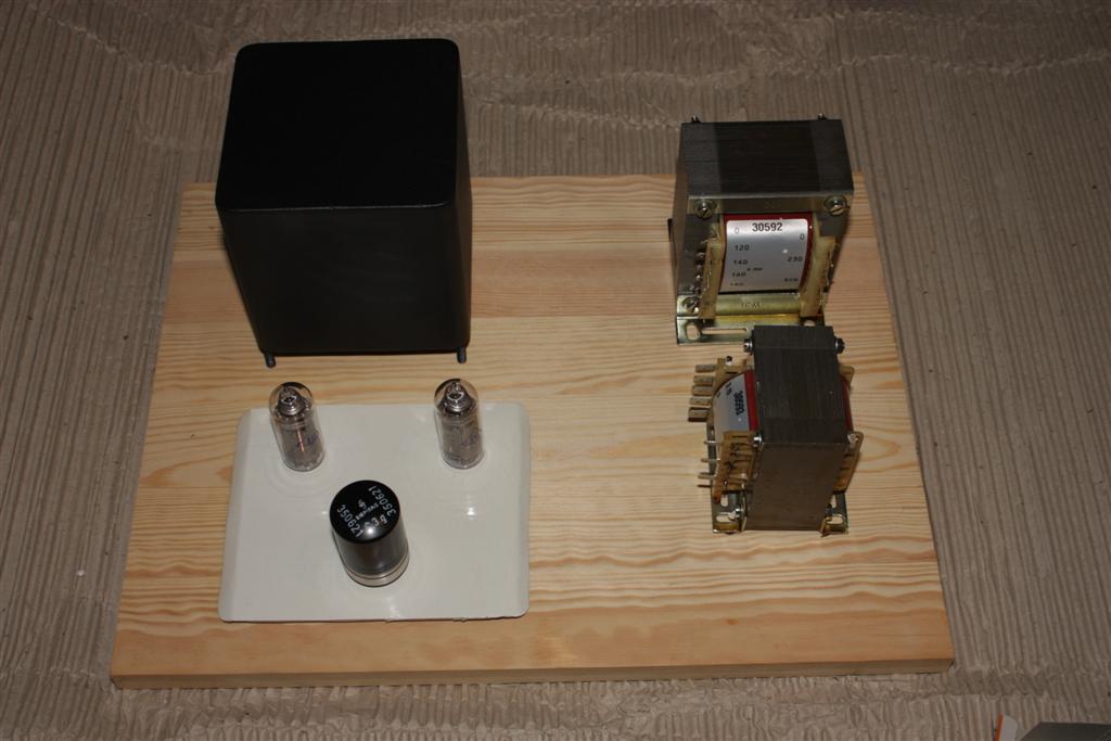

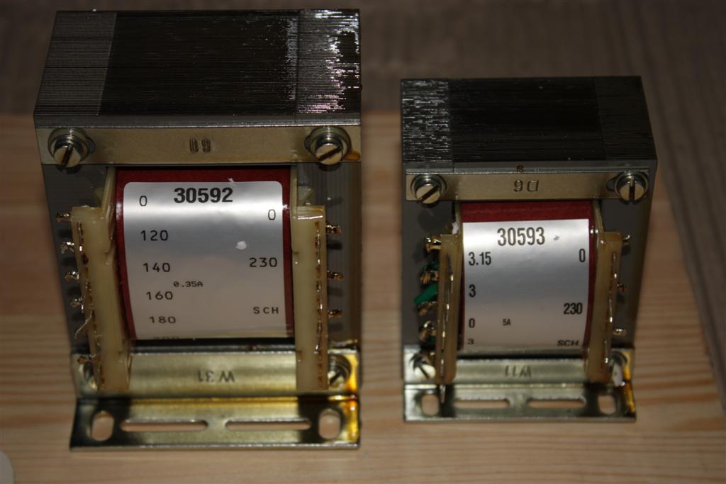

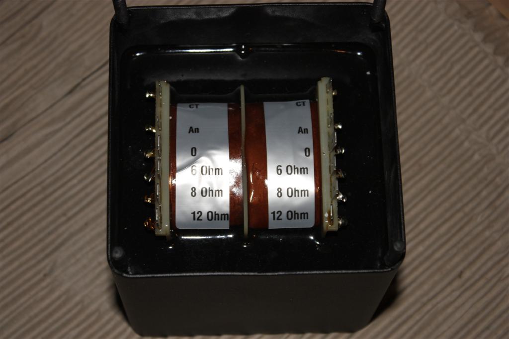

I have looked at Edcor trafos, and several others
ok prices, but shipping, custom and taxes eats on any bargains
I decided to better use the exstra expences to get better quality
or at least trafos with optimal specs
I contacted the Dutch trafo company AutomaticElectricEurope
by making it simpler I could get ok prices from them too
that means potted PP C-core OPTs without UL tap, and lowish powerhandling
multi tapped main supply trafo without heater winding
and center tapped 5A heater trafos with both 6.3V and 6V CT
regarding interstage Im in contact with Per Lundahl
I cant get any further until I have all trafos
due to long delivery time this thread may on hold for a while
maybe a month or two
as said, this is a winter project
and hopefully by then I may have forgot how much it costs 😛
see you later 🙂

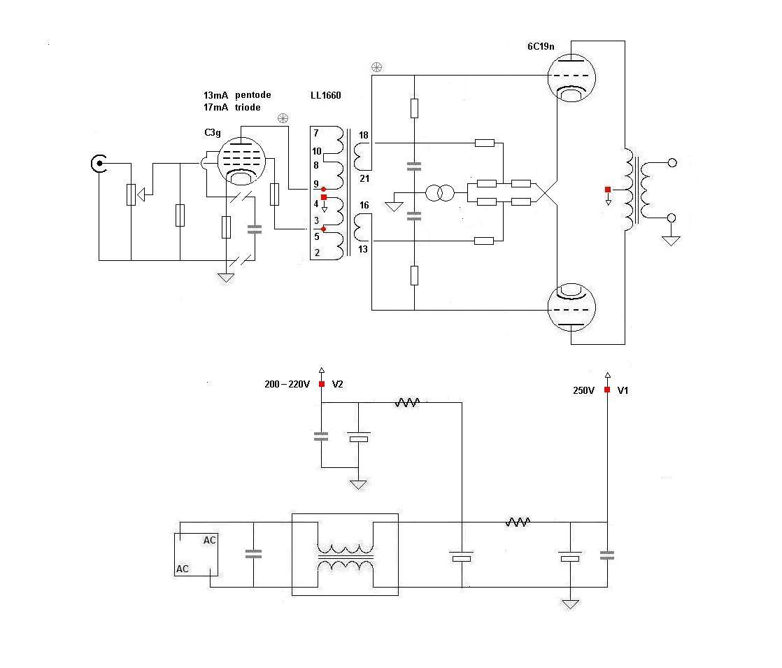

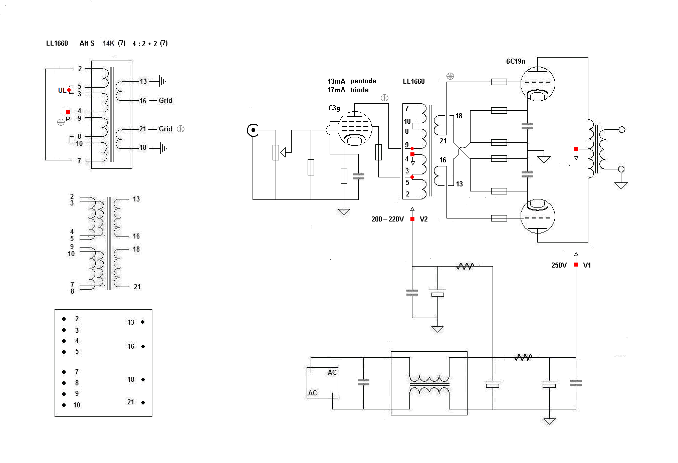

btw, am I right presuming that ripple voltage on each coil is about half of total, when series connected, as shown in schematic ?
I suppose that what is said in Lundahl spec sheet
quote
ripple voltage is approx. 0.42 x input voltage
http://www.lundahl.se/pdfs/datash/1685.pdf
though, I still dont know which to choose
I get a bit confused when it says recommended DC current
well, in my book it means the closer the better, or ?
maybe to load it better ?
any ideas which to choose ?

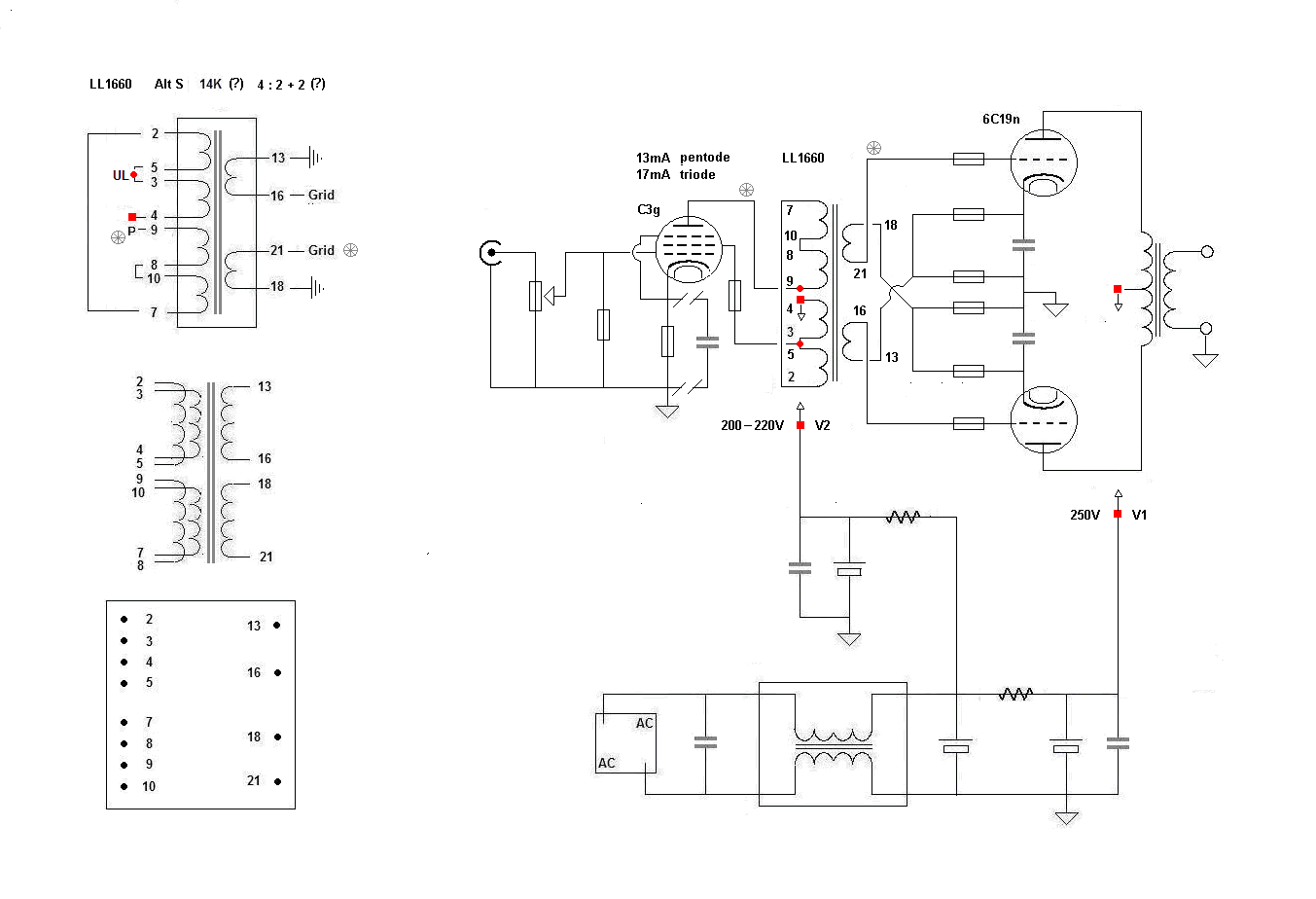

hmm, I need to post this, so I dont forget it
C3g has huge gain in pentode
and only slightly less in UL
ok
I need to deal with that
looks like my IT may be something like 4:2+2
in other words, its a 2:1 step down configuration
and next move, away with cathode decoupling cap

You need to load the C3g transformer secondary to make it work. Then Ra*Gm will be gain. Off course you also have to take the turns ratio in account when calculating. Ra should probably be something like 2-10k. Check the Ua/Ia curves!
I remember you said that

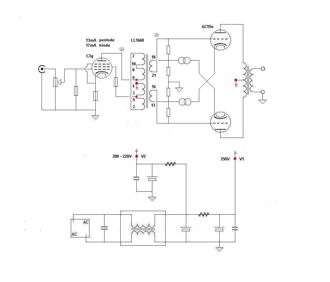

but wont it upset the BlumleinGarter ?
I suppose the resitors of the BlumleinGarter needs to be taken into account too ?
Revintage, we/you "found" a way to do the cross referenced BlumleinGarter with interstage
I can see why it was needed, with the relatively small resistor coupling
But if we look at Broskies active BlumleiGarter version
Resistors to ground are much larger
Wouldnt this not be exactly what we need, loading the IT secondary
or what am I missing ?
Wrong, they must be smaller (5-10k) to load the driver properly! Go triode and they should be larger.

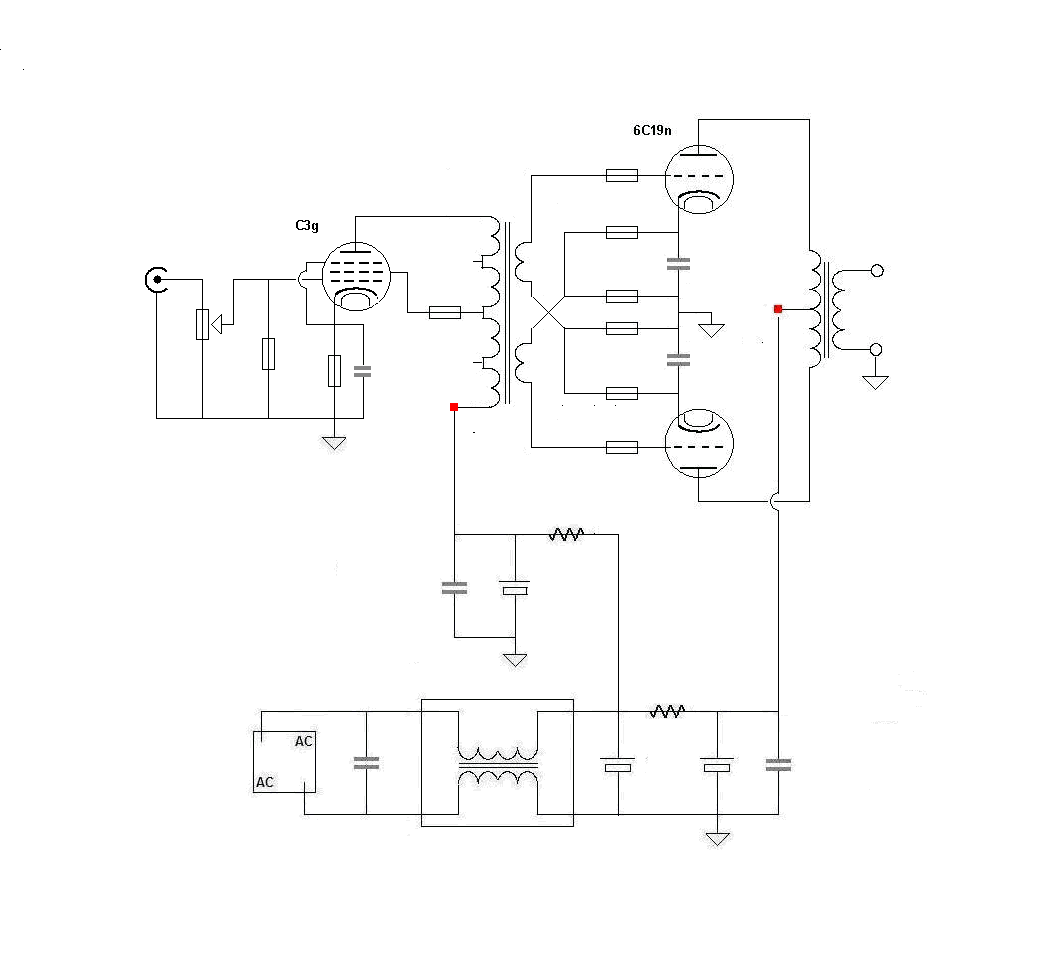

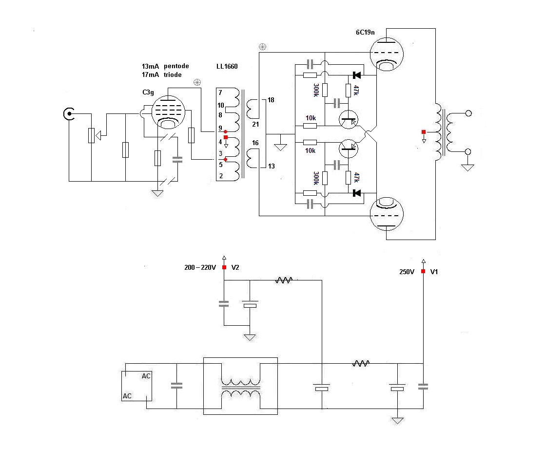

hey Revintage, nice to see you are still around
my latest version
I dont know, but I have a lot more variations
The last one I did twice, without knowing
but my first thought was hey, drawing the same schematic twice within minutes, without knowing, it could mean thats how it should be
but its probably just stupid, and I dont know for sure, as usual
