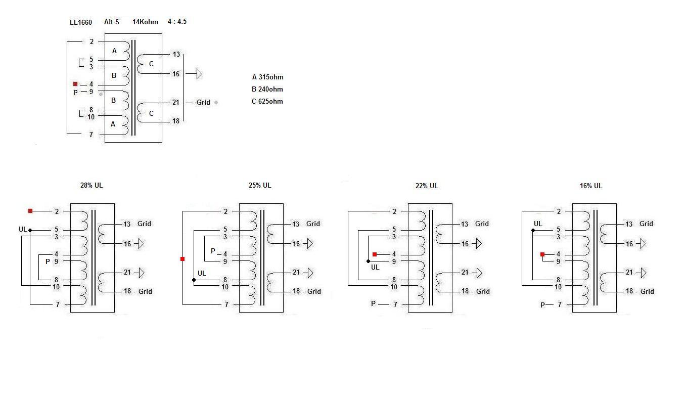

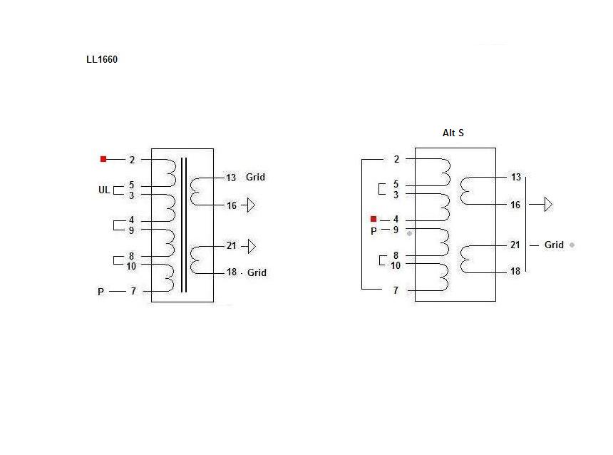

ecc99 - 6C19n PP, (6S19P)
hmm, UL tapped load is supposed to work between 15-50% "tap"
at higher percentage "tap" we are approaching penthode load, and with lesser, more triode load
we are not aiming at minimum distortion, nor maximum output
what we want is lower impedance
so I guess a smaller percentage UL tap is where we want to be
maybe like this
"Alt S" is the closest looking factory suggestion
specs are 14kohm source, 250V, 10ma, 25-40khz
and still havent figure how its phased
any suggestions how that works would be welcome

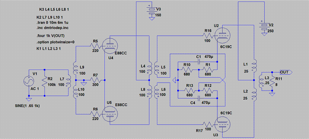

So why UL? Or, what's not to like with triode connection in this application?
Anything built, yet?
I meant to say lower distortion than in direct triode couple
or in other words, to use UL tapped IT, and optimise the coupling for low impedance instead of lowest distortion
direct triode coupled should work very well, though to me it seems like kind of brute force
but now the interstage is there, UL tapped seems more elegant, to me
surely not the easy road
but whatever, there may be something good to learn
no, nothing built yet, but tubes are bought
enough tubes to run it for its entire relevant lifetime
and relatively cheap NOS tubes of very high quality
thats one choise I made, to not worry about tubes in a few years, and the cost of them
that is, if it works, or I could possibly burn all of them in no time
I hate that thought, but ofcourse noone knows for sure

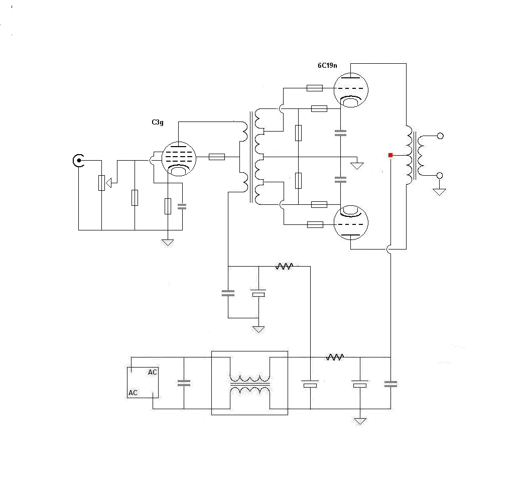

Tube amp circuits are relatively simple. So I'd suggest just breadboard what you have (on a piece of wood or whatever by hardwirings) and fire it up to see what happens. It may probably sing beatifully at the first time😀 Who knows? After that, you do the mods and other experiments. Well, that's what I do.
Just my 2c. 🙂
What looks good on paper is often not the best sounding end result. As CLS said, only the suck it and see option can distinguish between your different ideas.
Personally i have my doubts about the UL approach - but a simple wire switch will reveal the truth.
What I can say is that these regulator valve amps sound better than any other amps I have heard - mainly because they avoid the fault of most valve amps, which is woolly bass.
Shoog

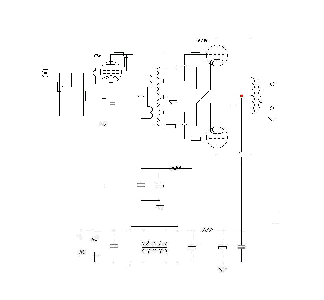

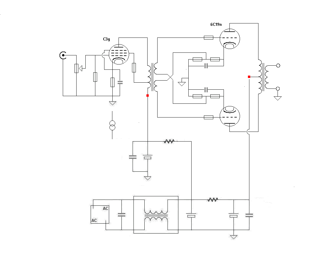

btw, its the C3g-6C19n.....ECC88-6C19n(Revintage) is for reference

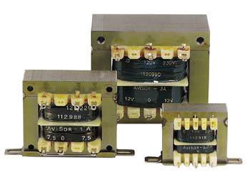

The exceptions are Indirectly heated triodes, phono and mic preamps. Anything else will work just fine without DC heaters, and there is even a case for saying that incorrectly implemented DC may even degrade the sound quality.
None of my amps or preamps use DC heaters - and all of them are wisper quiet.
These valves were primarily designed for AC (any one designed for battery operation tend to have lower voltages such as 2V or 5V), and so they are more than capable of sucking up a bit of line variation along the way.
Shoog
ok, I hear you
others say the same
I just thought...well, I guess not
AC it will be
some suggest its best to use center tapped trafo
or create a CT ground reference with resistors
buggers, its impossible to find cheap heater trafo with accurate voltage
the one I found is 9V
hmm, hope it will be ok to adjust voltage by resitors ?????
or a bit of unwinding maybe :idea:
EI transformers are best because they filter out line hash, which will bleed from the heaters to the cathodes, toroidals let it all through. The effect maybe minimal - but if you live in a very dirty supply area - maybe it wont be. Going DC would make this even worse because the massive charging spikes become harmonic spikes throughout the circuit.
It maybe OK to use a 9V toroidal, but some sort of line conditioner on the mains input would be advisable. Unwinding toroidals is a piece of cake and probably the better option over resistive dropping. Another better alternative is to wire your heaters in series to get a 12.6V heater supply (this is what I tend to do). A 12V transformer will be fine, especially considering that running your heaters lean will tend to linearise the valve response and extend valve life by 2x or greater.
Shoog
hmm, series hetater for 12V ? I still have C3g at 6.3V ?

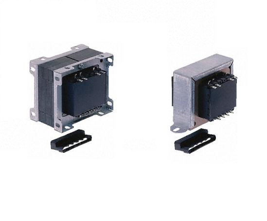

I found EI trafo with 2x 6V, 2.5A
looks ok
found another supplier
2x 0-6V, 50VA rating, and weighs twice the above(1kg)
theres also a 2x 6.3V, 20VA from same supplier
but I might prefer the 2x 0-6V, 50VA
