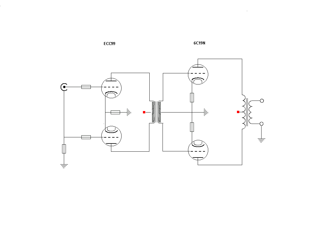

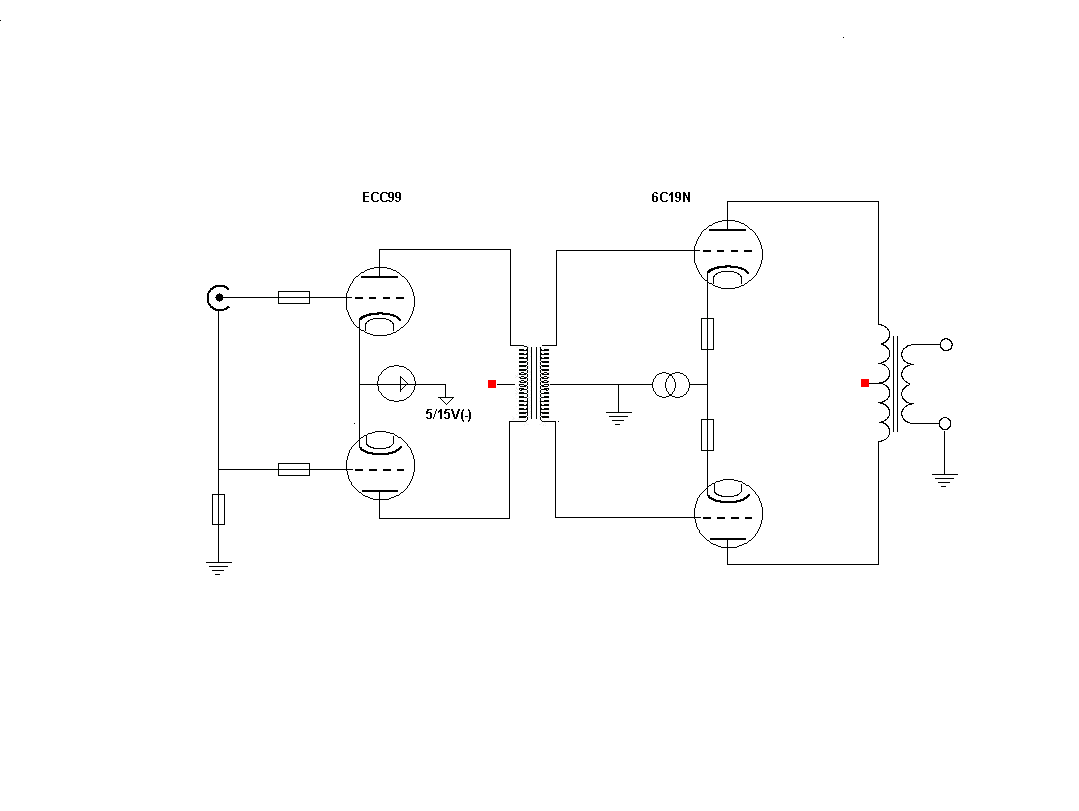

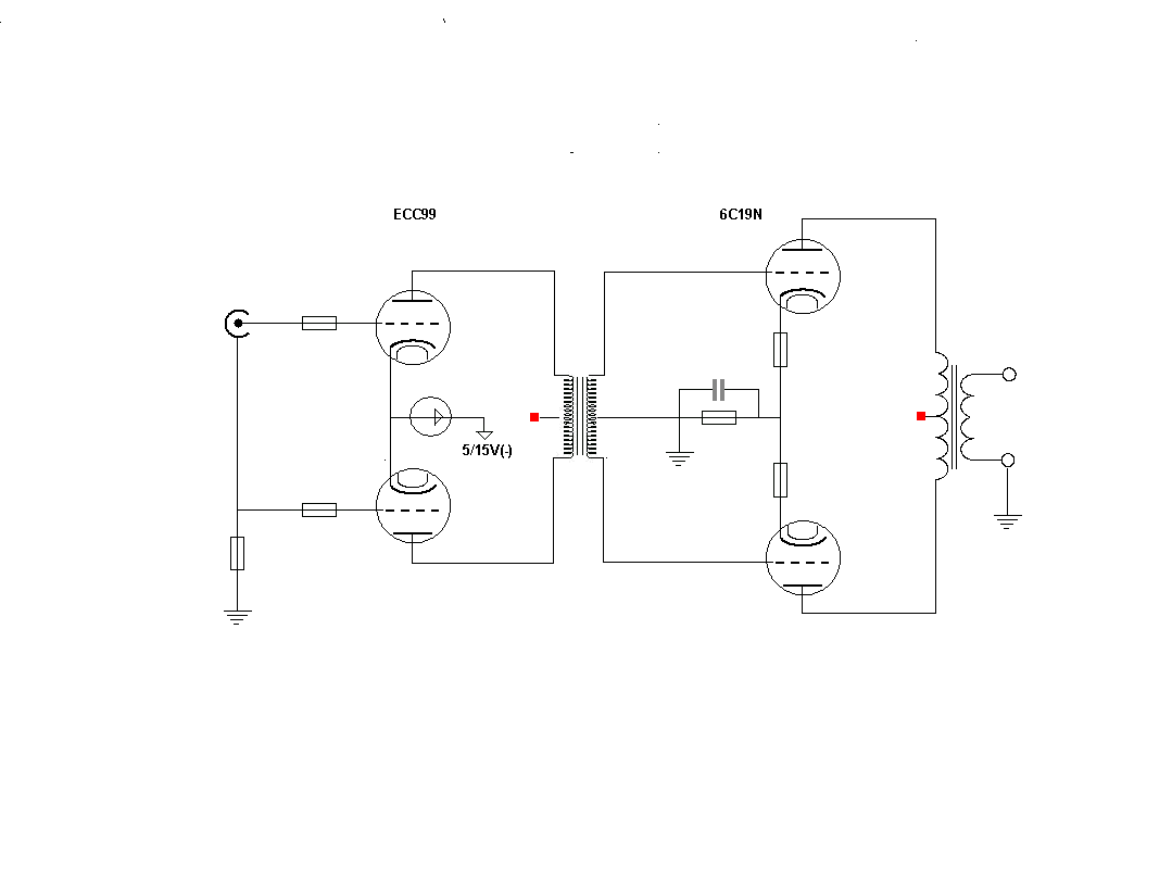

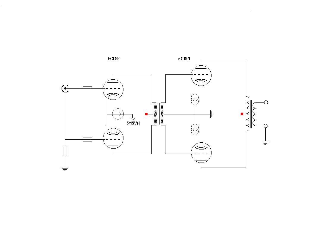

Hey, I bought a bunch of 6C19N, to get started
ECC99 seem to match as driver
Should I use SE or PP driver stage
Interstage trafo could be coupled for 1:2 gain with SE to PP configuration
With PP to PP configuration only 1:1 seems possible
I could consider a line trafo, but those are expencive
Would nice with some input on this

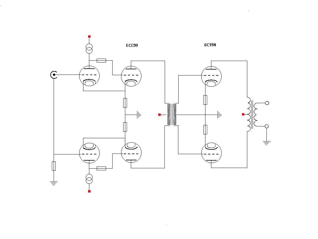

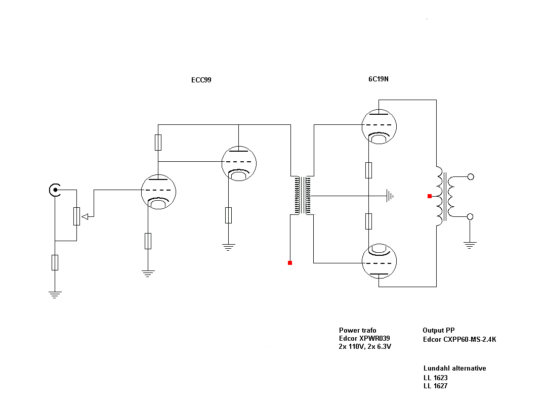

ahh, maybe a kind of SRPP
better forget that one

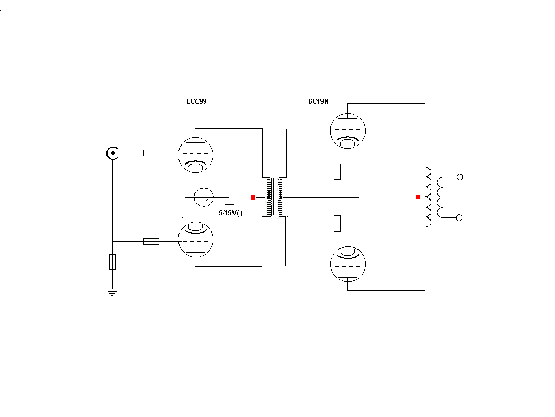

Its my understanding that adding some negative or positive bias voltage is lowering bias current, to make tube run cooler
And I dont think thats needed here
I dont know if it makes any sense to use another driver tube 😕
maybe something with biasing the second driver stage driving the IT ?
Im not sure about CCS on first driver stage B+
I read that it puts hard load on supply 😕
any opinions ?

That won´t work! About #1 you must have a CCS-tail and -supply with unbalanced in. Skip #2!
I am building a 6S19P PP at the moment. The driver I am using has a gain of about 35 and my preamp has a very high output-more than 2 volts. ECC99 seems a little marginal in gain as the 6S19P has a mu of only 2 although you could use an input step up xformer as the phase splitter. It would be less expensive than an interstage one I would expect.If I was using a single ended preamp I would probably use a triode connected EF184 differential pair phase splitter with a constant current sink. The gain of this is about 60 and this valve is very linear triode connected.
revintage, you come to my resque once again, thanks 🙂
I understand, front end as in your schematic from my previous thread with ECC99 PP
negative supply voltage is Ug(V), and curves say from -5 /-15V, depending on B+, right 🙄

1922 will probably have to low input Z for most sources. 1676 connected 1:2 will work though. If signal is lower than 2V 1544 or 1545 will also do.
About your new circuit it looks OK. But you could use fixed bias through the transformers secondary midtap. If not you could use common bypassed cathode resistor.
Sorry, I can only give SE estimate quickly; If you choose an operating point of Va =190V, Ia =50mA and a 2k load, it looks like you could swing about 230V pk-pk =81V RMS which should give 3.3 watts with this load. I suppose you could count on doubling this,more or less, push-pull. With reasonably efficient speakers, this could be plenty. Or,you could use 2 pairs in parallel and half the load. If I were doing this I would compromise and use a 1.5k load for parallel operation with lower distortion.

Go for #1, it will work fine.
thats great, thanks 🙂

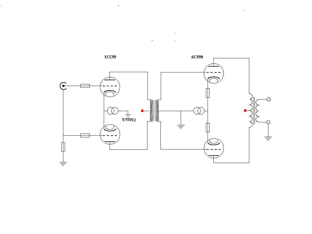

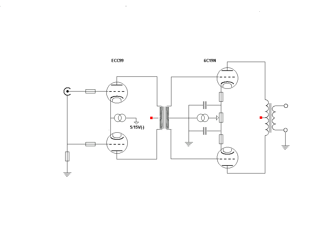

maybe this one is closer to what you meant ?
bypass ?
Im not sure what you mean

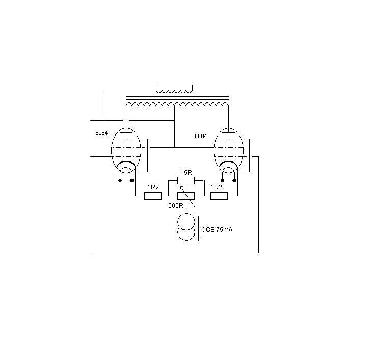

I thought that a CCS would replace the cathode resistor and bypass cap
but maybe the IT is a teaser now
borrowed this EL84 bias from DHT Rob
but SE driver, and no IT
probably different

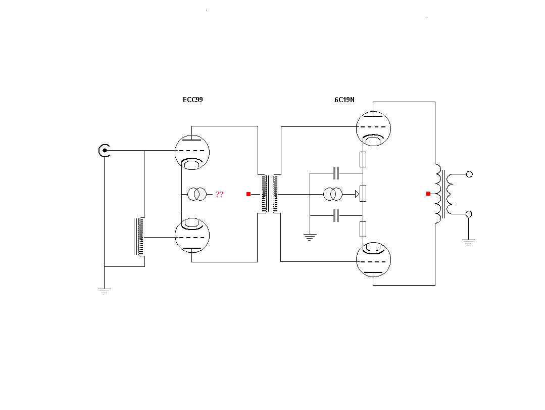

that was very important to learn
Im still thinking about it, and it begins to make sense
and maybe Im beginning to understand how it changes available B+, steals voltage, so to speak
I suppose it means that if using input line trafo in SE to PP phase splitter configuration, then theres no need for dedicated negative bias supply

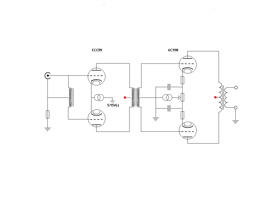

btw, bypassing ccs as you suggested, could it look like this
what kind of cap is needed
smaller film cap ok ? or supply cap electrolytic ?

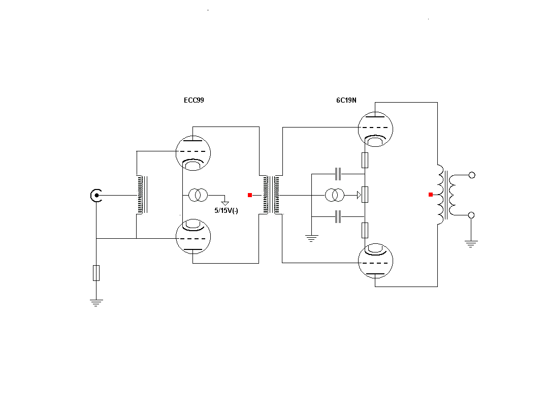

I also thought about mounting grid choke like this
looks to me like kind of a phase splitter
but Im not sure it will work this way
or maybe turn it around and connect midpoint to cathodes ccs
