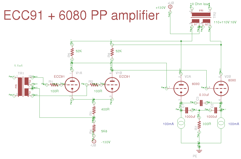

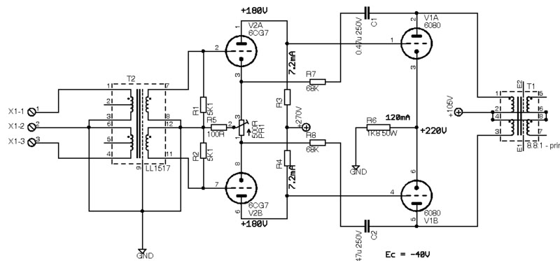

Interstage transformers are horribly expensive so why not dump them and use an input transformer. With a decent low Z preamp you can use a 600ohm line transformer with great results.
If you are interested I can post my 6080 amp to show what I mean.
Shoog
Hey Shoog,
If we are talking high quality transformers the prices are actually on par. A LL1674 costs 104EUR and a LL1660 costs 104EUR.
If using a LL1676 there will be no problems impedance-wise with any source.
Using an input transformer opens up another possibility as one can use DC-coupling between driver and output tube. Didn´t you use it?

I have used OEP 600Ohm line input transformers which are about €30.00 each. I can't notice any issues with them, though I haven't done any significant testing. This is definately the best amp sound wise that I have built.
As you said using an input transformer allows direct coupling, and in my case I used Schade feedback ala Gary Pimms Tabor. It is all surprisingly simple and elegant with quite a few built in refinements. I certainly don't think the OEP's do anything bad.
Shoog

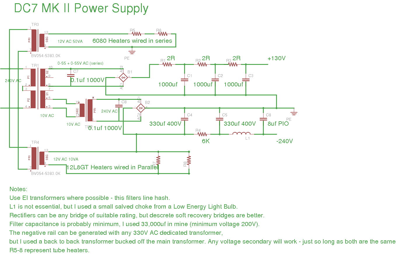

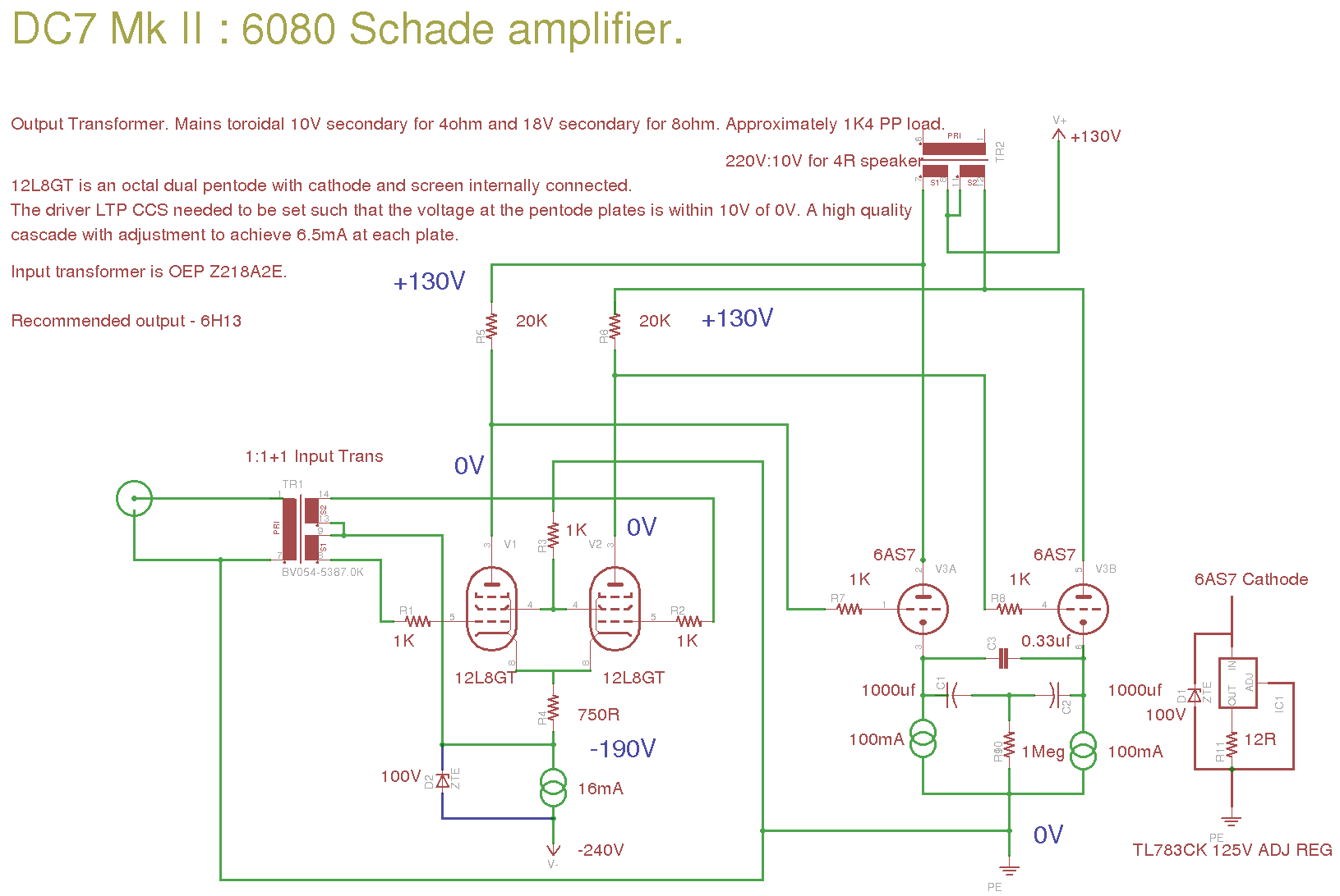

Here goes;
Shoog

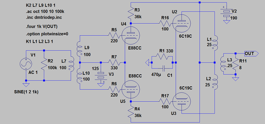

This is a variation on Shoogs wellproven theme with the more linear 6C19 together with triode drivers.
If building with mains-toroids as OPTs it is easy to add a Rod Coleman-style servo to keep currents equal.

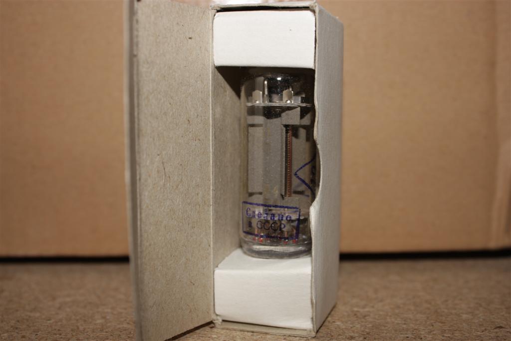

Wavebourne may not see your post; if you check the Cyrillic alphabet you will find that C= S which means single triode, the letter "pi" is P which means miniature base either 9 pins or 7. There is no N as you write it in the Cyrillic alphabet only a letter which looks similar with the centre stroke going the other way; this is the "ee" sound and on a tube means for impulse operation. The only variation on 6C19"pi" is 6C19"pi"-B which is a mechanically more rugged version of this tube.

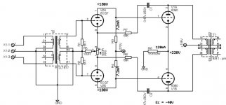

I have a question regarding linetrafo
LL1922 and LL1676 looks very alike, specced to a 600ohm source
Though, LL1676 has 10kohm out, and lower than LL1922 with 47kohm
is it the lower 10kohm out that makes it easier to drive, in respect to driver tube, and maybe also the lower 1:2 gain 😕
btw, LL1676 is top quality with amorph C-core 🙂
you are right, small letter "n" looks a lot like the mathematical symbol for "pi", but could easily end up as capital letter "N", which appears to be wrong
6C19"pi" it is then, probably :up:
what I meant was that if called 6S19, it must have been relabelled with western letters
while in production, I suppose this tube has never left Russia
letters CCCP clearly indicates that
