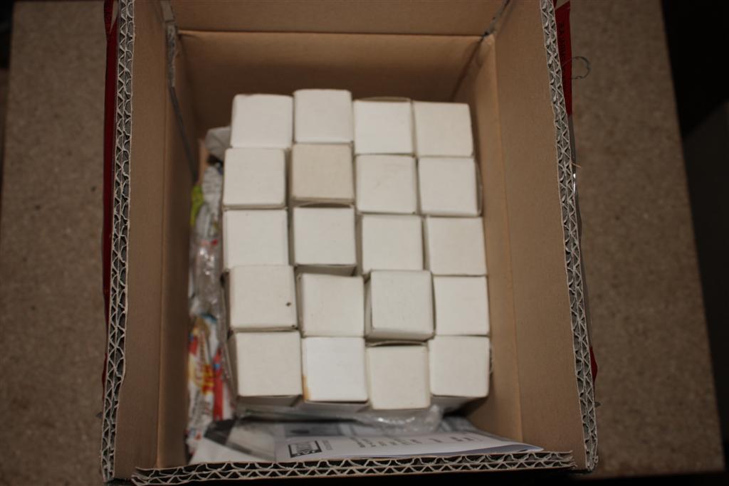

about having this amp for a long time, I bought 20 tubes 😉
4 tubes in two monos, and playing maybe 2-3 hours a day, means they will last a long time

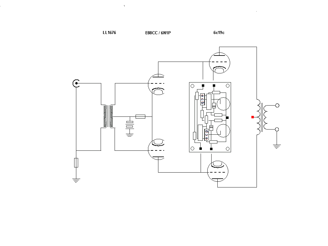

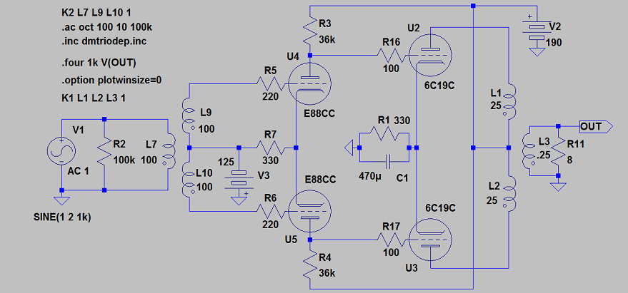

I think you are now considering the power supply,no? It will need to be regulated I would say as you are not using ccs to bias your pairs-and having just made 6 constant current sinks with goodness knows how many transistors I completely agree with the advice of Lars to keep it simple. Have you read the excellent series on Steve Bench's site about regulators? It is an excellent learning guide whether you intend to use tube regulation or not. You may get away without it but there is quite a big current swing.
regulated supply needs higher voltage trafo, so I need to decide
any idea how much wattage(VA) I need for B+
and I need negative voltage too
maybe I could use regulated supply on negative only, to driver
125Vac trafo should give the 190V b+
that is with no chokes
and 125Vac should be just about ok to give -125Vdc regulated
but ofcourse 220Vac trafo could be regulated to both 190Vdc B+, and the -125Vdc

Ok, I have thought a little; let us assume that you can match the tubes-maybe ask Wavebourne if he thinks this is realistic. Then try passive supply-separate heater transformer 50VA is enough for everything(unless you are going to use a tube rectifier). Wire it so that heaters come on as soon as you plug it in but B+ is switched on whenever you want. Very simple; Silicon bridge with each diode bypassed(or tube if you like!) small film cap(0.22uF) Choke 20H 150 mA,another small film cap,same value,then 470uF 450V and then the supply splits between output and driver stage. For output stage 220 ohms and 100 uF, for driver stage 470 ohms and 100 uF. This inductive filter has LF resonance of less than 2 Hz and when you get the chokes measure the DC resistance and add series resistance to make it up to 400 ohms. You should not have more than about a millivolt of ripple and I would suggest that you bypass the final electrolytics with suitable film caps of a few uF. The green Russian ones,either K75-10 or(slightly smaller) K75-24 are absolutely marvellous for this and very good value! The bypass caps should be in the amp case and not the power supply case. If you can match the valves reasonably this supply will work very well.The separate spurs for output and driver means that a regulator should not be needed and there will be little common impedance coupling between the stages(which would be degenerative anyway)

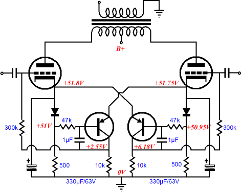

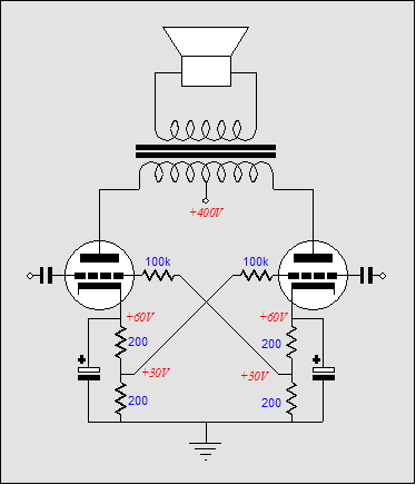

If you can bare to waste a bit more voltage and want to keep it simple, Garter Bias works extremely well to keep the outputs matched.
http://www.tubecad.com/2005/May/blog0046.htm
http://www.tubecad.com/2009/04/blog0163.htm

thats need more study
maybe the simpler version with balance adjustment, and a balance meter, somehow
Broskie does seem to conlude that common bias resistor/cap works better than having seperate
common bias was also suggested previously by Revintage
but its my understanding that 6C19C are like factory tested quality tubes
maybe they wont be very far off
its mentioned that one reason for this balance bias scheme is problems with OPT core saturation caused by imbalance
I dont know, but with this low power, there might never be any issues with saturation

I used plain resistor garter bias on a headphone amp with toroidals as outputs. The valves were ECL82. Any imbalance much above 1mA will induce core saturation, so this scheme keeps imbalance down to that region.
As you have noted specialist OT designed for these low plate to plate loads tend to be madly expensive because of the very low demand. Surprisingly these are some of the simplest transformers to get right so cost is in no way a reflection of cost of manufacture (apart from tooling up for small production runs).
The power transformers I have used are about 35Euro and they work from about 10hz up to 50kHz in these circuits.

These high current low mu tubes are very difficult to manufacture consistently so variability is likely to be high. Also since they are designed as pass regulators this is not a high design criteria anyway. If you fancy adjusting the bias every few weeks/months then thats fine. Remember as well that bias will only settle after warm up, so if you have adjusted for hot operation the amp will sound unlistenable until it comes up to temperature. Needless to say, I have never experienced the Joy of bias adjustment.
The great thing about the transistor version is that for a tiny bit more complexity you suffer no voltage/heat penalty.

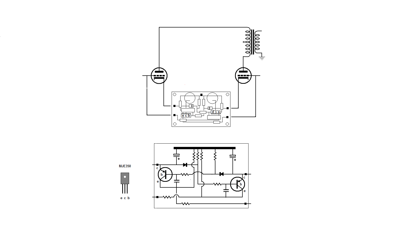

on a second glance, it doesnt look so complicated
transistors are pr Broskie ordinary like MJE350
yeah, I could be tempted to give it a try 🙄
and alone checking dc out on OT would tell if it works, right
sounds almost too easy
wow, I like this
thanks Shoog

It seems to me, that the battery does no good, as and you are still using cathode bias in your schematic.😉
