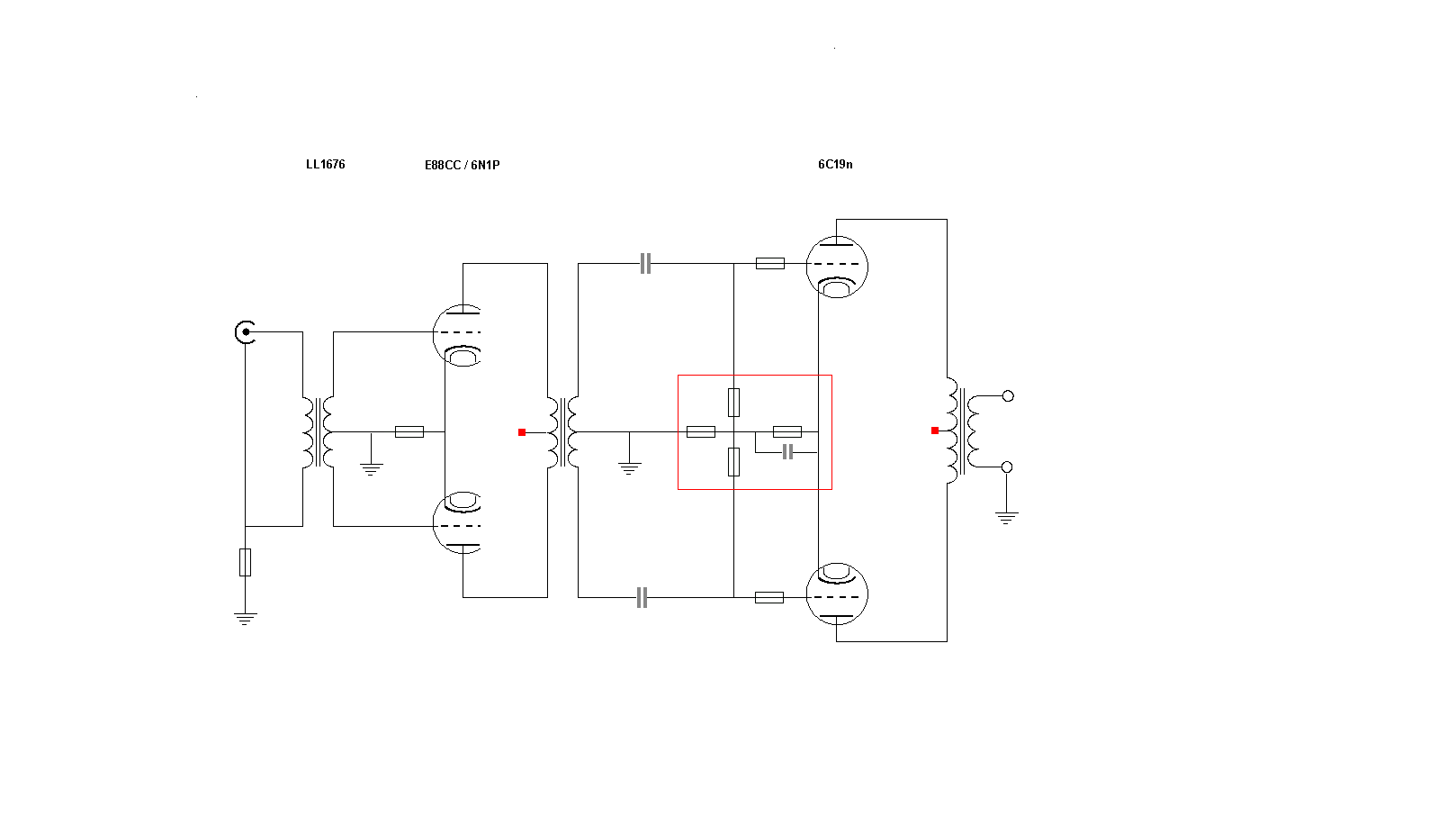

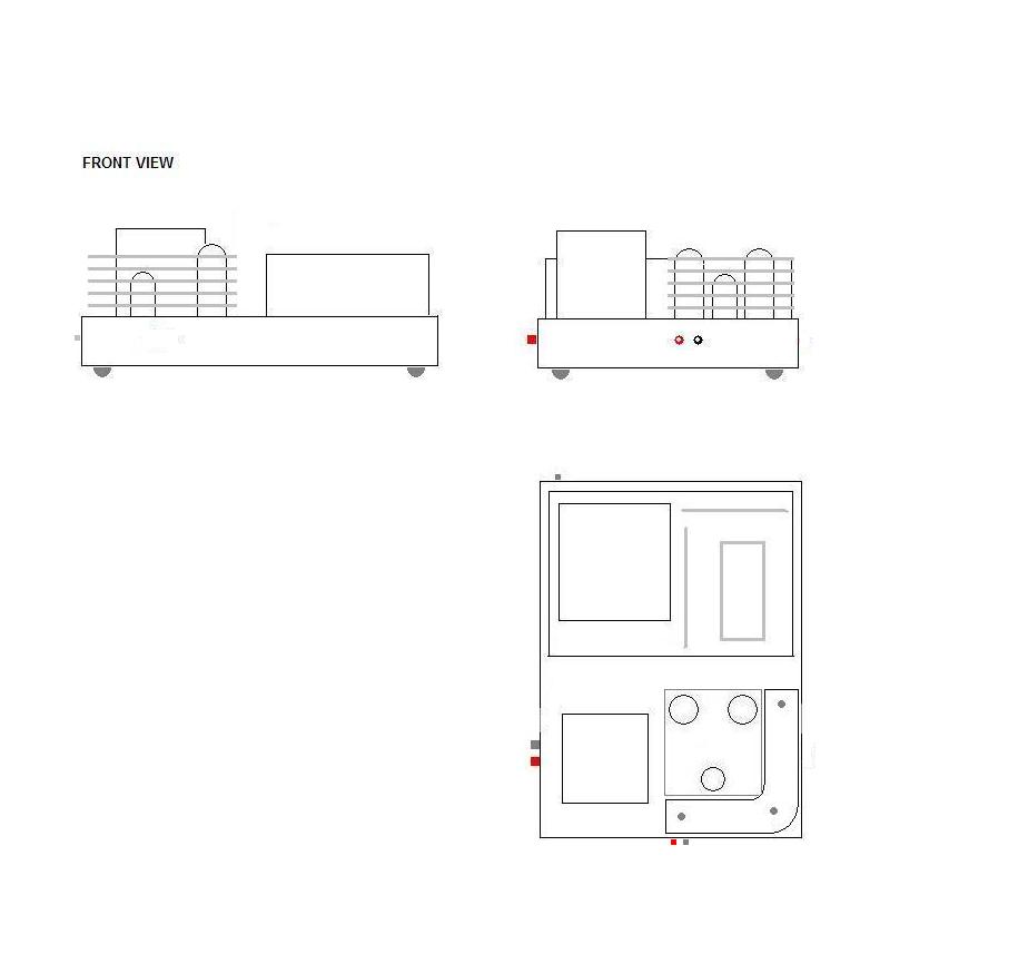

An interstage can swing symmetrically either side of the driver staged B+, so given a B+ of 190V and a plate swing of +/-60V you get a range of 250V to 130V. Its the same way an output transformer works.

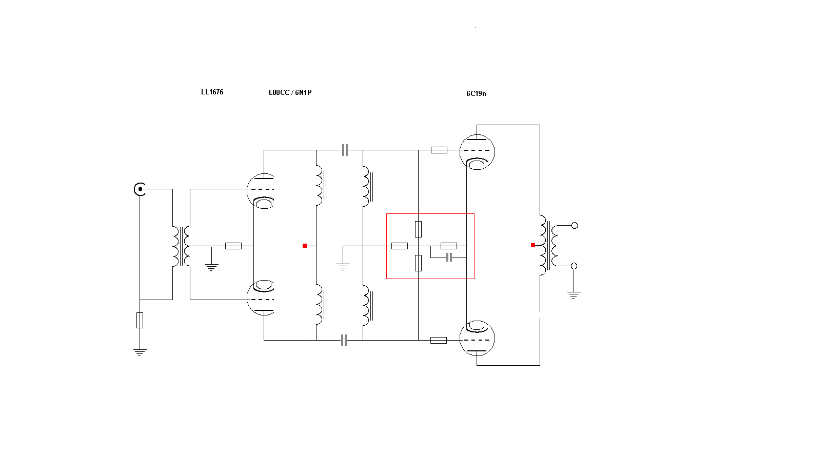

ok, sounds good
but it couples inductively
where to place the cap, and get away from direct coupled 😕
well, maybe I just couldnt get myself to put in the cap when using IT
seemed like a waste
but maybe using IT still could make sense, even if "RC" coupled

Maybe this is an example but given the fact that E88CC should have an Ua of 120V we need a B+ of something like 130V to compensate for the RDC in the IT.
Unfortunately the IT solution does not allow the Gartner. To use coupling-caps together is somewhat surrealistic as we can skip the IT if using them😉.
Unfortunately the IT solution does not allow the Gartner. To use coupling-caps together is somewhat surrealistic as we can skip the IT if using them.

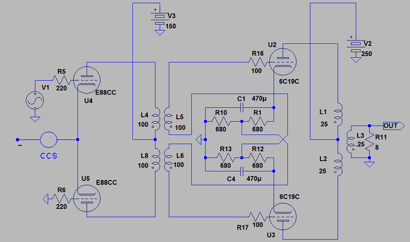

You are right of course, but using simple LM317 CCS's gets around that problem and allows for direct coupling. It really is an elegant solution - even though most people resist it.
The choice is - use a coupling cap, which can be chosen for it sound quality, but will always be subject to blocking distortion if driven to hard.
or use a cathode bypass cap (with bypass film cap) which has to be an electrolytic - but it is subject to 100% degenerative feedback which should eliminate most of its nastyness.
Its just about the decisions which you want to make. Personally I have built a 6080 amp with IT and it sounded great. I have built a direct coupled version and it sounded better. Given that the IT was only a cheap one comparison is not straightforward. Both had LM317 biased cathodes arranged as a differential pair at the outputs.
My 2cents worth is, if you can do it with a simple IT, then the amp becomes very elegant and simple (with no plate load CCS and no second power supply) and will definately sound top flight.

The caps on the garter bias are wrong. As RV has said - you can't use both Garter and IT without adding caps before the grids. As it is you are averaging the bias adjustment between sides which will mess up both sides. Also you need to bypass both resistors on both sides rather than just the bottom resistor.

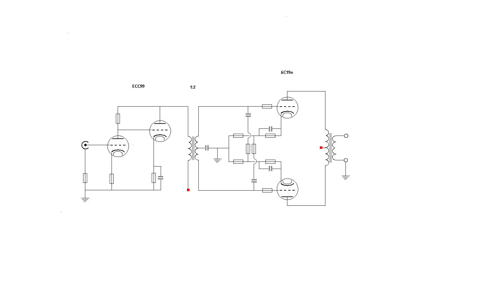

Hey Shoog and Tin,
This might work to get rid of the coupling caps before the output tubes. Don´t mind the component values.
Thats a really clever solution RV and I can't see why it wouldn't work.
I like the idea of keeping the LTP at the front, but only driving one input grid chucks away half of the gain (which is an issue here).
For the small extra cost I would add in an input transformer which would double the overall gain, and also possibly allow for the option of stepping up by 1:2+2. This seems like a sensible use of funds to me.
Something like this worked very well for me;
http://ly.rsdelivers.com/product/ox...2e/1122-pcb-mount-af-transformer/2106419.aspx
Because of the light loading frequency response will be better - though ringing maybe an issue. Its worth a punt as you can always upgrade it later if you find you need the extra gain. Primarys in series gives 1:1+1 primaries in parallel gives 1:2+2.
