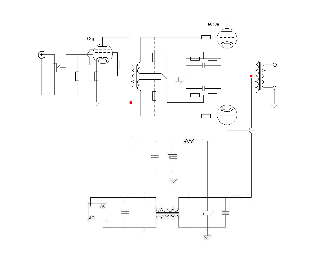

My good friend Revintage will be pulling his hairs when he sees this
Every time I am offered a fine scheme, things change again
well, so far just an idea
it "looses" one(two) expencive input line splitter trafo
and with a C3g even better drive
and no worries about balanced driver tubes

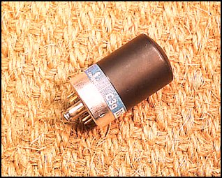

did you look at C3g specsheet, its not just any ordinary penthode
its supposed to be a good interstage driver, low impedance and high gain

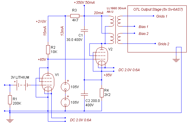

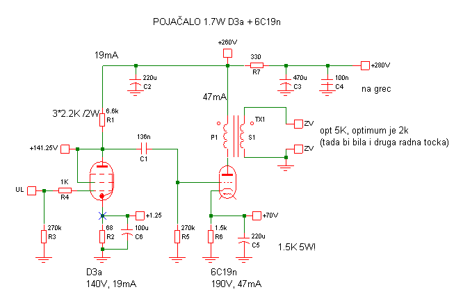

and I found these two designs
right, you did say that, yes
Im trying to figure how to wire that interstage (LL1660)
another good man with knowledge suggested to wire it in UL style
symmetric 50% wouldnt be hard, I guess
but Im trying to find a way to paralel some, and series other, on primary
but maybe it will give issues with the symmetric PP secondary, and result in unbalanced output
I dont know

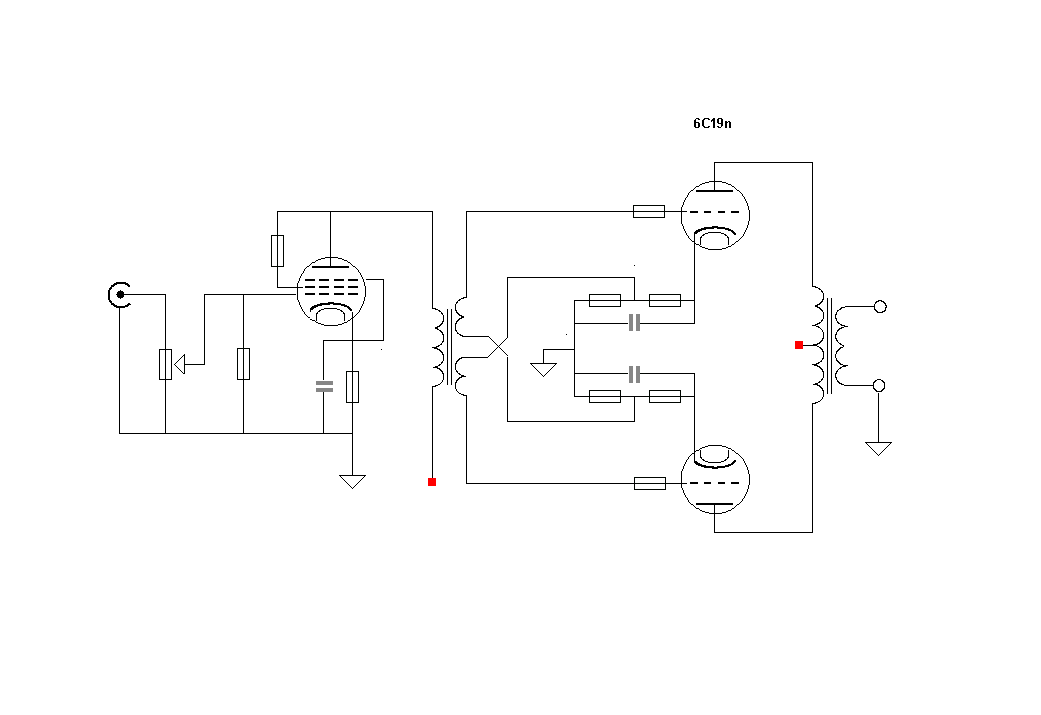

preliminary schematic
so far I understand that when triode coupled, plate(Ra) and inner resistance(Ri) are in paralel, which gives the desired low impedance
UL tapped through trafo they are still in paralel, I guess
but also with trafo impedance in series
well, I see the dilemma now 🙁

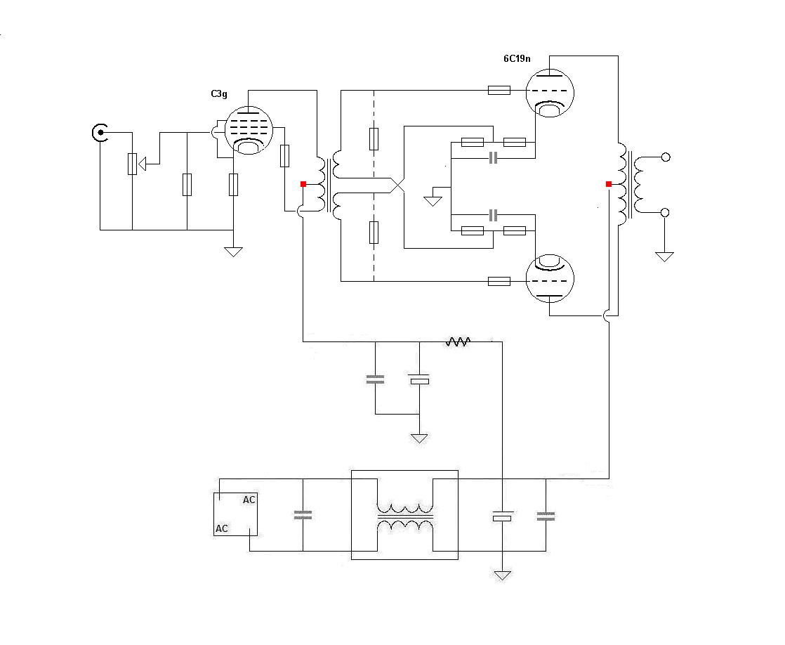

Hi Tinitus !
Dont you think that you will get enough amplification with the driver tube in triodemode ?
probably, yes
but distortion doubles
UL tapped lowers gain and impedance, and thus even less distortion
and if accepting a small portion of step down from interstage, it may improve things a bit
but sure, I may be chasing a wild goose:faint:

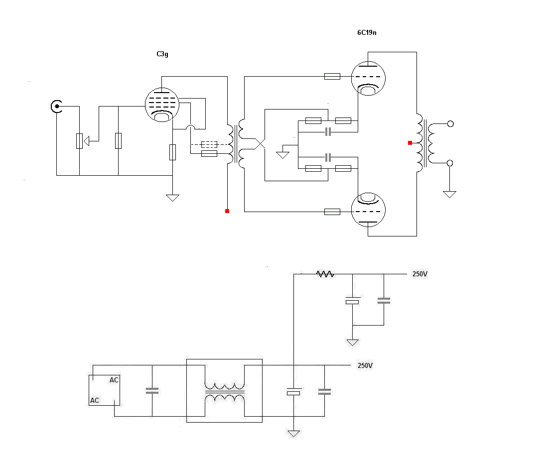

and there is another way, like using a simple autoformer as phase splitter
I have seen that on Electraprint site
but then we are back to a cap coupled design
or parafeed
but then, some say choke or CCS load is useless with penthodes
and so it goes round and round
