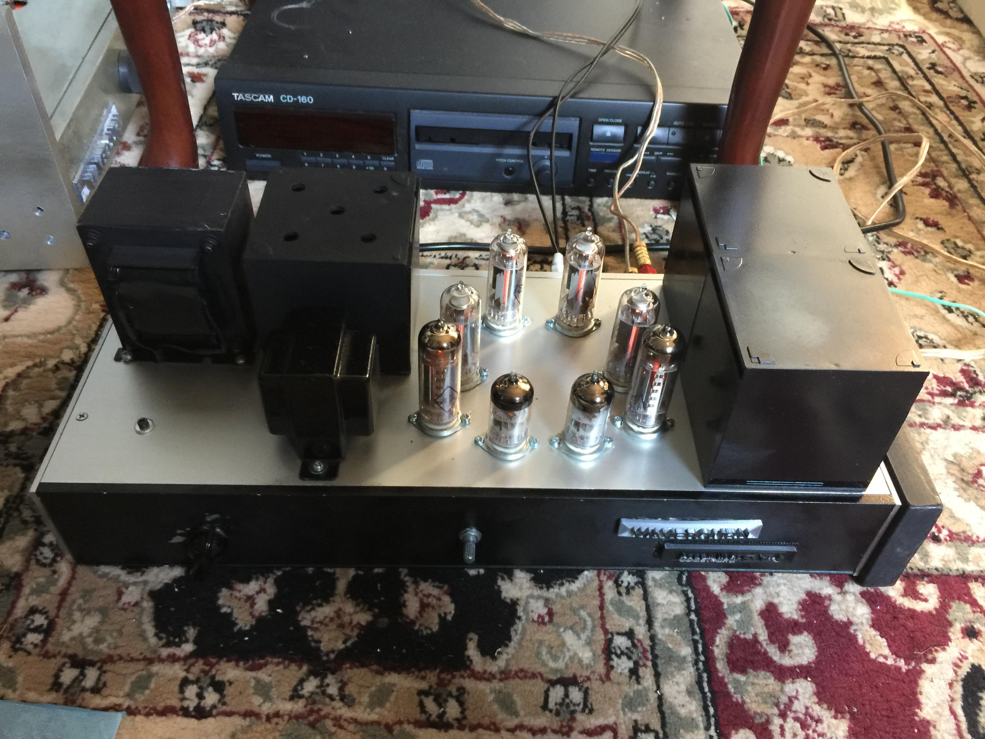

ecc99 - 6C19n PP, (6S19P)
Done!
Enjoying the music... Feedback wires going from speaker posts were causing capacitive coupling with something nearby. Moved resistors to the posts, now both channels are stable.
Well; fast amps should be treated as carefully as radio transceivers! 😀
