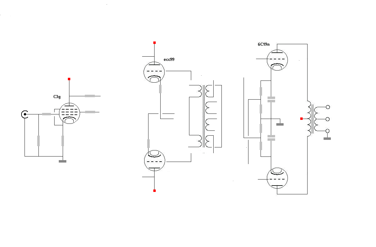

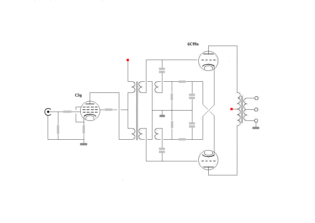

well, If someone could tell me why I placed a cap in one leg of the interstage, or maybe why it shouldnt be there, or which kind of cap, that would be nice
btw, found this about calculating interstage, by Benny Glass FAQ on interstage and line output transformers (Lundahl)
I place phase splitting transformers on the input - because these types perform as well as interstagers for phase splitting - but cost a lot less. I place a LTP after them to achieve the maximum gain from the LTP (twice the gain with both LTP inputs driven). The LTP will also be more accurate if it has both inputs driven. If you are feeling adventurous then direct couple to the finals. In this way you can build an amp with only the power supply caps in the signal path.
Personally at this stage - I think you are thinking about this way to much. Each of the different configurations is relatively easy to try by a simple shift in wires and that way you can actually listen to what difference the different configuration make.
There's nothing like experience for proving a theory.

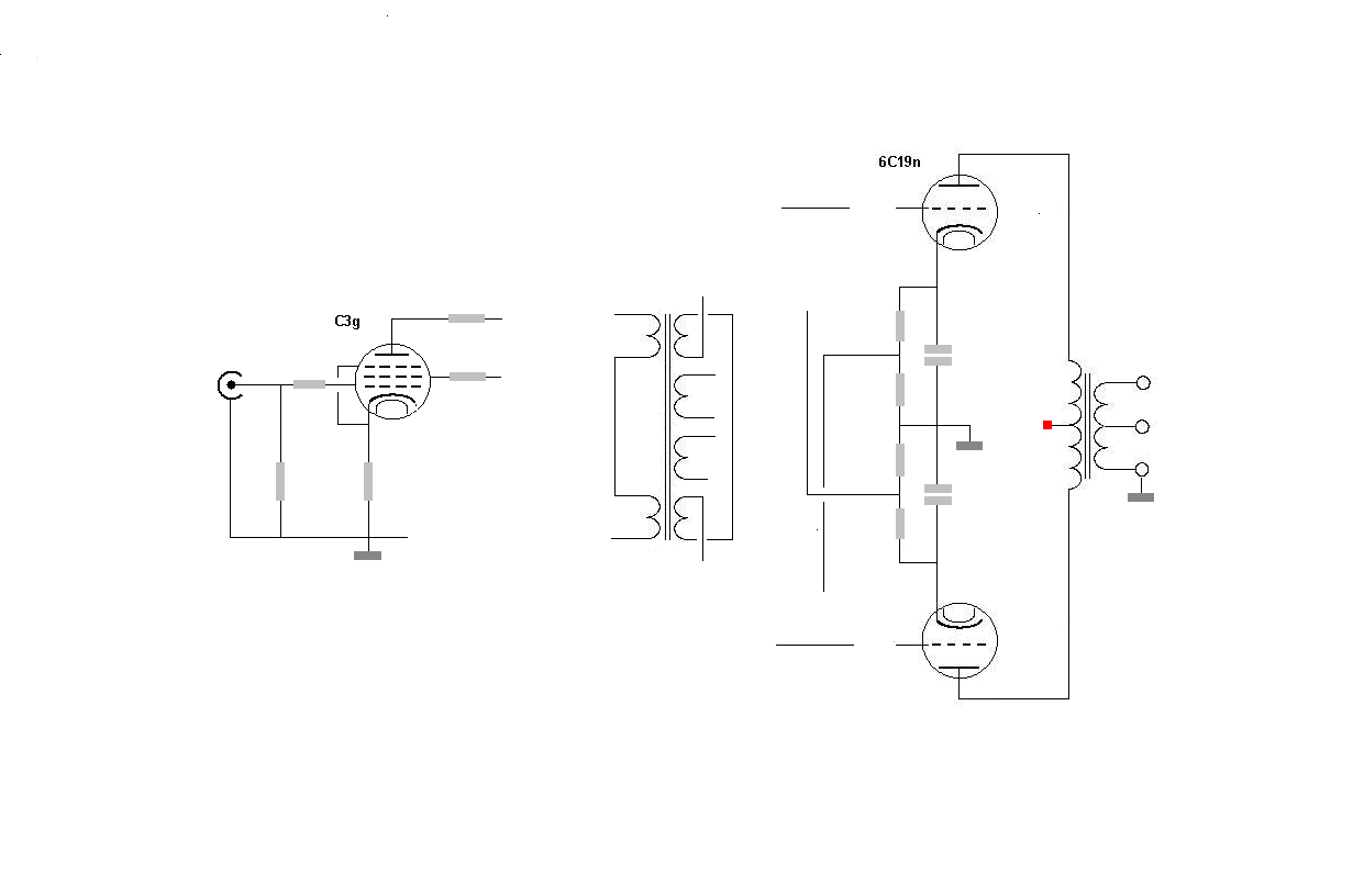

ok, been reading though several tutorials about phase splitters
and if I say more about that it will probably be rubbish
I will try the 'simple' version first

If it is half of a 6AS7 then I run mine at 100V 100mA which requires just 30V drive for full output. Running these pass regulators at high voltage is the wrong way to go in my opinion.
Shoog
Shoog
This picture can be used to approximate what to expect from 6S19P. On 100 MA and zero grid voltage voltage drop between anode and cathode will be 50 Volt. That means, on 100V of B+ you get no more than 100V of voltage swing, that means 35V of RMS AC. About 1.2W of output power. Is it enough for 10W dissipation? Up to you. I would consider 200-250V B+ for it, with fixed bias.
I am running mine at about 220V, 45mA as a diff. pair with individual CCS's and cathodes AC coupled.The bias comes out at about 75V. I would not really consider 6S19P to be half of a 6AS7 exactly.
It is the same conclusion I come to: to run them as a diffpair, in this exact regime.
I was also thinking that a similar regime would be good for trioded 6P41S; with the same B+ and CCS the bias would come out lower and the anode dissipation appropriately higher. I imagine, Anatoliy, that you might run these tubes a bit harder?

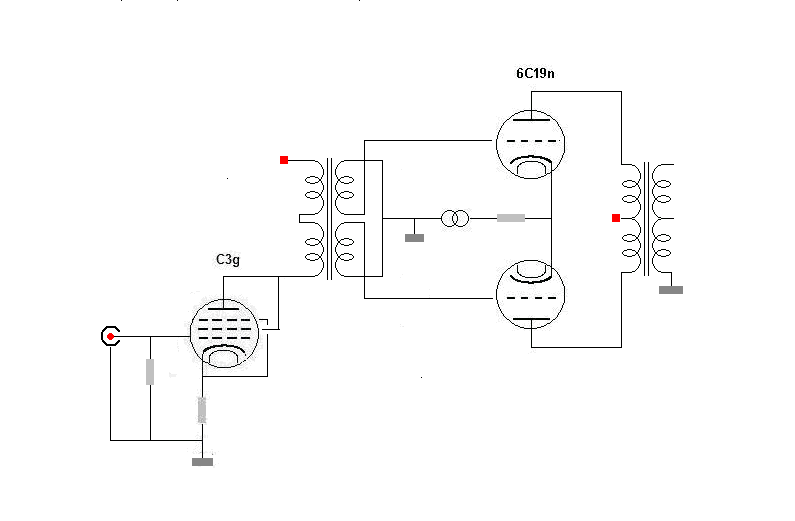

diff.pair
I take it you are suggesting ccs feed to each output anode/plate
as in PPP, parafeed pushpull
hmm, and fixed bias would be applied to IT/CT

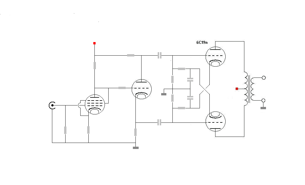

or else scrap the IT, and go back to ecc99 phase splitter
and place input trafo in front of it instead
things to think about, again
yeah, I have been tempted by that, so it sounds good to me, if I can handle it
