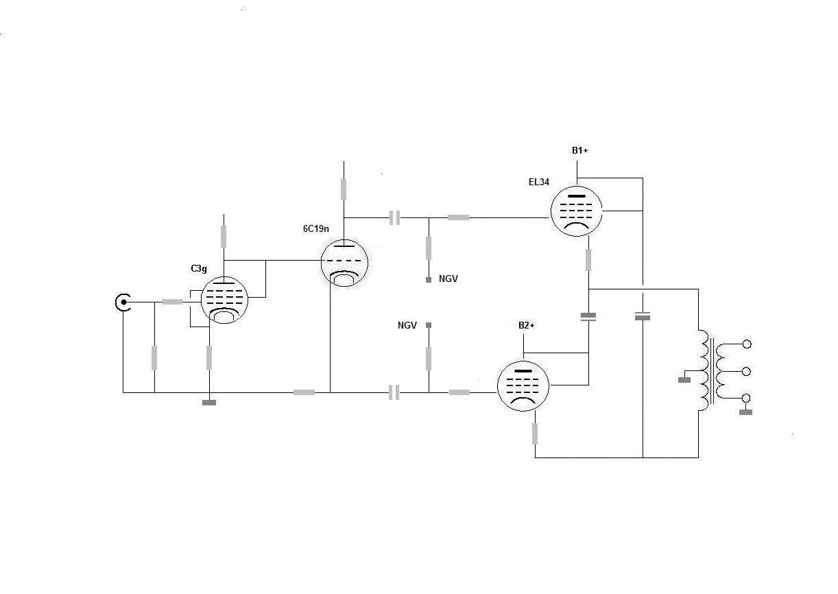

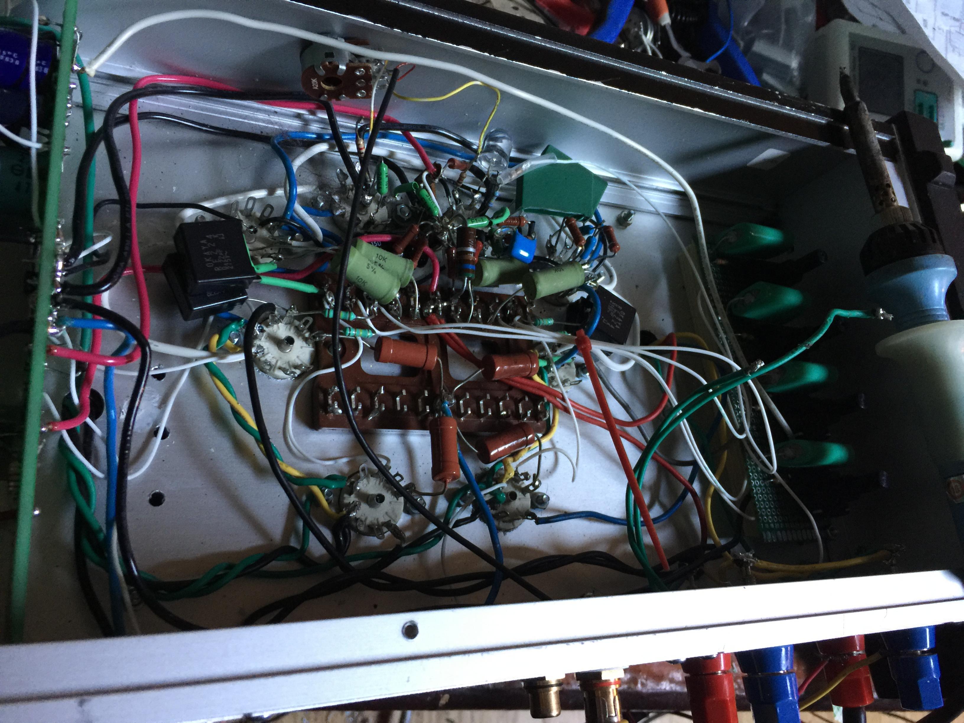

I take it you are suggesting ccs feed to each output anode/plate
Yes. Either a CCS, or 10W 820 Ohm resistor. 300V B+, grids grounded through grid leak resistors. Driver powered from the same 300V source. Simple and robust. For driver I would use something like 6J52P or 6P15P.

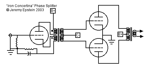

if I understand this correctly, a higher B+ with CCS biased cathode, would be almost similar to lower B+ voltage with fixed bias
Let's resurrect the thread...
Actually, fixed bias current instead of fixed bias voltage.
However, today I would do differently, 6 years later...
The same 300V B+, but something like 36 Ohm in cathodes, and a fixed bias like -70V; also, I would bootstrap drivers from cathodes of 6S19P, getting such a way also a positive feedback by current. However, grid leak resistors should have pretty low values (relative to other tubes), since people reported run-aways?

For the driver I want to try ГУ-17 tube (QQE03/12), with 1K in common cathode and 10K+1K load.
What do you think?

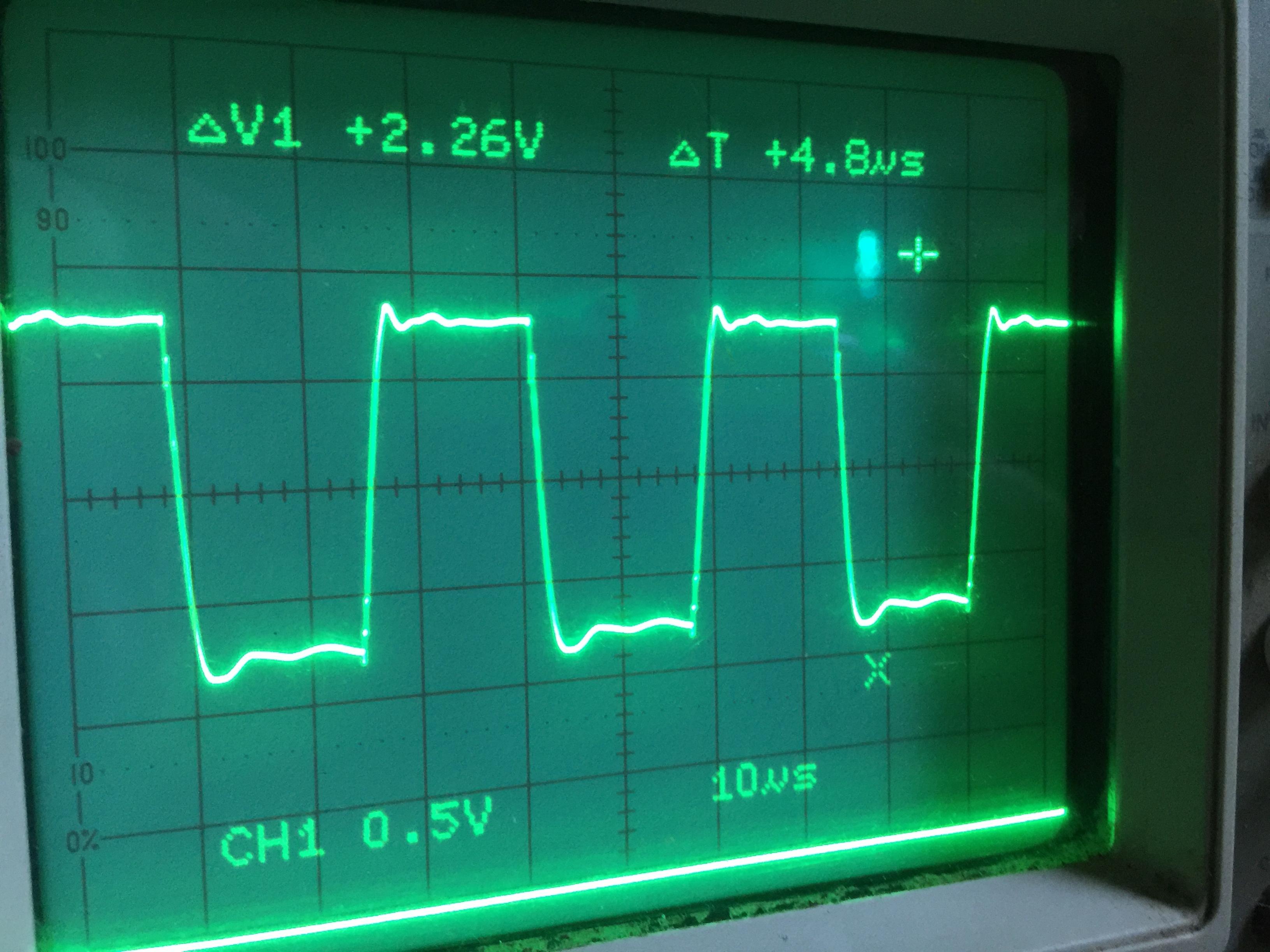

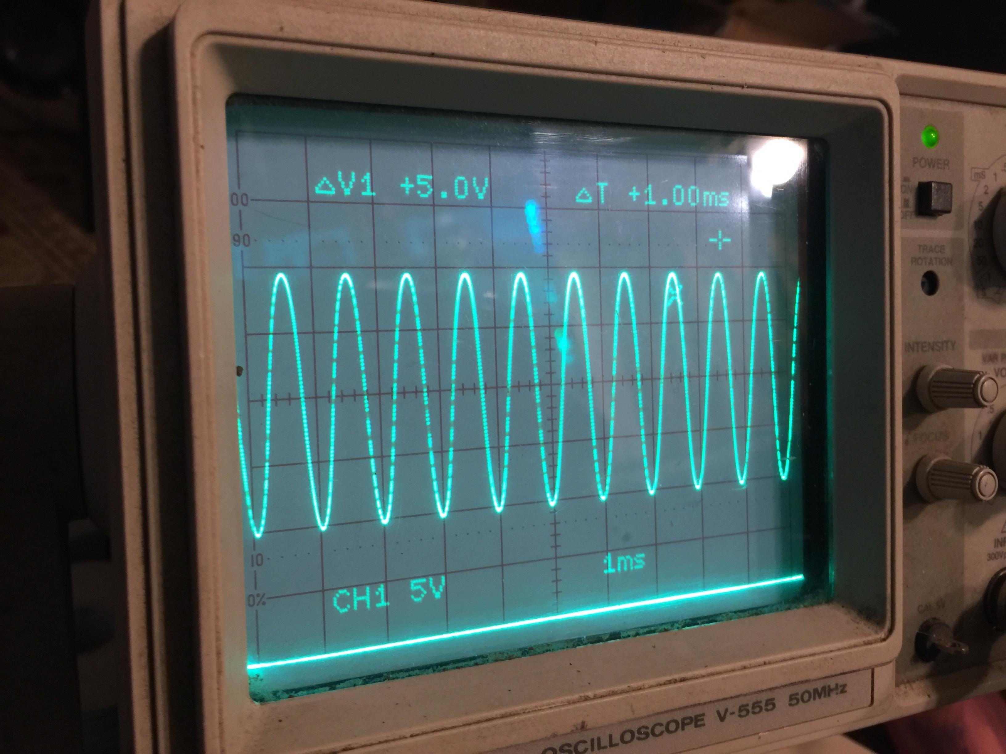

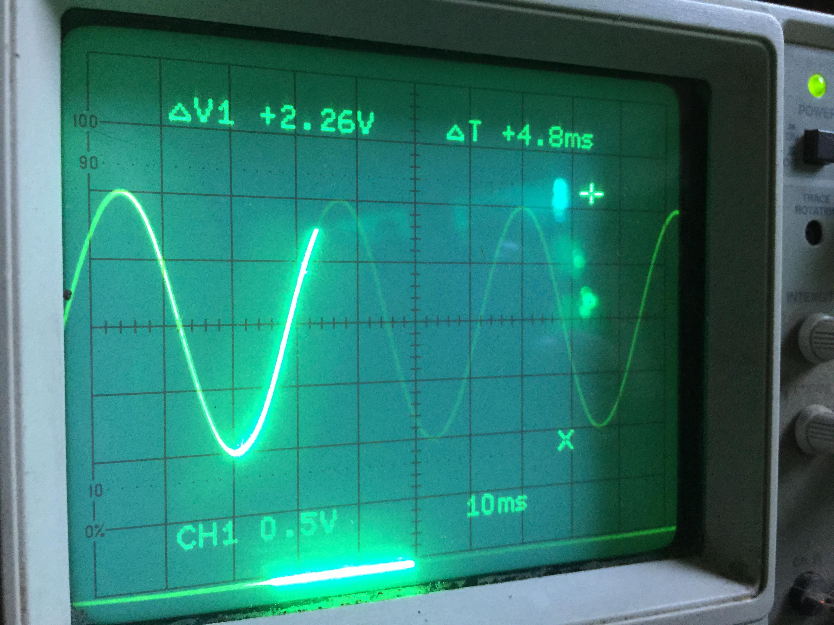

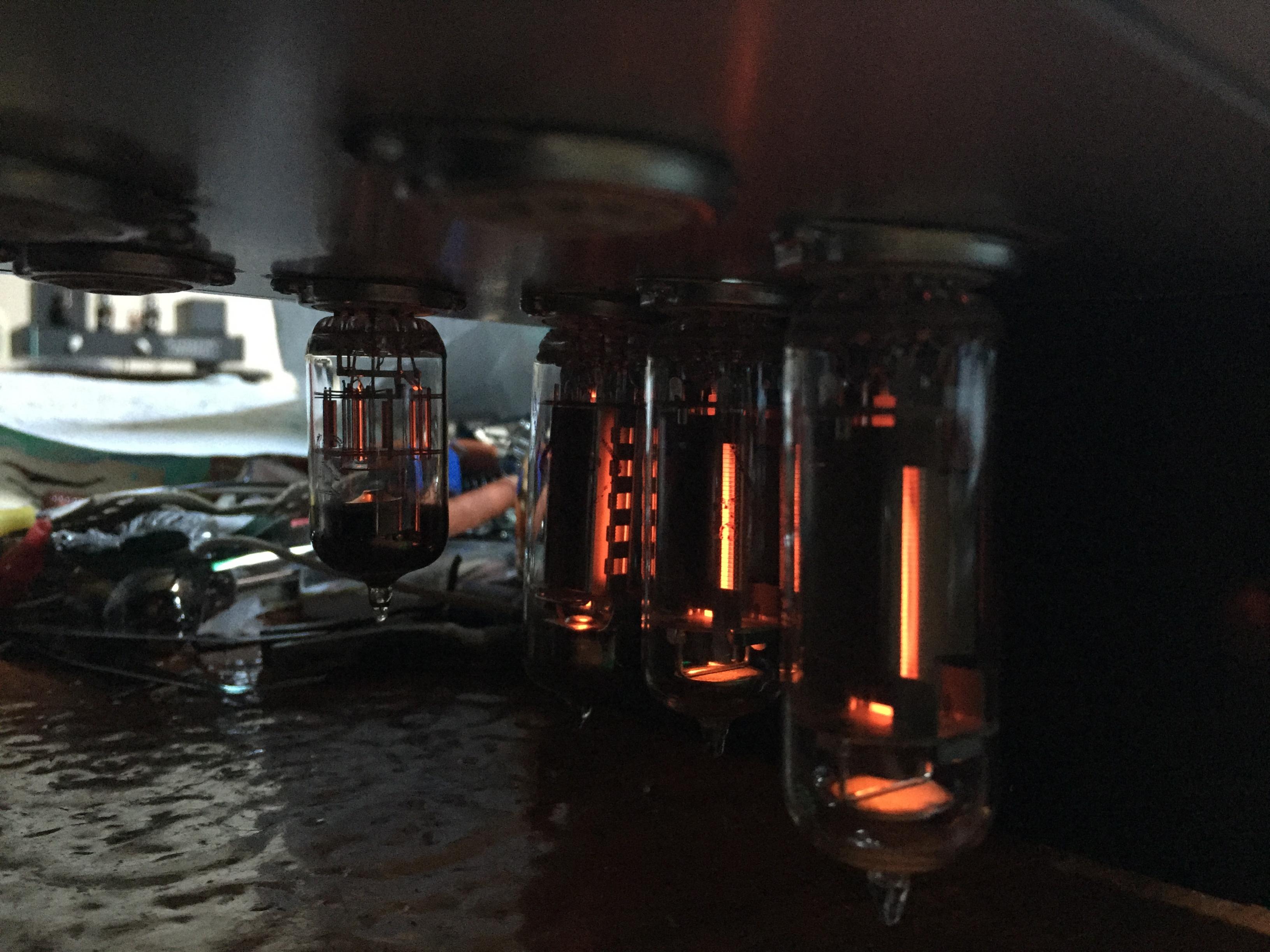

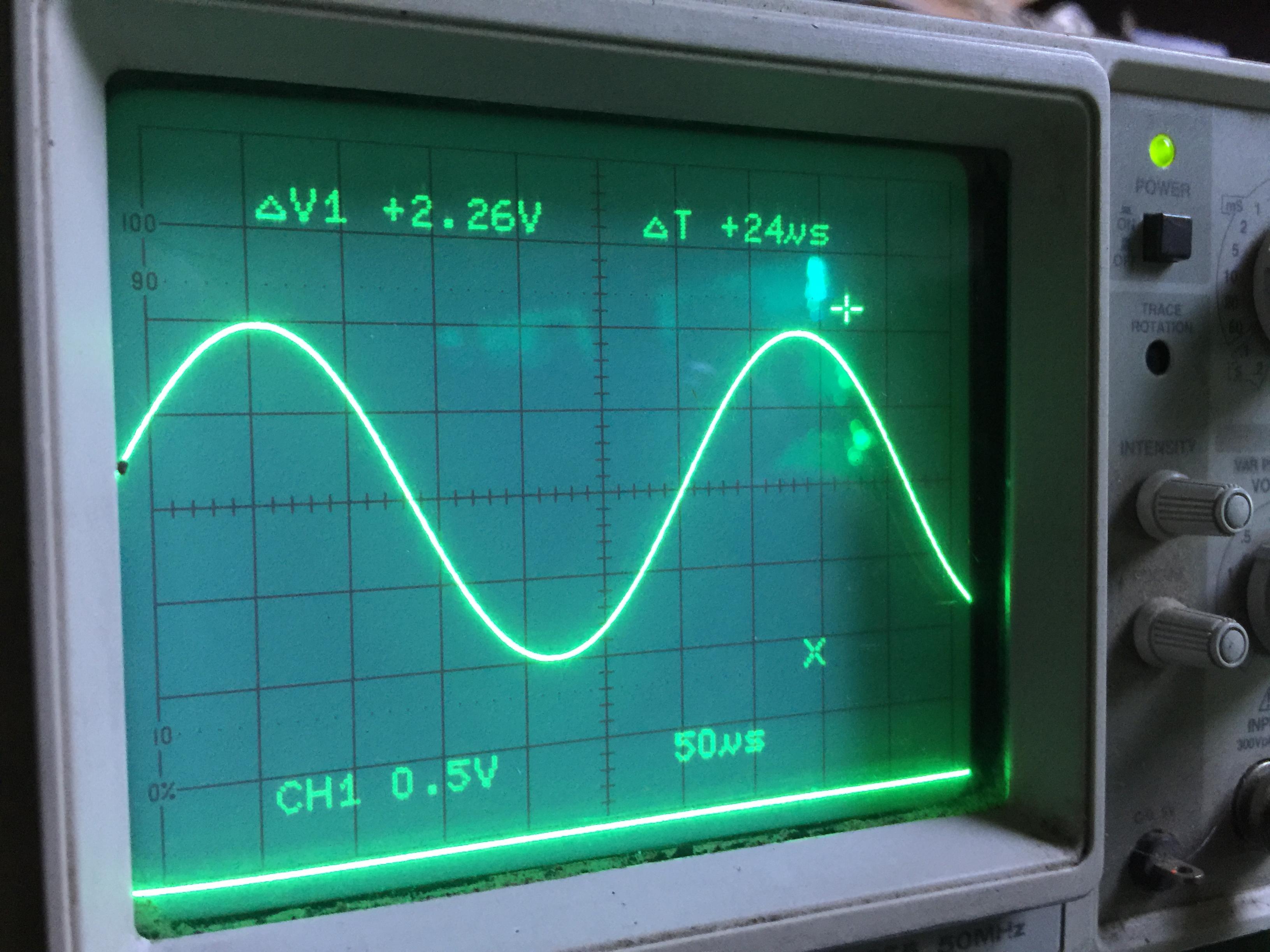

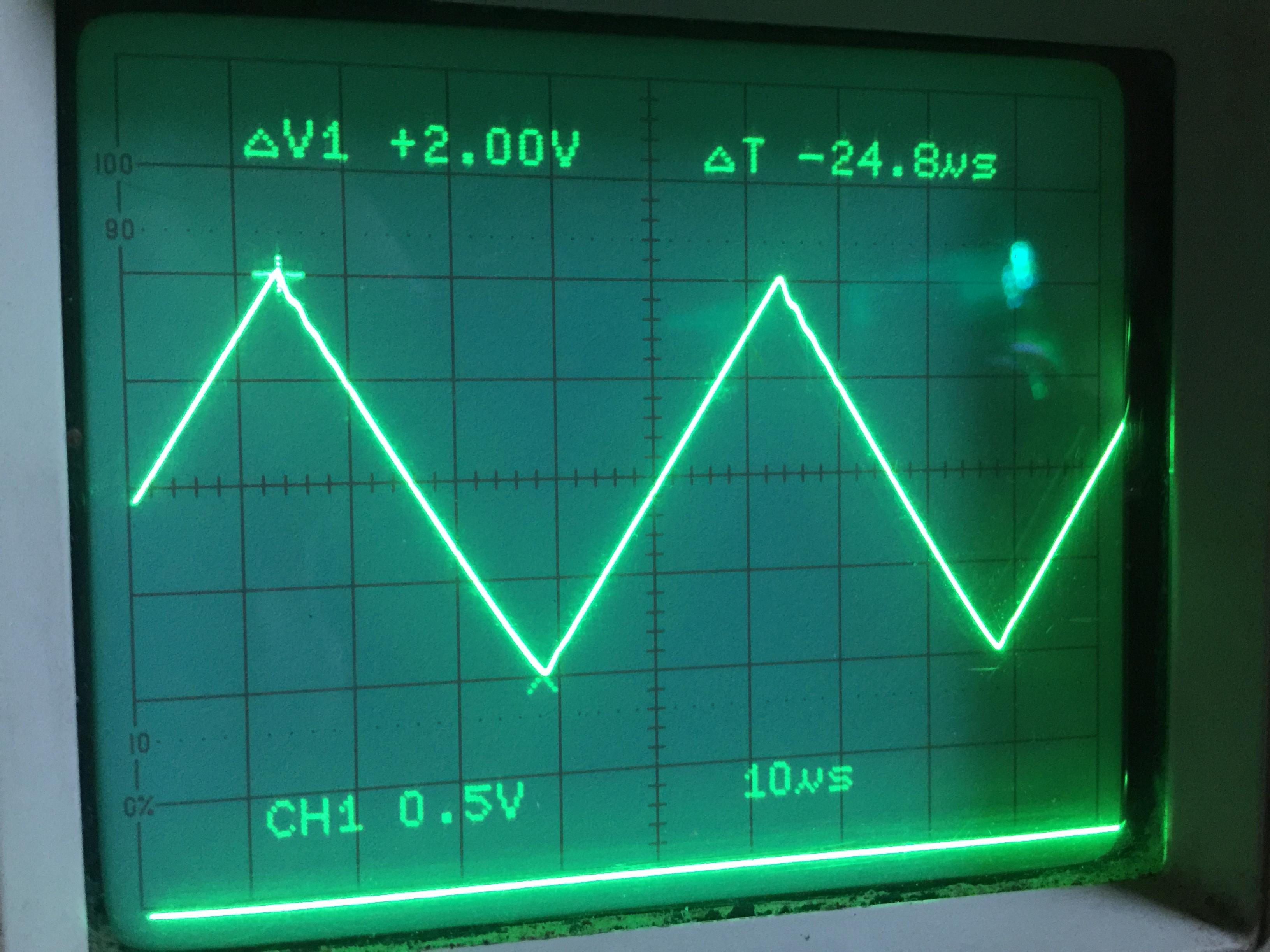

Here is my result. No bootstrap yet. 180 Ohm in cathodes, about -90V bias through 130K resistors.
280V B+, 4K5 output transformers.
GU-19 driver, 6F12P phase splitter.
With Edcor "15W" cheap transformers I got 9W of class A triode push-pull power.
I believe with lower load impedance and B+ I may get better results
Is there any particular reason why you are using GU-17 other than convenience?
It fits. 🙂
As you may see, 200V swing from each half, 10k load resistors.
