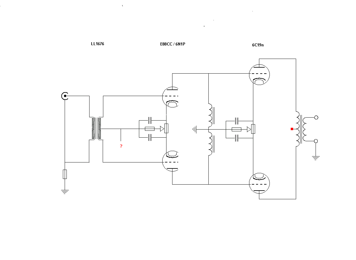

hey Thorsten
ehh, battery ?

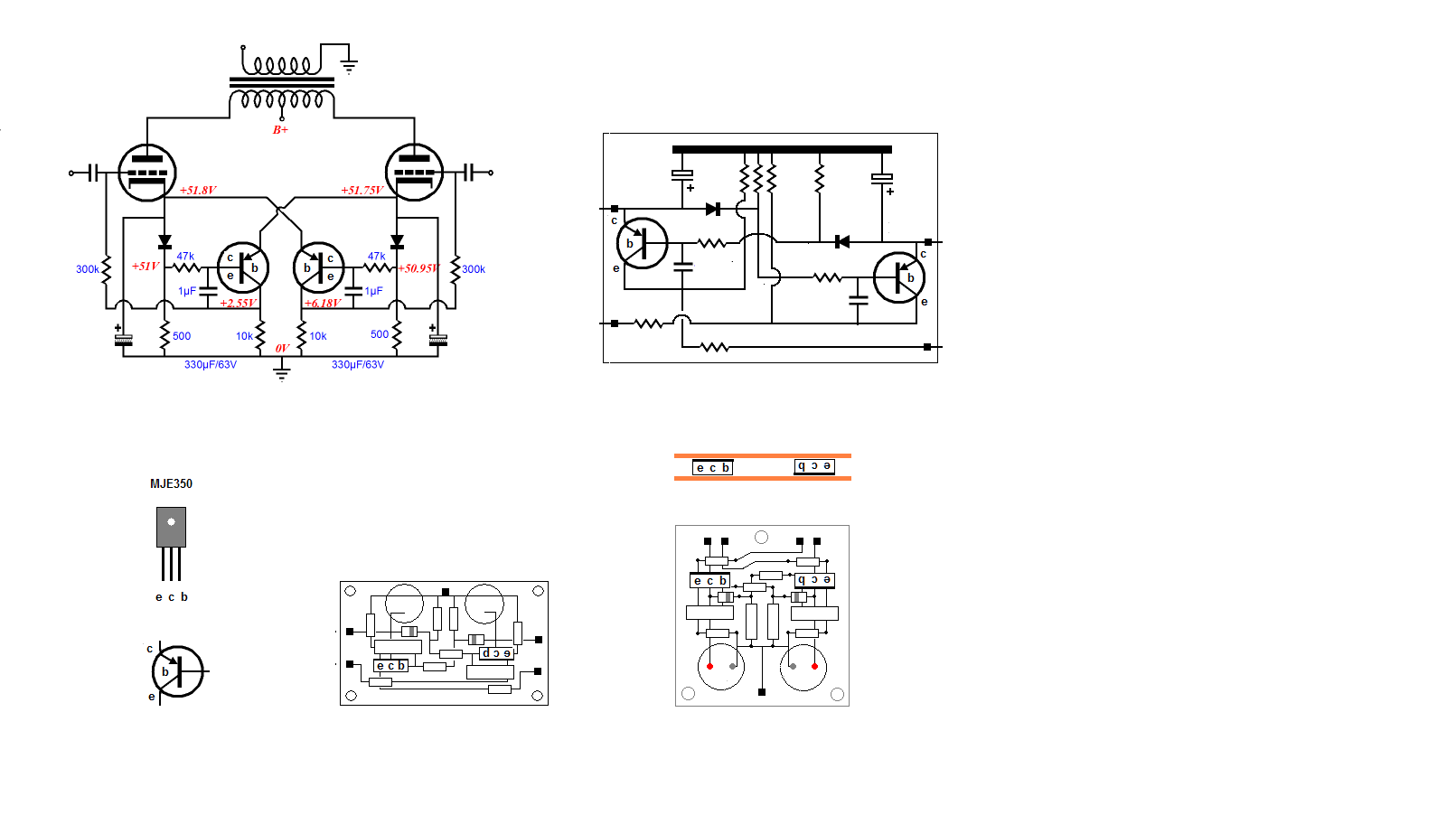

if you refer to middle schematic, its just the way Revintage shows a power supply
but you are right, it does look like the way a battery is usually shown

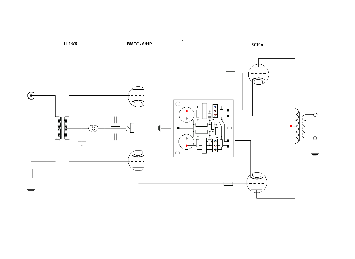

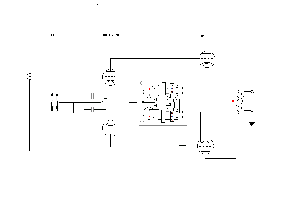

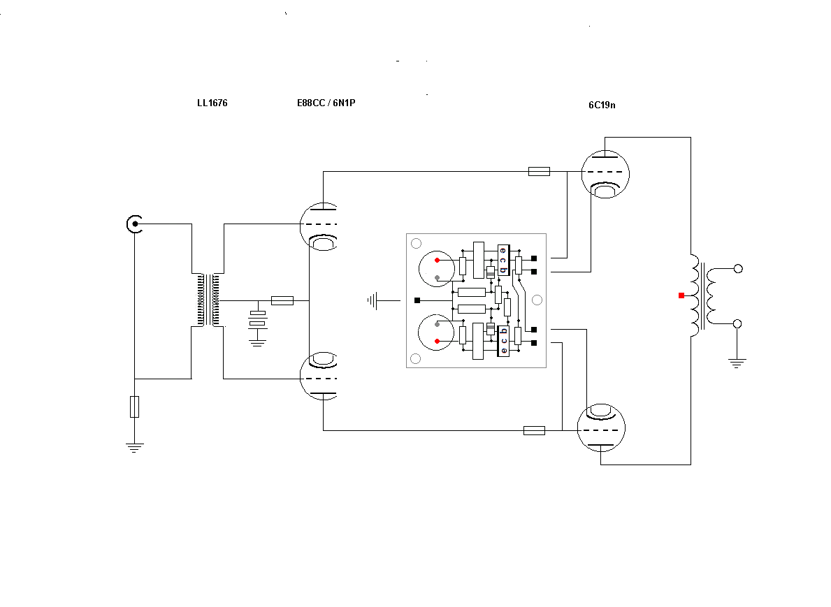

some will know that I enjoy drawing simpler board layout 😛 so heres a revised board layout 🙂
question is, will this advanced bias curcuit work with 6C19n(6S19P) 😕

Hej Thorsten!
Remember this is a DC-amp. The input grids are at ca -120V, the anodes and the next stages grids at ca 0V. The output stage have ca 160V Ua. Shoog has done a working amp on this theme.
If we want to add a Gartner-circuit a DC-amp like this will not work. It will not work with an amp with IT either. So unfortunately this goes for the left amp above. To get automatic bias here a more complex servocircuit is needed. But in my opinion an automatic biascircuit will not be needed, The only thing needed is a 50ohm pot inserted between the firsts stages cathodes and the cathode resistor.

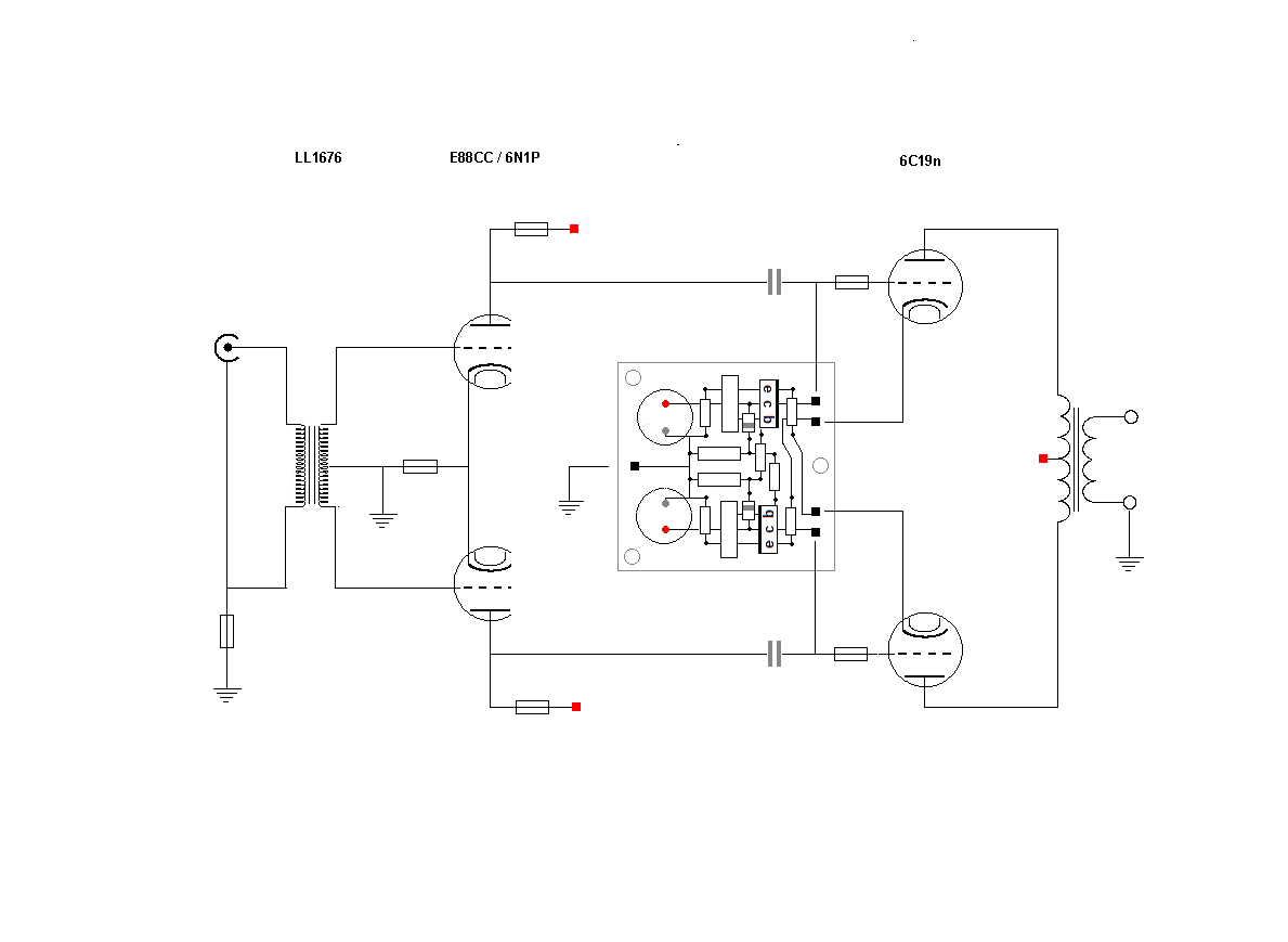

To make a cap-coupled amp no negative voltage is needed.

If you look at my circuit, you will see that you can get autobias if you use CCS's in the tails. This is extremely simple and I have not found any sonic penalty with this approach.

........ 50ohm pot inserted between the firsts stages cathodes and the cathode resistor.

regarding driver stage, you mean something like this, maybe
I understand that dc from longer prolonged turn-on time of tubes could result in a severely burned amp
but I dont understand why the Blumlein Garter curcuit makes it worse
I mean, to me it still looks like ordinary auto bias with bypassed cathode resistor for biasing
but yes, it is connected to the grid
I dont know
I dont know

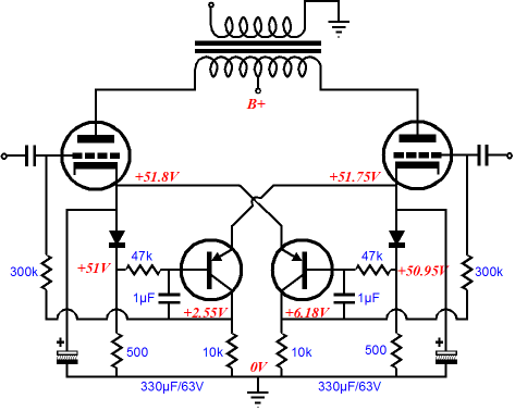

well, I can see that its obvious that the above suggested 18V/25ma cathode bias doesnt correlate well with the suggested 60V of the BroskieBlumlein curcuit
and a forced ccs doesnt seem to take care of the balanced voltage "regulation" either
also, Broskie's bias curcuit is clearly shown with series cap coupling to grid
or am I missing something

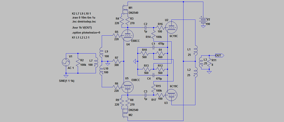

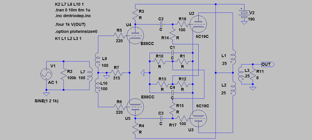

Using a simple CCS in the tails and going direct coupled solves a number of problems. It keeps DC out of the output transformer. It compensates automatically for output tube variation. Almost as importantly - it automatically compensates for variations in driver tube plate voltage.
It achieves all of this by the simple fact that it sets its "anode" voltage to whatever it takes to achieve its set current. I have used this approach on two direct coupled amps and they work flawlessly and need no adjustment whatsoever. Two caveats are;
- the +B of the output stage needs a time delay to allow the heaters to fully come up, and for the first stage to stabalize at its operating voltage.
-the initial switch on condition can produce large voltage spikes across the CCS. I use a 125V adjustable regulator in my last amp and place a 100V zener across it to absorb these switch on spikes. Alternatively I used the IXY900 for the cathodes of my 807 direct coupled amp.
Hope that helps.

thanks Shoog, your input is highly valued
Revintage, your suggested schematic is of now our new reference
you never forget the smaller details, thanks
leaving direct coupled apparently also makes frontend simpler
still learning 🙂

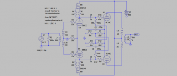

The only precaution is that 190V B+ is to low for the driver. CCS will maybe help.

any chance you remember the bias voltage/current on output cathode ?

btw, is it significant that original "passive" BlumleinGarter you have used in sims burns more voltage and heat than the "active" Brokie version ?
as far as I understand it both curcuits try to achieve the average bias current of both tubes

Out of curiosity, why is 190v too low for E88CC driver, at least I can't see this from the datasheet ?
Hey Bigun,
Knowing that the sweetspot for E88CC is in the ballpark of 120V/5mA this leaves us with a very small anoderesistor giving us extremely high distortion. Also there will not be enough output level to drive the 6c... properly. If going for resistor-loading 300-400V B+ is needed.
Hey Tinitus,
ECC99 demands a little more B+, higher Ia and leaves us with to low gain. As E88CC it will also need a CCS to perform at its best. Can´t see no reason to build another expensive voltagesource when a CCS only costs a few dollars😉.

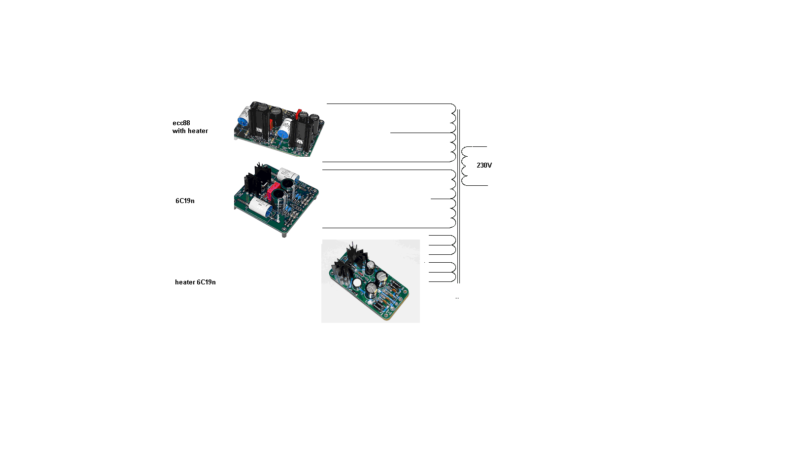

if I ask you to let go of the costs considerations, what would be ideal voltages
I still like to use your CSS load of ecc88, as it seems easy and cheap to copy
and anyway, I plan to use seperate regulated supply
and preferably to each section, one for ecc88, and another for 6C19n
I see several good reasons for doing so
one is the higher voltage trafo, being fully adjustable through regulation
there are other good reasons
still, with this low power its not very costly
