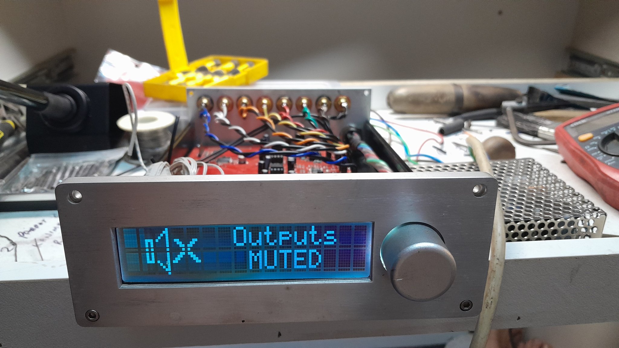

Managed to get the smoke back inside my unit, powered on and mounted in the case finally. Only took me 10 years or so... Few more things to tidy up and then onto the next part of the system. Thanks for everyone's help.

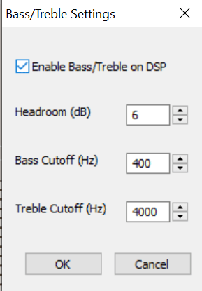

Do you guys are using bass/treble function ?
I'm a DIYer & 'F. Toole' enthousiast and i'd like to use this function.
But I can't activated it without having the dedicated 'bass/treble clipping" led flashing quasi-continuously.
Even if I set the maximum headroom and set bass & treble at 0.
So I'm using 3/4 presets with some high-shelf values, but it's not as easy as it could be with a bass/treble knob 🙁
Is this a bug ? Do I need to save / reboot / etc the najda in order to correct this problem ?

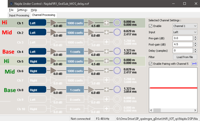

Changed my setup and experience the same. Tried gain and headroom settings all over the place without any effect on the Bass/Treble led flickering, as does the PC GUI indicator in Sync'ed mode. Running 96k
Gain structure can be difficult as you don't see when it is clipping. I have had my Najda for many years but never really understood what the LED bars are showing. You can adjust each channel before and after. But where is the pickup point for the LED bars?
There is no explanation for this in the user Najda under control Software user manual.
My problem is not that my signal is clipping but that I don't get enough signal out to drive my power.

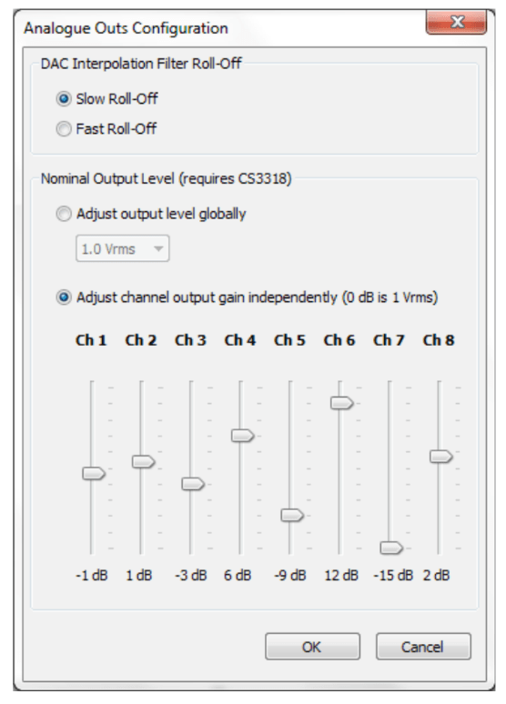

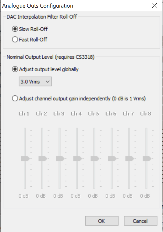

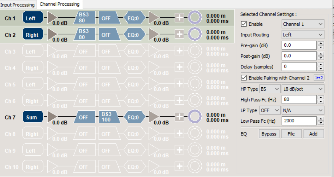

Not seeing Input Tab and assuming there is no - gain (or - gain is close to -4.5) there, + gain you are presenting on "Channel Processing" will produce clipping. This is described in manual, generally all processing needs to be done after proper amount of - gain, because direct effect of processing or some kind of artifacts/short spikes can exceed maximum level.
Generally anywhere in digital processing (input/pre/processing/post).
This is not issue with Najda DSP but it's generally how digital processing works. If you need more voltage on output it's better to do it in analog domain on this dialog. Unfortunately this is global setting/not per presset

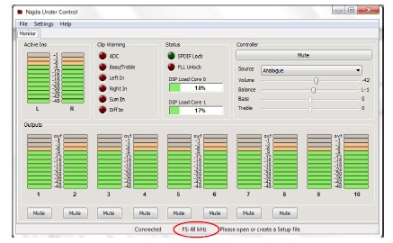

The initial question that I hope to get an answer to is how the "level indicators" work in the Monitor tab window. What are they actually presenting?
Input or output from filters and before or after the in and out gain settings!
This is not explained in the manual.
The manual does explain gain structure as a topic but not how to control it. It is common in analogue studio equipment like real-to-real records to be able to switch the VU meter pre or post-recording heads. This does not seem to be possible in Najda.

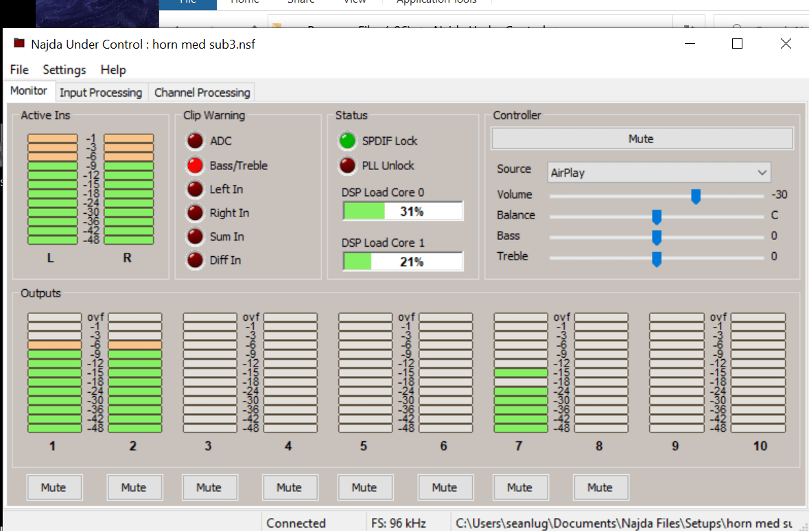

I would say they are self explanatory but lets list them
- ADC - only analog level clipping in here, too much voltage on analog input (above 1 or 2V depending on board version and input setting)

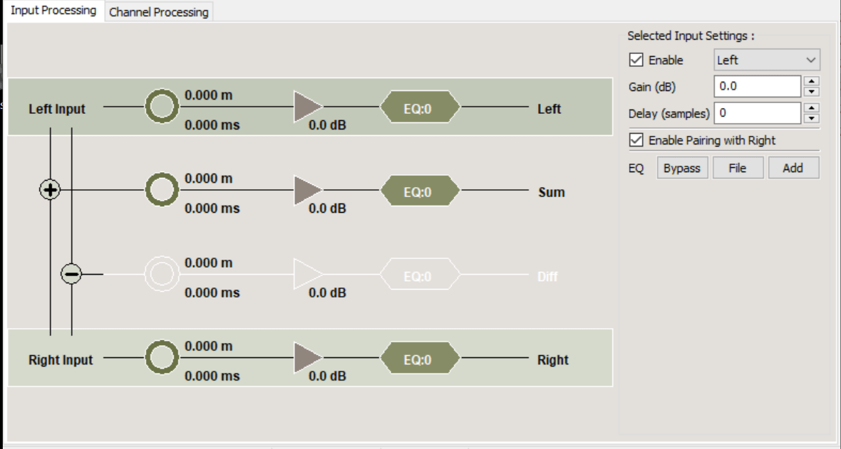

  • Left In/Right in ("Input processing" tab) - result of any operation you do to those (pre gain, filters, post gain), it's not analog meter so it's not bound to single point in path, any operation can trigger clipping, so fist that exceeds maximum level will do it.
  • Sum/Diff same as above but for Sum even if you will not apply anything you can get clipping if you will not apply -6db pre gain
  • Bass/Treble application - effect of Bass/Treble functionality does clipping, not sure if this is applied to input or to output of each channel (what manual suggests) but I would say it does not matter, as every processing is chained here with another one
  • then on each channel similar to right left, any action you do in every place of the chain on particular can trigger clipping
This is digital domain, there is maximum level described as digit. Lets assume its 10, subsequent steps are doing some operation +/-/*/:., but whatever you do there is no way to to exceed 10. As opposed to analog stuff where some nominal standard maximum level can be exceeded without harm.
If you assume that some parts of input digital data have already maximum level (and you must do it), than on general input or in particular channel you have to contradict with proper - gain to what you plan to do in every further step of processing.
I regret it took me this long to grab some screens. When playing analog the bass/treble led flickers very seldom. From the CD (coaxial digital input) depending on program ocationally. Worst is Airplay from an old AppleTV through optical digital in. My outs are a 15+15 W solid state class A (kit from diyAudio) driving a pair of backloaded horns and a common closed box sub driven by a Quad 405.
