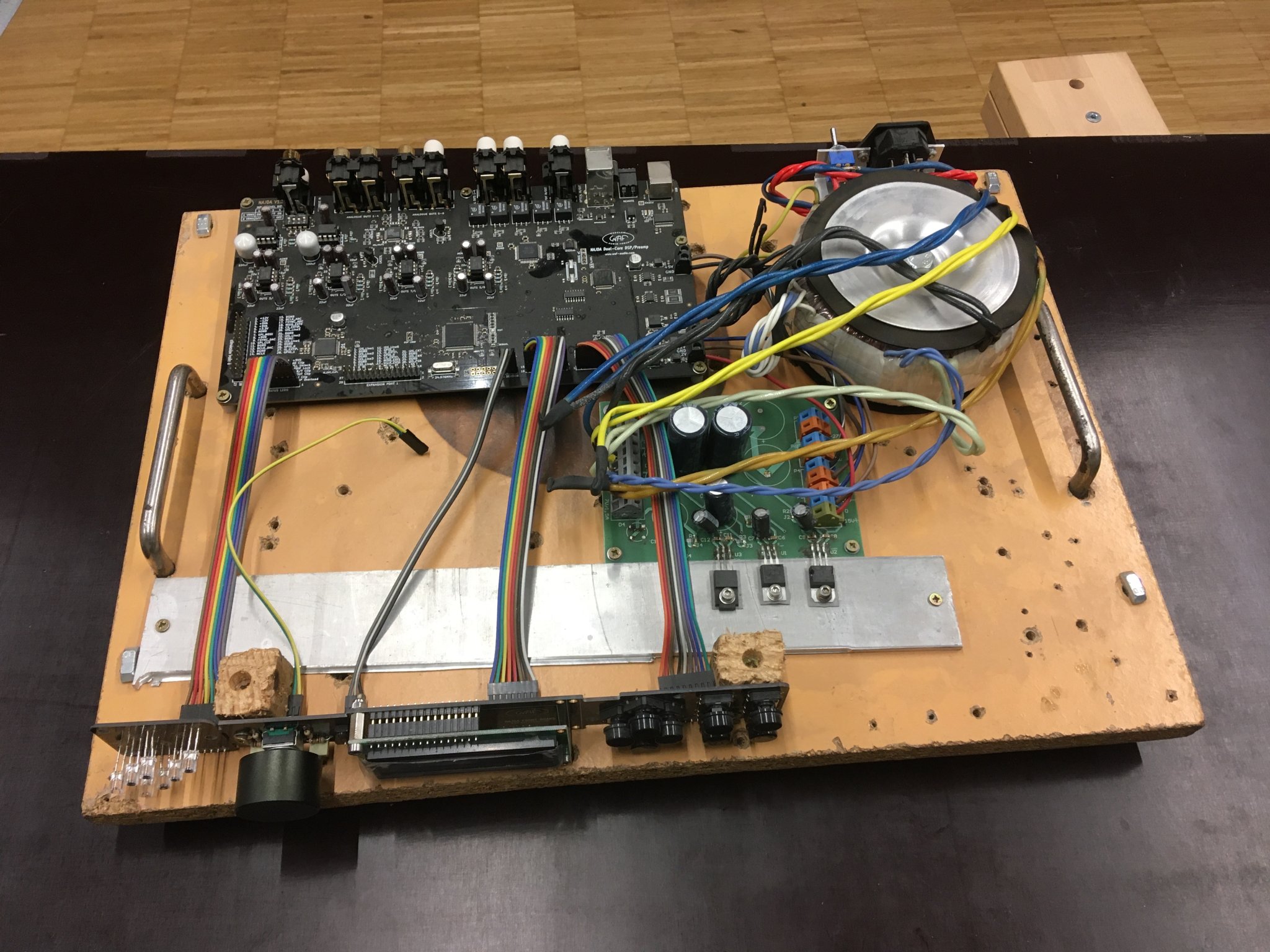

Gentlemen,
I could use some advice with a Najda combo I'm playing with now. It's a complete v.1.3 set installed on a wooden board, so I'm exploring the options before setting up a proper case for it.
I'm planning to add a USB/I2S XMOS input module from JLSounds, but I cannot find any info on input routing in Nick's manuals. As long as such a board is installed, do you get a new input automatically in the menu (in addition to existing Coax/Optical/Analogue), or does it replace some of the existing inputs?
If it does replace the SPDIF, then the whole board will be of not much use in my case. Half of my listening is vinyl/R2R, but the built-in ADC for the analogue input is pathetic - so an external ADC feeding the coax input is a must. I'm running it now with a Fostex DAT serving as a converter, and the result is way superior to the Najda's ADC.

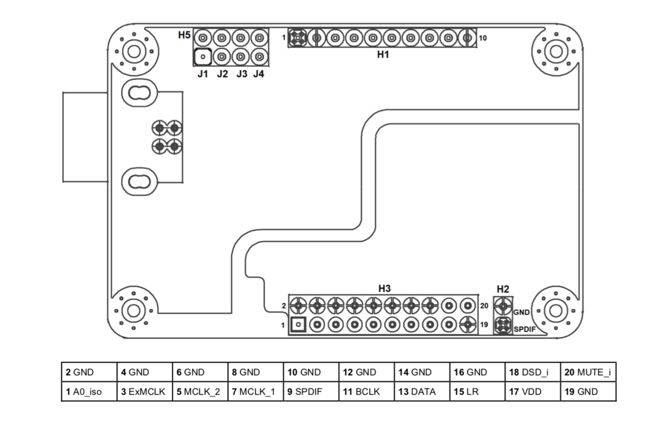

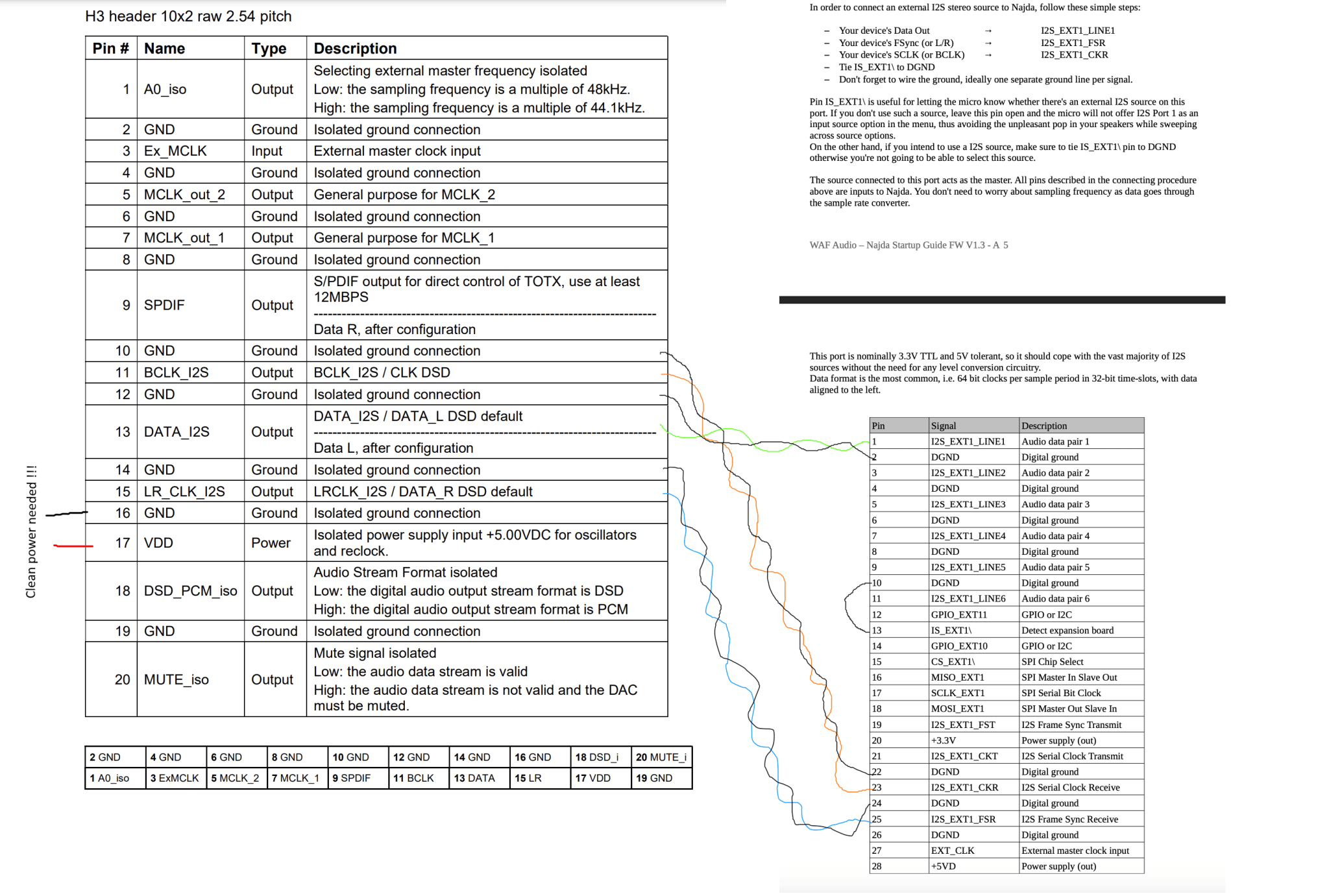

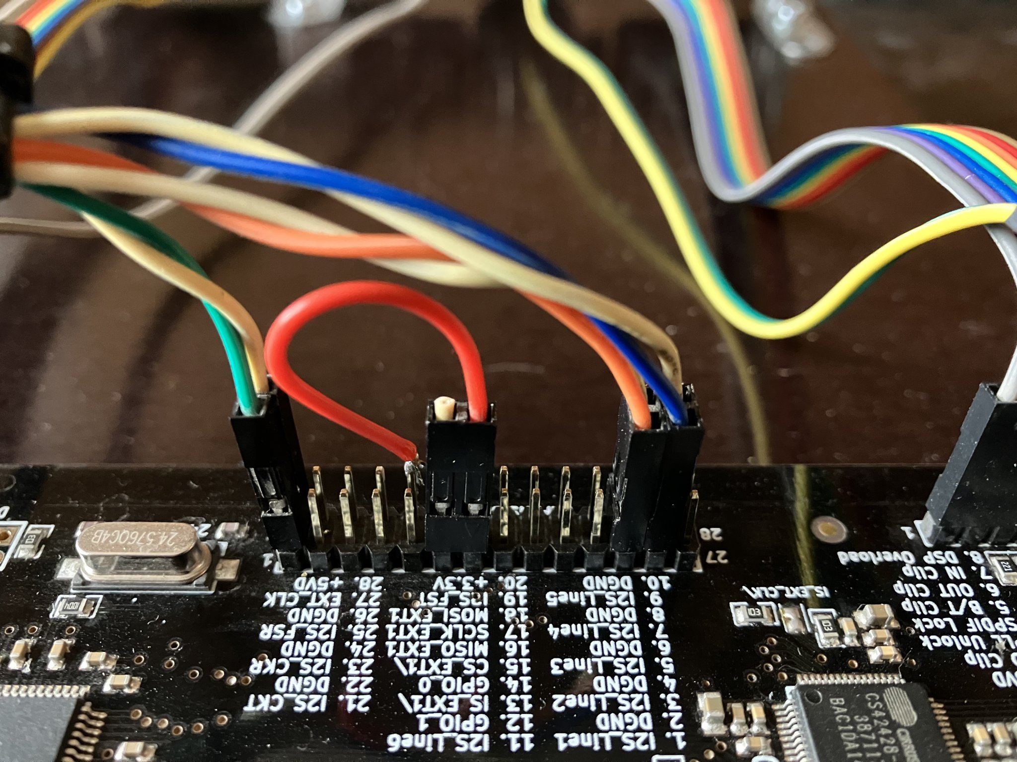

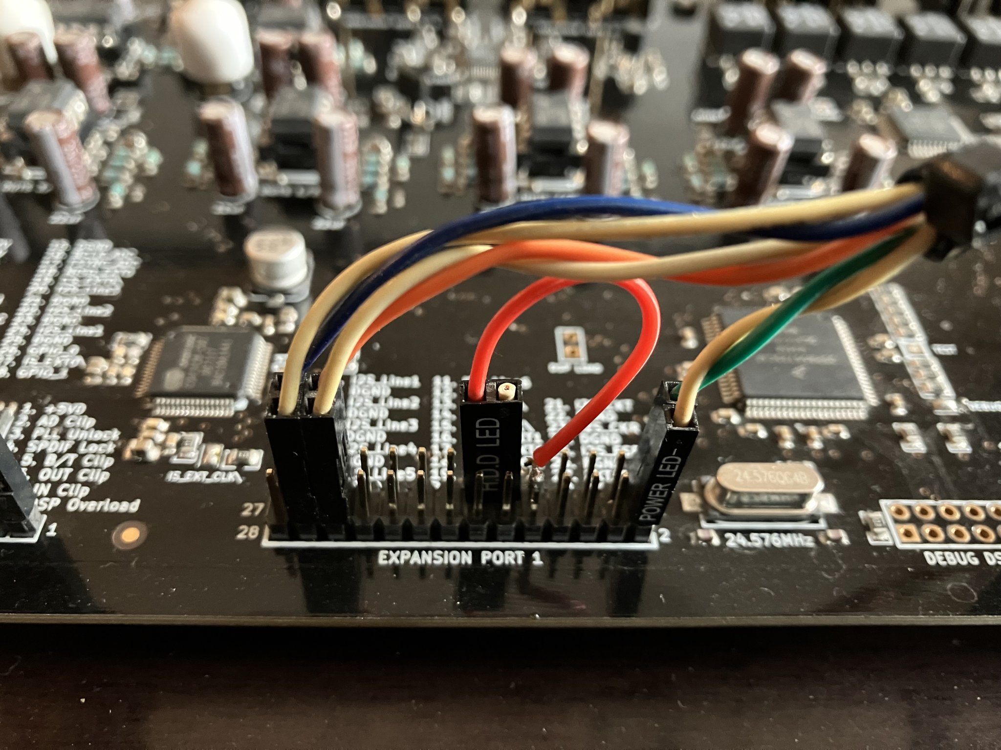

I think I have a photo somewhere showing the connection between jlsound and najda i2s input, I'll search it later today. Though, there are multiple ways to connect depending on how you decide to power jlsound card.
OK, please find some photos of my application here:
https://drive.google.com/drive/folders/1lq0ZRFTqT0C7eMOK96PIoO2HdfUwkWtb?usp=sharing
Note that my JLSounds board is V II and not the latesst v III
Also I have 2 separate power supply to JLSound board , around 100mA to Header H3 pin 17 and around 400mA to Header H1 pin 1
See below image for the latest JLSounds board:
Also keep in mind to use as short I2S lines as possible and twist each line together with ground, see below image
To be on safe side each wire should the same length, even if not needed.

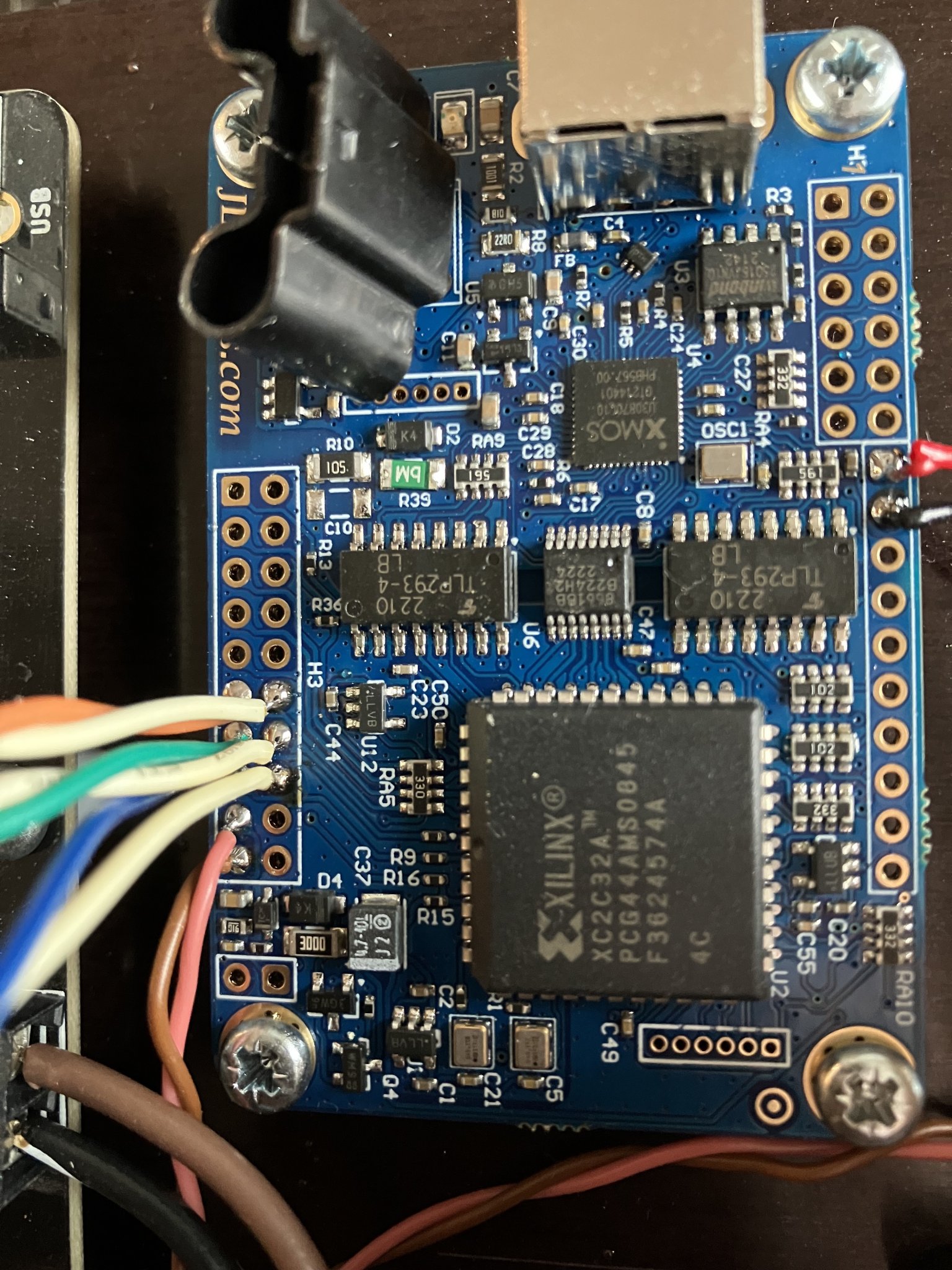

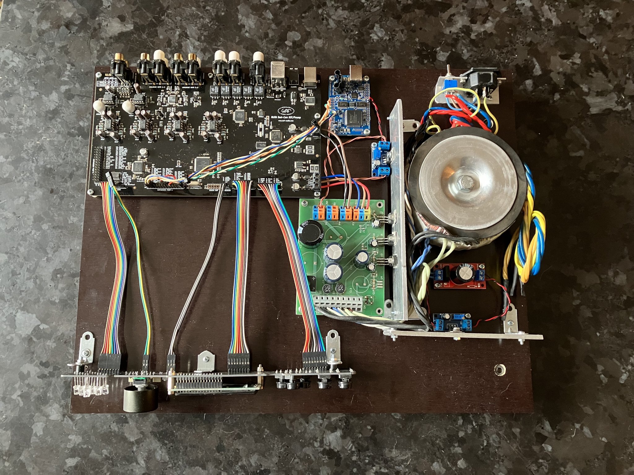

Hello,
I think I’d need some more advice on two problems with my Najda.
I got it back from my friend, neatly rearranged on a new board and with the JLSounds XMOS module installed. It played nice, although a bit colourful in the highs — but I attributed that to all the interconnect and power cable upgrades I did in the meantime.
But when I played a test sweep tone 20-20000 from REW, there were very strange artifacts in the higher tones, from approximately 10 KHz and above — like howling wind, or repetitive echo.
Played test tone again via SPDIF — same thing. Disconnected the bridge which tells Najda that XMOS is present — just a tad better. Only when I disconnected all cables from the XMOS and left only the SPDIF, the artifacts disappeared and everything was back in order. Here are two videos, with the test tone via I2S and SPDIF: https://we.tl/t-N2NWUYoI2M
Could anyone give a clue where the mistake could be? I suppose it has to do with the clocks of the Najda and the XMOS messing up, but have no idea what to change.
In Piisami's diagram the connections start from pins 10/11 on the XMOS, but on the JLSounds' website the diagram shows the same outputs on pins 12/13, and it is wired according to that. My friend has installed dozens of these modules, I already use three of them as standalone converters or as part of a DAC, but it's the first time we see something similar.
The second problem is the analogue volume encoder. The front panel has the module installed, but it simply does not do anything. I tried connecting the cable to the pins 12 and 14 both ways, to no avail (NB - in the picture it’s disconnected, I know). Am I missing something here?
Thanks a ton in advance for any ideas!
