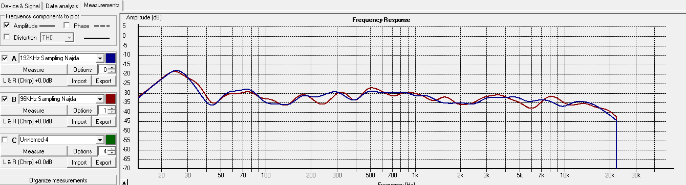

Calling all Nadja knowledgeable..
Here are two plots of a standard Holmimpulse test signal sweep.
Something I've used since I first got Najda V1.0 all those years ago and I have found invaluable in shaping the output in various rooms, to achieve a sound I like.
The blue plot is with Najda set to upsample at 192KHz,
the red plot is with Najda set to upsample at 96KHz.
The crossover frequencies, slopes / room correction (tapped horn subs only) and time alignment settings to my 4 way Najda V1.3 (+ tweeter on passive X/O) set up, are identical for both 96 and 192KHz setups.
As are the input dB reductions I have.
Clearly something is going on between 96KHz and 192KHz!
This is measurable, repeatable and I assume accurate enough, as Holmimpulse has been a great tool for me.
Everything in the room was of course identical for both sweeps.
So! Implementation differences in the way Nick handled 96 vs 192KHz? Wittingly or unwittingly?
I'm at a loss to explain what I am heading and measuring, otherwise.
Oh yes, the differences are audible between the two when playing music. Esp the mid and upper mid frequencys - typically vocals etc.
I mean, look the dB difference!
This of course just measures spl. Quality or grain/less grain in the music presentation, is another thing..
