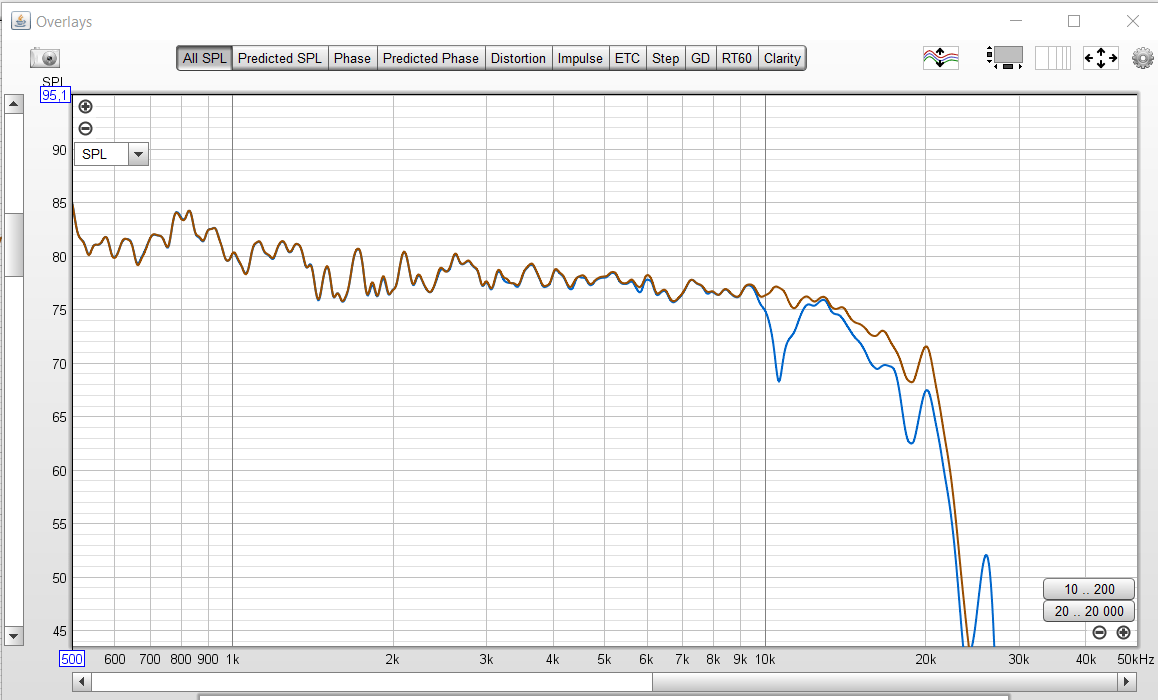

To get lower DSP load I made new setup with 48 kHz sampling, but get other problem with it. Seems Najda asynchronous sampling rate converter is not very asynchronous.
48 kHz setup works correctly only with 48 kHz SPDIF input, with 44k or 96k I get strange holes. Measurements made 1m from speaker, brown is 48k signal blue is 44k. Fall on 20 kHz is because mic was not perfectly on axis.
With old 96kHz sampling setup I have not seen this kind of holes.
I have a similar (?) problem on one of the Najda channels, when doing a measurement sweep there is clear aliasing or clipping problem at around 10 kHz as I remember it resulting in a deep dip in measured response. It is wery audible when playing the shirp but I can't say that I have heard any problem when playing music. It sounds like the normal sweep up to around 10k and then some Tj Tj Tj Tj sounds, continued by the end of the sweep.
I have also had the same problem. I noticed that it was possible to remove the problem by switching the setup file and then rereading the one I was using. At some point, I also was able to deal with the problem by shooting down one of the channels.
I have not however been able to reproduce those so the problem seems to be random.

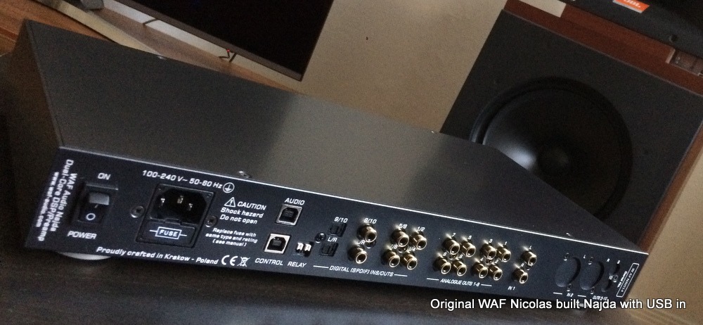

My Najda is boxed and so built by WAF. I have the USB in card aslo original fit.

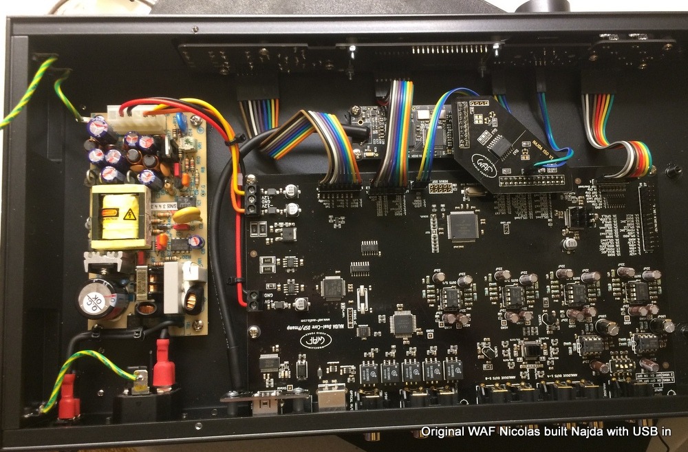

Does anyone know if ant atx power supply could be used with the Najda?
If the voltages match Najda's requirements, it should be fine. I salvaged a power supply from an old Rotel DVD player and it worked fine. There might be some concerns about the noise levels on a power supply that was not designed for audio purposes, but the only way to really know if it is an issue is to try it out.
Najda's power supply requires +5V 1A, +12V 1A and -12V 0,3A. Any ATX power supply will do this even the original IBM PC. But to be sure check out this link.
