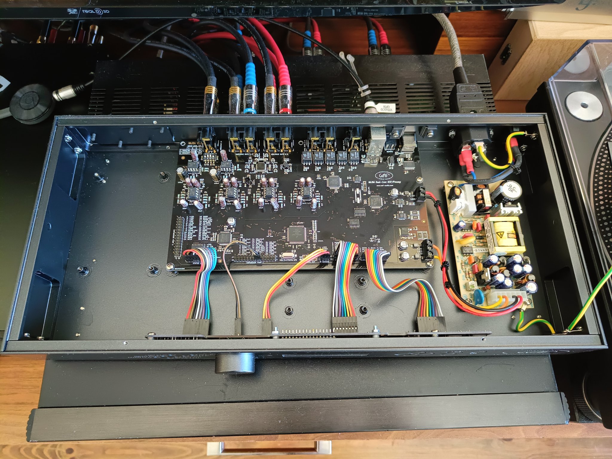

SMPS. Case is compact and non ventilated. But this psu is pretty decent. Works better then on my other unit based on simple, linear psu on lm78/79xx. From pictures box does not look solid but in reality is the oposite way. It's aluminium and all sides are cnc'ed aluminium blocks. I'm suprised that price for boxed unit was do low compared to bare PCB.
Picture is for my unit. One from ebay has additionally USB audio board.

You'll recall the Najda unit that played fine for 3 hours and then didn't output anything, but the lights were still on??
Well, the owner found out that removing the lid upped the working time from a repeatable 3hrs, to over 24hrs / perhaps it never loses sound.. he doesn't leave it on that long normally!
He normally runs it for 6 or so hours at a time, and with the lid off, or raised up a couple of cms, all is well.
So, what could be overheating?
Could it be the SMPS crapping out on one or other of the 5v or 12-0-12v supplies?
Anyone any experience of this. What happens if you lose 5v or 12-0-12v singally? It perhaps not enough voltage or current supplied?
I've used Najda since the very beginning with a Mouser SMPS for 7 odd years, no problem, and then an external transformer with linear 12-0-12v and external linear 5v PSU for the last 4 years, also without glitch, with a sealed aluminium case, and with full array of Burson opamps (the big ones).
As Marvin once asked "what's going on?"
I already wrote this. For my other unit, not boxed with simple linear psu. When it's turn of on standby (with remote) it does not wake up after few hours. With boxed it happens too but after much longer time period. But actually had no problems during normal work. With first unit sound issues where sometimes when I was turning on amplifires, najda was hanging compleatly or on some channels. But for this I'm using power up sequence and turn on Najda last.
