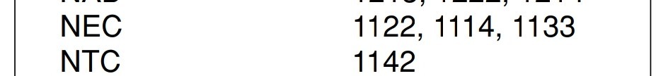

I found this UC1210. Could you tell me what protocol on najda you have configured for it and what code you have selected? I can not force it to work with Najda. Najda sees it only on NEC protocol but then while programing, single button press does double functions skip (kind of double click).I use a cheap all 4 one remote.

The Najda manual talks of NEC & JVC protocol.
I'm pretty sure it was NEC for the All in one remote.
For codes see attached
NEC
JVC (just in case)
I don't remember having any problem with programming the individual button on the remote.

Thanks. My error was I did not kept Setup button pressed long enough. Missed part where manual said that led needs to blink twice.
