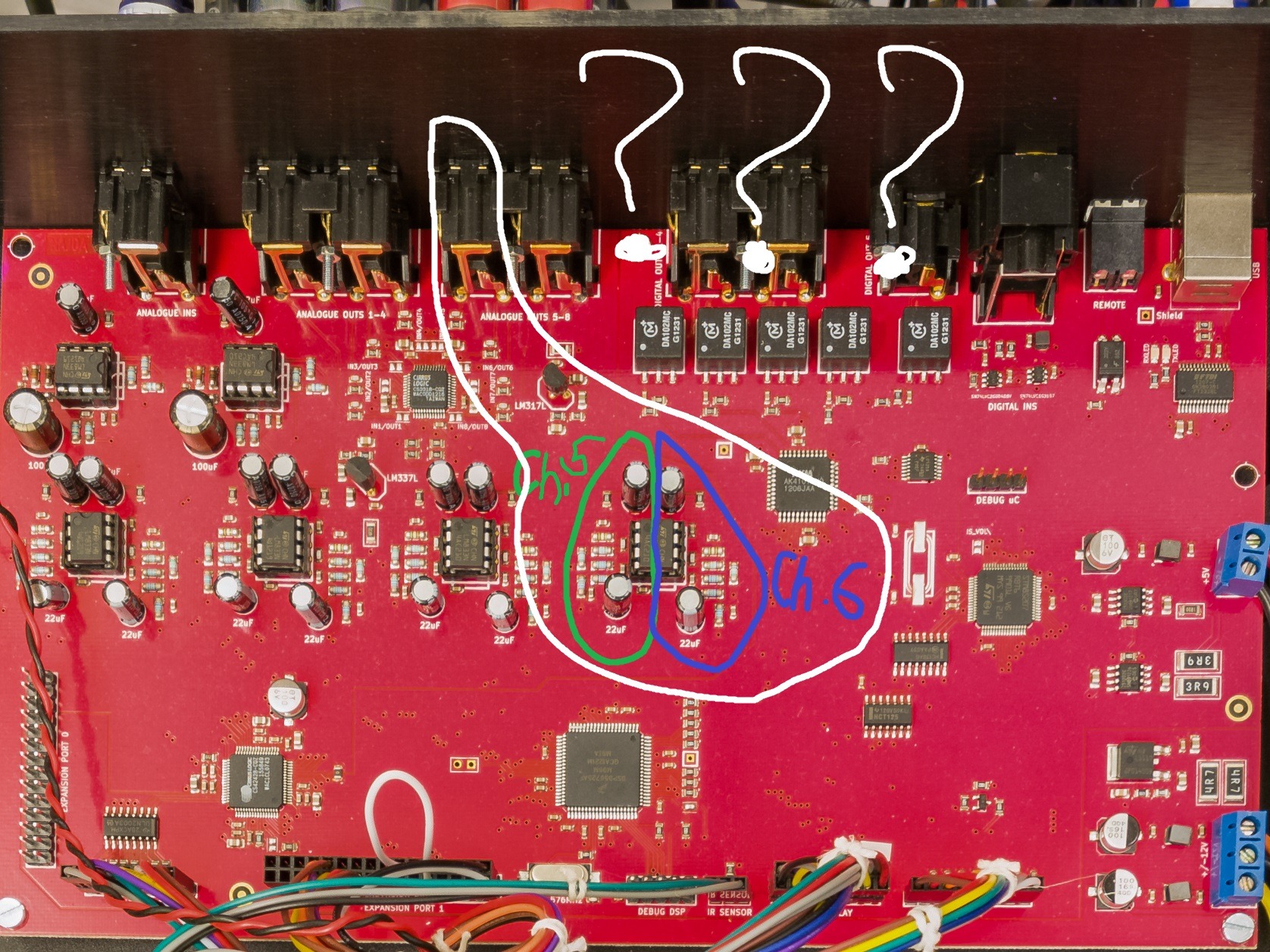

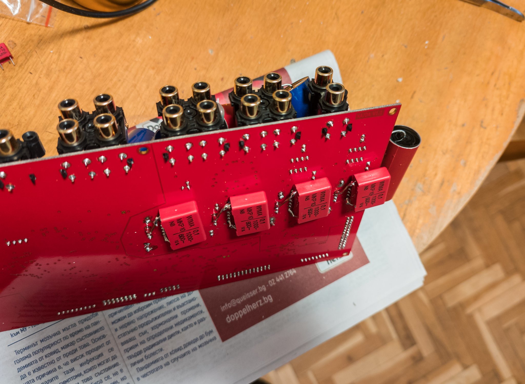

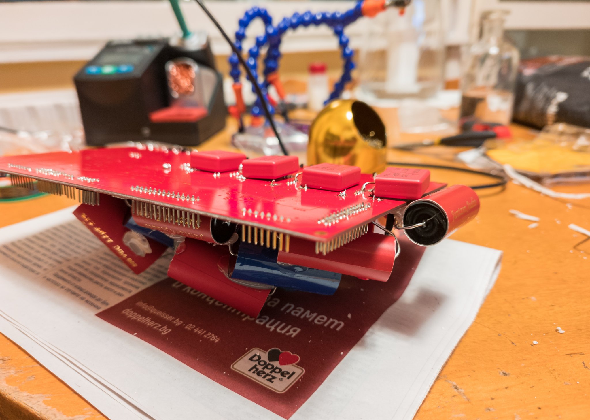

Can you guys help me with the capacitors for the op-amps?
Are one side of them for one channel and the other pair for the other channel?
I hope this photo will make clear my question?
I want to put different values for different channels.

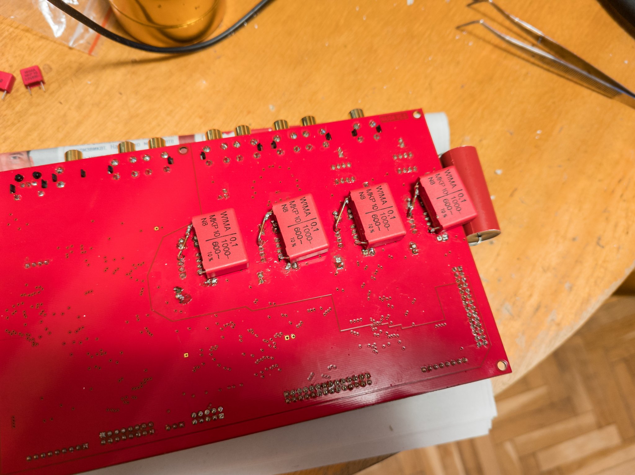

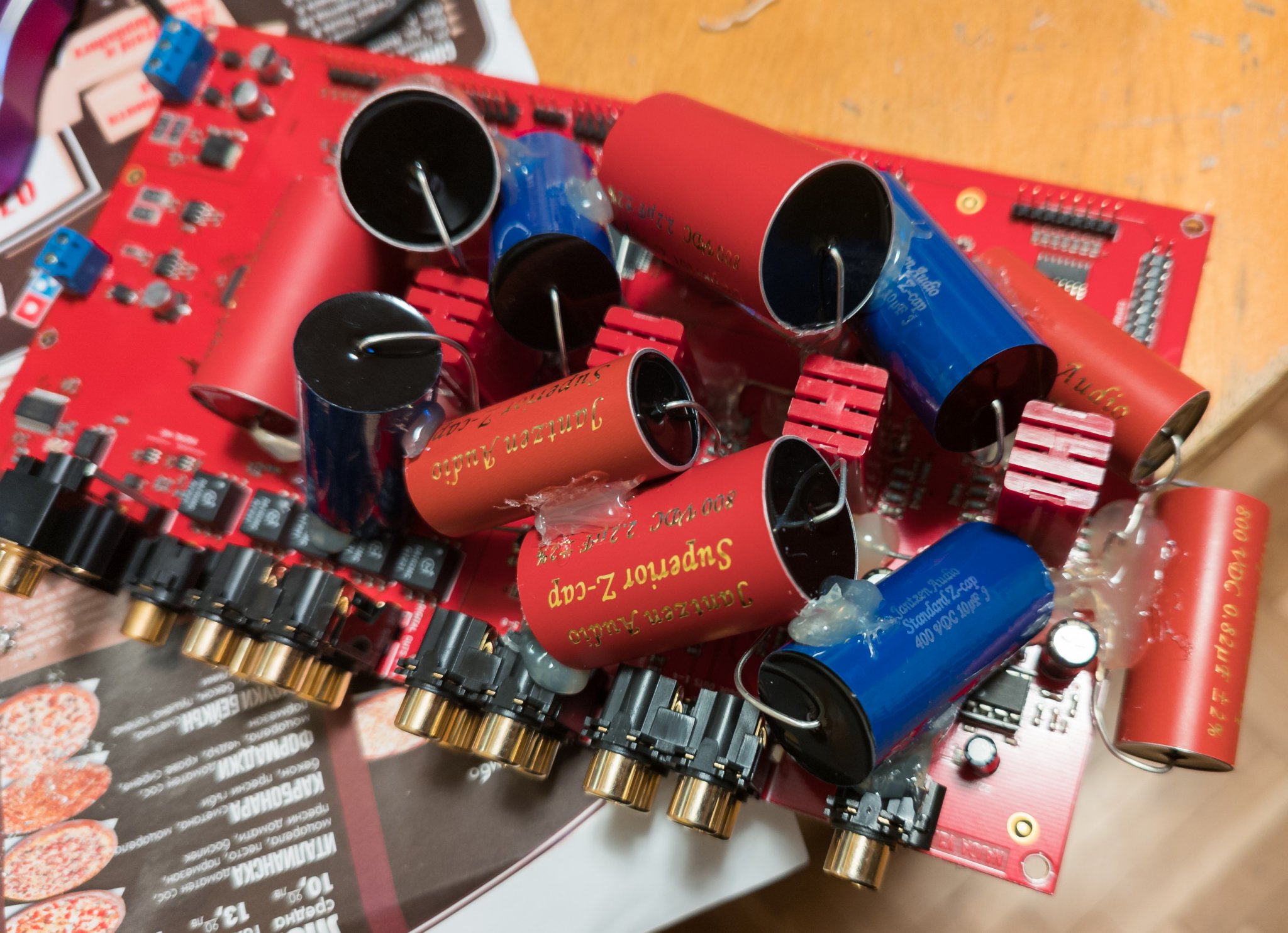

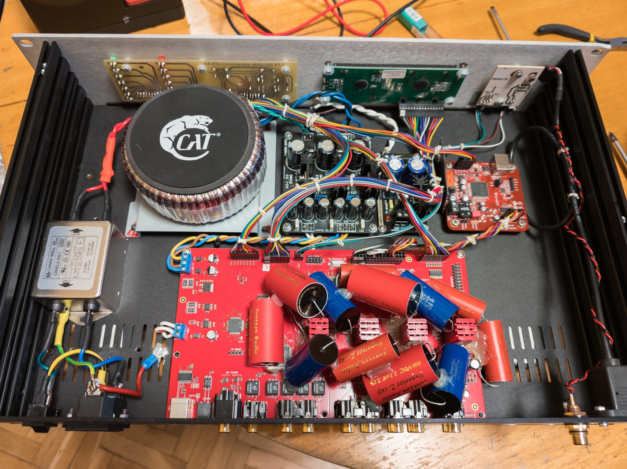

^ Update on the above problem - the reason for the delay was the mixing of 511 sample filters on the tweeter channels in combination with the rest of 1023 samples.
Subjective differences in comparison with stock caps include:
  • + Much tighter bass (like switching from a big heavy woofer to a smaller lightweight one)
  • + Bigger micro-dynamics - more layers and smoother textures
  • + More natural timbre in regards to voices and acoustic instruments
  • + Less sibilance and grain, especially at higher frequencies.
  • ± Much more relaxed sound - On one hand it is relaxed such as the aggression disappeared. However, I feel that overall attacks have a lower impact - It's as if the peaks don't reach the same volume as before.
  • - Lower macro-dynamics - check the above point.
  • - Less enthusiasm in the vocals - they are "whatever" - check the above points.
The negative effects create a feeling of not enough powerful power supply.
What could be the reason for that?
I'm gonna put caps across the Vin pins of the op-amps - any recommendations?

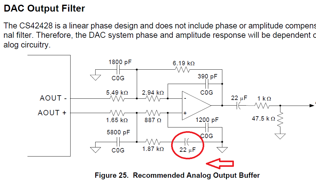

Hmm, I was thinking of removing all caps and bridging them?
I'll be careful on that, at least the way you did. Top/closer to RCA caps are in signal path. But those below opamps are power decoupling (one for + and other for -). If you short then then well you will short power supply.
On the other hand I'm not sure if they are power supply capacitors but anyway one leg is on GND so at least there will be some short in signal path.
Ok I was wrong, that is the cup. But question is if it's worth to touch it?
