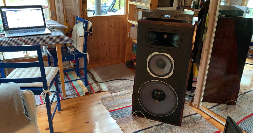

I have been looking for a replacement solution for the Najda.
PC + dac8pro have more EQ power. But usability in home environment with need for multiple source connection can not be solved with a PC.
So Najda is still the got to the solution.

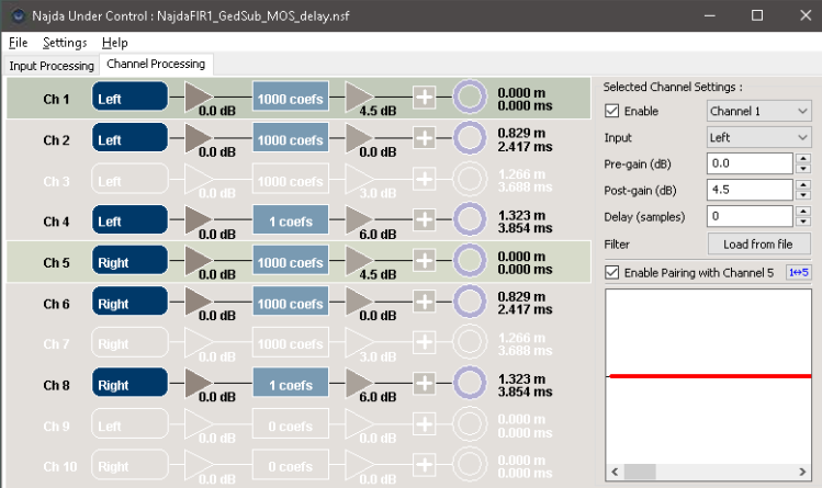

I use FIR filters on Hi and Mid drivers. Base and subs are fed straight true to a MiniDSP 2/4 unit where I EQ the bass. This gives much flexibility and solves some of the lacking computing power.
