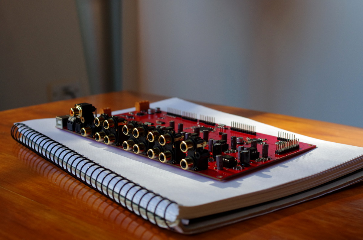

Some time ago I had started a thread about making a project with existing boards I had from a previous project. Well, after investigating several directions the project could follow, based on feedback from this forum and from other mates, I realized I needed to design a new board specifically tailored for the task.
This time the project is really on track and I'm happy to start this new thread with a picture of the recently born little baby. More info will follow shortly.

Yes indeed, the previous board had a DSP56321. This one has a dual-core DSP56725![]()
any reason for sticking with a 24 bit DSP when 32 bit DSP's are typical these days ?
The number of bits is not really relevant. It's all about properly scaling the signal through the processing flow and you can anytime switch to double precision mode in case of need.
24-bit is plenty for audio signals: you wouldn't be able to *measure* the difference between properly processed 24-bit and 32-bit audio - left alone hearing any difference.

what is the sample rate and number of channels ?

Look's good,
Could share some insight details, number of channels, sampling rate, ADC - DAC type and so on please ?

I can't go too much into the details right now, but I can say that 48kHz, 96 kHz and 192 kHz are all 3 natively supported by the DSP and that sampling frequency is user selectable while configuring the board.

So I can reveal now that the board has following IOs:
- Stereo analogue input
- Stereo digital input
- 8 analogue outputs with analogue volume control
- 10 digital outputs (8 of them carry the signal of the analogue outs before DA conversion)
- 2 I2S expansion ports
The board also features headers for keypad with 8 push-buttons, LCD, status leds and IR sensor as well as a USB connector for the control application. Peripheral management is performed by a micro-controller so that the DSP stays fully available for DSP routines.

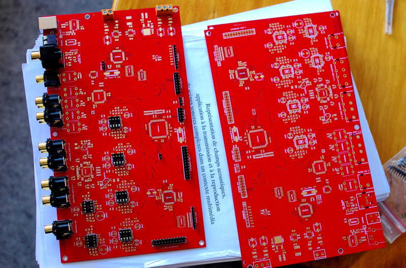

Below is a pic of the PCBs before assembly. At that time I was just making sure that the connectors were fitting properly.
Note that all OPs are on sockets so one can use his favorite model. Also, the caps on the signal path are Through-Hole so easy to replace.

looks like a 4 layer board trevor, application notes for DSP chips would be unlikely to cover 2 layer designs, I can see plenty of vias which hints at multilayerin case of a digital only use, is it possible not to populate analog circuit?

I intend to make available a 'light' version beside of the full one.
The light version would have no analogue volume control, and volume would be handled digitally in that case. Note however that the user of such a board would be able anytime to add himself the chip and get analogue volume, but this will require fine pitch smd soldering.
This would allow users on a budget to make some savings because the bare analogue volume chip is rather expensive.
