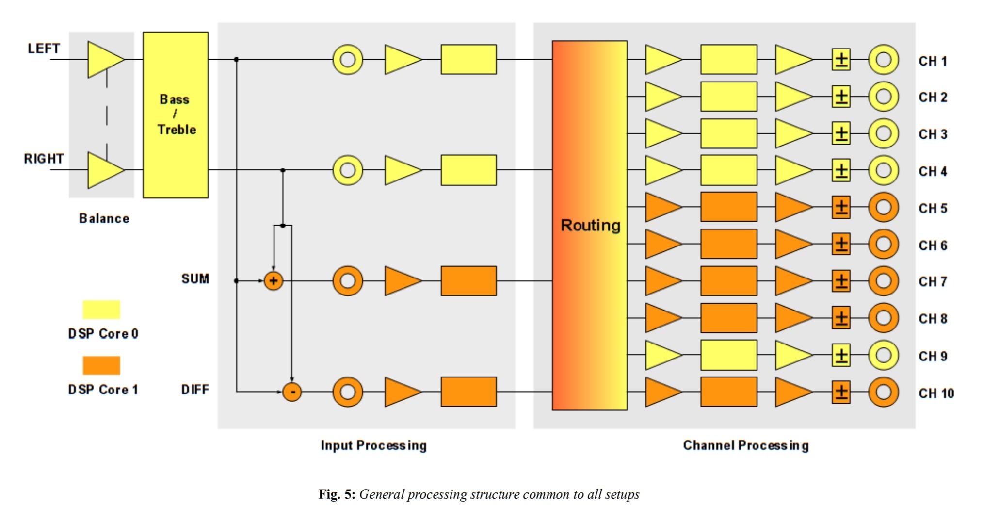

Steve,
I think Nick once said that one core is connected to channel 1,3,5 and 7 and the other is connected to 2,4,6 and 8, so left and right channel should be used accordingly.
Edit: I was wrong. I think ch 1-4 is core 1 and 5-8 is core 2.
Thanks Paalj,
That's makes perfect sense.
I'd searched and searched to no avail!
As I set things up ages ago, the heavy lifting (bass) was done on core 1.
Hence the higher load!
I'll reconfigure in Parallel Lines instead.
Fingers crossed.

You have searched wrong place. I guess RTFM phrase is still actual 😀. It's in NUC manualI'd searched and searched to no avail!
Made the changes in the setup so it's all left on channel 1 to 4, and right on channel 5 to 8.
Will change the physical outputs next and delete all the old presets using the left/right system!

👍 Didn't search there😂You have searched wrong place. I guess RTFM phrase is still actual 😀. It's in NUC manual
Searched online.
All set for a test soon.
Be nice to bolt on faster processors!
Thanks for the help guys.
