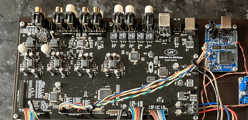

badeff, you need to connect BCLK from JLSounds to Najda pin 23. BCLK in JLSounds is on pin 11, not pin 13. Just like your screenshot shows.
Also, your I2S wires seem very long. If they are more than few cm LVDS is better choice over IIS.

But when I played a test sweep tone 20-20000 from REW, there were very strange artifacts in the higher tones, from approximately 10 KHz and above — like howling wind, or repetitive echo.
Just watched your video. This actually reminds me of identical issue I have had time to time using macbook. Just can't remember what was the cause. But I'm pretty sure if you use different software to generate the sweep you won't have the issue. With ARTA I never had the issue but with REW I did, but only occasionally. Also, IIRC, reloading najda setup helped. You could also check your macbook audio midi setup and try with different bit depth/frequency to see if anything changes.
Update - the culprit is found.
I double-checked the wiring with the guys from JL Sounds (we're lucky to live in the same city), they confirmed that it's correct, but had no clue where the artifacts might come from - and also suggested playing with the output bitrate, or trying the other I2S inputs.
After playing with various settings, it seems that that Najda's 192 KHz resampling is the problem. I have two active presets loaded now, with just basic two-way crossovers at 96 and 192. When started in 96, Najda plays the test tone without a glitch - from two different versions of REW, and from a WAV file. Once switched to 192, it starts adding loads of noise and artifacts in the high frequencies. Switching back to 96 - the noise is there again. But if the Najda is switched off in 96 KHz and restarted, all comes back to normal.
So, I'll simply ditch 192KHz modes, stick to 96 and save some computational resource. 🙂

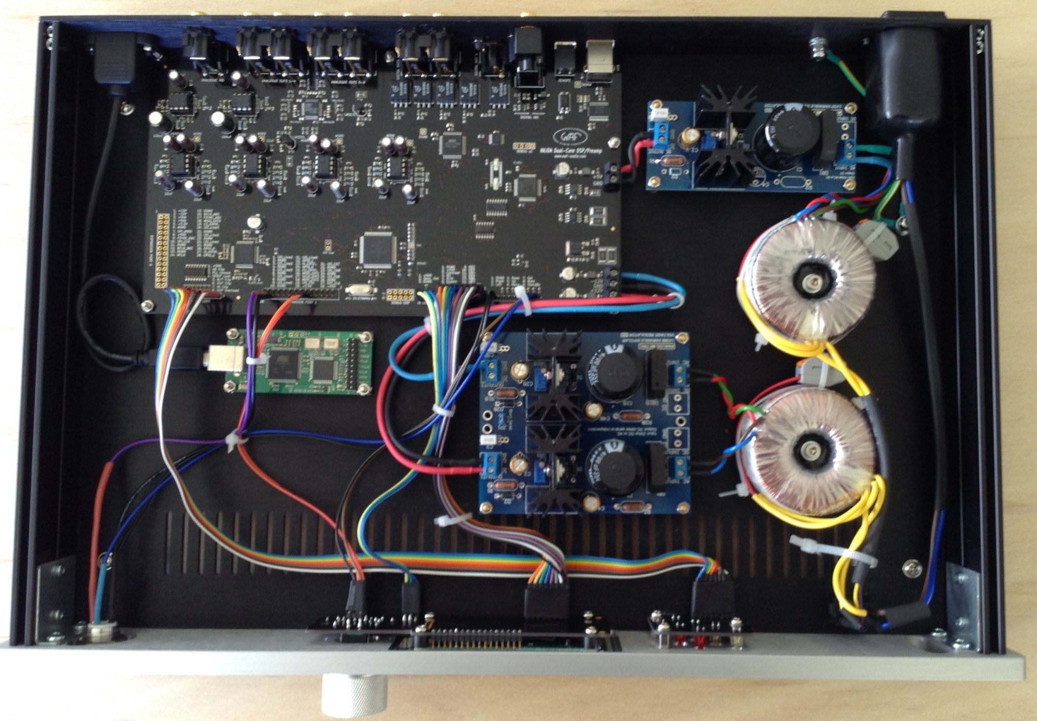

Well, I'll try relocate the XMOS board to the other side then, before building a final case for the Najda.
What I don't like in the picture is the USB connection between the board and the back of the case. A few years ago I made a small listening experiment with several generic USB cables and an entry-level audio grade USB interconnect, a Furutech Formula 2. Compared to it, all the generic cables totally killed detail and dynamics, producing a muddy and muffled picture. I'd say that the benefits of shorter I2S wires in this case would be annihilated by a crappy USB line feeding the board.

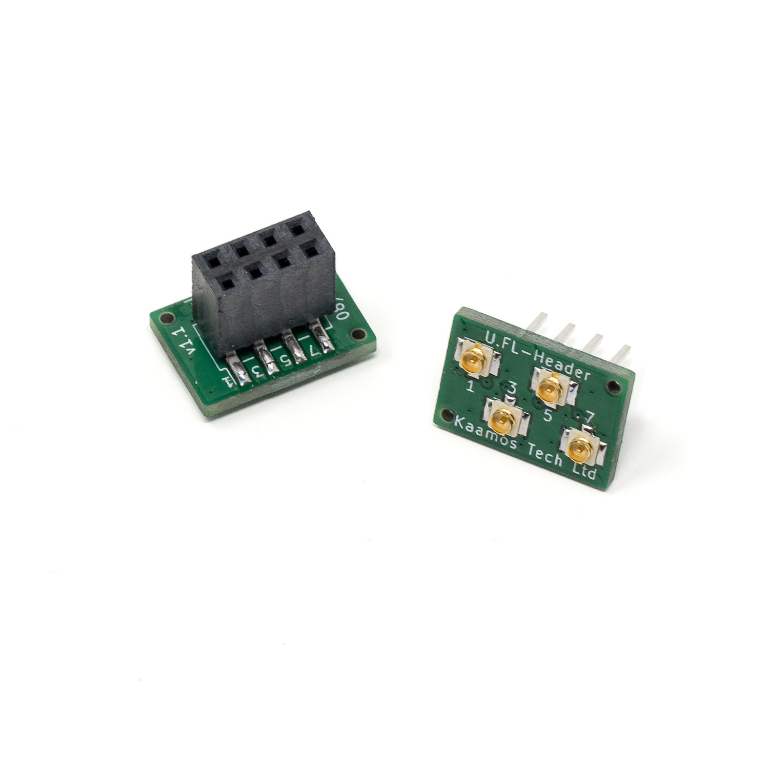

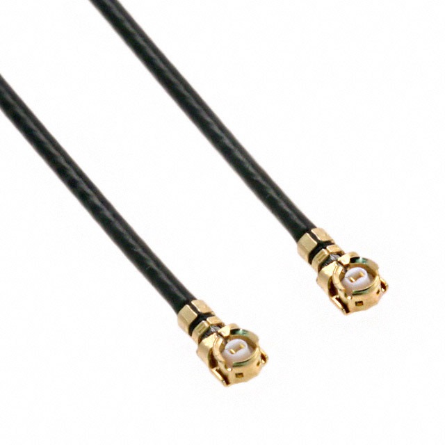

You could live with slightly longer I2S wires but then switch them to UF.L cables
and for that you would need some custom pin to UF.L converter, similar to those.
Sorry, I'm not cables believer. Too long I2S don't change sound quality, it leeds to transmission errors, breaks, cracks and whole lot of unexpected behaviour.

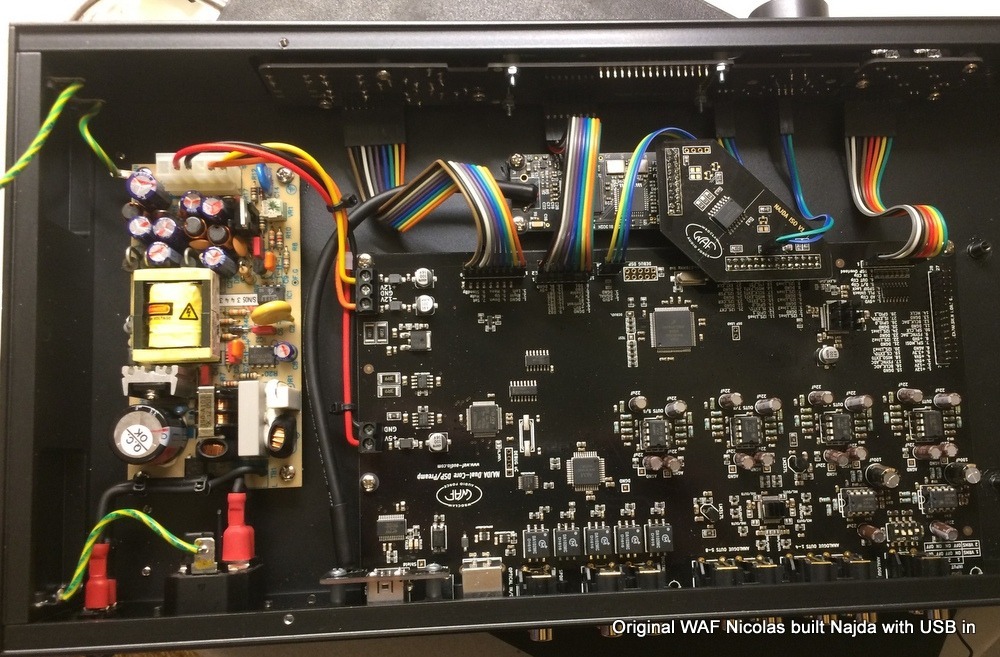

In original Najda Boxed, connection was done with additional optoisolator board.
Anyway, before you boxed it you can make another set of shortest possible I2s cables only for test purposes and check if this fixes the problem
And another topic are your wires equally long? Those on left looks longer then green one, keep all wires same length, needed or no.
Thank you Bacek, I'll check these out.
That looks much better than the previous boxed version, indeed.

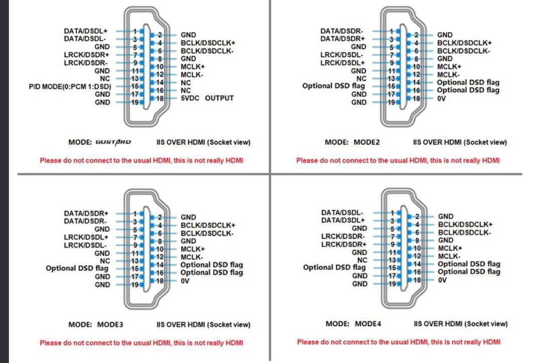

This may have been covered somewhere else but my basic searches didn't reveal.
I am interested if connecting my Gustard U18 reclocker to Najda using I2S might yield better SQ than the Coax Spdif I currently use between the two?
The Gustard can output I2S over HDMI.
Can have 4 different output settings
Najda uses native I2S.
In the past I have used WaveIO for USB into Najda, and more recently RPi/Volumio + Kali reclocker feeding native I2S.
For I2S over HDMI
I will need a HDMI receiver board at the Najda end to translate the HDMI levels to raw I2S.
Would something like this do the job?
https://www.audiophonics.fr/en/interface-modules/hdmi-to-i2s-spdif-digital-interface-p-13415.html
This must have been done before?
Any recommendations on devices or views if SPdif is unlikely to be beaten?
