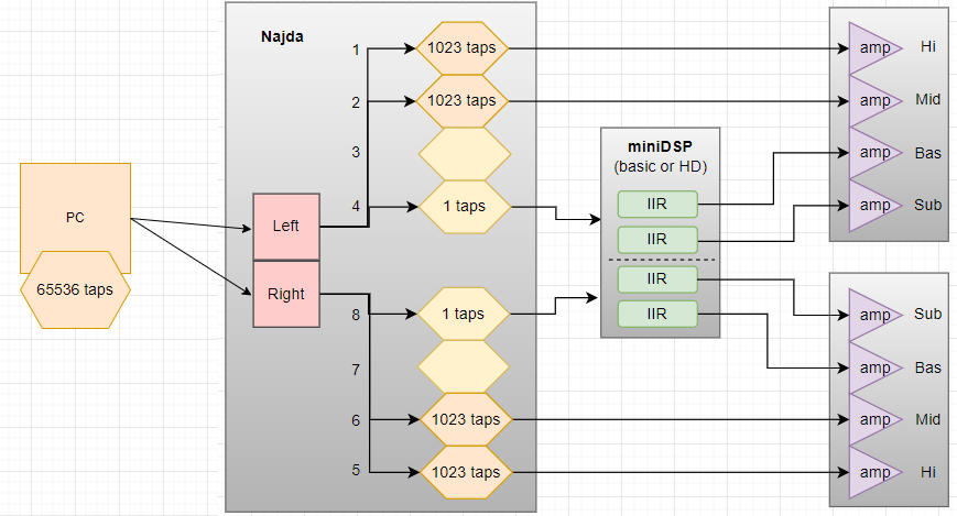

bass only roughly by hand, also with RePhase,
1023 taps don't seem to be enough to do anything of value below 200Hz. Or do you want to explain what you are doing?
I have also used FIR for mid- and high- speakers. The taps are not enough at the mid-low end 200Hz, but I have been able to manage some XO features. However, the horn offers many adjustable opportunities.
See the picture of how I solved the lack of taps at the low end.
I never thought of that option. Being old school I use 18dB/oct Bessels and let Najda process at 96kHz, I also favor linear supplies, but haven't dared to apply tweaks to the PCB. I really need to add some room correction for the subs, but haven't come to make any sweep measurements yet. As is I'm very content currently listening to the Simply Red, Picture Book LP.

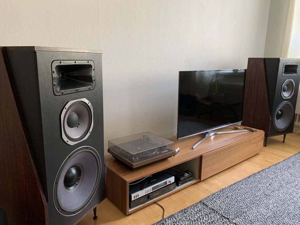

I guess the difference is in the single point source of the MEH (drivers in the 50Hz to 18KHz range all within 1/4 wavelength of each other), and focus of the narrower control pattern compared to large distances between each driver of the 5way and their wide dispersion, Exponential, Tractrix and le Cléach.
With my now Multi Entry Horn system
I can only imagine how this sounds. I've seen pictures of Your system elsewhere, it looks just great. Myself I only have a backloaded horn together with a separate treble driver and a closed box for the lowest frequencies. The system with ear adjusted Najda x-over sounds fabulous to me. I also have a separate ESL57 system that I listen to occasionally. They sound fantastic in their own way but no way as full at the horn system
(Sorry for maybe becoming a little too far off topic)

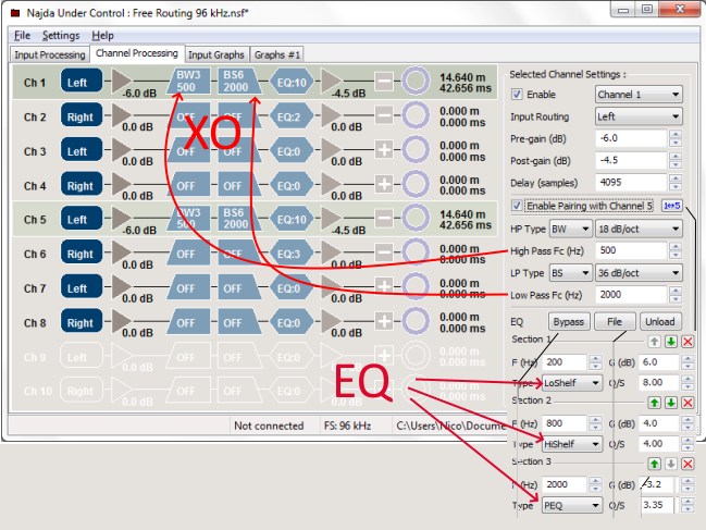

I'm looking for a good and cheap DSP XO for active speakers.
Najda is a DSP processor that has both XO and EQ features. XO or EQ, technically, there is no difference. The XO is set for each driver at the high and low end of the frequency range where you want them to play. The EQ filters are then set between the XO filters.

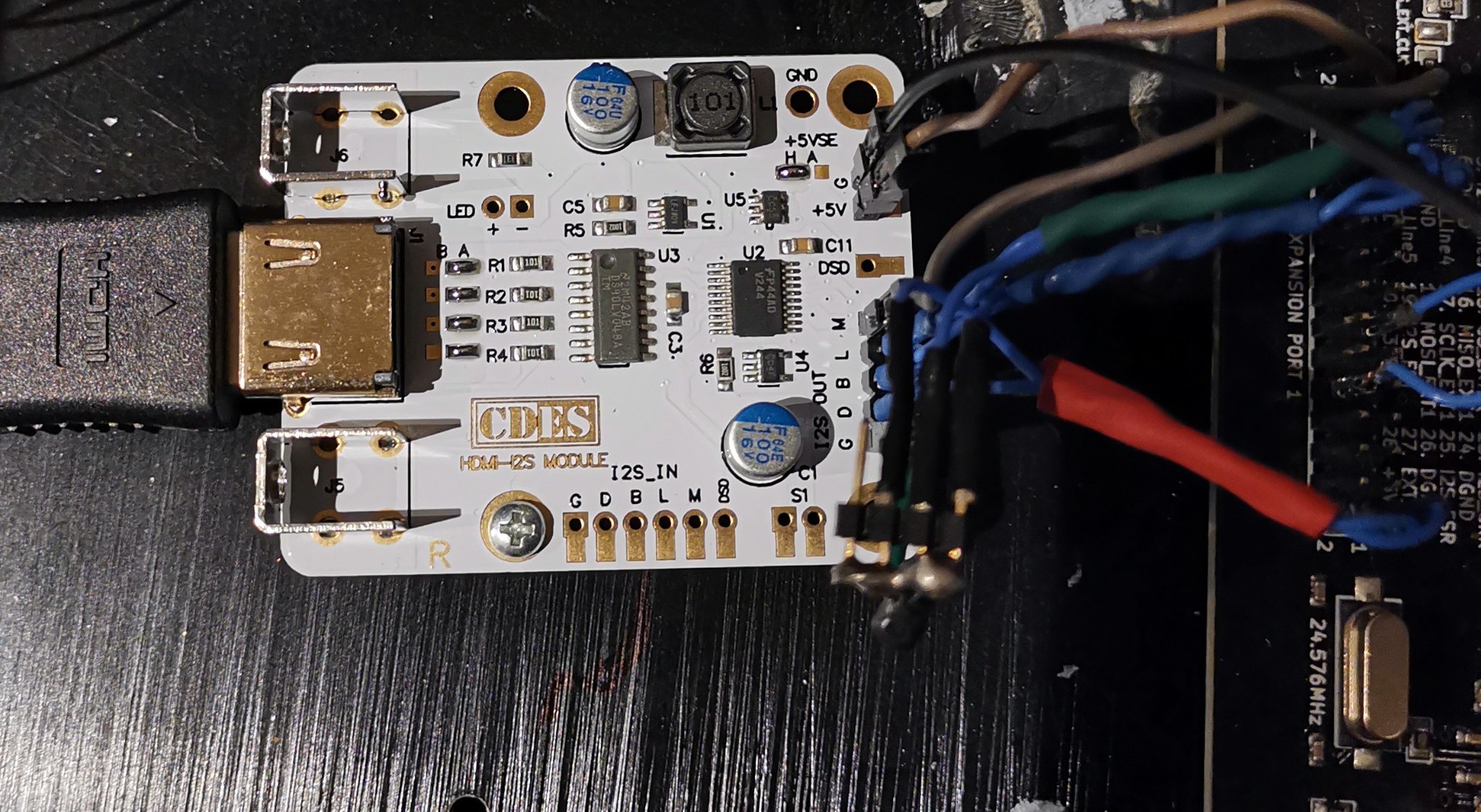

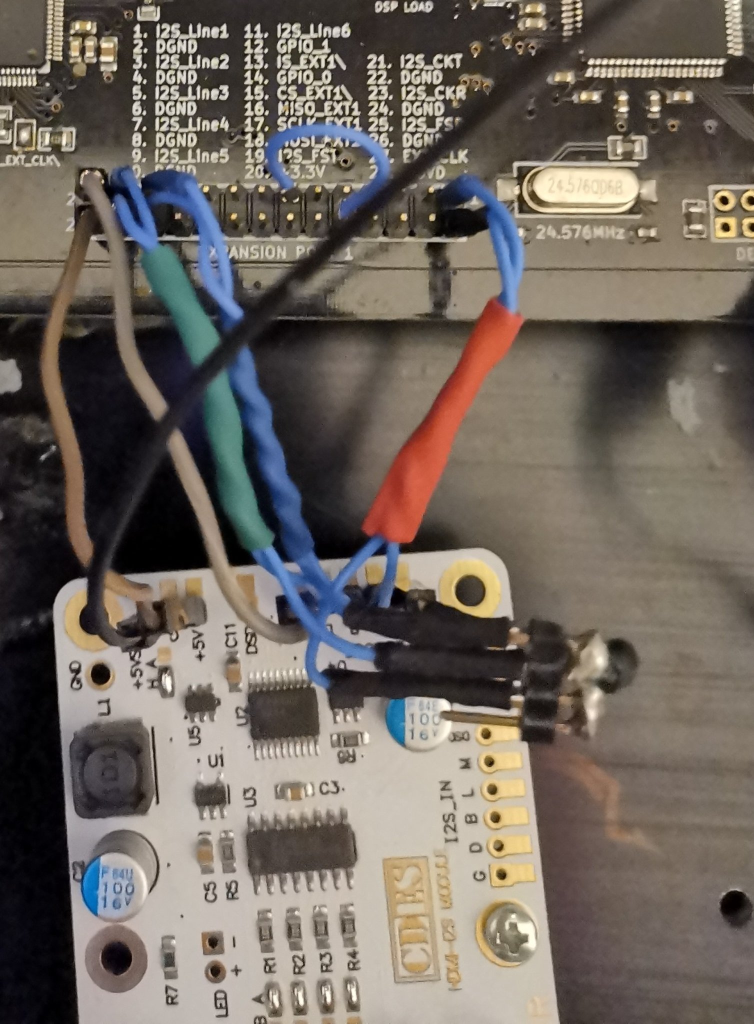

I2S over HDMI to Najda
I use a Gustard U18 reclocker (cleans up Sonore Ultrarendu Streamer nicely).
Was using RCA SPdif to connect up.
Prior to this I was using RPi/Kali reclocker with Volumio, I2S in to Najda.
Before that USB with WaveIO I2S in.
I wanted to be able to use a CD transport sometimes with SPdif.
Found the CDES I2S over HDMI to Native I2S converter module, cheap on AliExpress.
Got got around to wiring it up.
Removed RPi/Kali.
Figured out the pins
G D B L M on the CDES module
Ground, Data, BCK, LRCK , MCK
Najda has the following.
Line1 (audio data pair) pin 1
I2S Serial Clock Receive (CKR) pin 23
I2S Frame Sync Receive (FSR) pin 25
I2S External Master Clock Receive (Ext_CLK) pin 27
And a digital ground for each (connected then all together).
Gave it +5V from pin 28.
Connected up, powered up.
Plays perfectly.
Quick lash up to see if it worked
Result! SPdif freed up.
Najda 👍 - still as good as ever
