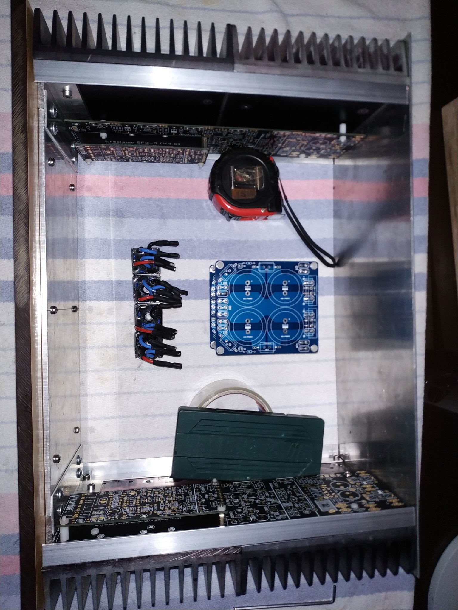

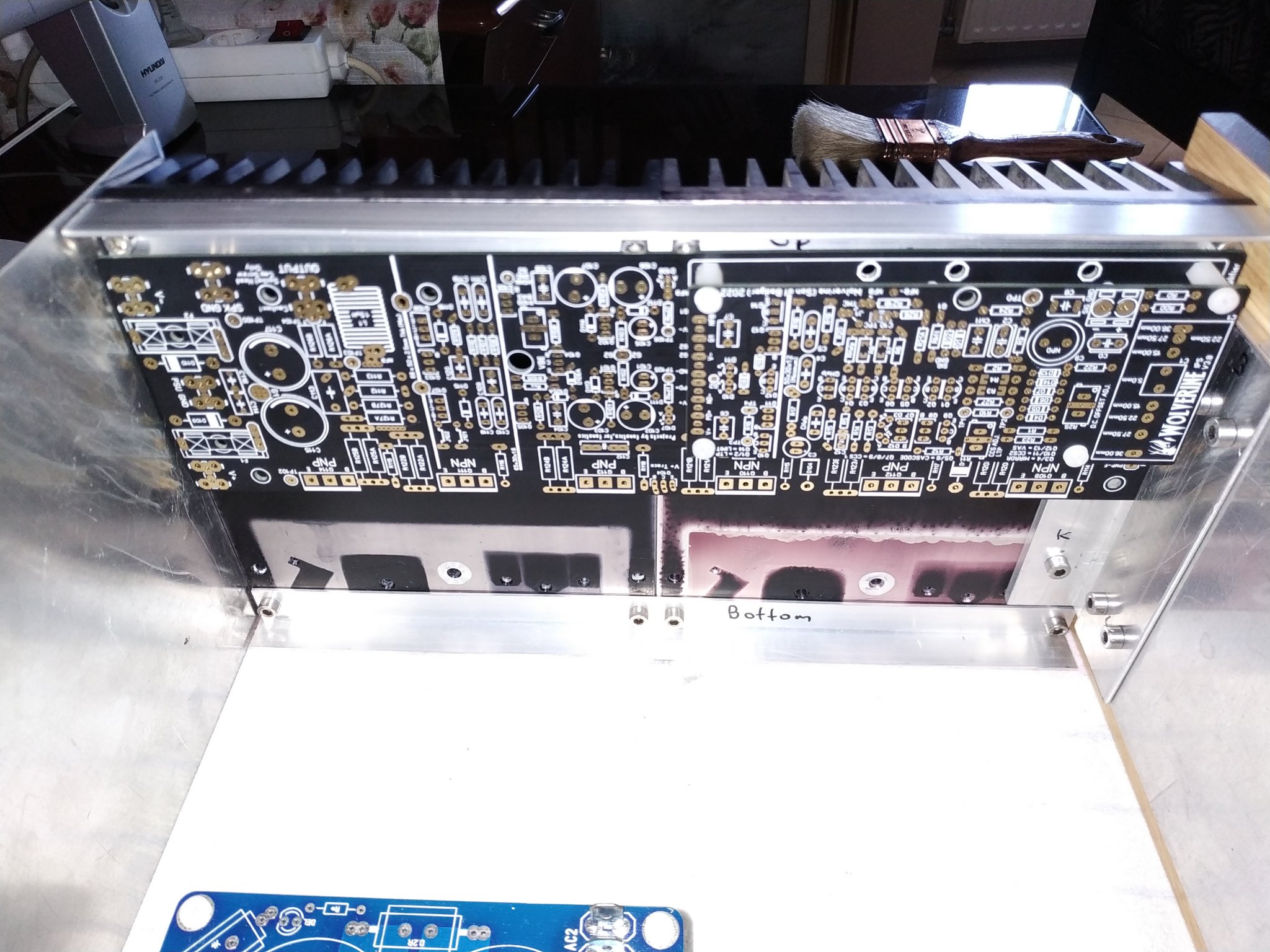

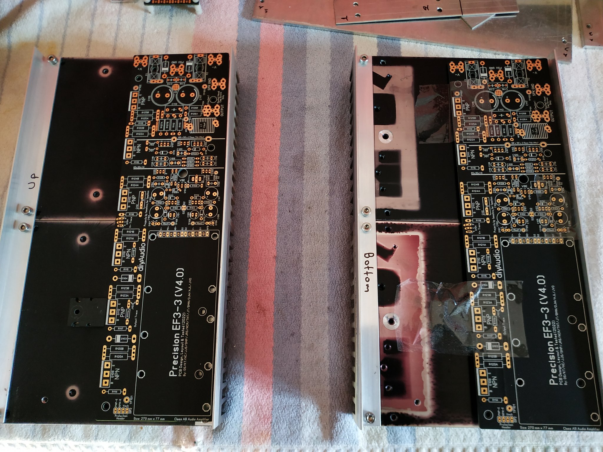

Almost finished the box....

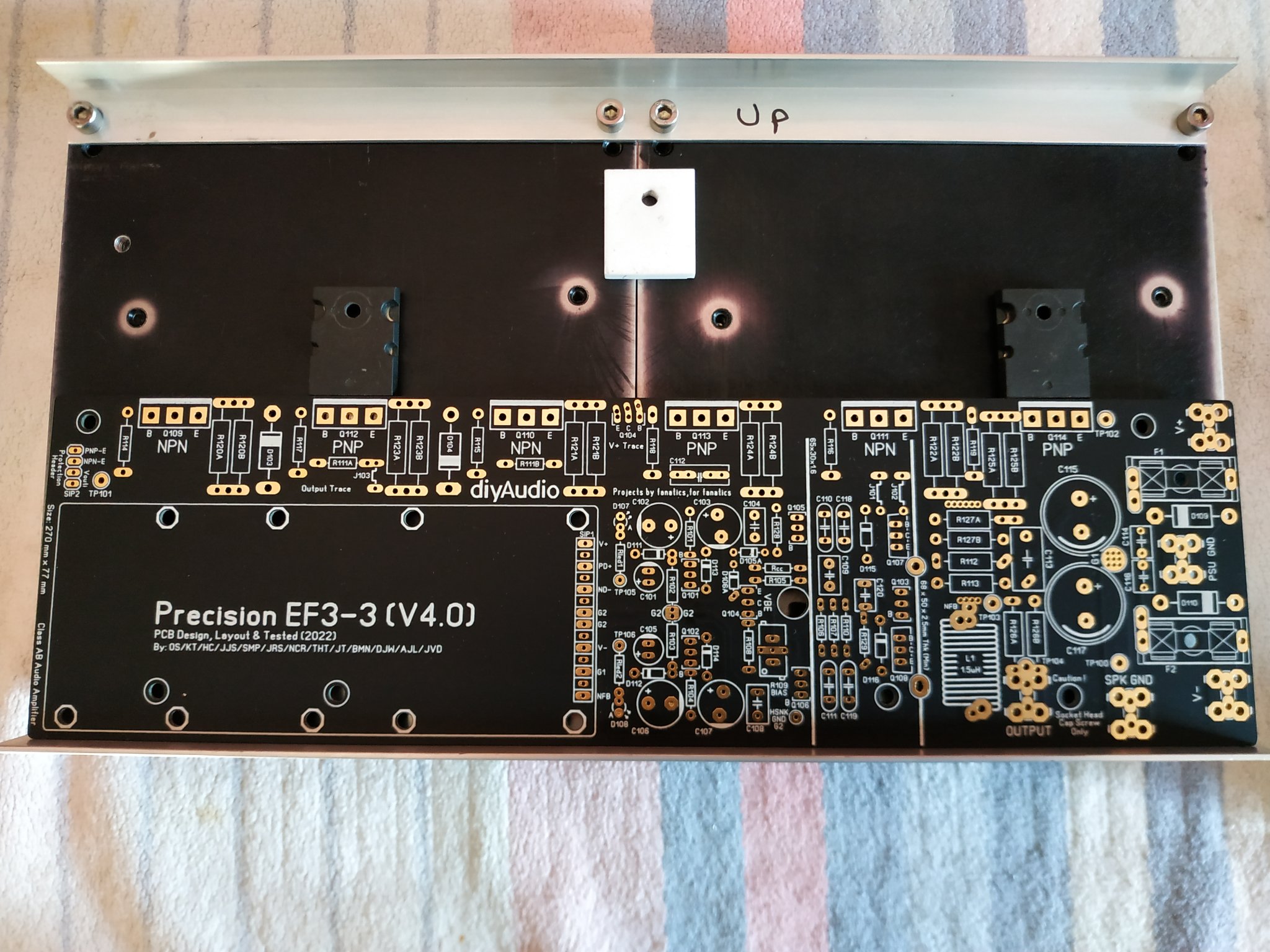

Here I would like your opinion on the placement of the boards .

I would prefer the way in the right(101239 jpg).Has anyone mounted the boards this way so that their outputs end up on the back of the box?
Agreed, I like the outputs on the bottom third of the heatsink.

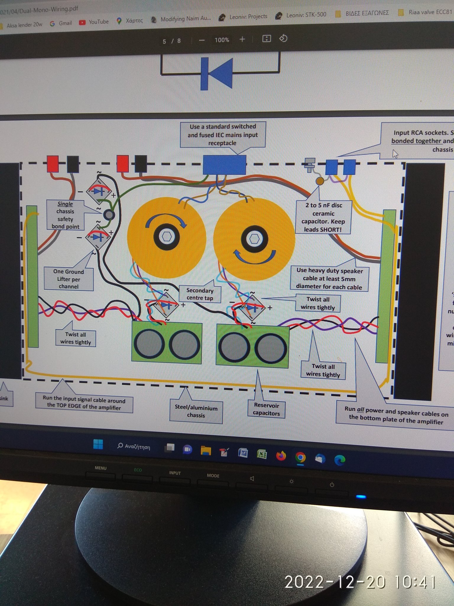

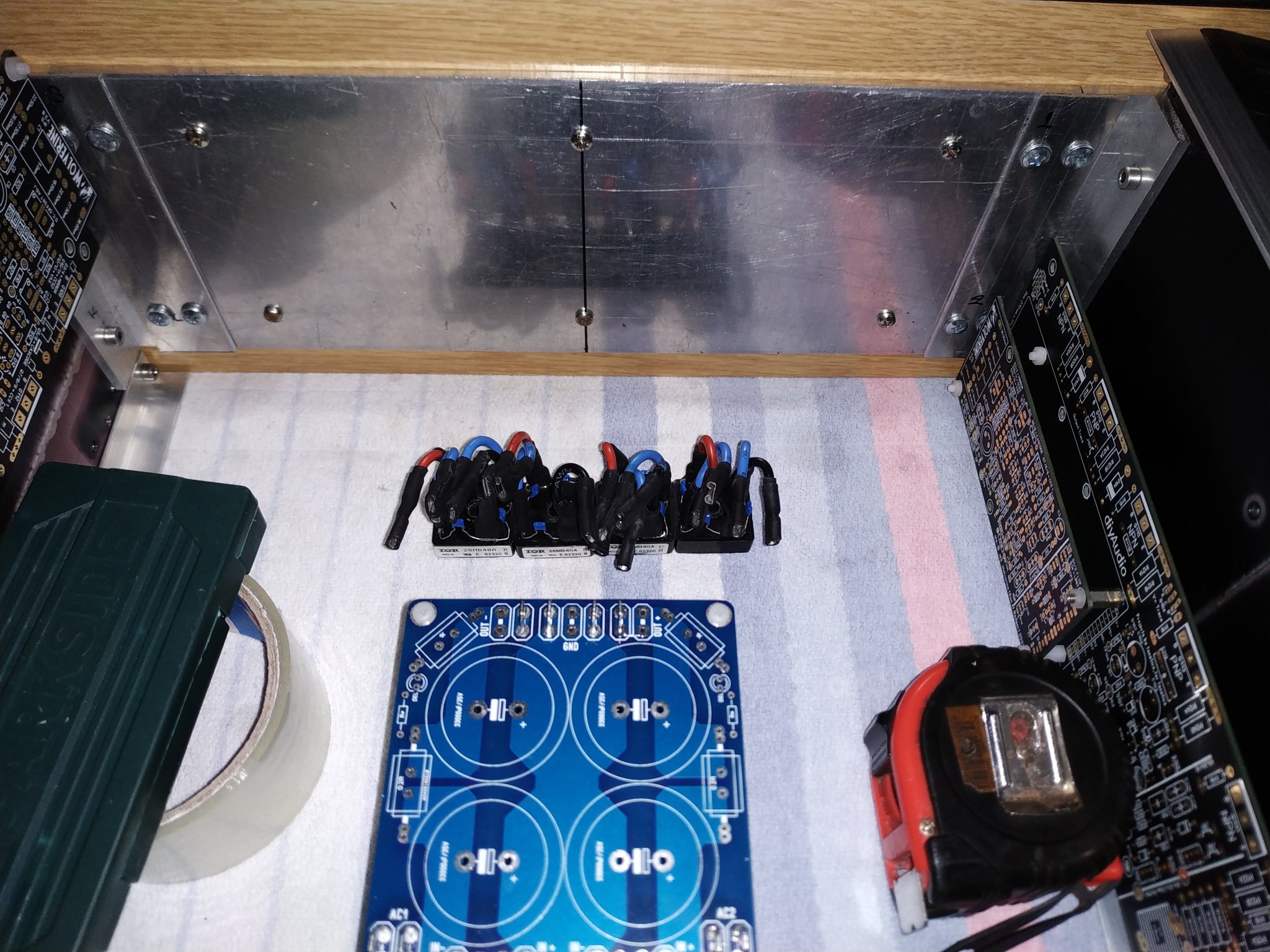

I was also thinking about how to mount the boards. I read the "how to wire an amplifier" document several times. It repeats over an over again that power wiring should be kept as short as possible. Audio input wiring should be done smart, reducing loop area, the shortest possible way is not always the best.
I think I will end up mounting both boards with their power input and speaker output section facing towards the back panel. This way power wiring and output wiring can be kept short and tidy.
As this is not a class A amp, I hope heat will not be a problem just because one of the boards is mounted with the outputs on the upper third of the heatsink.

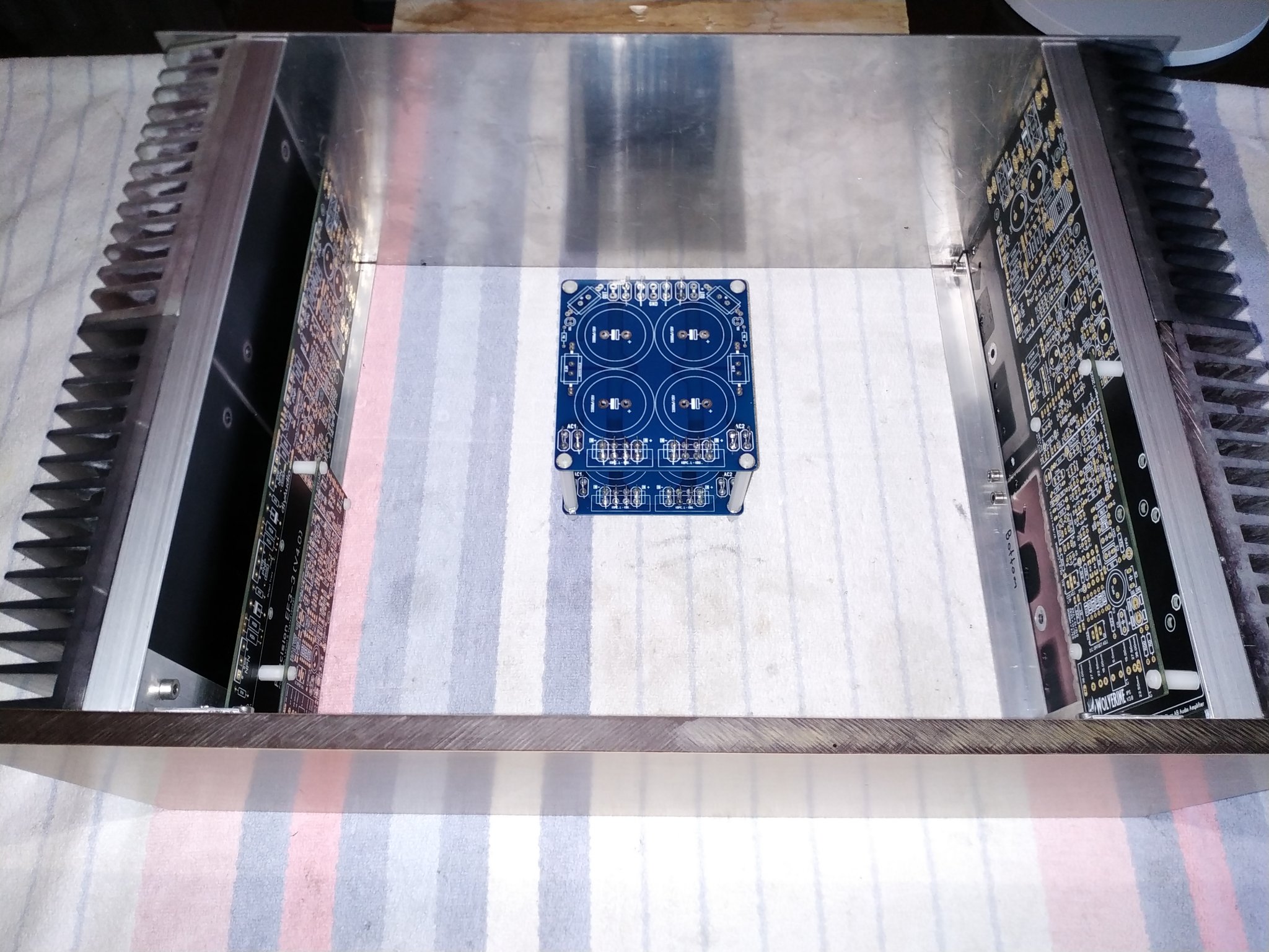

These are exactly the thoughts I have about the shortest power wiring. Of course, one board is placed in the upper third of the heatsink. My heatsink is 15.5cm tall and 27.5cm wide.I was also thinking about how to mount the boards. I read the "how to wire an amplifier" document several times. It repeats over an over again that power wiring should be kept as short as possible. Audio input wiring should be done smart, reducing loop area, the shortest possible way is not always the best.
I would like more opinions if it really reaches the height of the heatsink if it is placed like this to cool properly.
The transistors that will be used are the 2sc5359 και 2sa 1987 at 64 volts

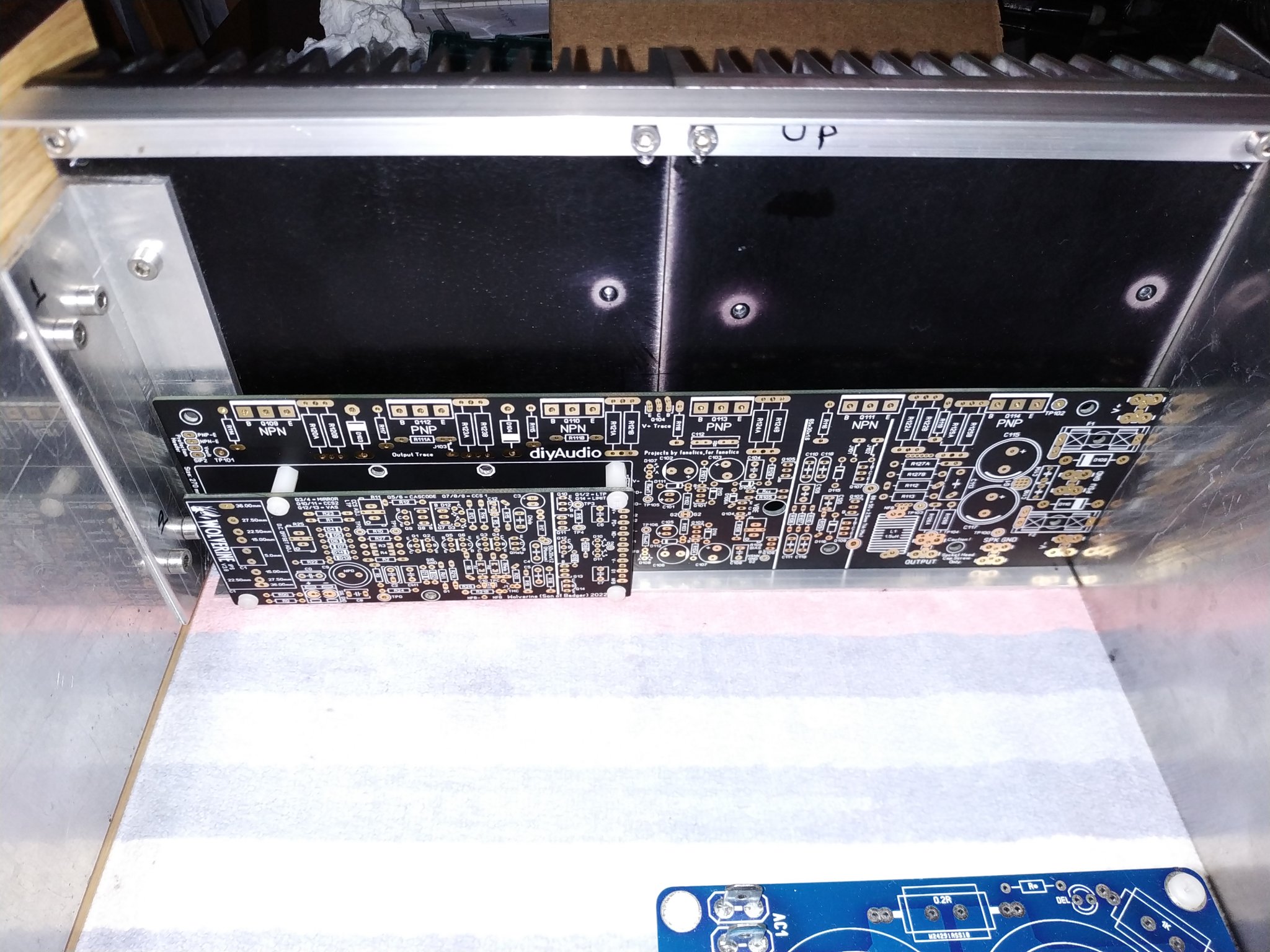

I believe your on the right track. It's preferable to have the AC transformer at the front of the chassis. Then have each pcb orientated so the DC power inputs are at the front of the chassis and the input signal terminals are towards the rear panel. This will mean one pcb is flipped relative to the other. Mount each pcb as low as practical to allow as much room above the output transistors as practical. Drill the two holes for the RCA inputs next to each other approximately 40mm appart on the left side of the chassis. This will keep the length of both input signal wires about the same length and minimise loop area.
It sounds like you have it under control. The how to wire an amplifier is a awesome reference.

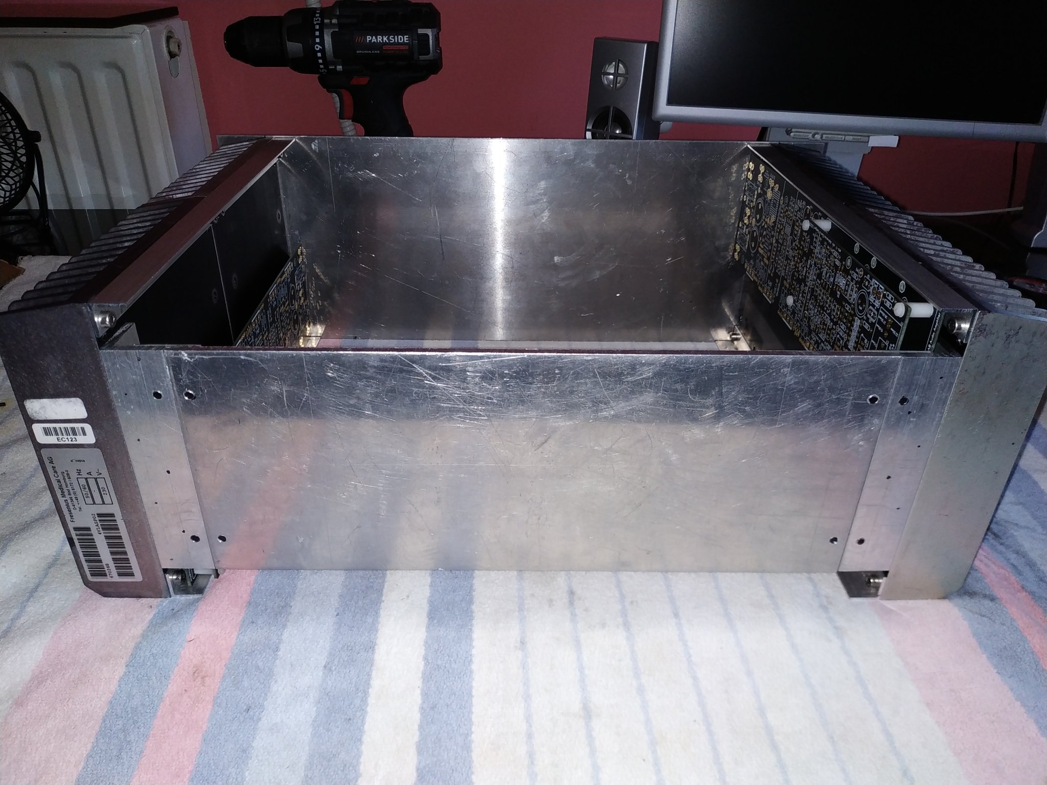

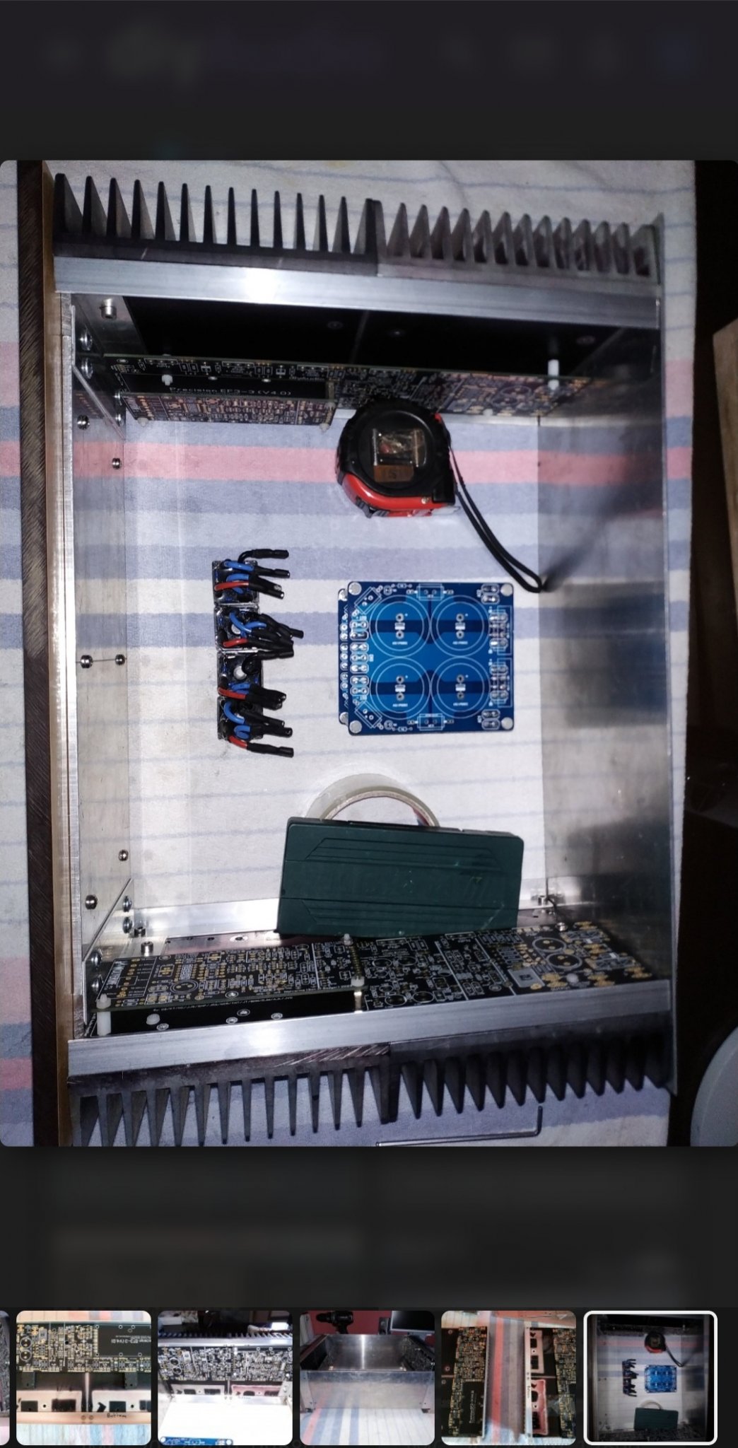

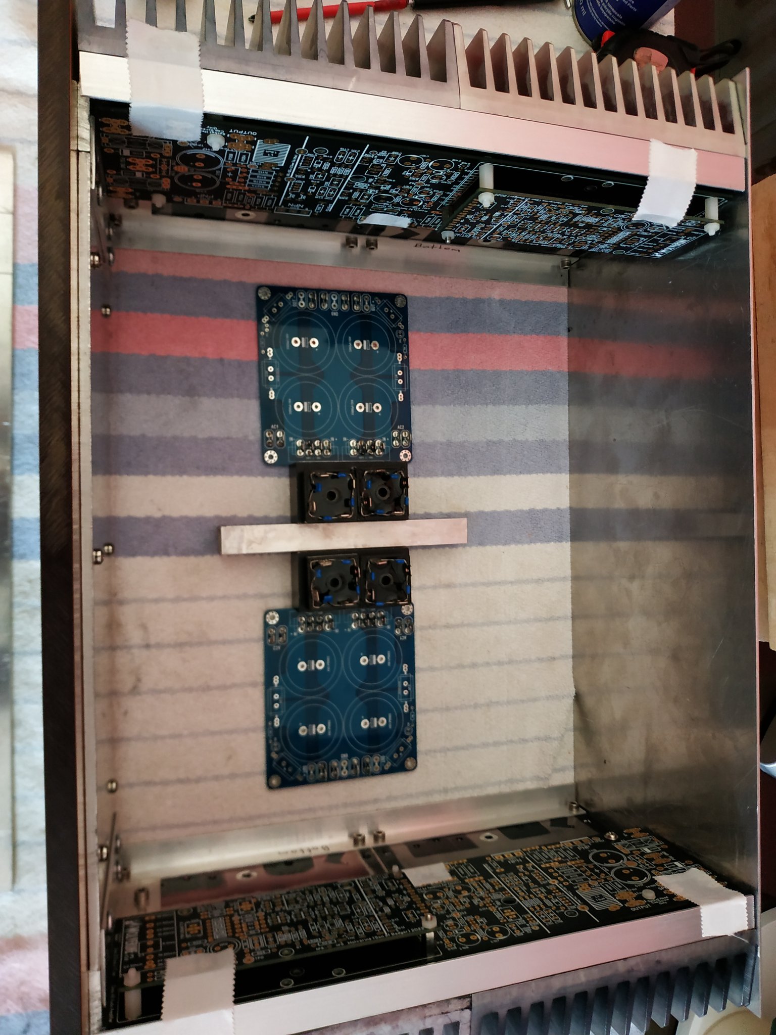

Stuart thanks for your explanation . Please look the pic and confirm the orientation of the boards ....The inputs at the back side and the power connections in the front panel near to the trafo...one board top the other at the bottom.
In some of your photos it's a little hard to know which is the front and rear of your chassis but from what I can see in this photo you want to rotate each pcb 180° so the input boards are at the rear of the chassis. Feel free to move things around and send another image to confirm.
Yes that's correct and you RCA inputs will go here.Stuart thanks for your explanation . Please look the pic and confirm the orientation of the boards ....The inputs at the back side and the power connections in the front panel near to the trafo...one board top the other at the bottom.

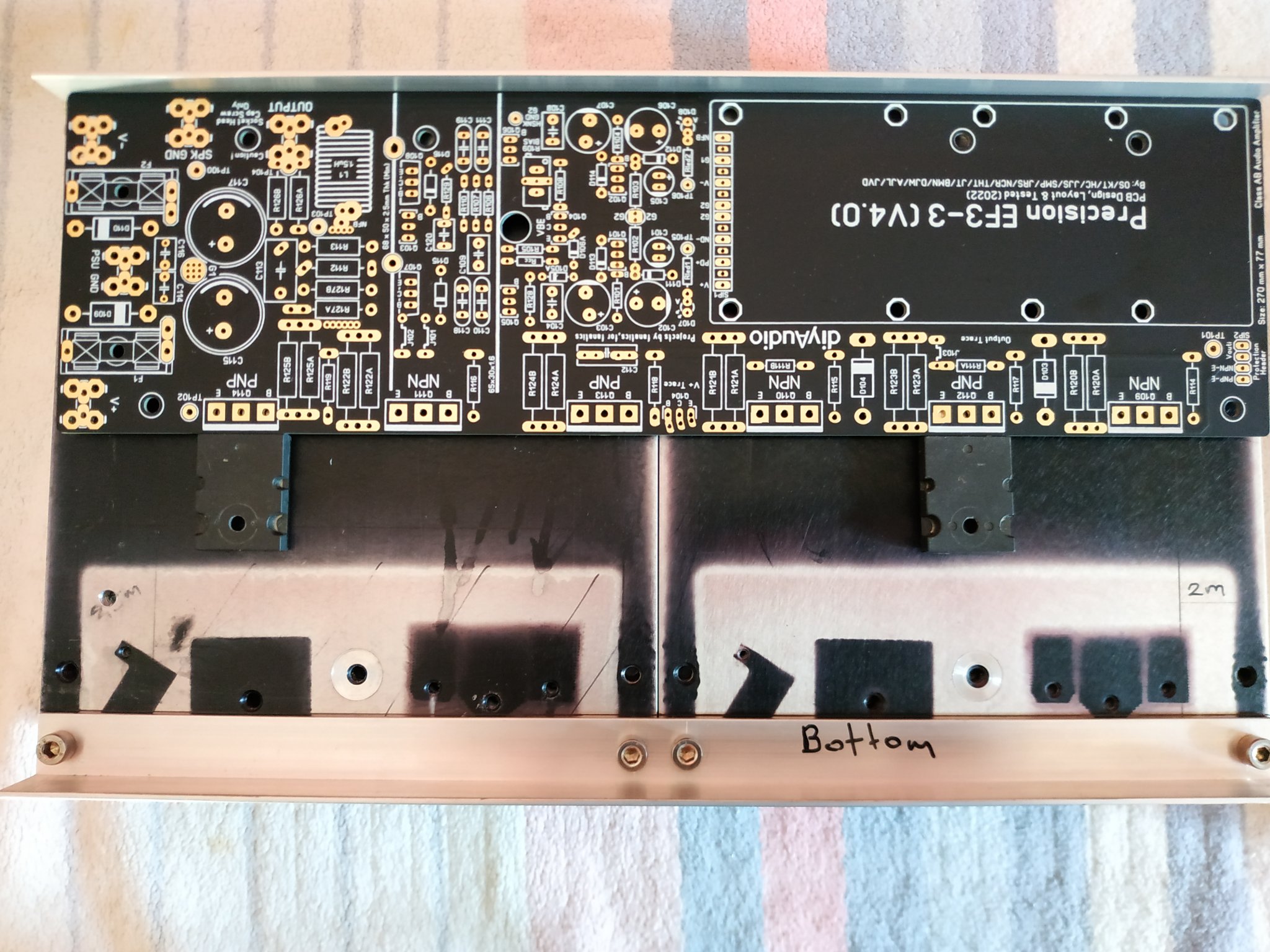

Understand......about Rca inputs and the dc power inputs placement.....but with this setup , the output transistors of the top board located at bottom third of the heatsink and the other bottom board output transistors at top third of the heatsink. Less cooler space....what do you think they will have the same behavior thermally?
I wouldn't be worried about that. I have seen many amplifiers were they are mounted in a simlar orientation and even closer to the upper edge.Understand......about Rca inputs and the dc power inputs placement.....but with this setup , the output transistors of the top board located at bottom third of the heatsink and the other bottom board output transistors at top third of the heatsink. Less cooler space....

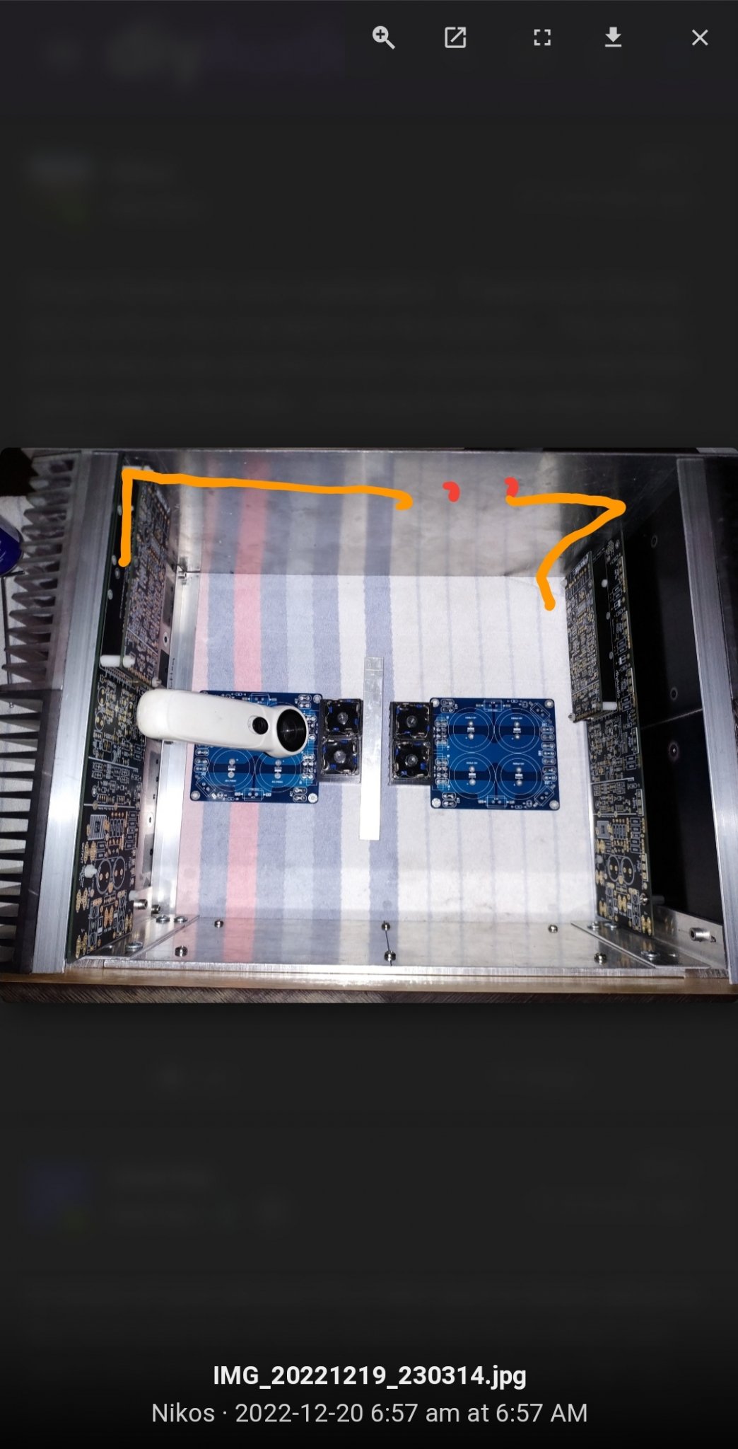

According to Bonsai.

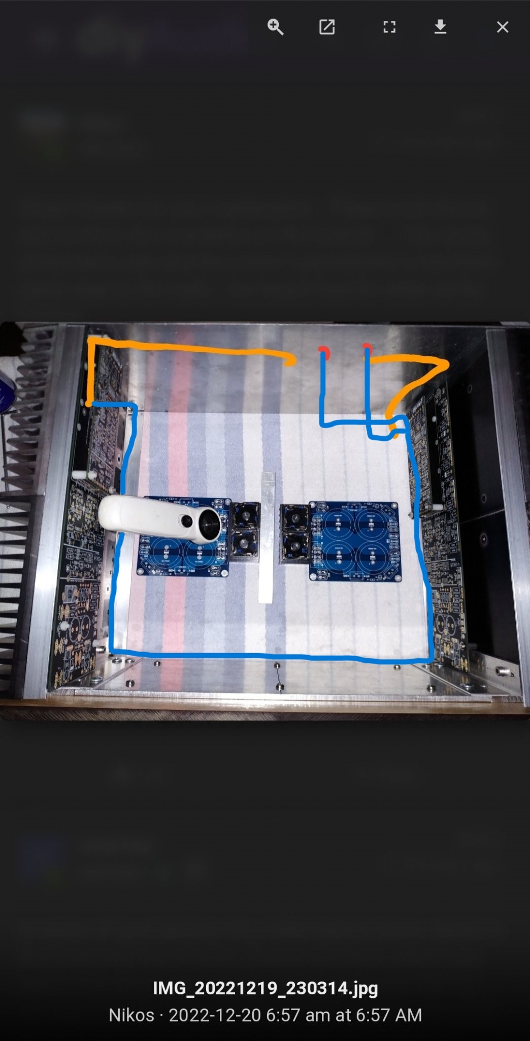

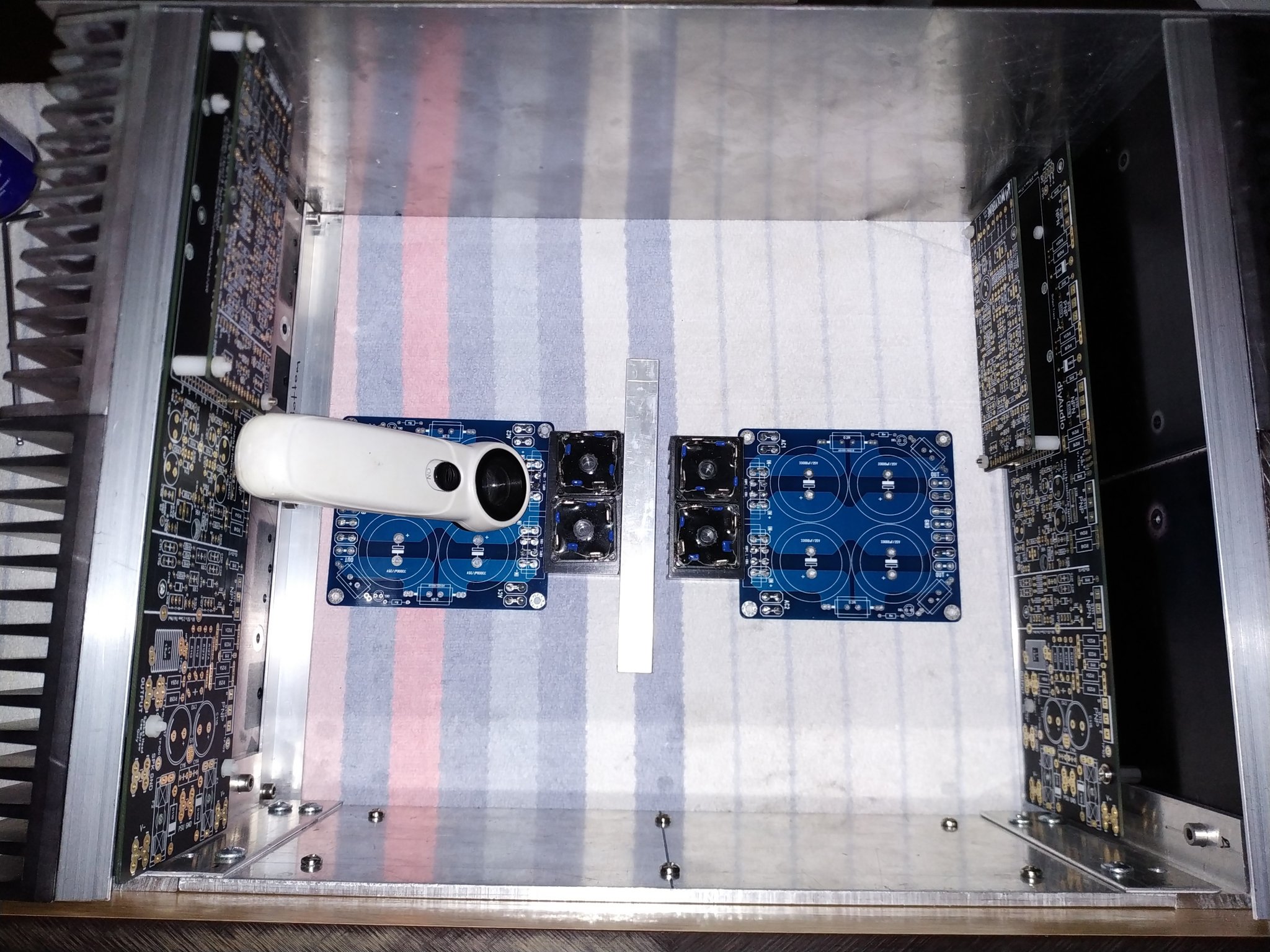

This is (blue lines)how the signal cables must be configured.
Ιn this way the power supply, transformer, rectifier, capacitors are outside the loop of the signal cables.
I would prefer boards placed in opposite way each other so all power transistors near the bottom side of heatshinks
I think you prefer with the placement of the boards so that the output transistors are mounted of the bottom third of the heatsink?
Regardless if one input or output is opposite giving more importance to the same thermal behavior??
Exactly!I think you prefer with the placement of the boards so that the output transistors are mounted of the bottom third of the heatsink?
If you will dril simetrical you can place one heatschink easy in both ways keeping the best.
