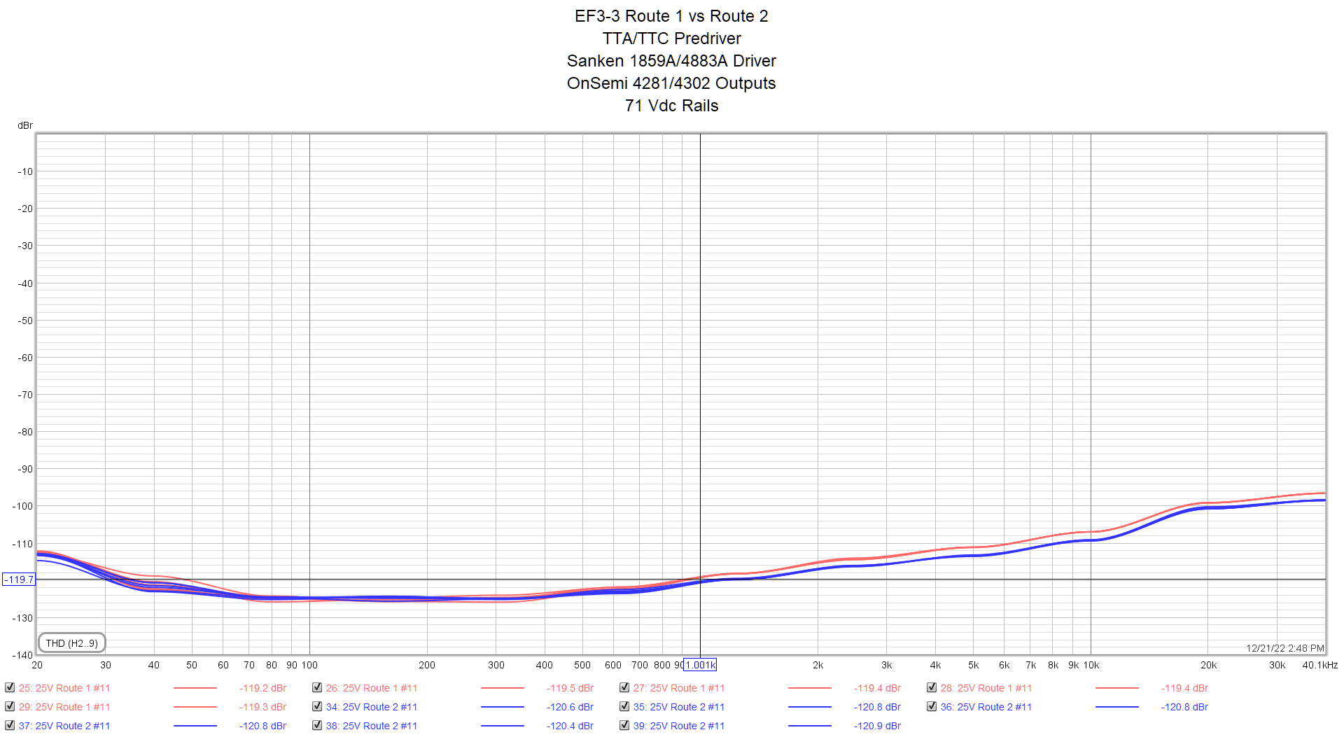

Just an update on further testing I just completed. If you are building Group Buy 2 EF3-3 Boards, Route 2 is the best option. EF3-4 still needs to be tested to confirm.
The debate over TTA/TTC or 2SC/2SA still needs to be measured, I have not had time yet to compare them, but there is a good chance that the differences will be marginal between them, but I would only use the 2SC/2SA if they are E grade, and use whatever is easier to source, which is most likely TTA/TTC.

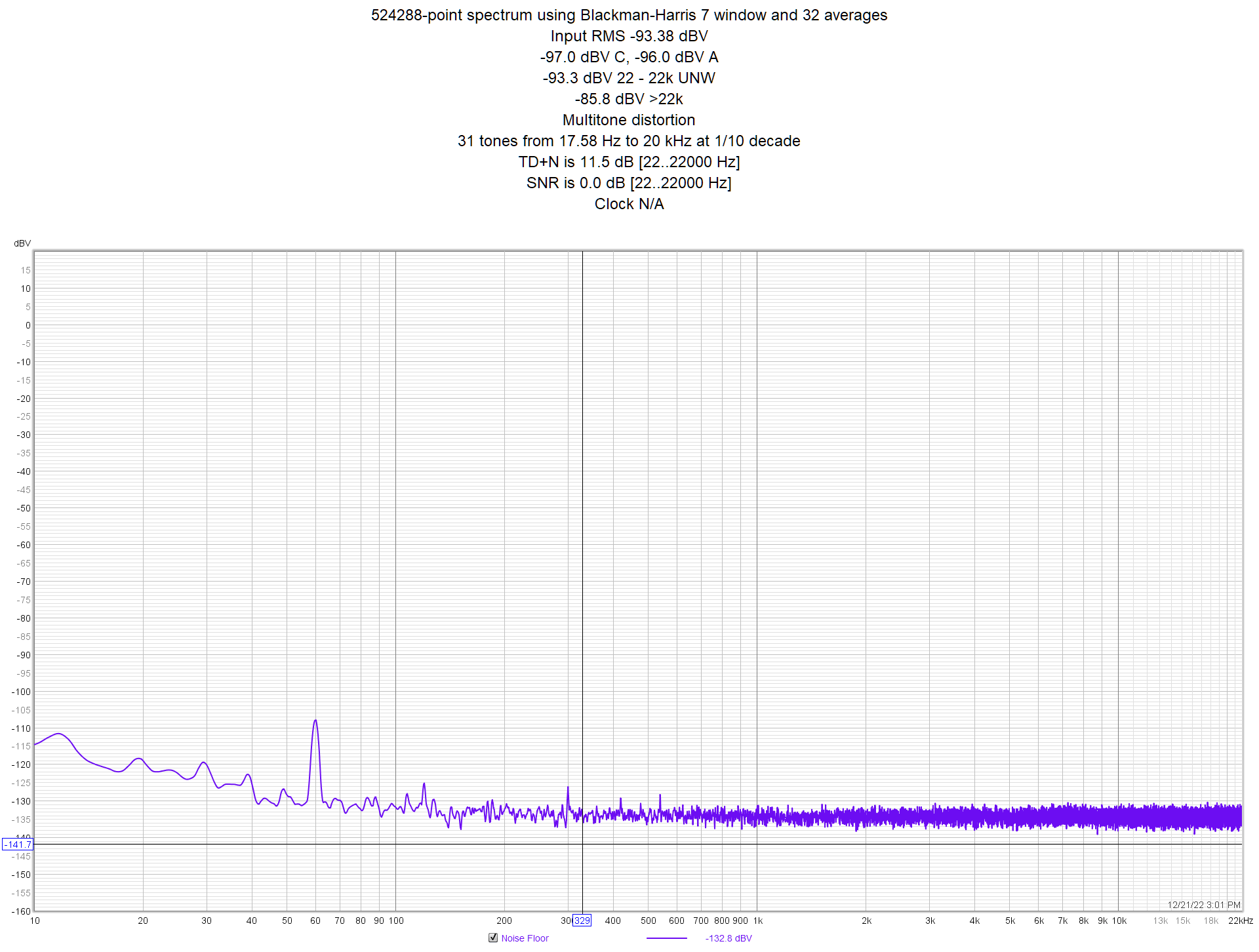

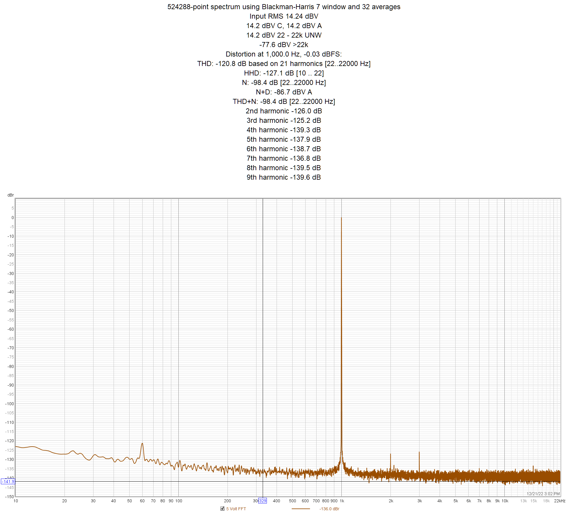

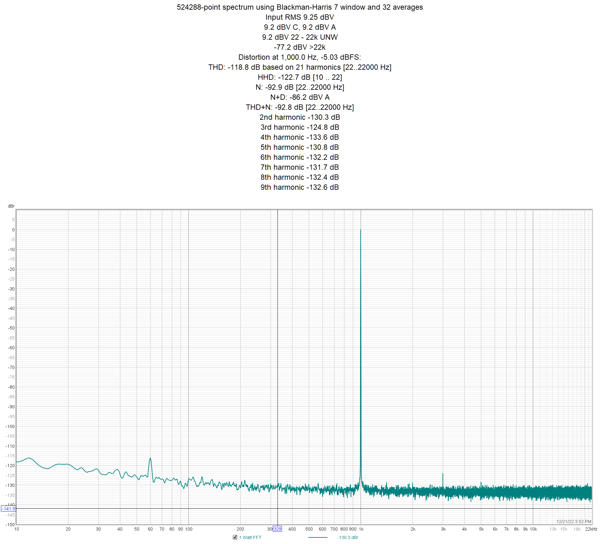

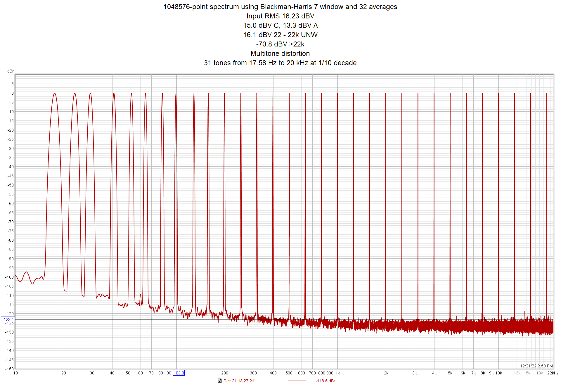

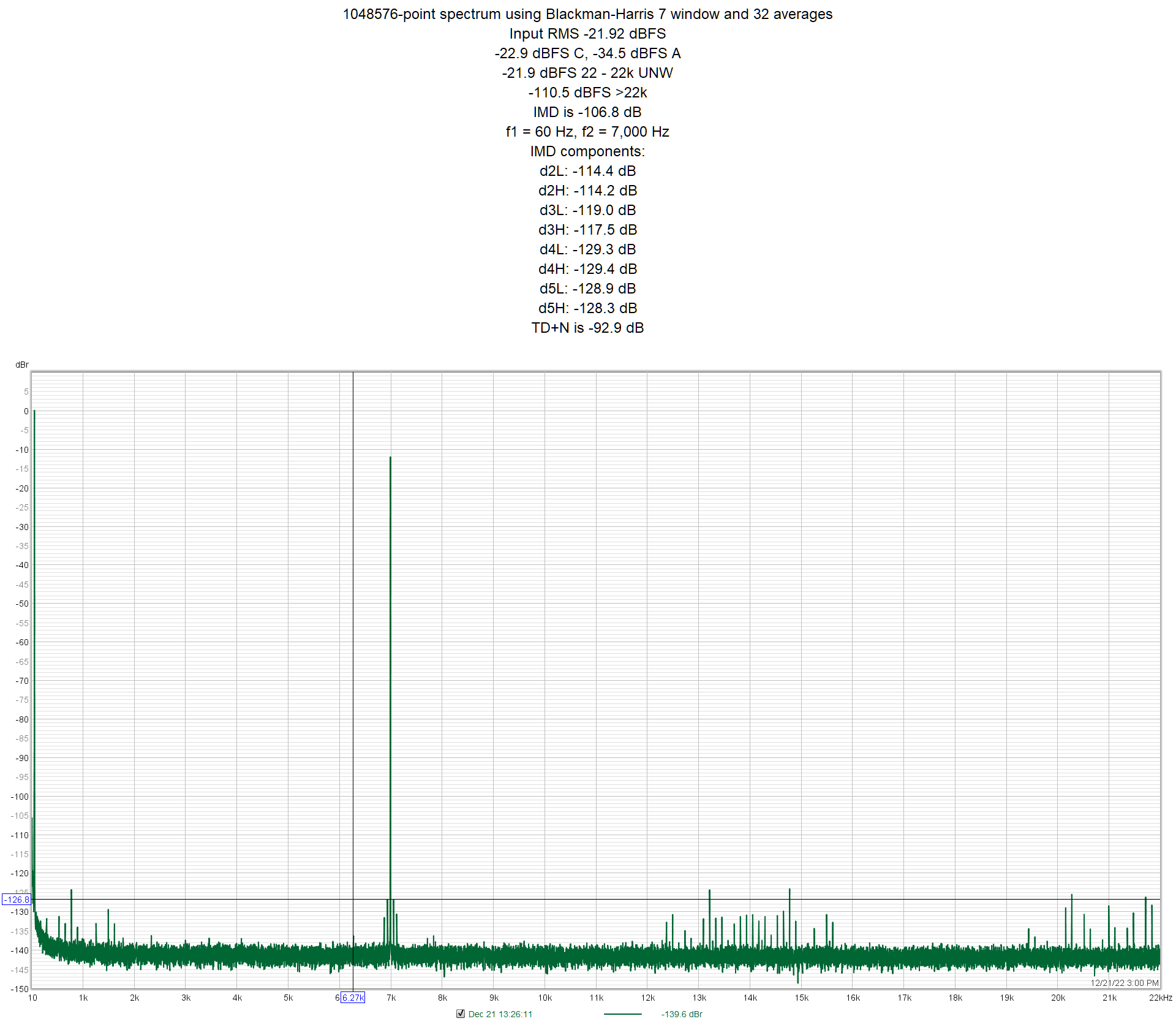

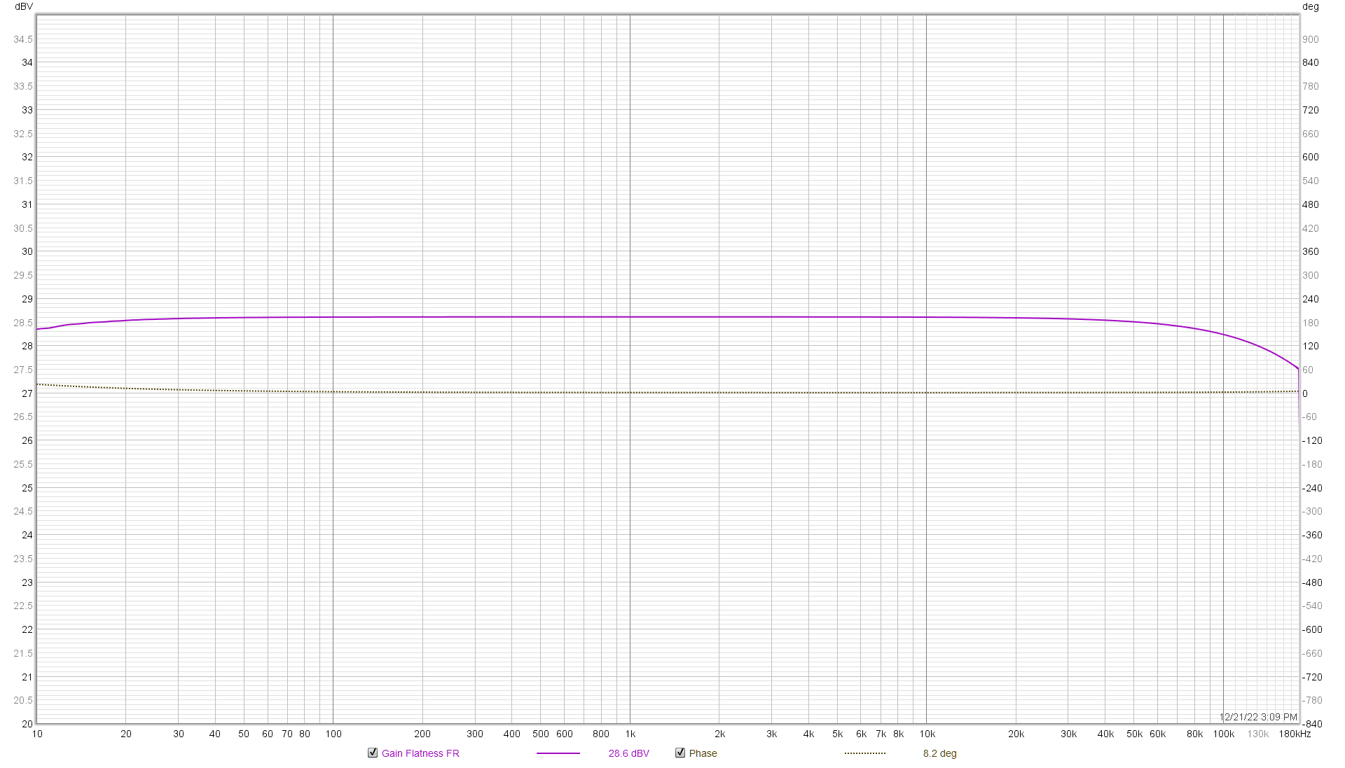

Here are some other measurements. This is an EF3-3 71 volt rails. Good for around 250 watts into 8 ohms @ .1% THD. 😵

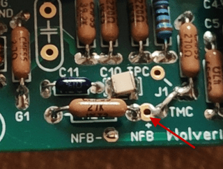

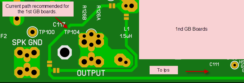

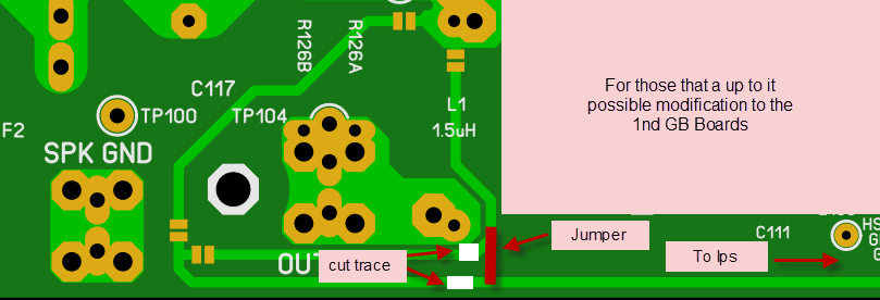

Hi Guy's.

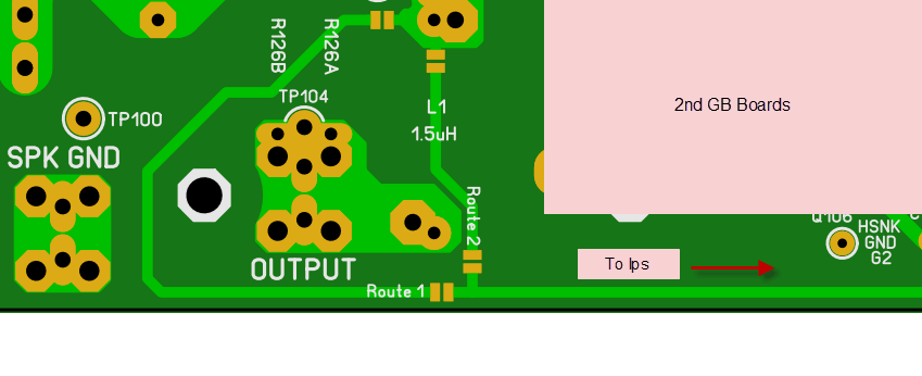

Just to clarify the information around the negative feedback path.
For the first group buy boards V3.9 we had two negative feedback paths to test. They were never named on the silkscreen. But the one that was tested, measured and shown in the build guide to be the lowest distortion is the the same as route 1 on the second group buy boards v4.0.
When we released the second group buy boards V4.0 I modified the other route from the first group buy boards V3.9 to become route 2 this is a completely new path. So please don't get it confused with the other path on the 1st group buy boards V3.9
Andy's new results are for the second group buy boards V4.0 and only for the EF3-3 at this stage. So like he said if your building a EF3-3 please select route 2.
Route 2 was modified so it heads directly towards the input stage and doesn't pass twice in front of the output terminal.
Theoretically you could tweak the first group buy trace if your prepared to cut the traces and use a jumper but its not probably necessary.

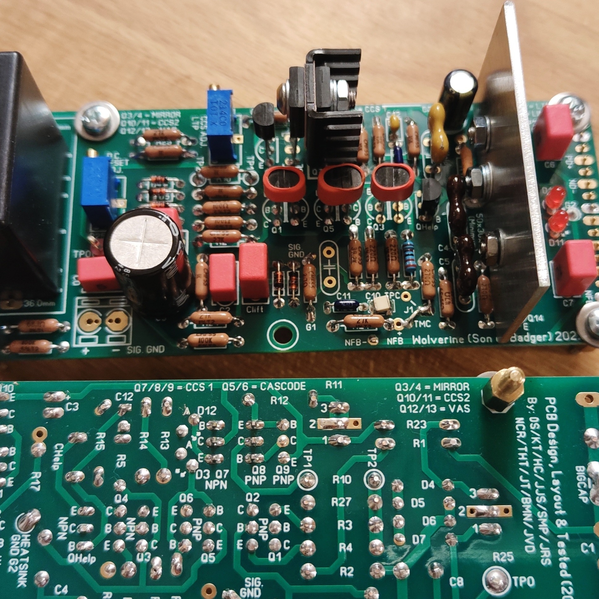

A tip for anyone thinking what enclosure, etc. to get - I went for the HiFi 2000 Dissipante 3/400 enclosure with their Wolverine modded heatsinks and got the inner baseplate as well, intending to run all mains/power beneath this plate for additional screening (every little helps!).
Mounting the pcb's parallel to this heatsink (with O/P trans' legs bent at 90 degrees) as I decided to do, positions the edge of the pcb very low down (or very high up - depending on your orientation!) if using use the pre-drilled & tapped hole locations as provided for both trans' and pcb. I'd also intended to assemble things with one heatsink 'trans up' and the other as 'trans down', if you see what I mean - in order to keep the I/P at the same relative ends to each other.
However, the edge of the pcb ends up so close to the securing 'rail' attached along the edge of the heatsink that there's no way the inner baseplate can be fitted! The only way, therefore, to fit this baseplate will be to position both heatsinks with the pcb towards the top, which will leave the inputs at different ends (not that this is so critical - as discussed here in some depth, the cable routing is more important in order to prevent loops).
Not the end of the world, but not as I'd hoped or intended - unless anyone has any other ideas about this? If intending to use the baseplate not sure if the 4/ enclosure would be better, if the heatsink holes are placed more central height wise (don't know if they are or not)?
Having now mounted everything on the heatsinks and fully tested (all working great by the way, exactly as per build guide - good stuff!), didn't fancy needing to dismantle everything, drill & tap new holes in the heatsinks, with all the hassle, mess and potential problems that would create!

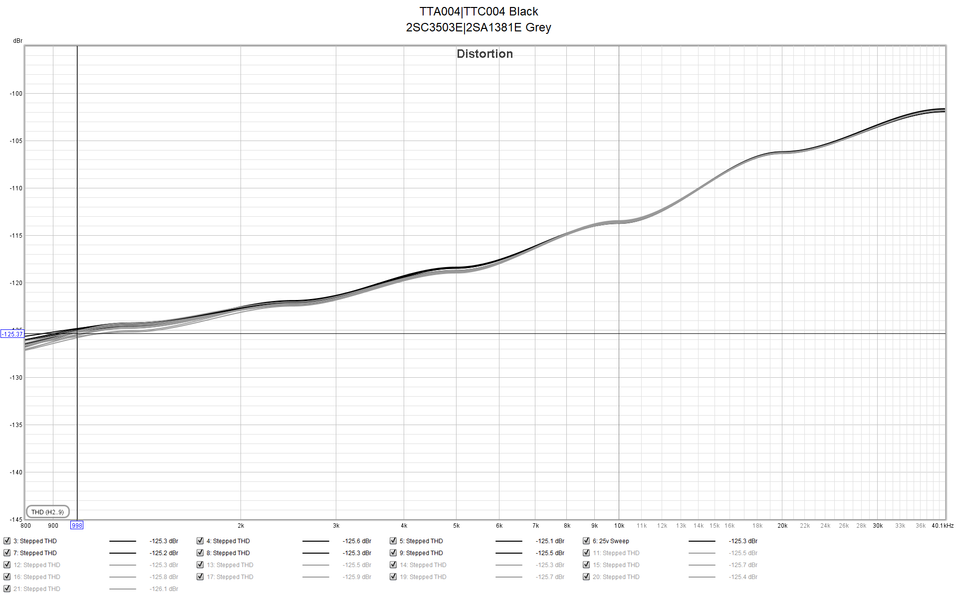

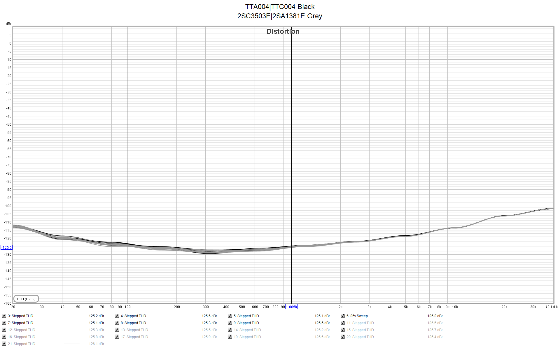

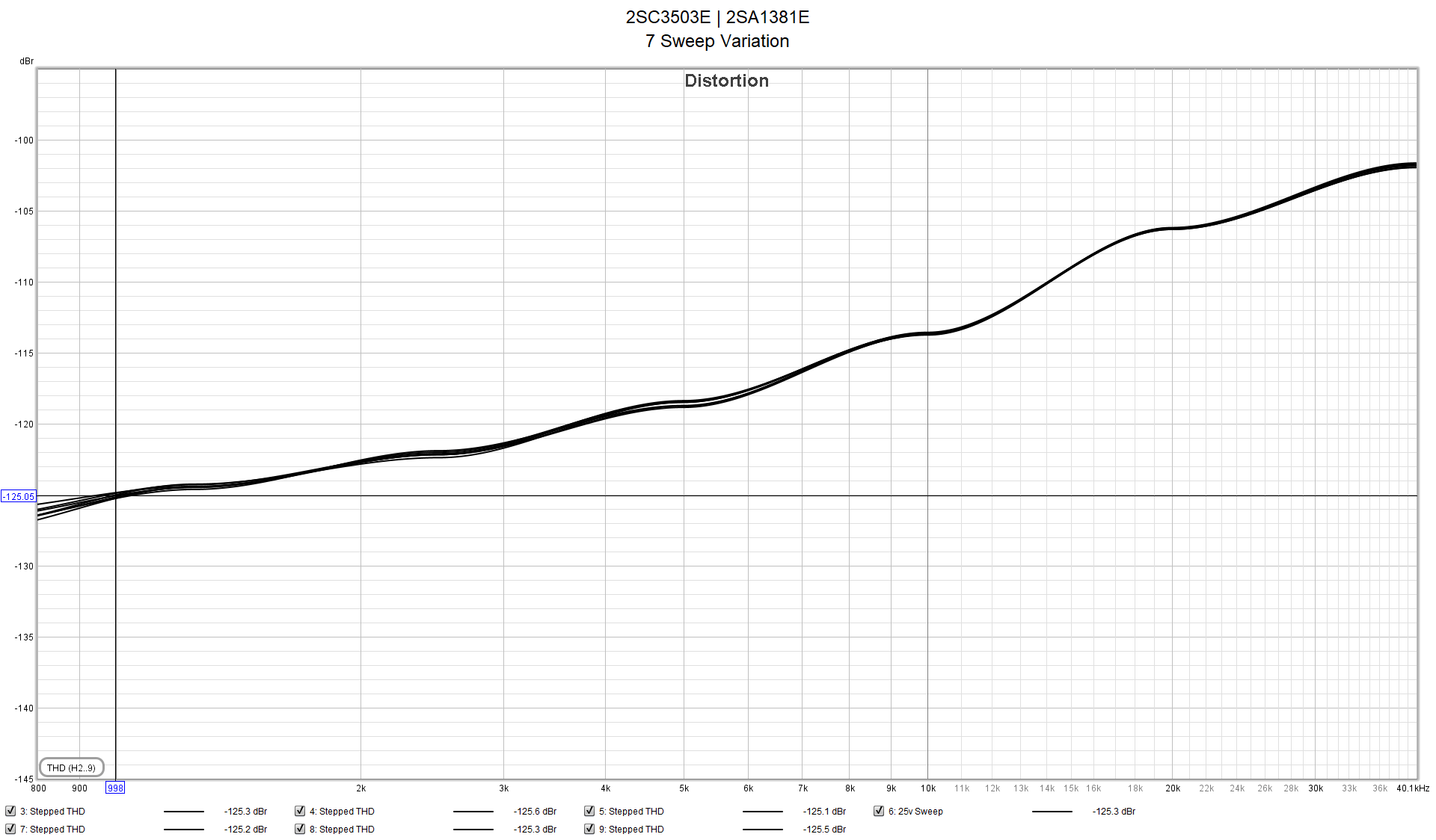

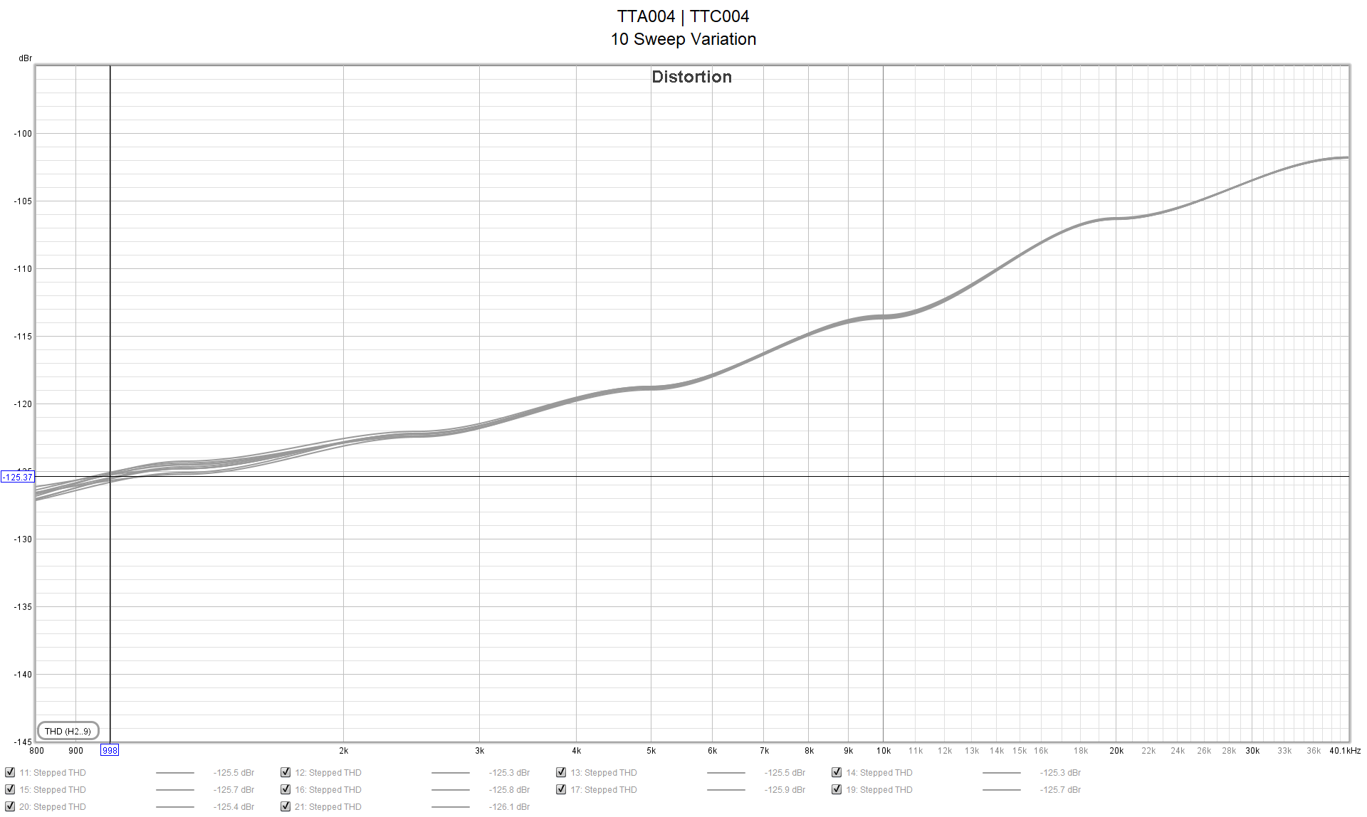

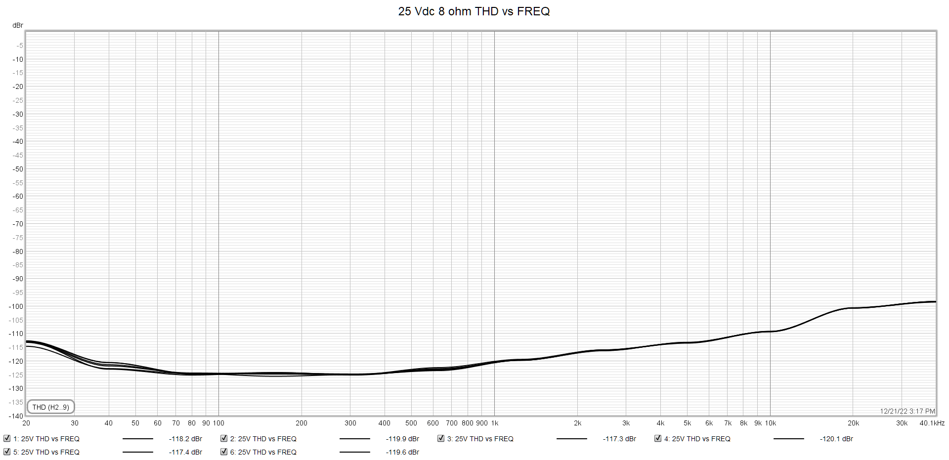

Ok all, results are in on the TTA004 TTC004 vs 2SC3503E 2SA1381E discussion. These measurements were taken from the same EF3-4 board, only swapping the predrivers out. I do multiple sweeps at 25 volts into 8 ohms every 5 minutes to check for temperature deviation on the distortion results. 2sc2sa_vari.pngTtaTtc_vari.png
In my opinion use whichever you have on hand, or easier to source as there is only a very minor difference between them. The Sanyos seem to hold tighter during time, and the toshibas measure a touch better at 1k, but to be honest @ -125 db there are both AWESOME 😀, actually its just the whole amp that is!!
Cheers and Merry Christmas !!!
