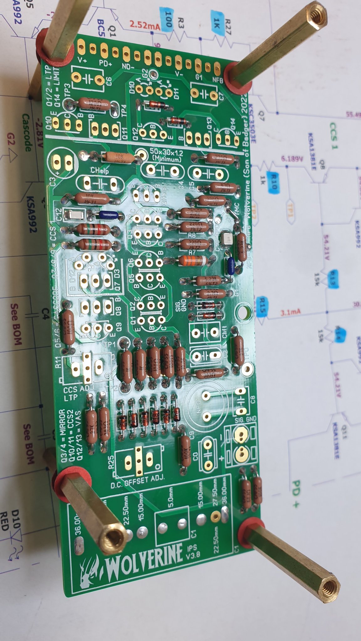

Hi Guy's
I'm just starting my EF3-4 build.

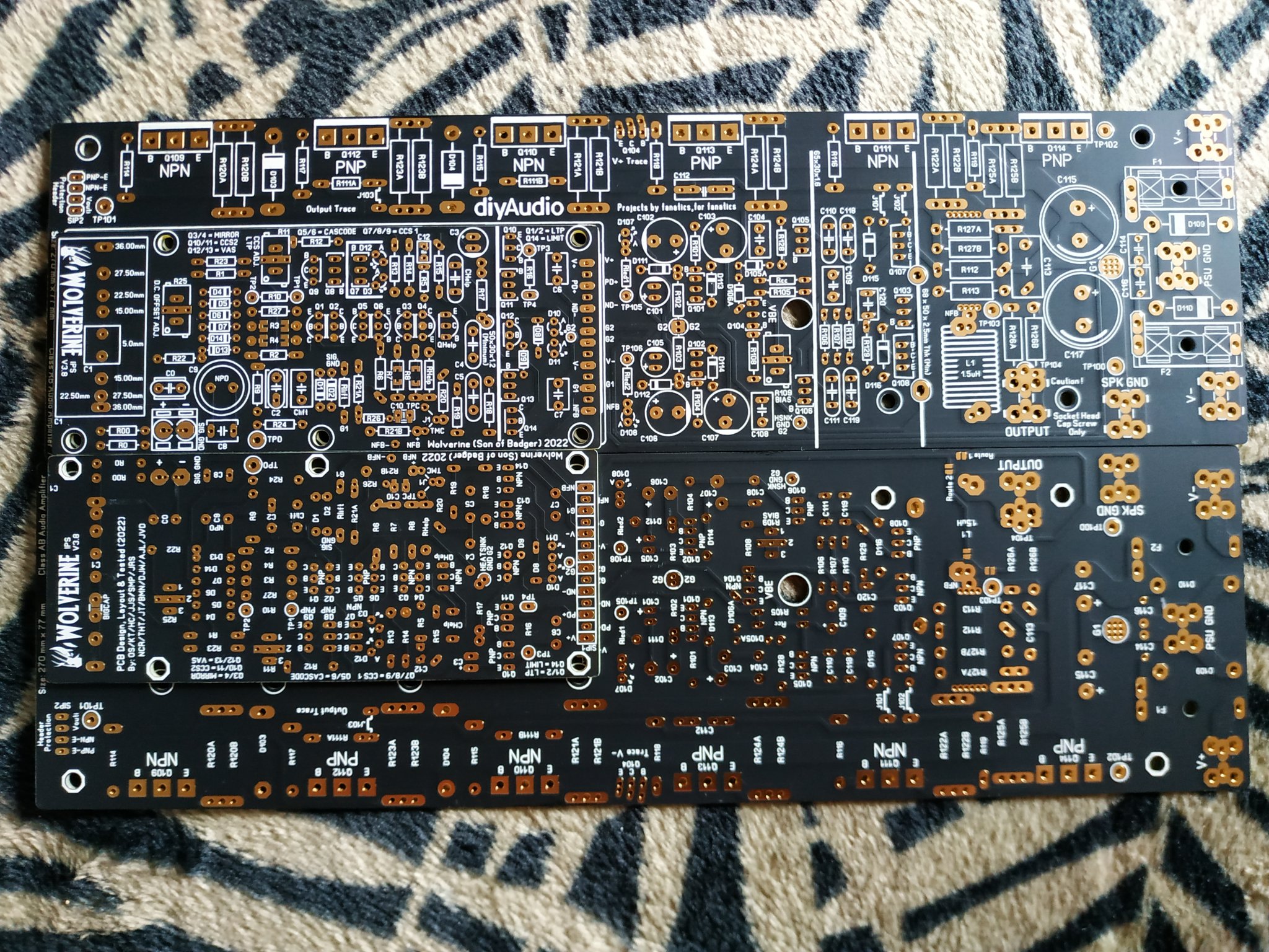

Here are some progress shots.
I've created a build album if anyone wants to follow my progress.
Wolverine Build Album

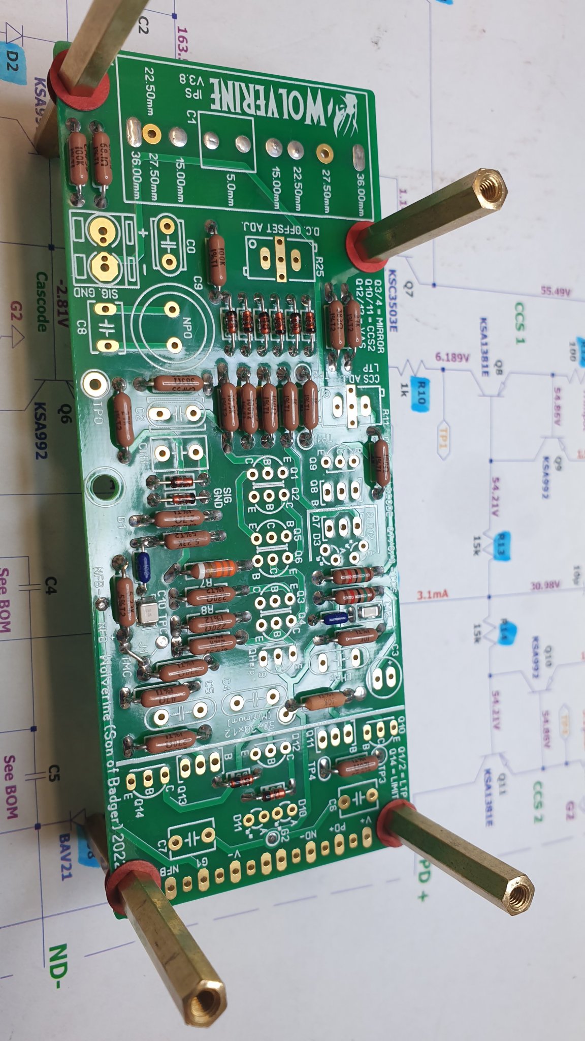

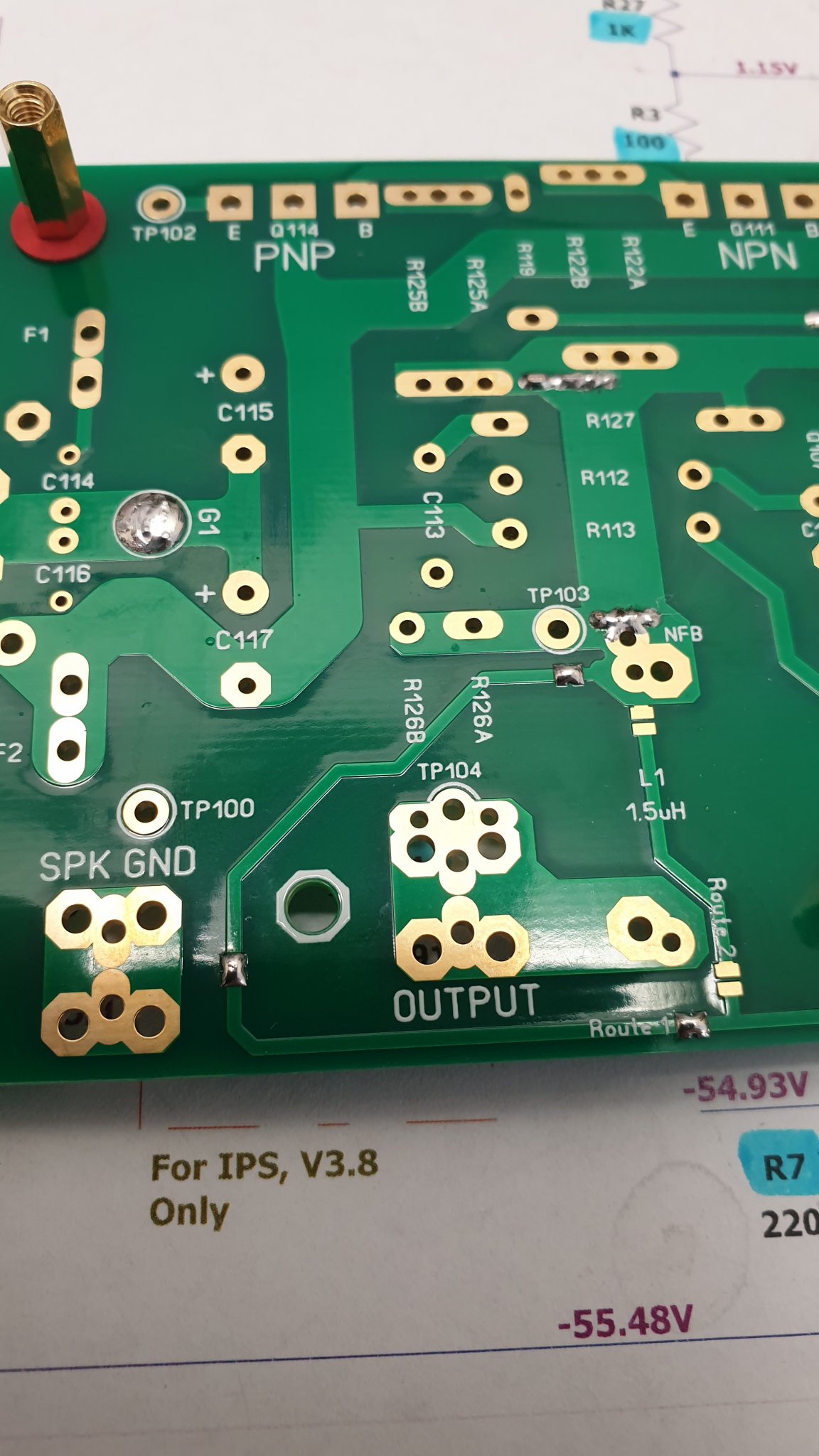

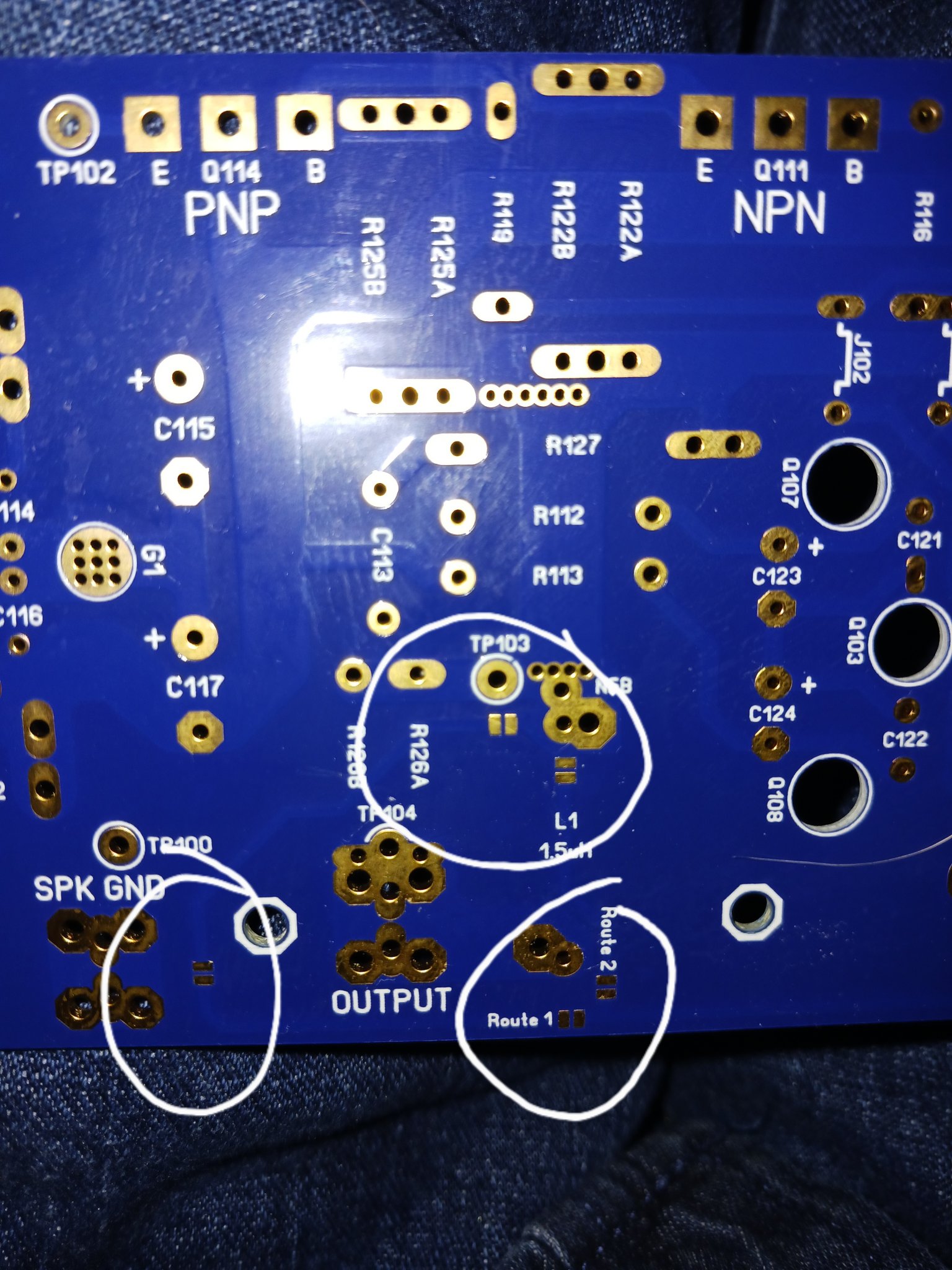

Questions before I start populating. These solder bridges need to be done? Why are they here?
Yes, they need to be soldered as per the notes in the build guide.
Please choose Route 1 and solder the bridges as shown in the build guide and in my attached image.
Do not solder both route 1 & 2.
Only solder route 1.
They connect the negative feedback path to the input stage and are vitally important!
We plan to test route 2 at some stage to see if it produces lower distortion. Route 2 is slightly different to the one we tried in the first group buy.
The solder bridges gives us options.

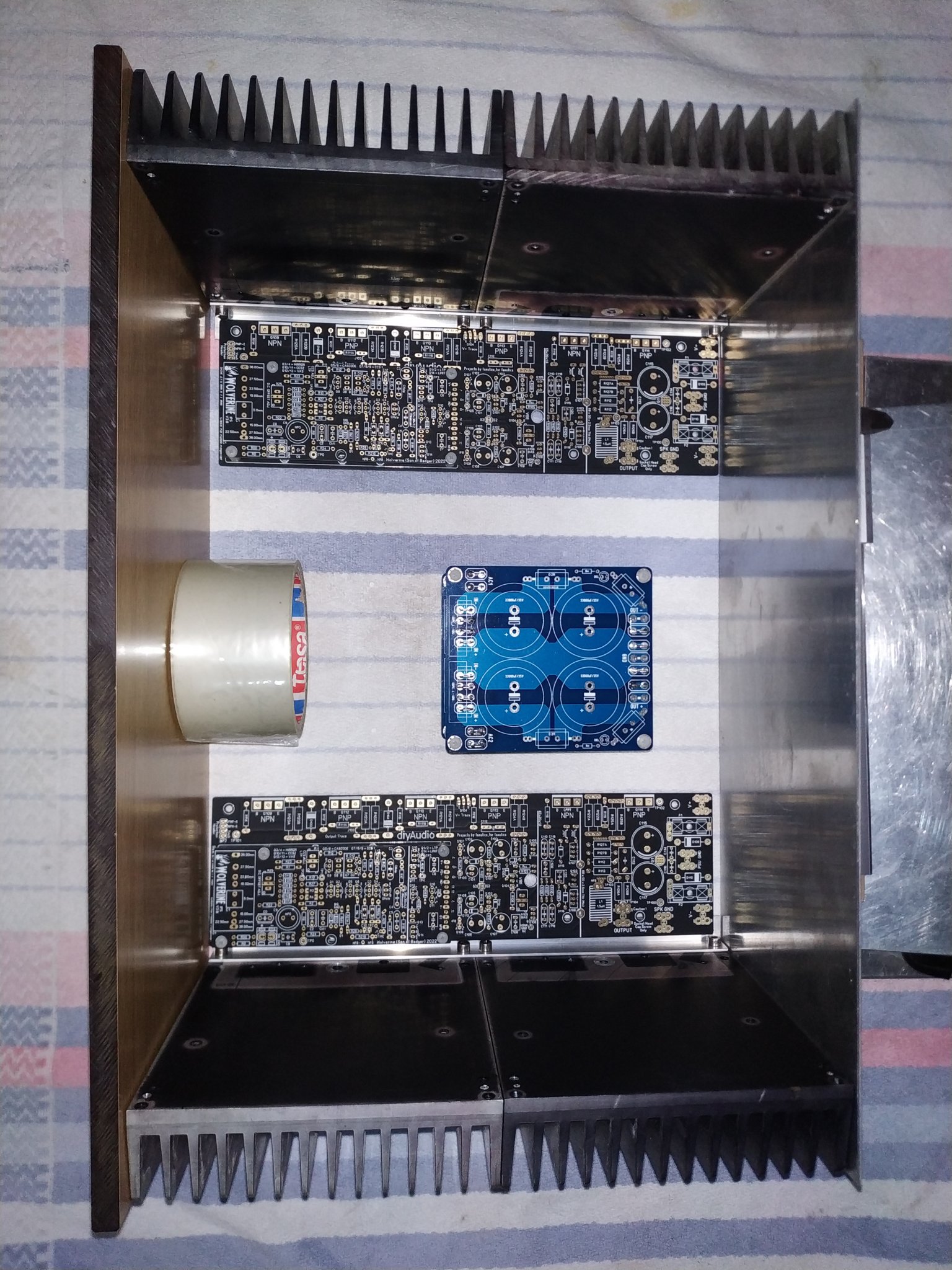

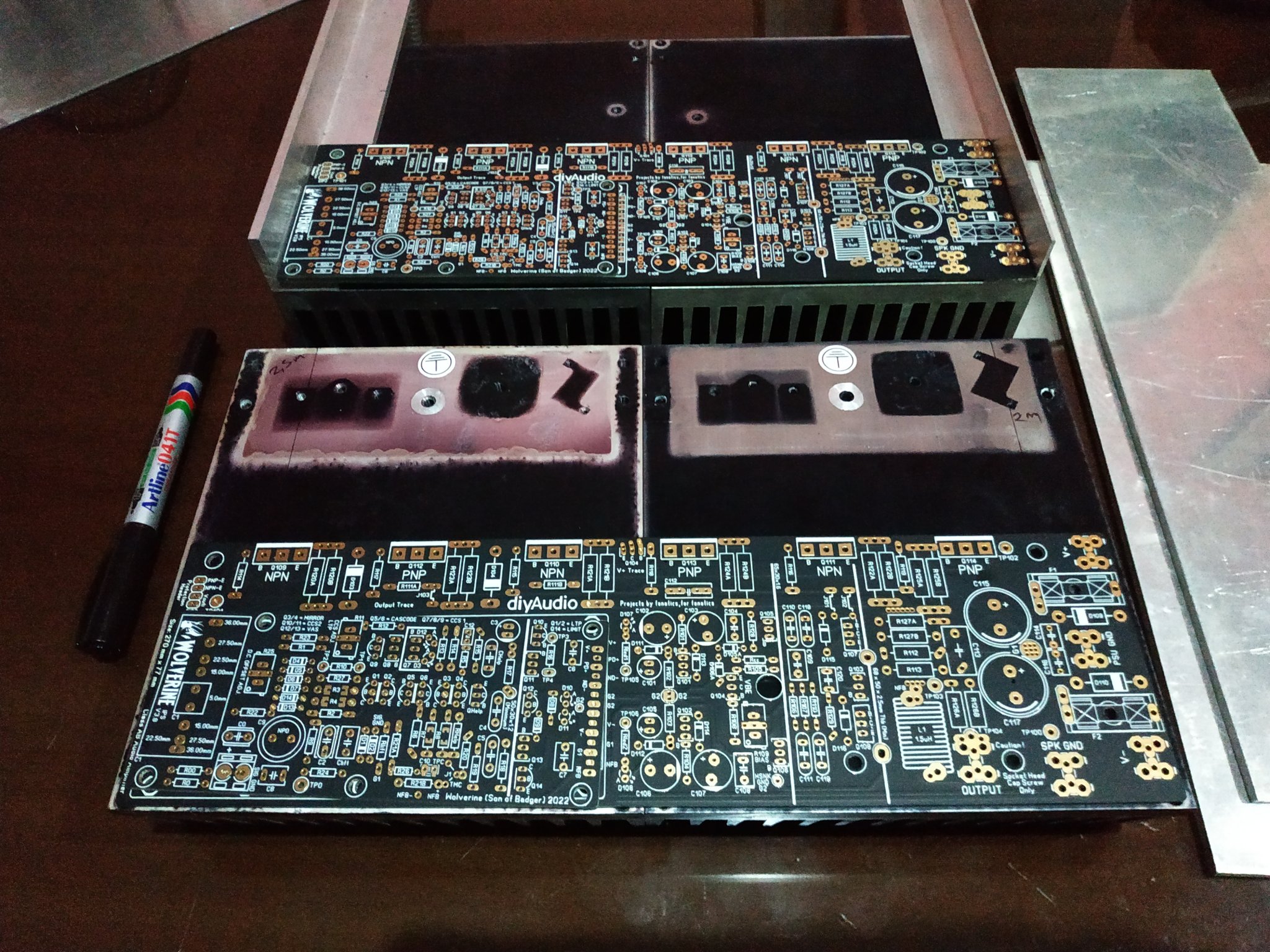

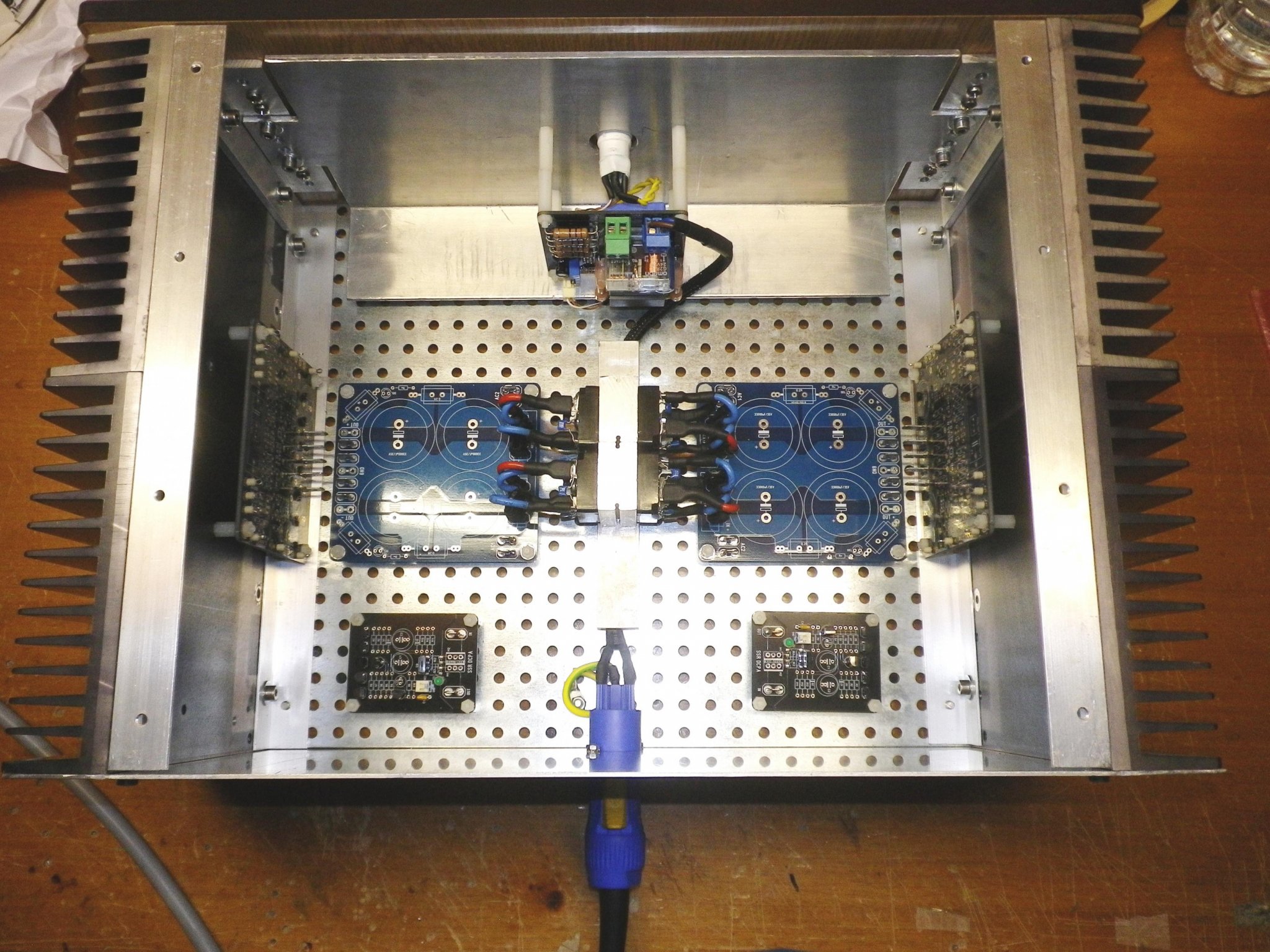

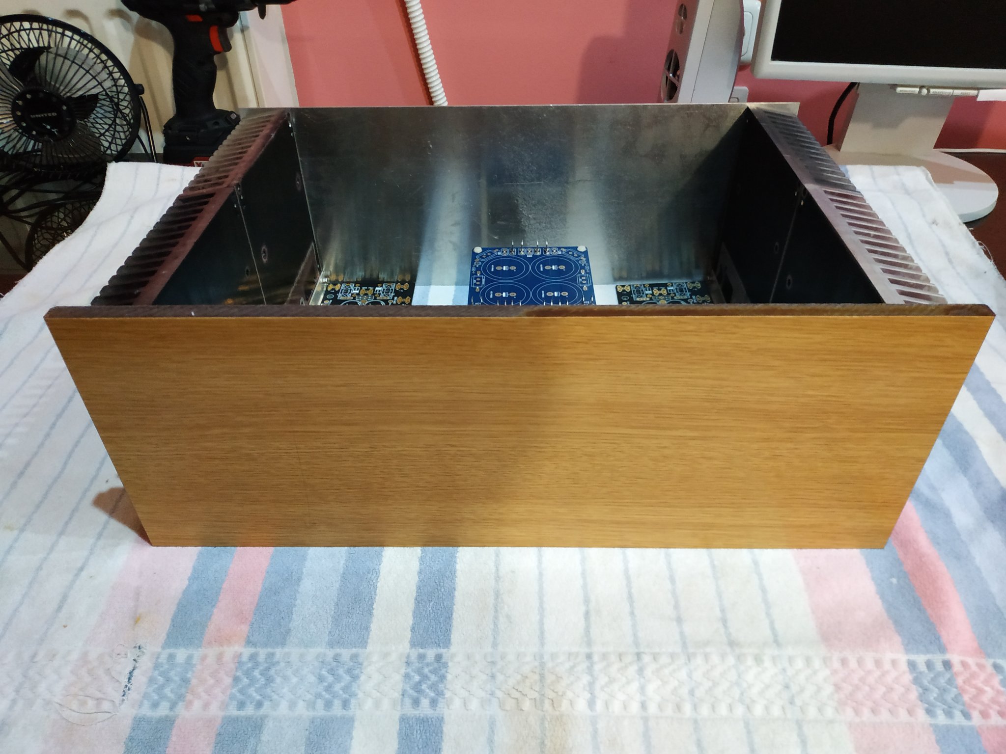

I got a job....I'll start with the construction of the box. it will be exactly the same box as in USSA 5. The boards will be placed one high and the other low so that their output is on the back side of the box. The output transistors are thus placed in this way approximately at the same height of the heatsink.the dimensions of the box will be 41cm width 27.5cm depth. and 16cm height..

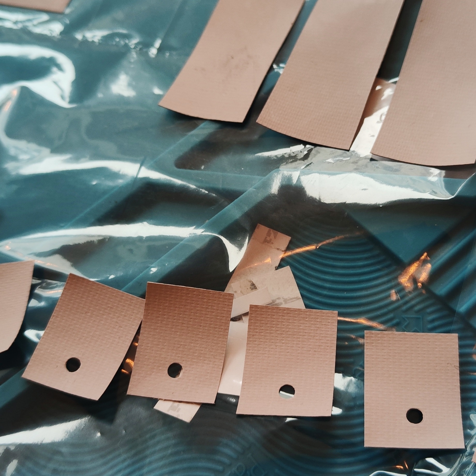

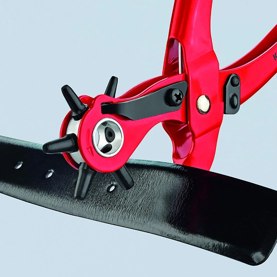

A nice thing to do on a dark winter day: cutting keratherm insulators. I realised that Keratherm is locally distributed through Conrad Elektronik in Germany. I got myself a sheet of 86/82, 190mm X 190mm in 0,25mm thickness.
The pads sold in the diyaudio store are quite big to fit for TO 247 case, but as I will use TO3-P devices I choose to cut pieces of 21mm x 27mm. That adds up to 7x9 = 63 insulators (and no waste) from my sheet. should be enough for the next few projects..
How did you cut those nice clean circular holes ?

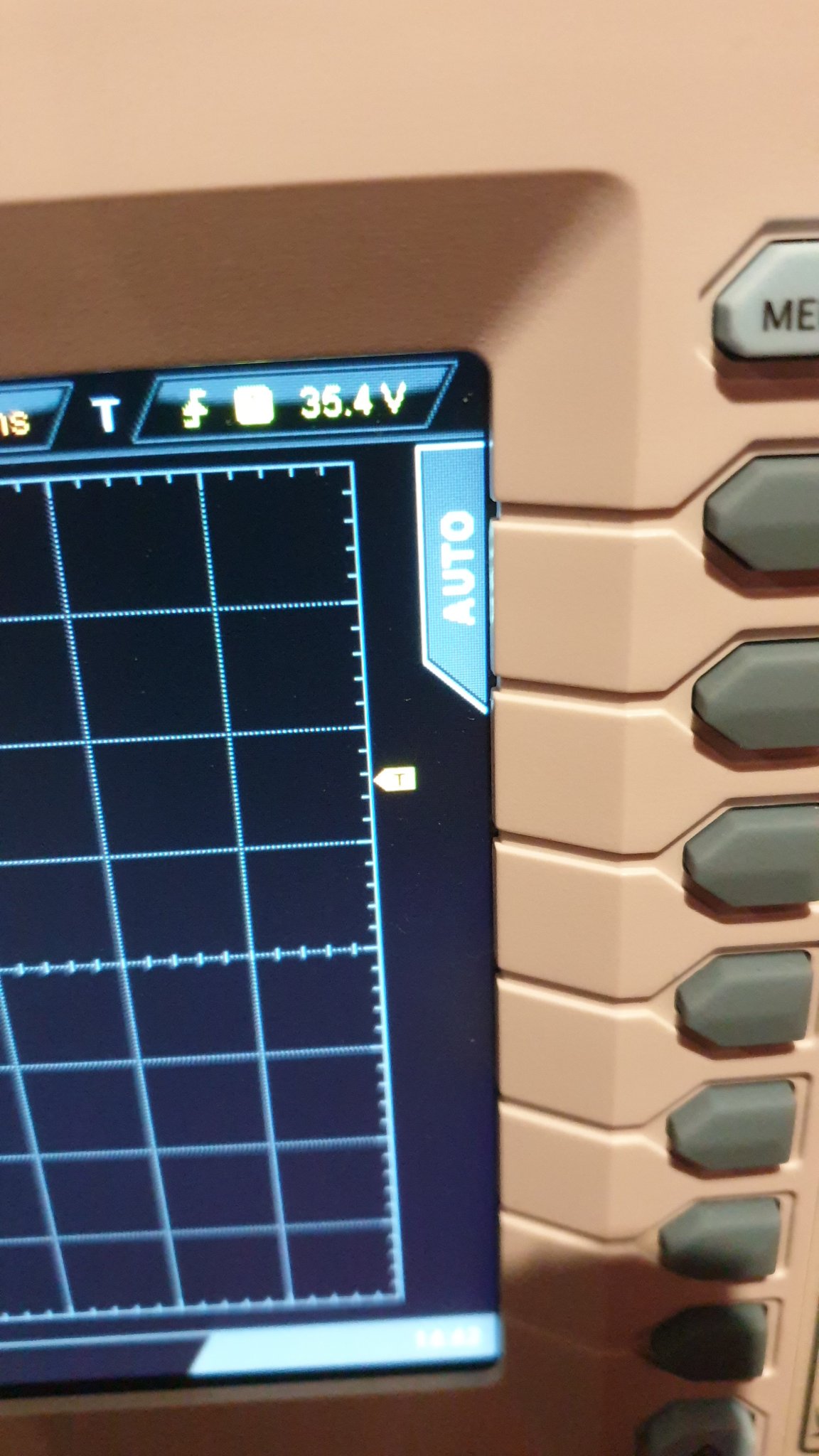

When aiming for high quality reproduction of real music (low distortion), realize that the dynamic range of real music is much higher then that of a constant repeating wave. I like headroom.
That's true and I appreciate your comment. Yes its something that can be quite surprising when you take a measurement.
I thought that it maybe worth checking and sharing my results.
At a listen level of 85db peeks at my seating position my peek voltage measured with my scope was about 6v
At a listen level of 95db peeks at my seating position my peek voltage measured with my scope was about 12v
At a listen level of 105db peeks at my seating position my peek voltage measured with my scope was 35.4v
105dB peeks is very loud I didn't want to listen to that for to long.
Even if you add the 8v losses and then do the maths you end up at 117w so if I have 150w I think that I'll be ok.
