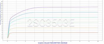

Hi Guys,
Does anyone have any preference or thoughts about whether best to use TTA004BQ's & TTC004BQ's, or to use SA1381E's and SC3503E's for my build (~50v dc rails, 8 ohm speakers)?
My original Mouser order some time ago for the TTC's were out of stock at the time (I did get the TTA's), so as an alternative I obtained the SA's and SC's from @fireanimal (many thanks @fireanimal!). Mouser have now advised that stocks have replenished and that my outstanding order has been shipped at last, so I'll now end up with a full compliment of the TTA's & TTC's as well!
I'm guessing (it's only a guess) that the 'E's' should be better quality that the 'TT's' and so I should use the 'E's', but is there any opinion about this from you guys more experienced than me?
PCB's are stuck at a PO sorting hub here in UK, general feeling is it might take some time (weeks?!) for them to move on from there ....
Any advice or guidance welcomed!

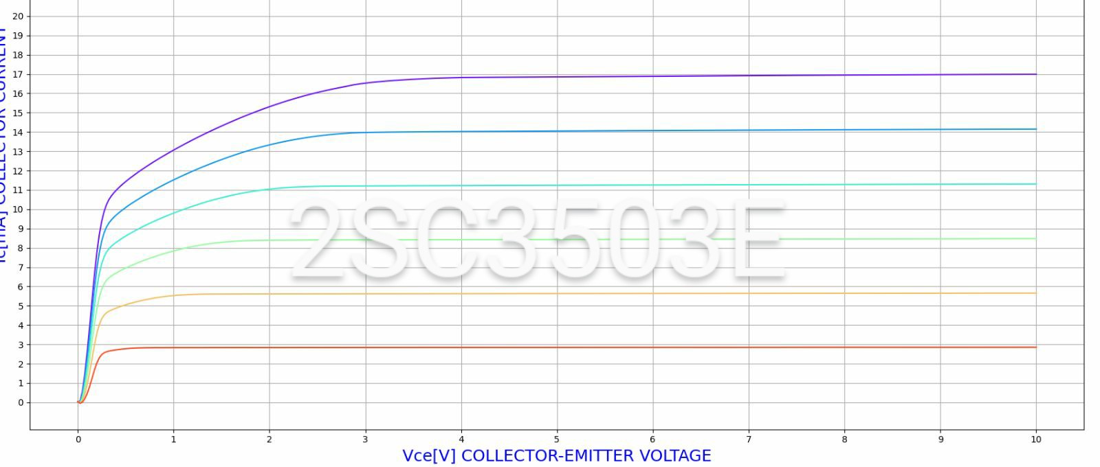

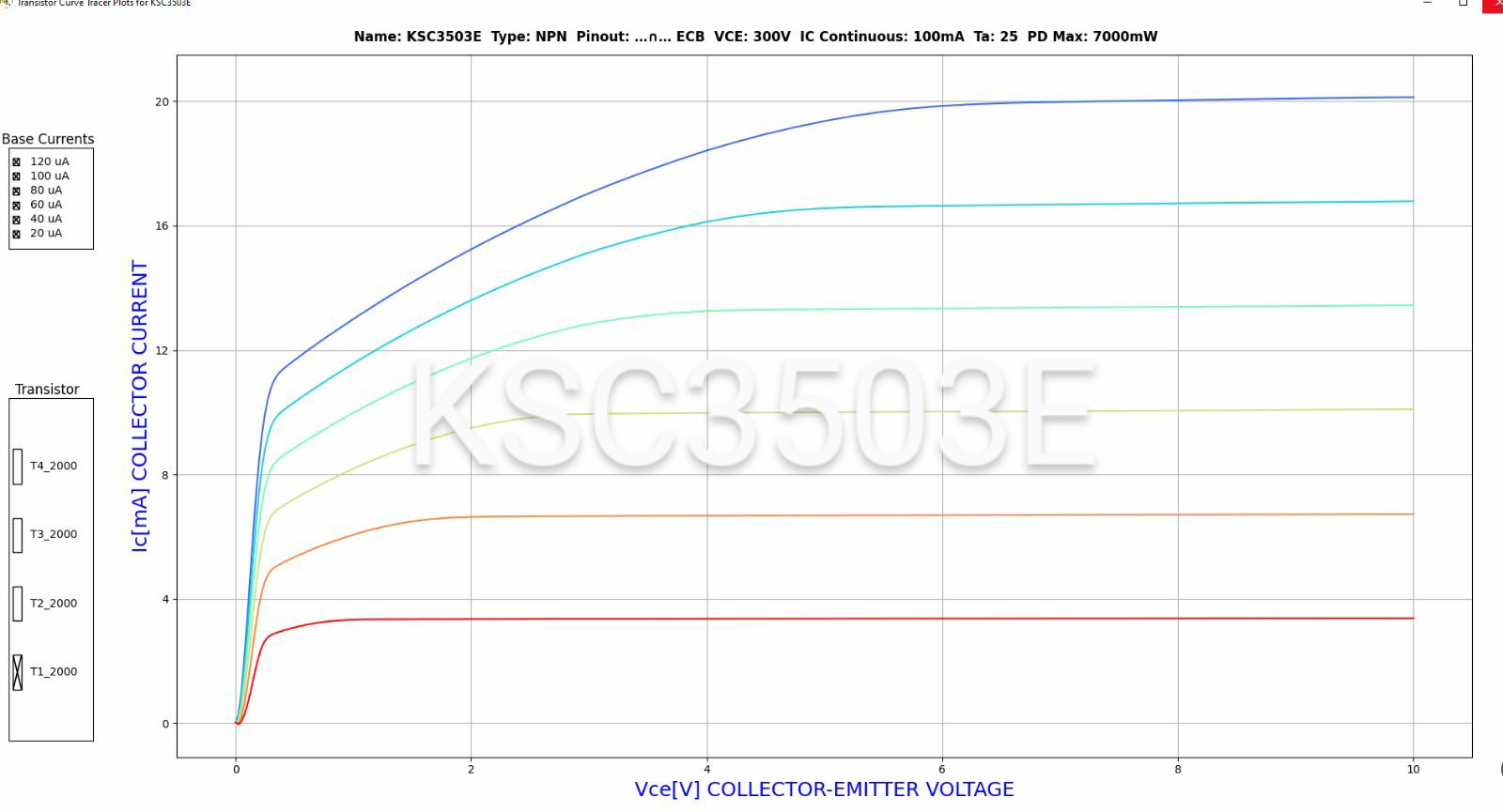

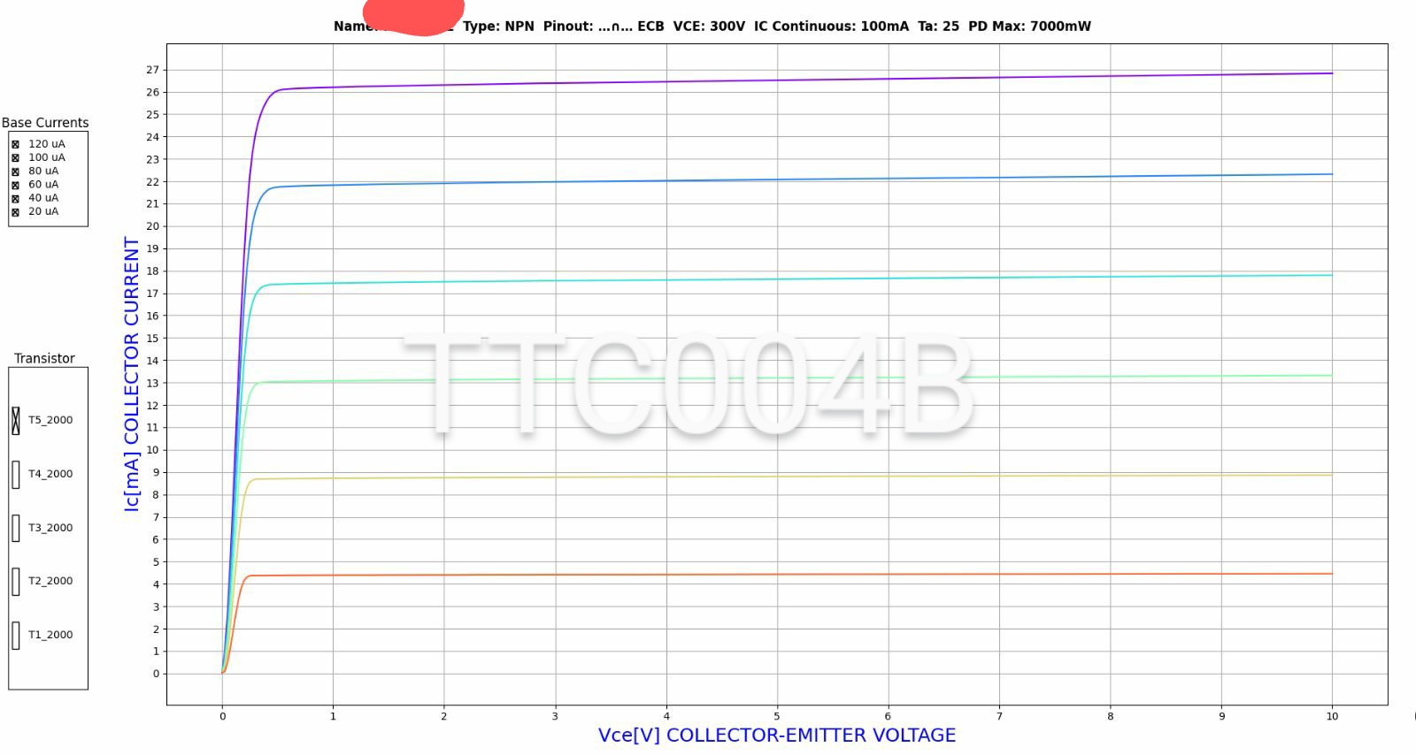

We are in the process of testing the TT transistors as the results from the curve tracer plots that I did recently revealed that the TT transistors have basically no quasi saturation region compared to the KSA, KSC, 2SA, 2SC options.Hi Guys,
The TT transistors have a VCE voltage limit of 160v so they are ok for up to 65v rails as per the latest BOM. I'll update you all one we know the results.
So if you can hold off a week or two we should know the results.
An amazing find Stuart, those curves are remarkable. Reminds me of lecture ideals vs crappy lab results in electronics 101...
Thanks Stuart,
Hmmm ..., very interesting! I'm presuming you meant quasi saturation region? Does this suggest that the TTC's might indeed be the better choice here (at lower voltages?), but I'll hang fire for a while until you conclude your checks - as I mentioned, it may well be a few weeks before I get my pcb's anyway.
Indeed. Typo.. should have been saturation. I've asked the admin team to fix it 🙂
We will be testing a bunch of things to see which is the preferred transistor.
