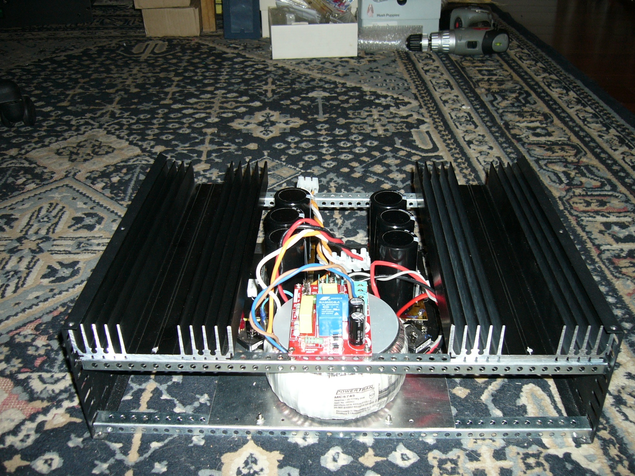

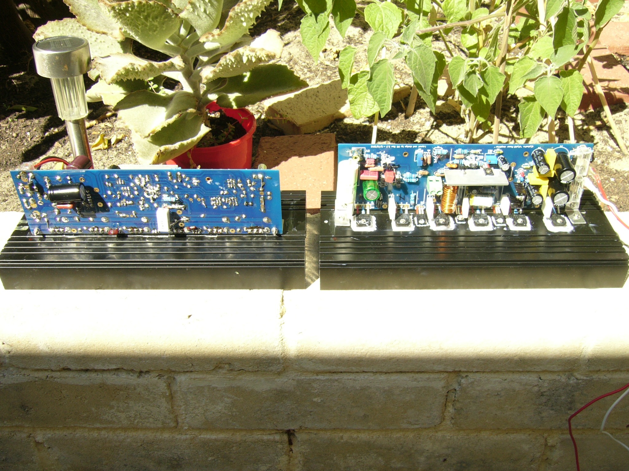

Hi Janusz,If this kind of a heatsink as shown on attached pictures is OK then it is available from temteccontrols seller on Australian EBay.
Lengths available up to 400mm. Plain aluminium not anodized.
The heatsink shown is available in 400 mm length(s) but the fins go in the wrong direction.
You would need to bolt together a few sections with the fins running vertically unless you want to have the fins running horizontally, which does work but is not as efficient for convection cooling.
I have gone a similar route before and it is doable but realistically you pay more than getting the appropriate heatsink and the labour time is high.
Also they are not anodised.
I hope this makes sense.
- Daniel

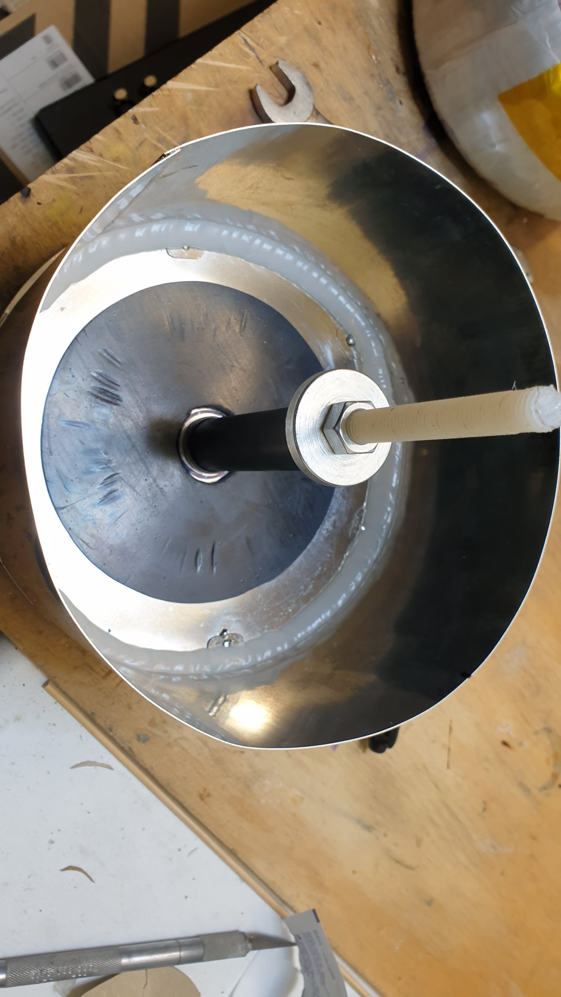

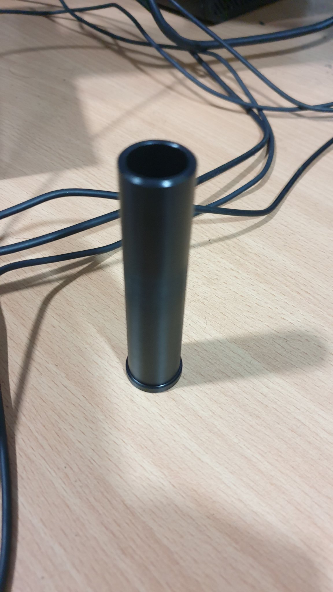

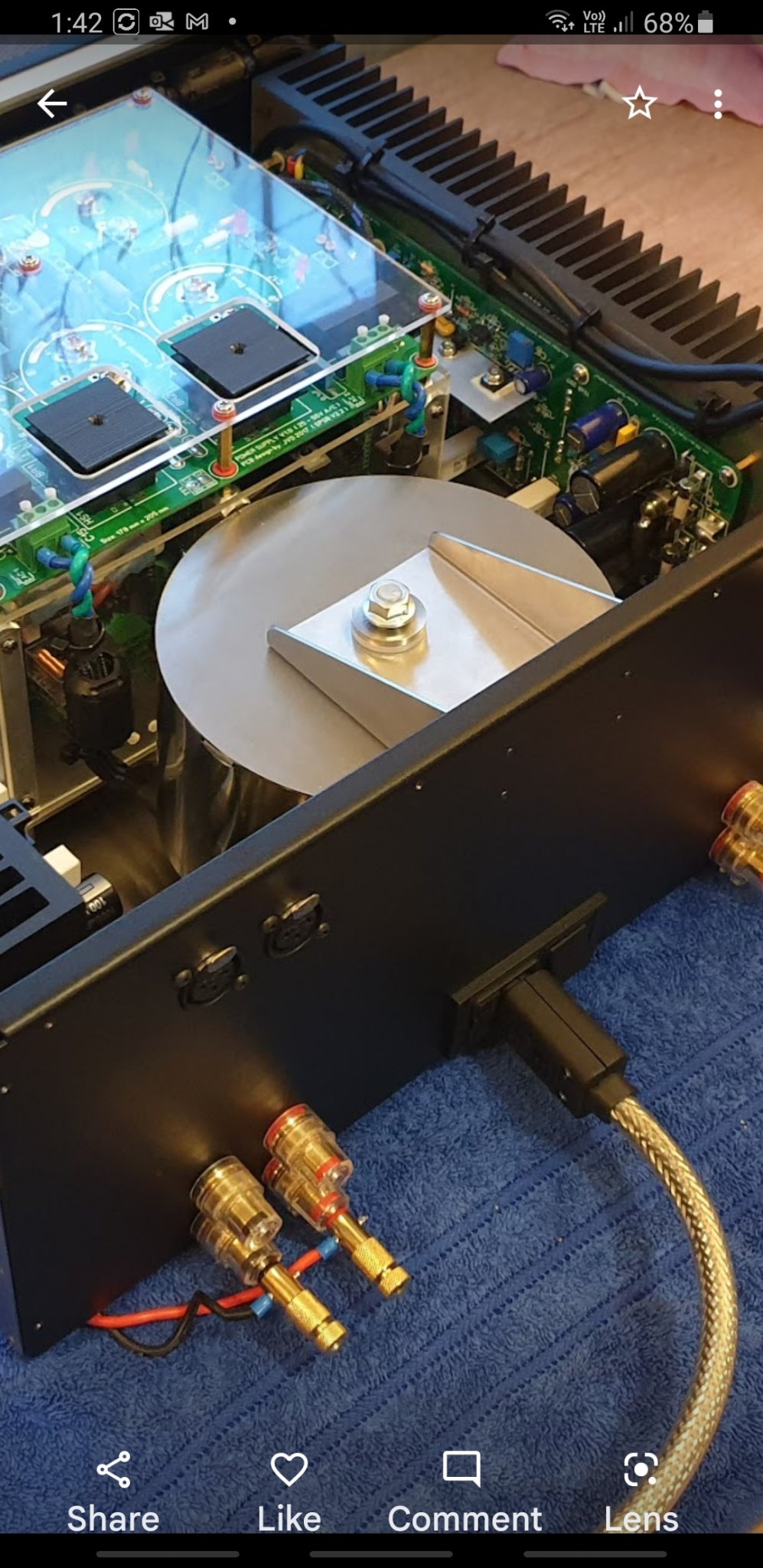

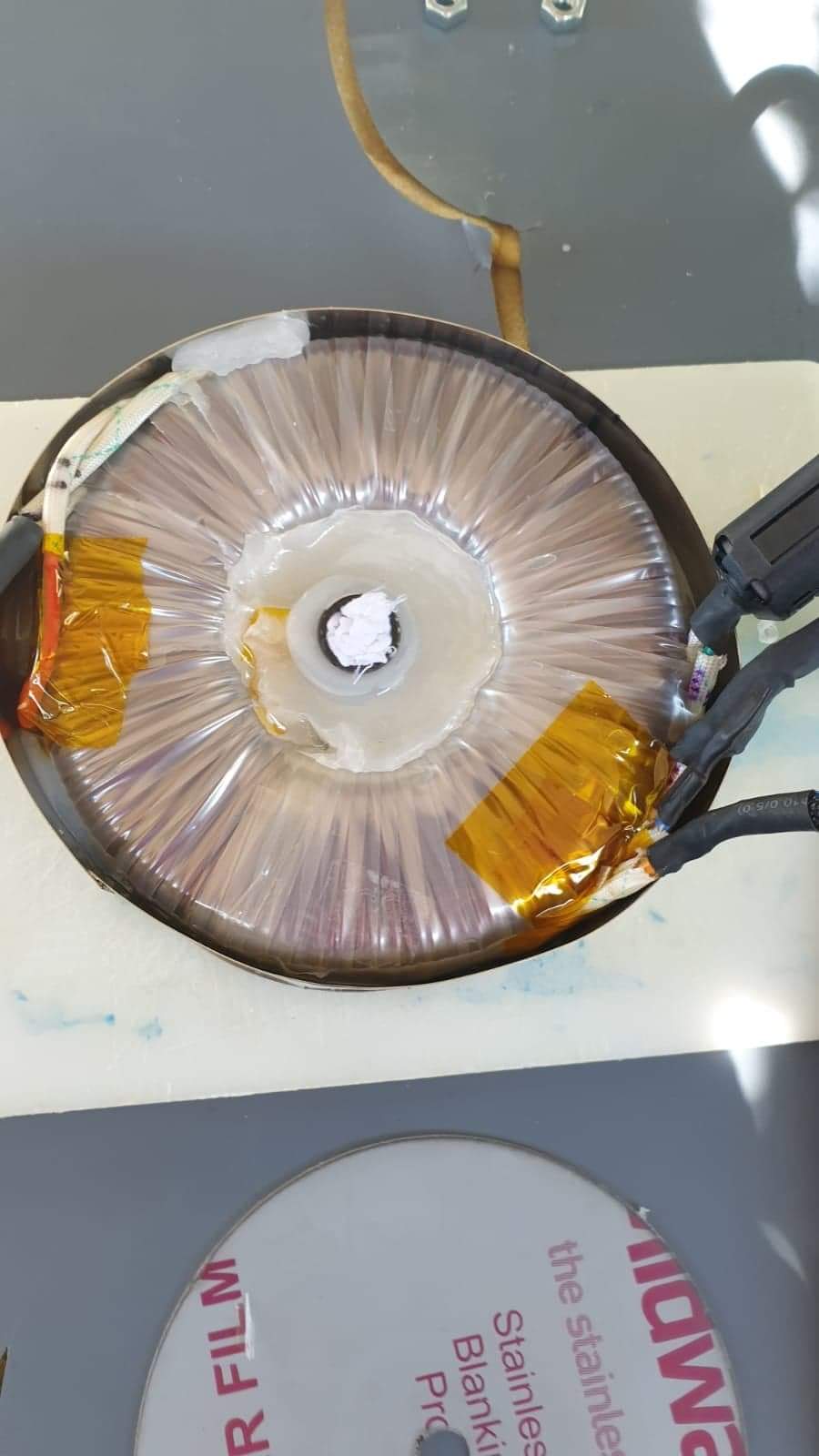

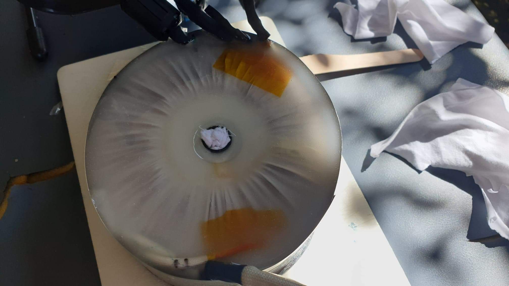

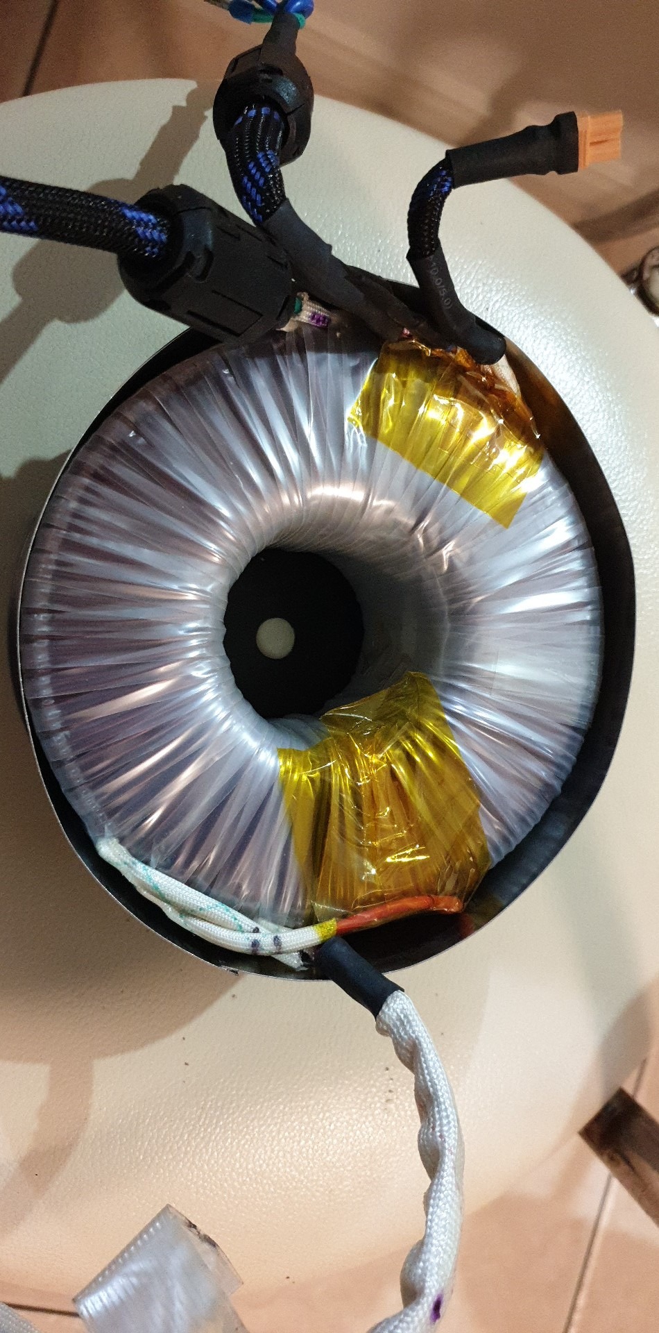

This may be a another imaginary dragon 🙂 but wondering if it is necessary/advisable to pot the torroid power transformer. Assuming good lead dressing and appropriate use of shielded cable, has anyone had hum trouble from an uncovered transformer?
I had a AnTek transformer that I used on my Honey Badger build. The transformer was quite but not dead quite. Potting it killed any noise completely. Definitely worth doing if you have a quite listening room.Guys-

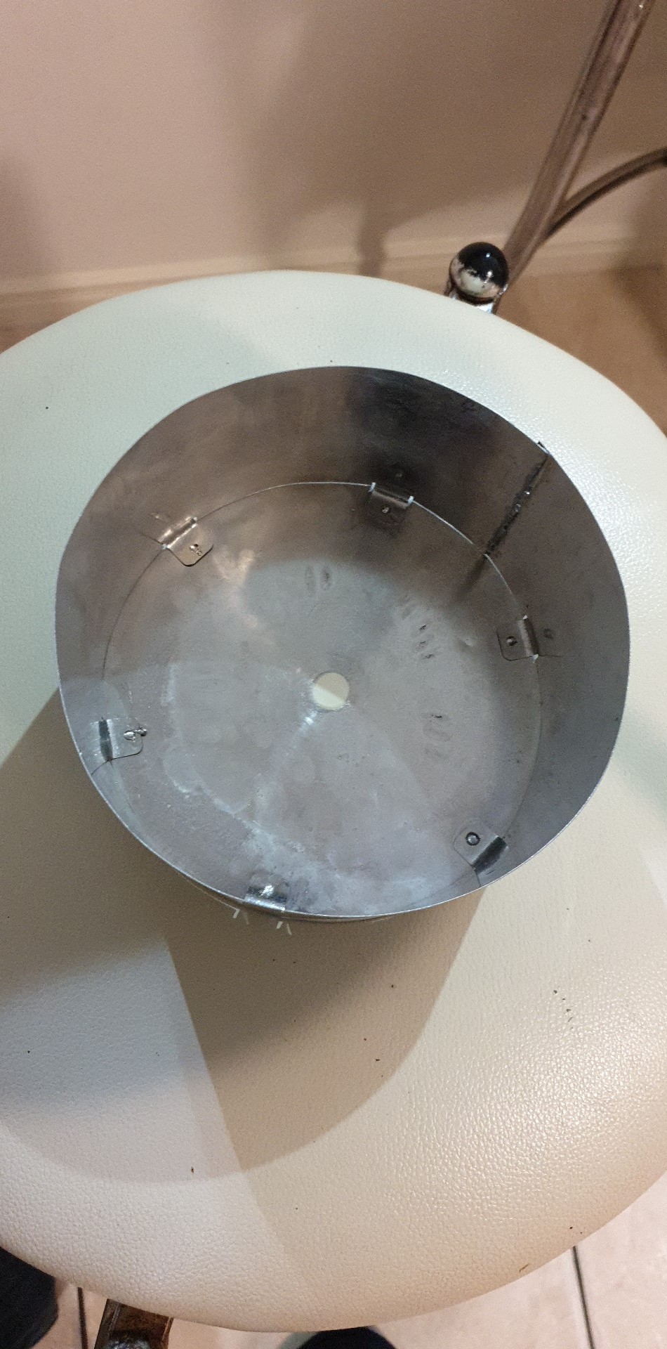

Poured it in two pours. First pour into the nu-metal housing with center tube inplace and without the transformer inplace then quickly lowered the transformer into position.
The second pour finished it off.
A big thanks to @neilshop for putting me on to this smooth-on product. If you use this product to pot your transformer please ensure that you get the longer setting version as the pot life on this version was very short.

I've been potting my transformers using Vytaflex 60, a urethane rubber product from Smooth-on. Very easy to use, as you don't have to be in a hurry to make the pour after mixing it. It takes a few hours to begin setting. The small sample kit provides all the volume that's needed, but don't forget to buy some color dye of your preference. It pours like syrup and will permeate everything.... Make sure that you don't have any seams or holes that can leak 😉

Yes, that would great if fin direction was different and heatsink black but I use heatsinks like this one with fins facing up, while PCB is underneath as on the attached photos. It works fine.Hi Janusz,
- Daniel
Heatsink could be anodized black or simply painted with anodizing paint. Anodizing can be done at home only one has to be careful as acid is used.
I decided to buy these heatsinks as they were relatively cheap, about A$52 each. I could get two 200mm x 125mm vertical fin heatsinks from element14 for about A$90 to get 400mm. In the end I opted for the cheaper version.
