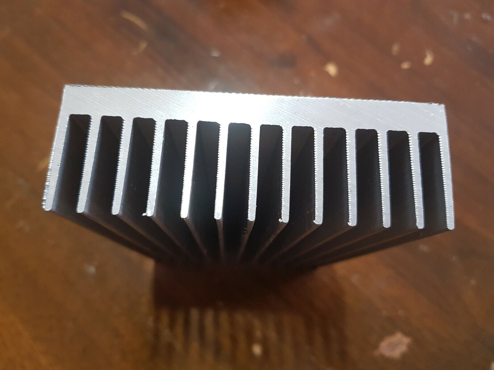

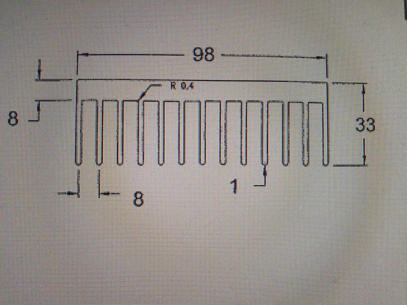

If this kind of a heatsink as shown on attached pictures is OK then it is available from temteccontrols seller on Australian EBay.
Lengths available up to 400mm. Plain aluminium not anodized.

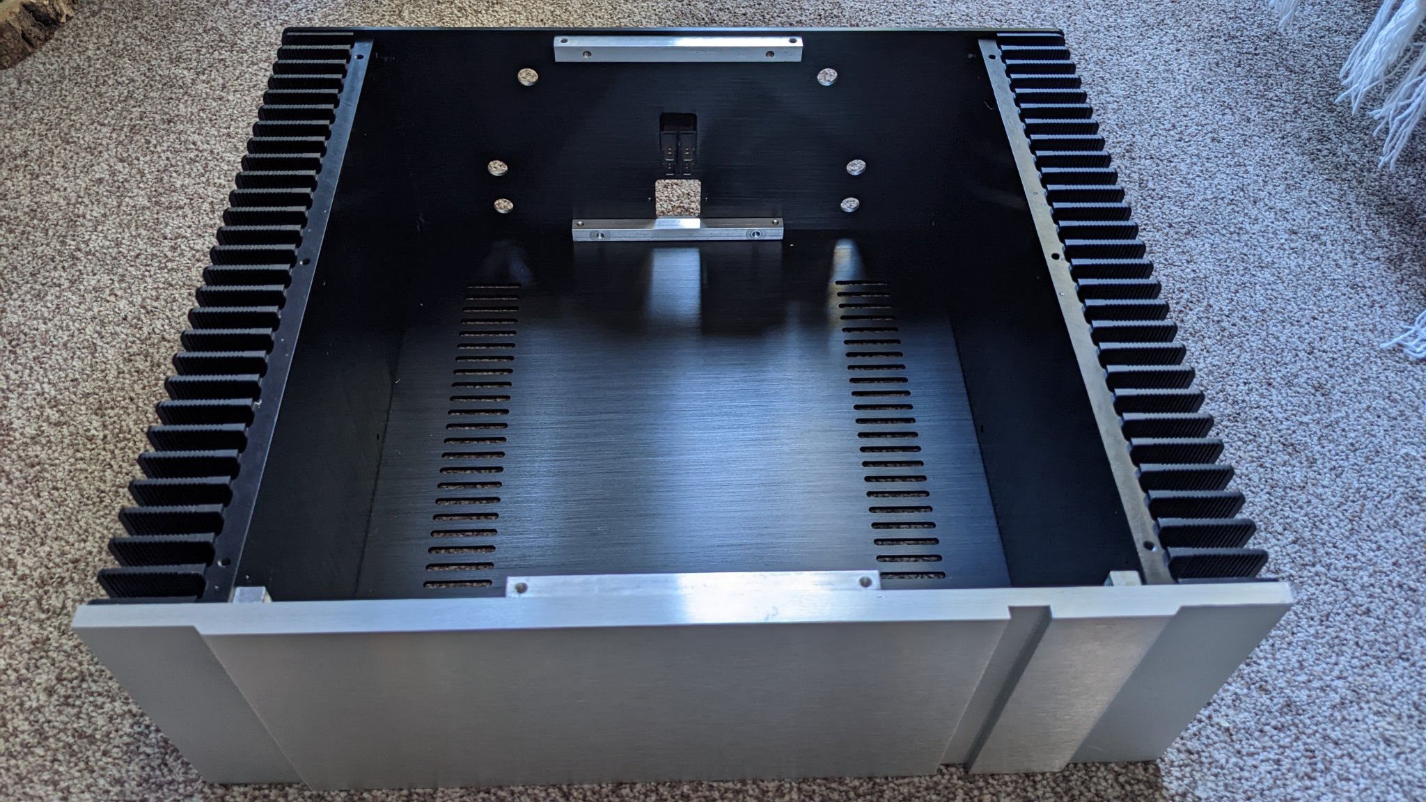

Here we go. This will be the home for my Wolverine amp.
I will have to build my own version of modushop perforated m3 mesh tray. For that, I am itching to utilise a 3d printed (have access to ultimaker rig at work) standoffs which will hold cut to size 1.5 mm thick mesh m3/ 5mm pitch. Can potentially 3d print all fittings as an integrated frame (including two-sided conduits with a foil lining in between for twisted wire runs) using ABS plastic, however unsure how feasible that would be.
If not, will use standard aluminium angle brackets + aforementioned mesh and possibly encapsulate the toroidal transformer in its own enclosure (can be had from ebay etc).
If it fits (and if I am going to use a conventional power supply) , I plan to put transformer in front, on its side- attached to one of metal separators.
Does it make sense to add another chamber for power supply filter, thus effectively introducing 4 distinct isolated chambers?
