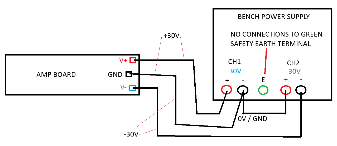

Your power supply is not setup properly. Please refer to this youtube guide that I made of another member.I'm using 0.2amp fast blow fuses. I'll try to bring up the voltage and current slowly using my bench power supply.
You must always, always, always confirm your supply voltages before you connect anything to your amplifier.
The schematic and the build guide will references these voltages as well.
Oh my, I was looking so hard at the board components I completely missed the power supply was connected 😱 Yeah, I don't think you'll get far in testing with it connected like that (its shouldn't have done any damage if R109 was at max resistance) , you need to establish the dual rails - a positive +30V rail, a "0V" (GND) and a negative -30V rail. As Daniel picture and Stuarts video show. Best of luck.

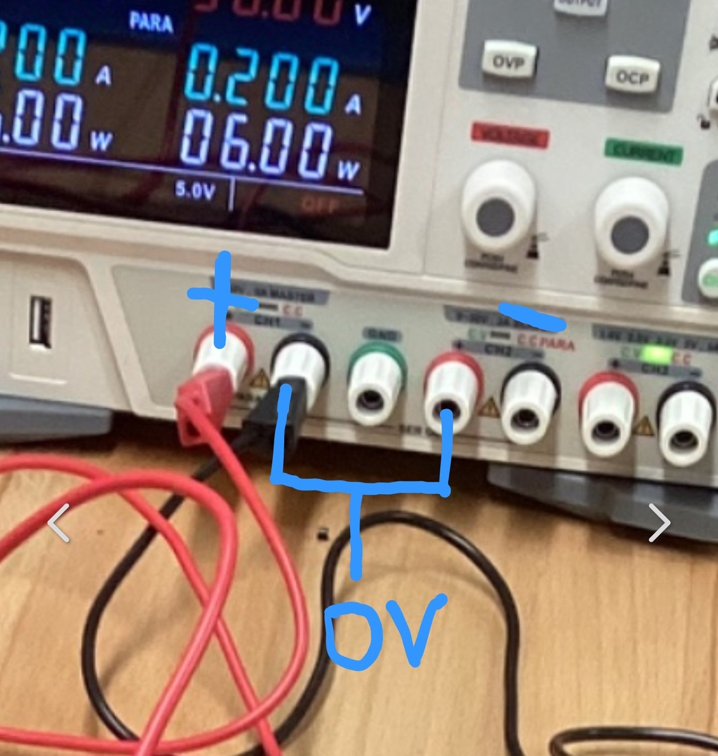

Ok guys, I understand what you are saying. I'm not quite sure how to accomplish it with my power supply. Can I get +30 V out of one channel and -30 V out of channel 2 by putting the channels in parallel? To get my 0 Volts do I physically have to connect the negative (black) output on channel 1 and the positive (red) output on channel 2 and run that to the PSU ground terminal on the pcb?

Yes, but this is a series connection, not parallel.Ok guys, I understand what you are saying. I'm not quite sure how to accomplish it with my power supply. Can I get +30 V out of one channel and -30 V out of channel 2 by putting the channels in parallel? To get my 0 Volts do I physically have to connect the negative (black) output on channel 1 and the positive (red) output on channel 2 and run that to the PSU ground terminal on the pcb?

Check the power supply manual, let us know if you need a hand
Quick rough example. Your two channels get connected in series.
